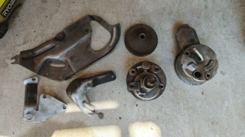

I am to a point where someone else has done removal and am looking for missing parts, IDing parts and figuring out how the P/S pump was attached. I think I am missing a bracket. Can someone post me a picture of their stock installed P/S pump please? Most that I see online are manual steering. And the book does not show anything.
I am going for the dual master cylinder, going to try the trick with the s10 unit, it is on order, I would like to have that completed before the engine install. I have run all new steel brake lines.
I am thinking there is a bracket between pully and pump?
Not sure but I think the L bracket is for the battery tray? Due to amount of corrosion is my thought. Other bracket holes line up with left head bolt holes.
Pics attached.
Thank you for your assistance,
Steve

I got the motor in, been working under the dash the last few days. Got the P/S bracket from the bay, it is off a Buick but it looks like it fits. I got the two lett brackets IDd but there is a 3rd bracket I am unsure of, I am guessing it is for an A/C car? The manual does not show any illustrations for the P/S.
The bracket in question is the one on the lower right.

What exactly is that? Head gasket material?

Thank you for the reply, not sure what you are referring to, the remains of what I think is a cotter key or the marks it left in the head.
