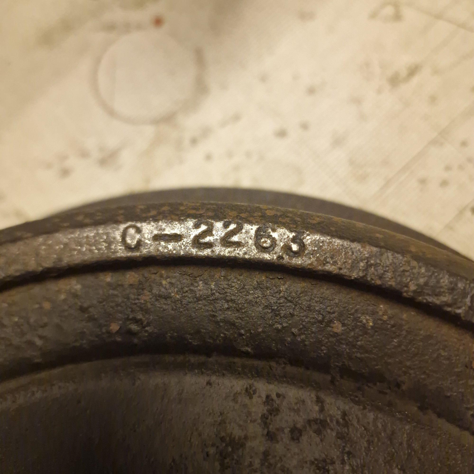

looking for solutions to have my '66 Starfire brake system in a good state. I started to look into replacing rear drum brake components (drums, shoes, wheel cylinder, hardware kit)...
1. Rear brake drums

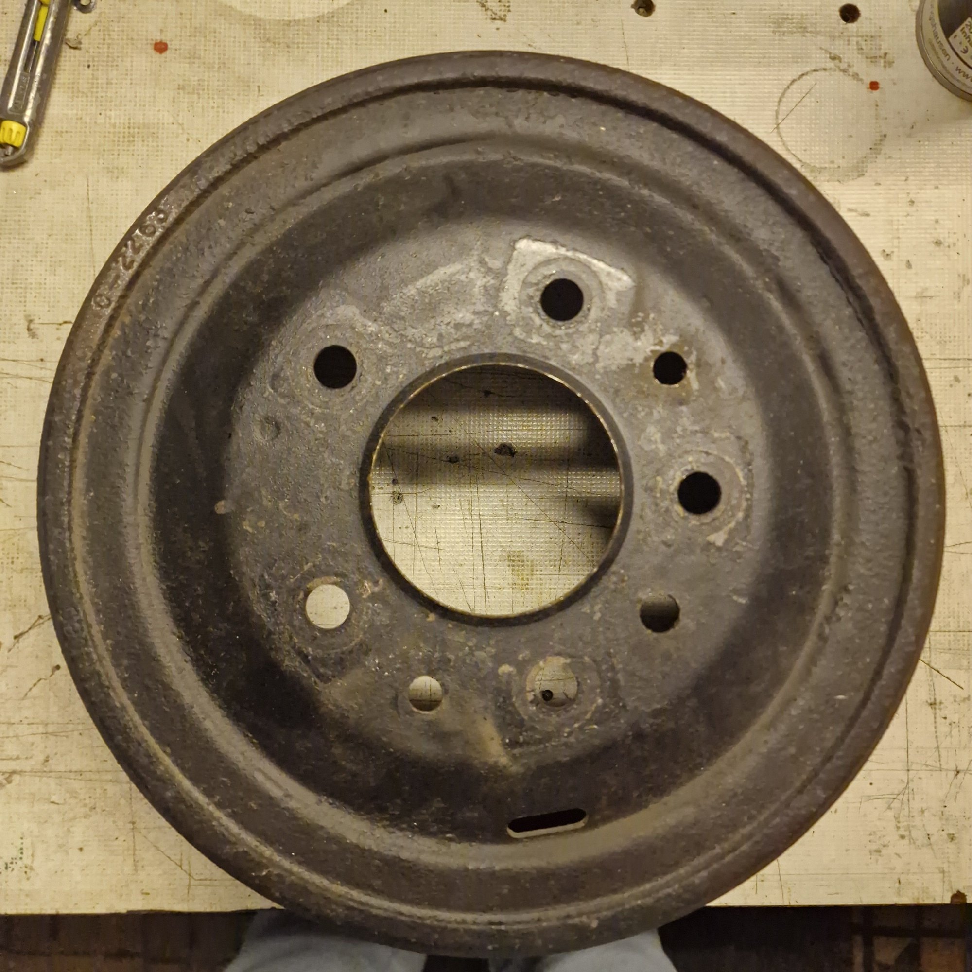

On my car, original drum brakes are mounted on the rear axle. one of the drum was still the original shape, the other one had already been replaced with a different type (which still fitted mechanically). The part number of this drum was C-2263 (manufacturer: Centric). Attached some pics of my previous setup:
Original brake drum (left side)
Replacement Centric C-2263 drum (right side)
Detail view of replacement Centric C-2263 drum (right side)
Casting detail of replacement Centric C-2263 drum (right side)
Inner view of replacement Centric C-2263 drum (right side)
Problem: Unfortunately, for service replacement neither the original brake drums nor the Centric C-2263 are still available. So far, this reflects what was also written in other related threads.

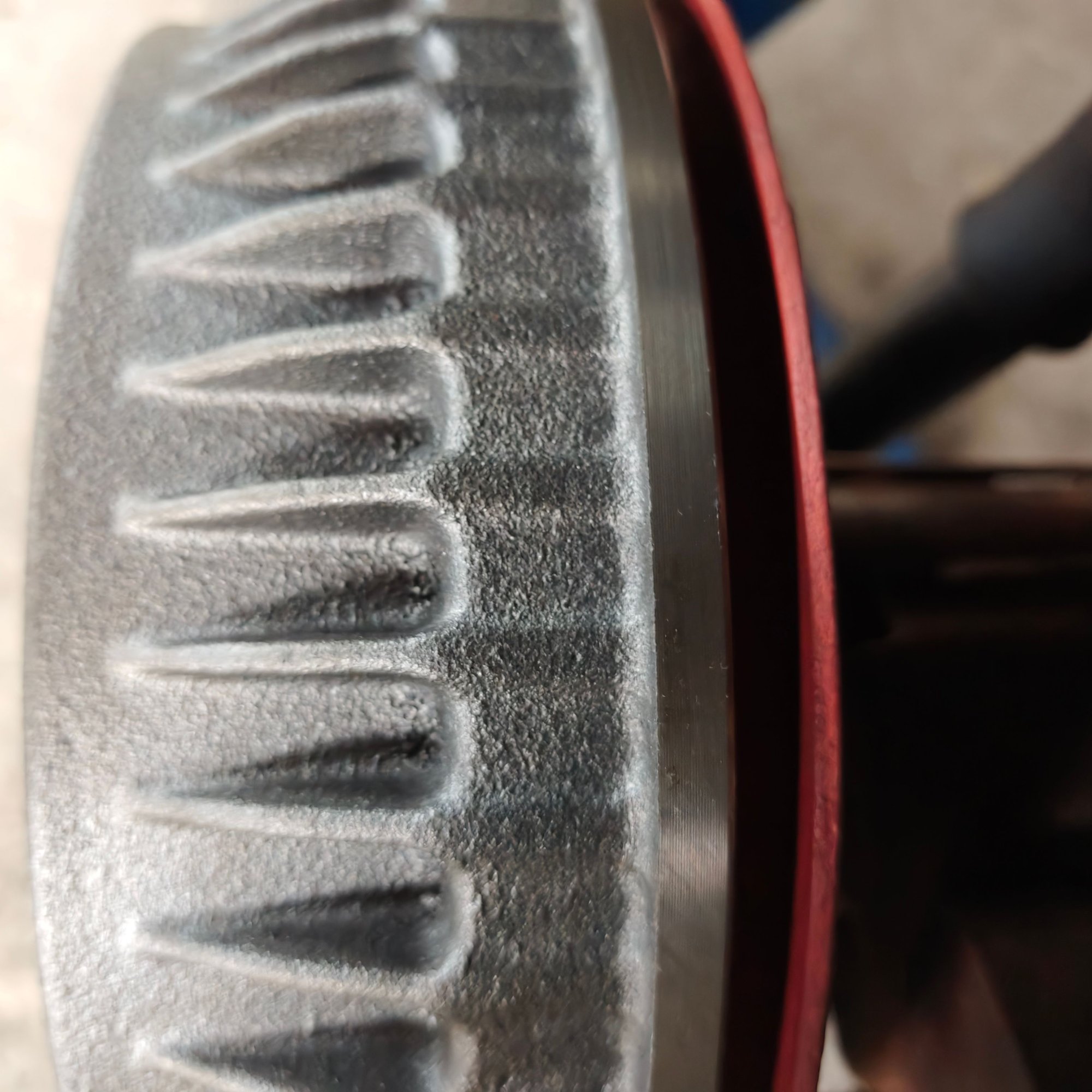

So, I had to identify a new brake drum type. Comparing all characteristics and especially searching for drums fitting a 5x5 wheel bolt pattern and with nominal brake dimensions of 11” diameter and 2” show width, I found out that rear drums will fit from the rear axle of a 1974 Chevrolet C10 Pickup truck. Also, according to this post (Link: ClassicOldsmobile forum) such drums should fit. They have the additional advantage of being equipped with cooling fins.
I checked the available 11x2" drums for 1974 C10 pickup on Rockauto (since I can conveniently order from this company to my home in Germany/Europe) and ordered a set of drums. I personally selected the BendixPDR0254.

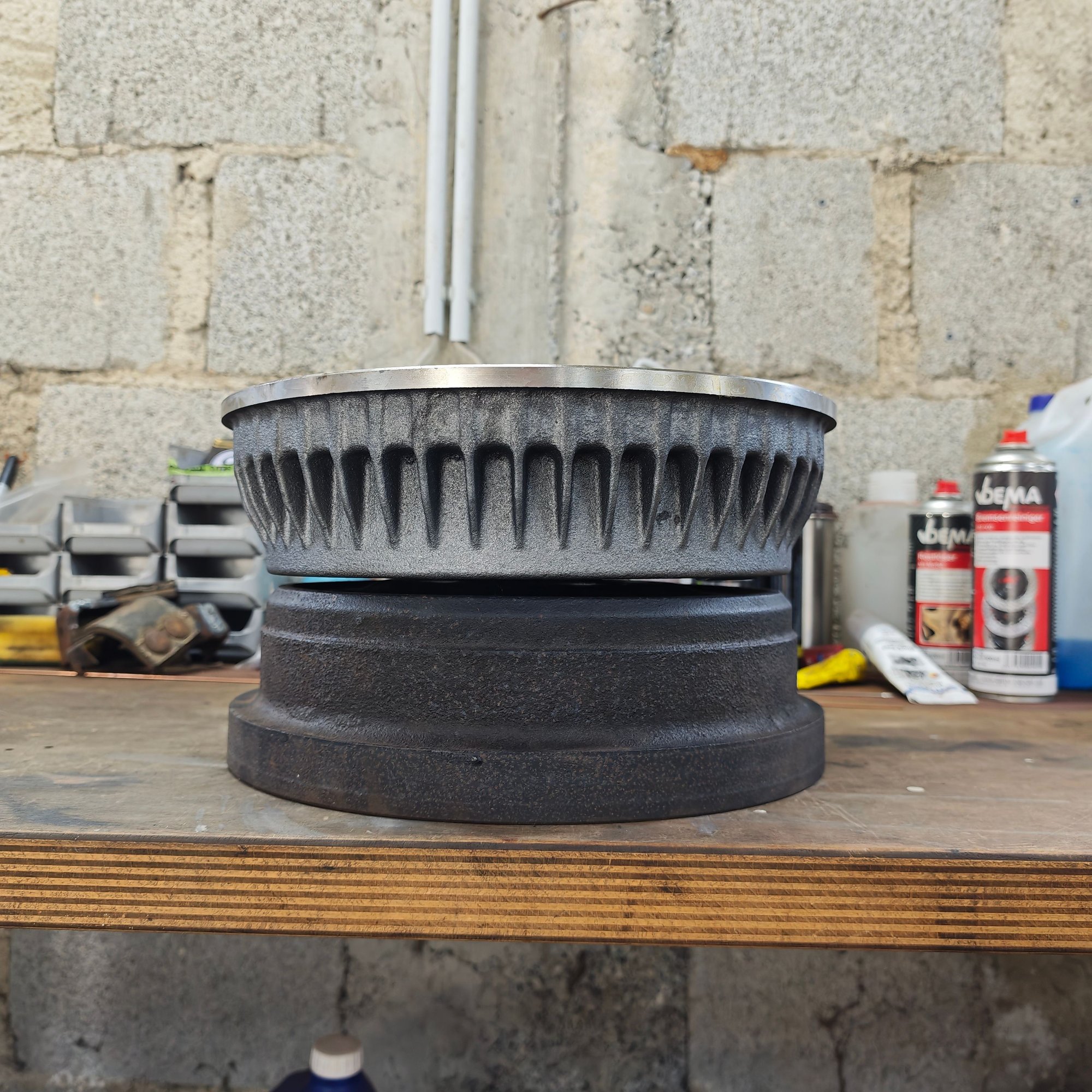

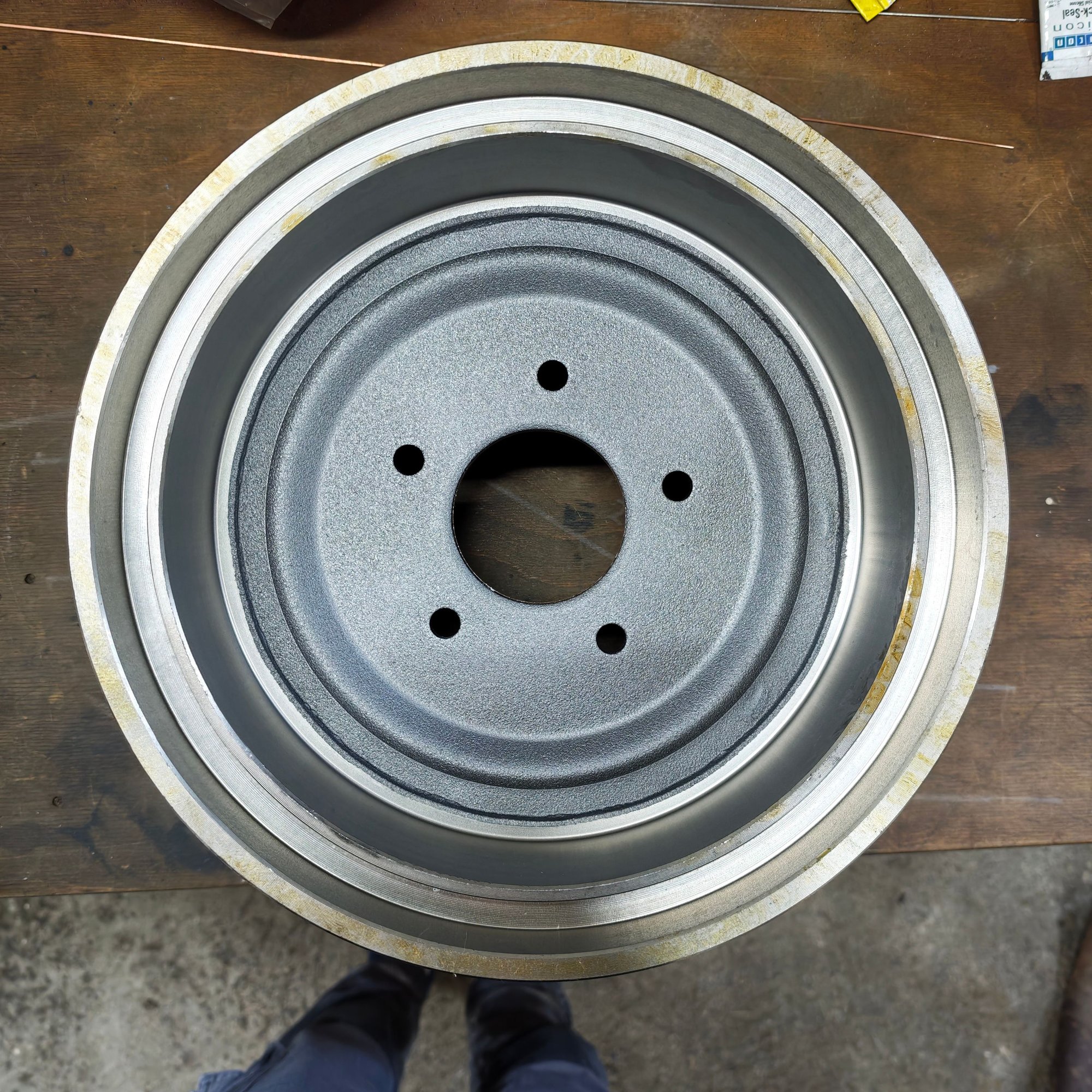

Solution: They fit and work really fine! See the attached pictures for reference:

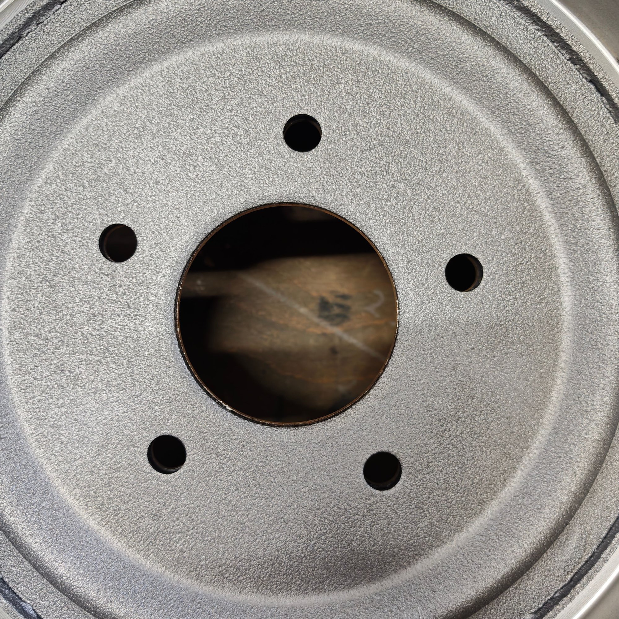

Inner view of my new Bendix PDR0254
Bolt pattern & center hole comparison of the new Bendix PDR0254 vs. my old Centric C-2263. Fits nicely, just the center hole is ~0.2mm bigger on the new Bendix drum
Bolt pattern & center hole comparison of the new Bendix PDR0254 vs. my old Centric C-2263. Fits nicely, just the center hole is ~0.4mm bigger on the new Bendix drum

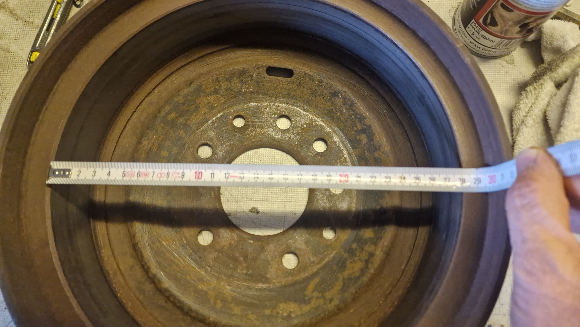

Side view comparison of the new Bendix PDR0254 vs. my old Centric C-2263.

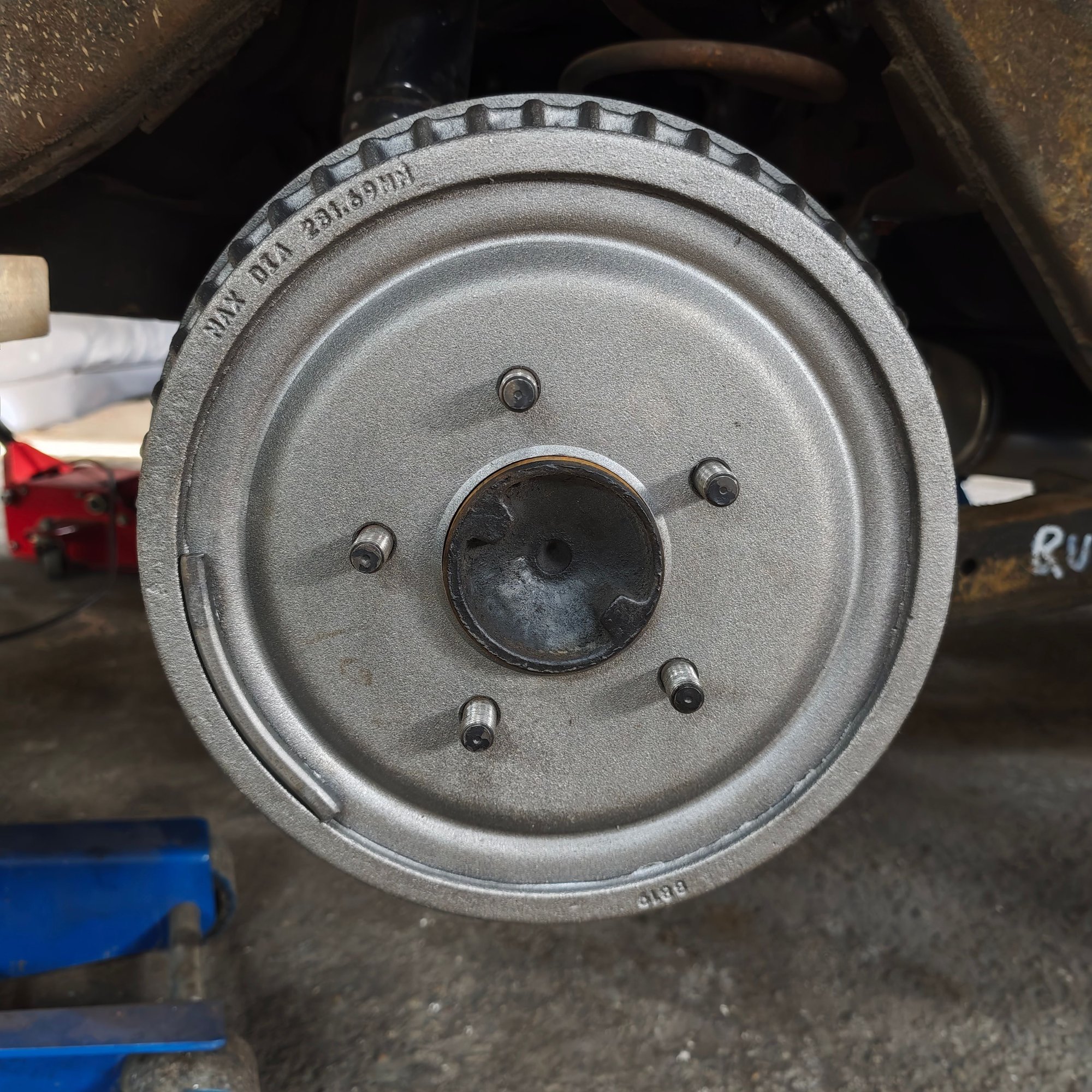

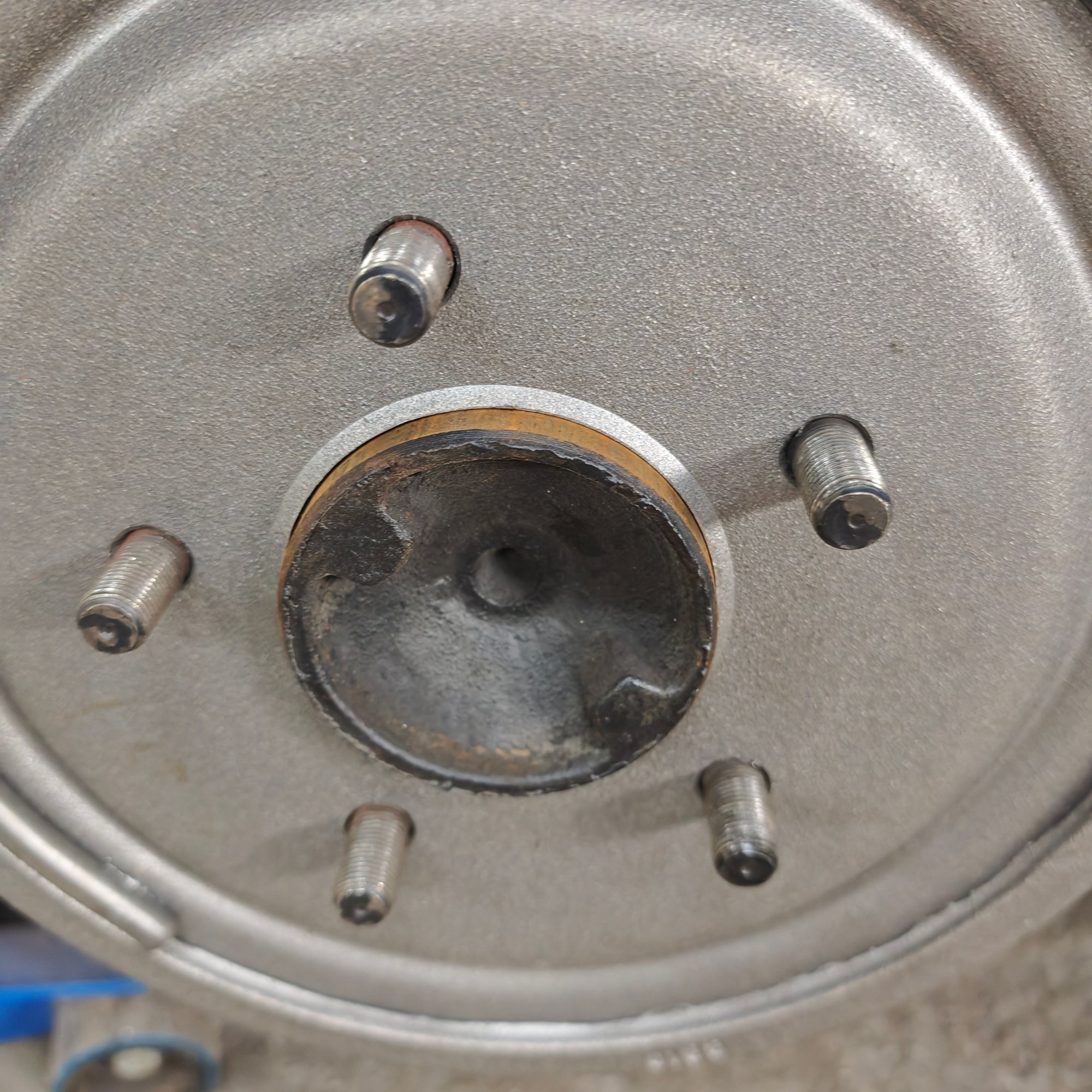

New Bendix PDR0254 mounted on axle. Fits nicely
Detail view
Detail view
Top view of new Bendix PDR0254. Also the fit towards the backing plate looks good
Remarks:
  • Disclaimer: This worked for me personally, brake function & performance is fine, clearance is given and I have no noise. Of course I don't guarantee that this works for you, you do the changes on your car at own risk.
  • The only downside of these drums is that they lack the slot to tune the adjuster wheel
  • Rim clearance: This mmust be checked in each individual case, especially when using original 14” wheels. But in my case with 15x8.5 Ansen Sprint Wheels, clearance was no issue at all.

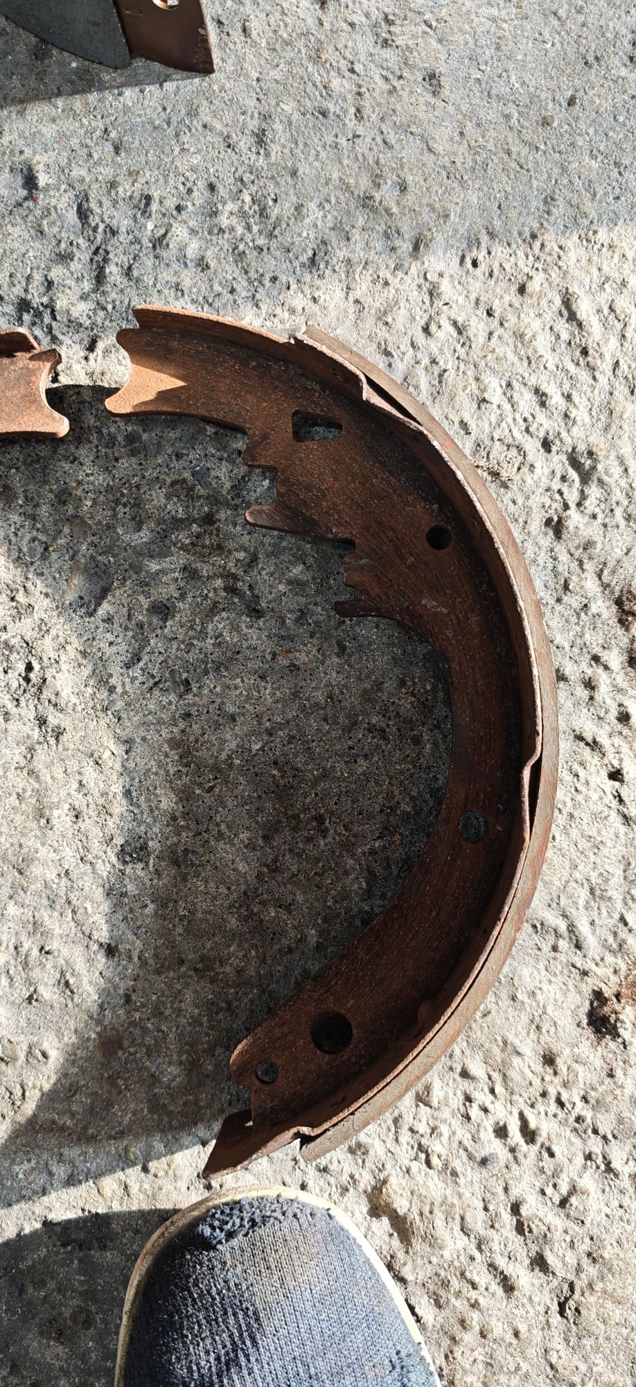

2. Rear brake shoes

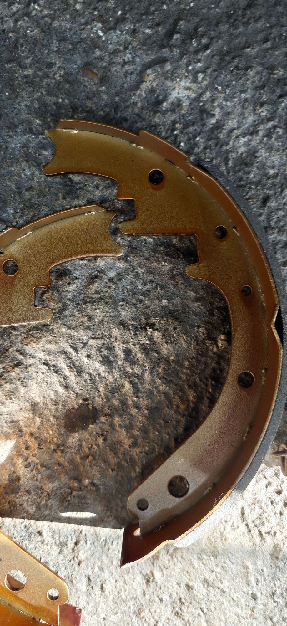

CAUTION: Do NOT order parts like Centric since they have wrong (round) slots for the park brake lever. Check product images before ordering.
For the shoes, you should order parts which are listed to fit for the Olds 98 of 1967, e.g. Power Stop B462 or Bosch BS272. See following pics:
Correct trapezodial shape of park brake lever slot (top-most hole in the shoe)
Correct trapezodial shape of park brake lever slot (top-most hole in the brake shoe)
"Wrong" round hole for park brake lever
