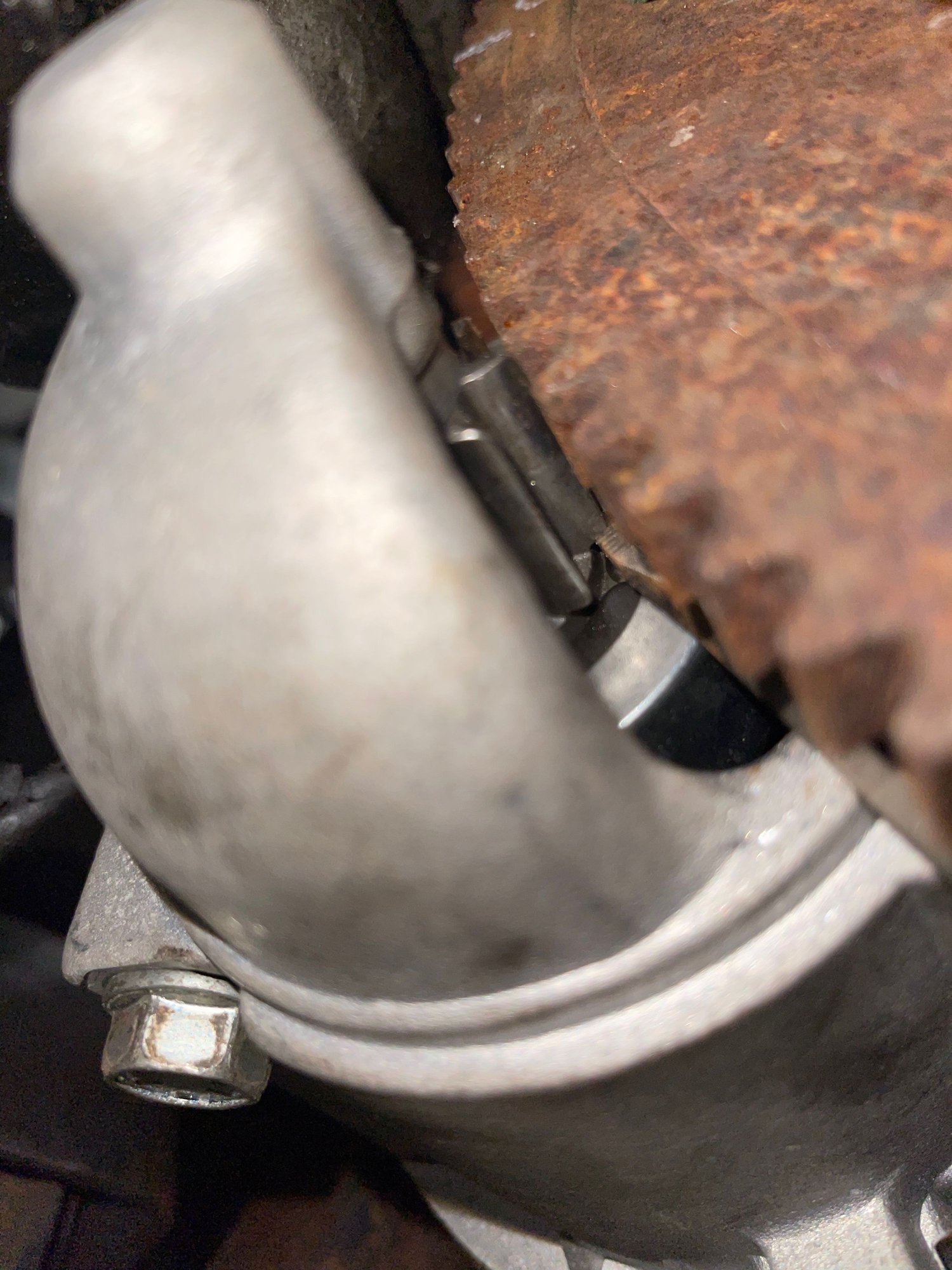

Old Mar 4, 2022 | 07:44 PM

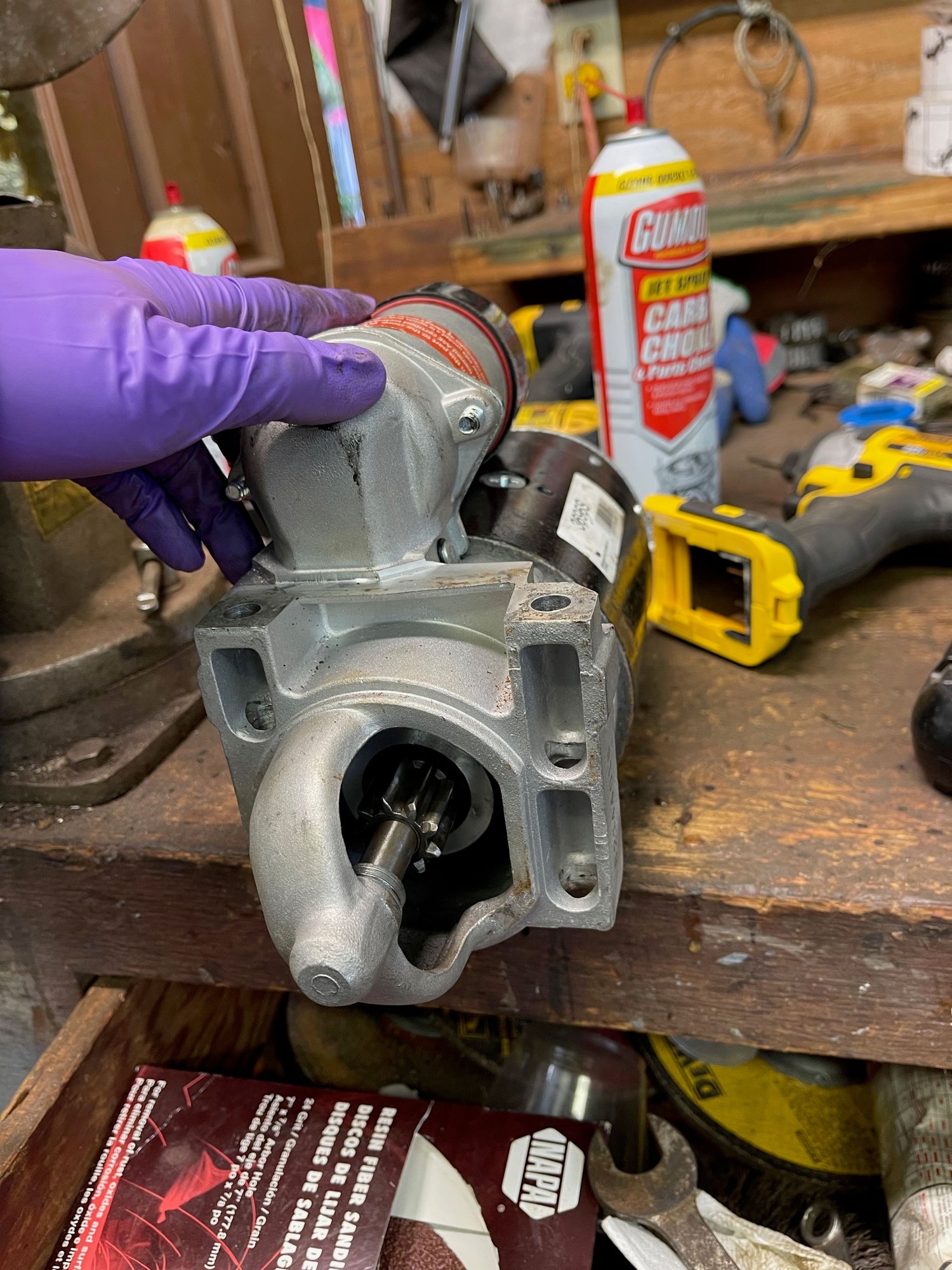

Old Mar 4, 2022 | 07:56 PM

hey y'all! sorry for being silent lately. I was able to get the olds pushed into the shop and out of the terrible Oregon weather. I bench tested my starter and it engages, spins, and disengages. I counted the teeth on my flywheel (twice) the total count of teeth was 135. I tried my best to get some good pictures of the starter and the flywheel. hopefully they are good enough to understand what's going on with the olds. this is the starter installed with no shims.

Refer to Joe's post #17. Looks like you have a diesel flex plate which is 135 teeth and smaller in diameter.

darn! I was hoping to avoid a transmission pull. thank you for all the help everyone. and just to be clear, if I get the flex plate with the 166 teeth and 13.91"in diameter that should fix my issue?

Correct. Any 1968-1990 Olds RWD gas engine flexplate will work.
