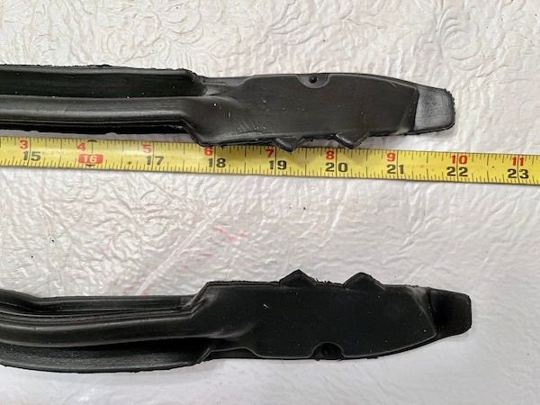

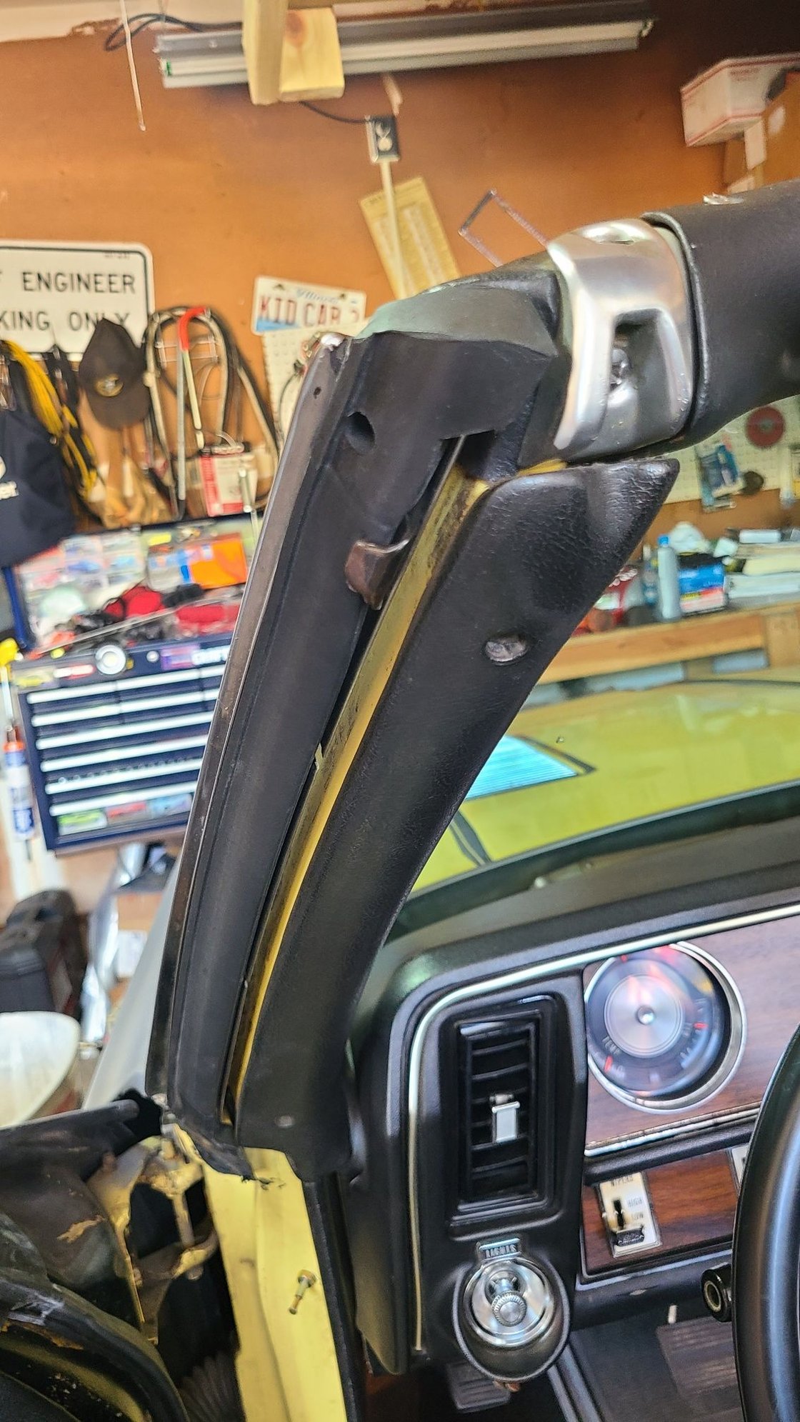

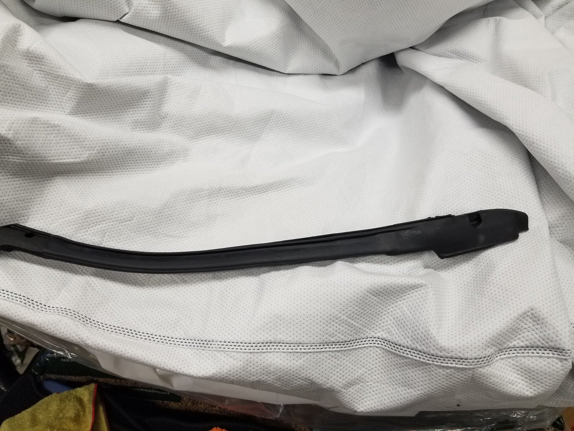

Morning all Bought a set of A pillar weatherstrips for the 70 convertible. Old ones are big time aged out. The new ones have some considerable differences in size /shape. (Pics below) As usual my lack of experience leaves me with questions lol.
The new ones appear shorter (although the directions show how to stretch them into length you need) The top end appears smaller, and the bottom end which clips in inside the door jamb is smaller and shaped different.
First thing that came to mind is that the old one is just really distorted and blown up and squashed from it's age, or the old one is incorrect and put in there by previous owner. Or both. I did a quick trial fit and it does fit , just shaped differently.
ANy knowledge would be appreciated
Thanks as always
Length
Top end
Door jamb end

Minmal "stretching" to make it reach. I have zero experience with weatherstripping so I'm not sure what my tolerance should be for anything less than exact duplicate to the original. However you may be right on the universal application idea. I don't have the box in front of me but if I recall it had a label that said something to the effect of "all GM A bodies.
Either way I'm not that crazy about them. That bottom end that goes in the door jam is MUCH larger and flatter on the old one and has 2 holes punched in it for the plastic pins that secure it. It appears I have to punch the holes in the new ones.

In my 3rd picture marked "door jamb end" is the old one only larger and flatter because it's been squashed for 52 years? The differences in size here are concerning.

INL12953 A-Pillar Weatherstrip Length
Originally Posted by 70Post
Surely someone on this site has a set of convertible Apillar reproduction w/strips they haven't installed yet that they could take an exact length measurement on.....out of curiosity to see how they compare.
This is the Inline Tube A-pillar seal part# INL12953; think it's made by Metro. It measures 22" long (unstretched).

Yep, that's exactly the one I have. Same length as well. I had an opportunity to visit a local body guy I know today and he confirmed our suspicion....the older one is only that "big" because it's blown out and swollen and squashed with age. Unfortunately it does look as though I'll have to accurately punch the holes for the fasteners on the jamb end. Thanks again everyone for the help.

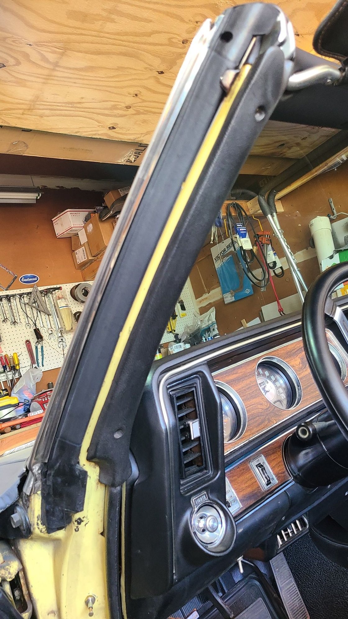

Mine looked identical to the originals except for the wear on the old ones.
here are a few pictures of them installed
I hope Soffseal didn't change their design, I purchased mine probably 15-20 years ago and just installed them maybe 2 years ago
Good Luck
