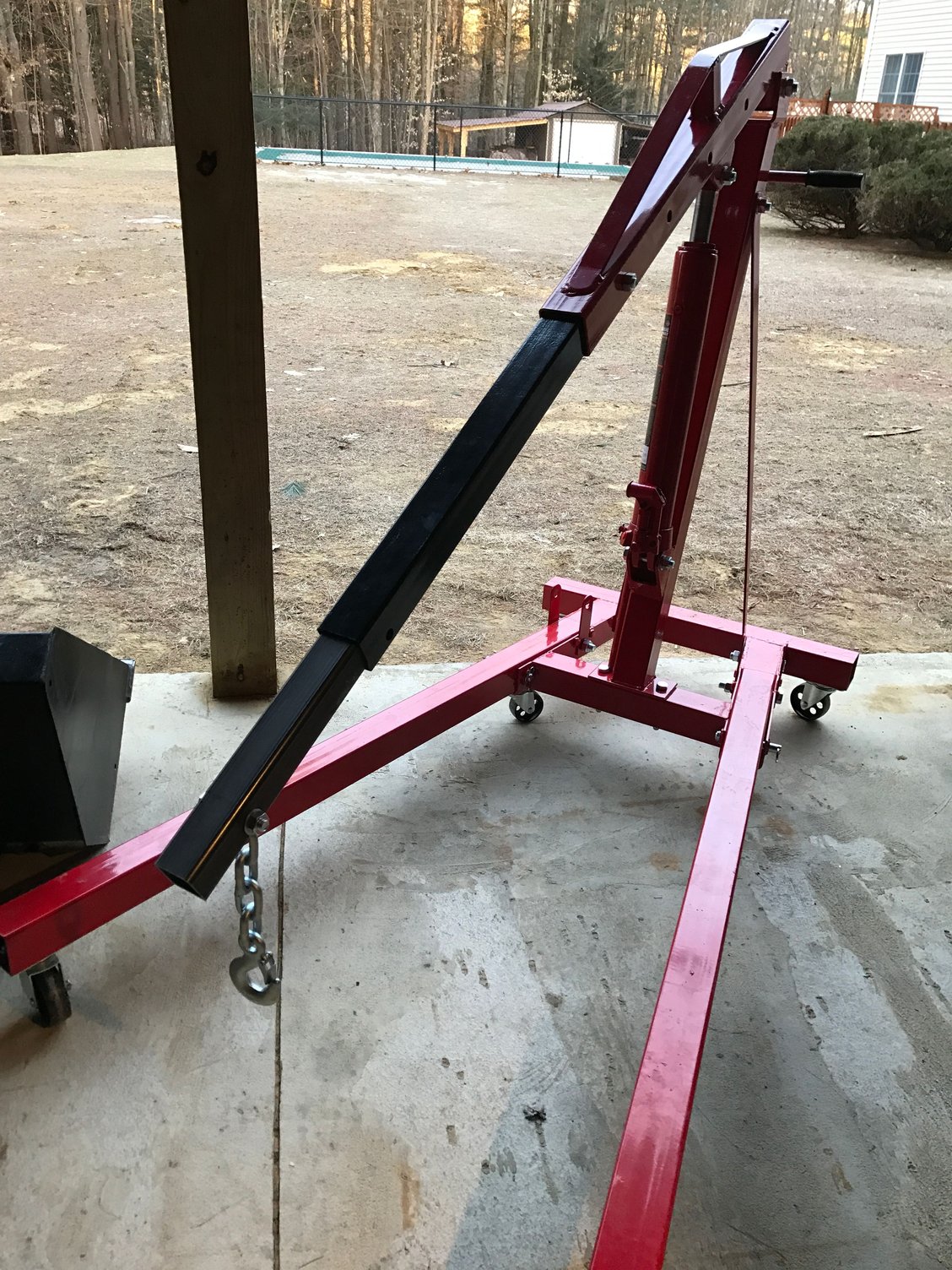

I have the same engine hoist and used it to pull and install the 360 engine in a Jeep Grand Wagoneer. Are you extending the boom all the way out?
if you use the holes marked by weight capacity it will be too short. You have to live on the edge and put the boom as far out as you can. It doesn’t roll very well with a lot of weight on the end of the boom but it is manageable. I did it by myself.

If you want to live dangerously, or carry your ***** around with a bucket, you could drill another hole in boom and extend the arm another couple inches. My hoist on the longest boom is rated for 750 pounds, that leaves about 100 pound safety margin (more if you have aluminum parts, or a less than fully assembled engine) I would still want some added ballast on the rear of the hoist for a counterbalance.
My hoist will drop the engine on the frame pads with the hydraulic cylinder about an inch from the bumper. The hoist is also older than dirt, I’m sure like everything else over the years they have gotten cheaper and made accordingly

i had this same issue putting the 455 back in my 76 cutlass .i ended up doing a boom extension on mine ,it worked fine but you will need to be careful it can tip forward .i had my big brother on the back end so it wasn't going nowhere .that exact setup however will NOT safely lift the 455 and turbo 400 trans together (ask me how i know!)
