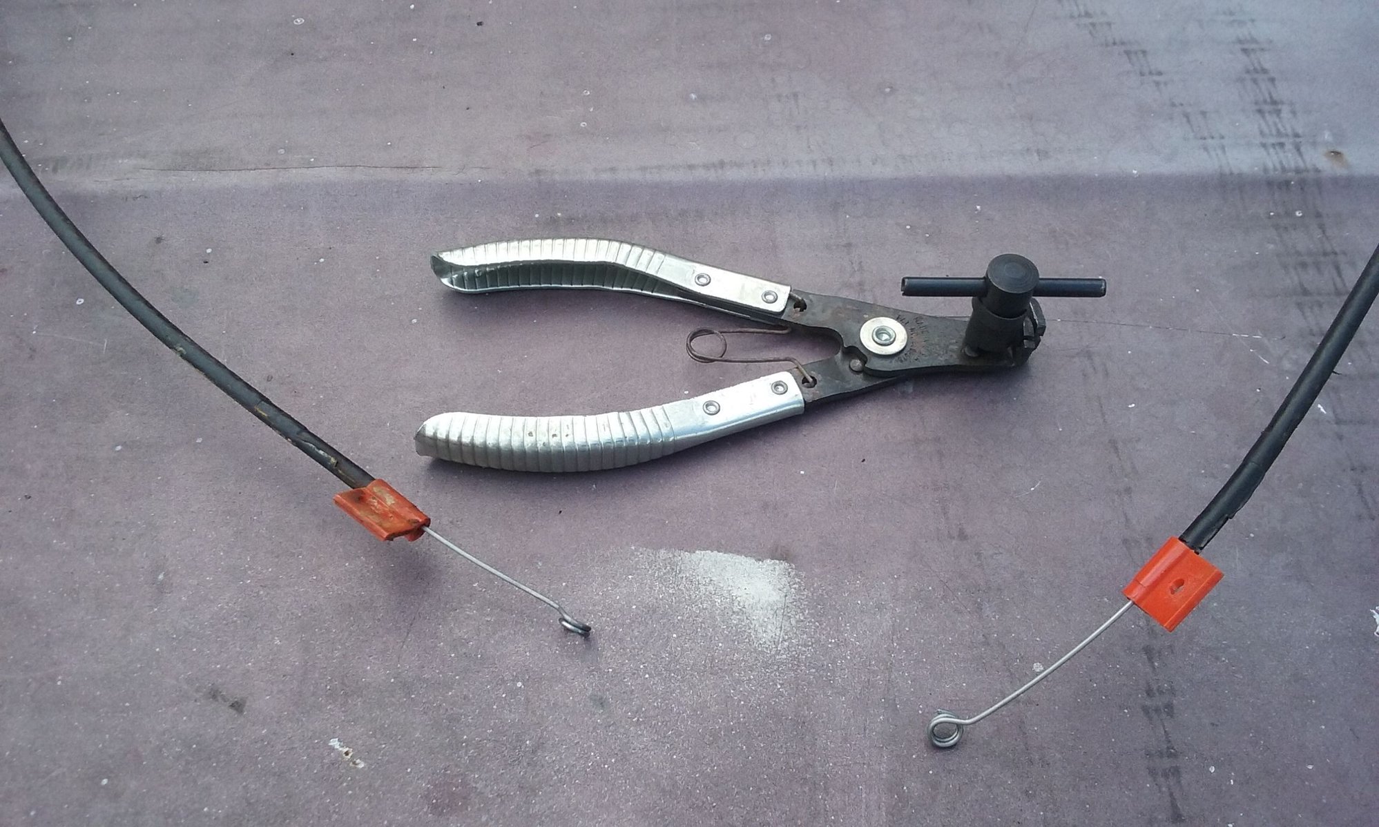

I just went through this with my 67 Delta, which uses the same HVAC box as your 70. The temperature control door is cable operated and the cable does corrode and gets stuck. In my case, the heater core had leaked on the cable, causing it to rust. Do not force the cable, as that's how I broke mine. You will need to remove the cable and hang it vertically to allow you to slowly drip penetrating oil down the cable and into the sheath. As the oil works it's way down, you should be able to start moving the cable. No one makes replacements for these. I have an old KD tool for twisting the loops onto the ends of the music wire cable, so I was able to fabricate a new cable to go inside my old sheath.
To disconnect the cable, you will need to remove the ducting that bolts to the HVAC box under the dash, which will give you access to the lower end of the cable at the temp door. Once you remove that end of the cable, actuate the door lever by hand to verify that it isn't the door that's stuck. The other end of the cable is buried in the HVAC control head. I was able to access the screws that hold the head to the dash through the radio opening.
If you do need to replace the music wire cable, these are photos of the tool that forms the loops.
