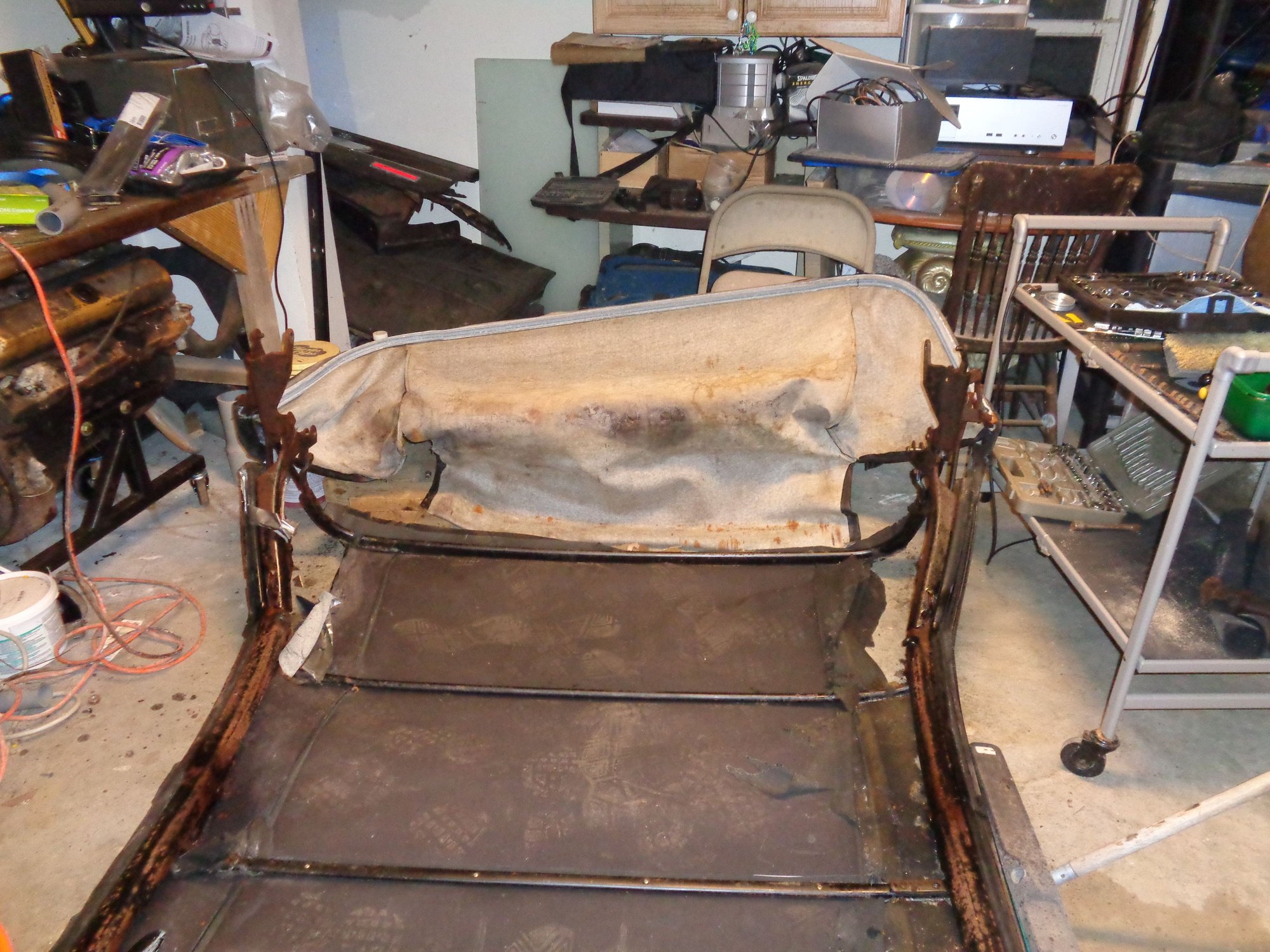

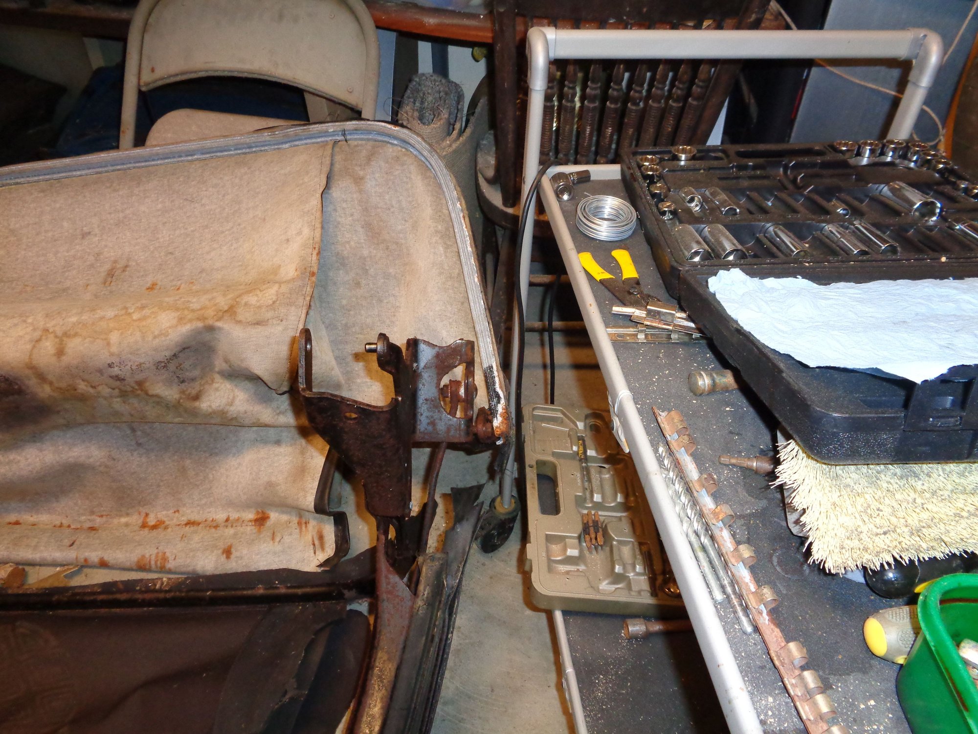

Finally got strong pair of hands to help
I managed to hold the front high enough to release the pressure on the trim stick, while my buddy yanked each back corner out.
strange are the trick stick bolts supposed to be partially screwed in?
