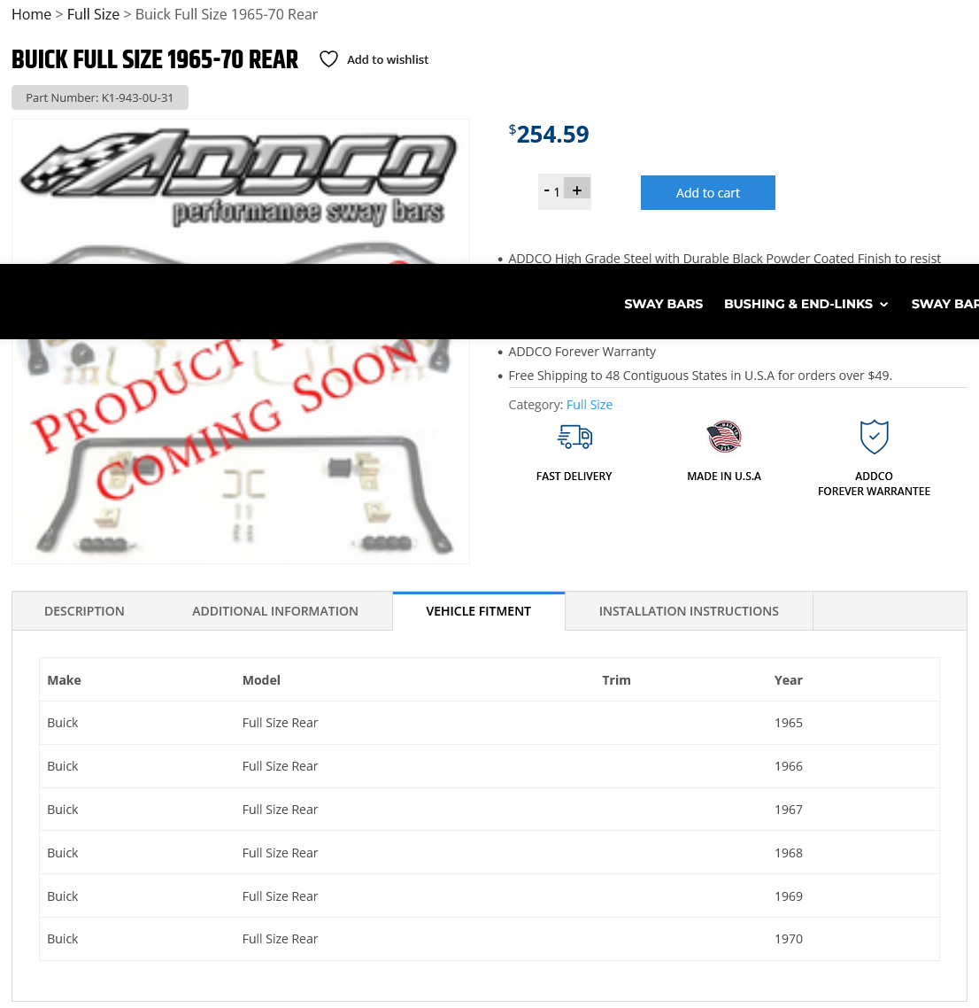

They definitely are advertising it fitting Buick/Olds. I noticed on the packaging it said Addco 943. I can buy the same bar elsewhere for $197. Not sure why they charge $402 for the same thing.

Posts: 50,791
First, Kanter is NEVER the least expensive source. Second, if you go to the ADDCO website, they clearly show that this bar only fits Buick full size. As I've said several times, the Olds suspension is completely different from that of any other same-year B-body car. Any source that claims a suspension or brake part fits another GM car besides a 1965-70 Olds full size is lying. You should return the bar, tell them that their fitment is incorrect (show them the ADDCO listing) and if you are going to make spacers anyways just get an inexpensive A-body rear bar. And as a hint for the future, it takes only seconds to price check multiple sources on the interwebs.
