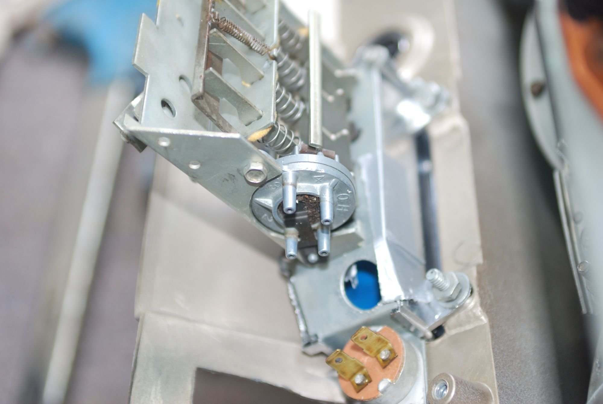

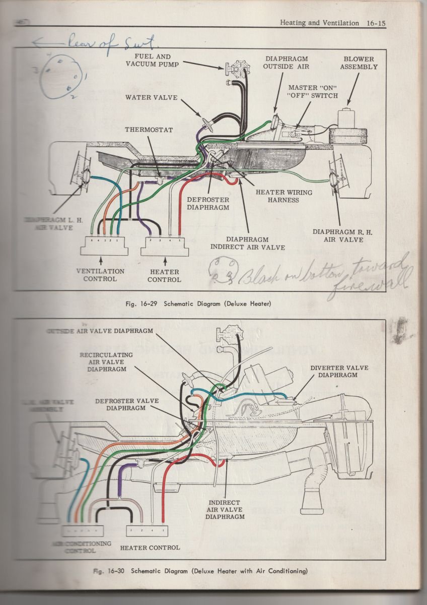

I had assisted someone before with similar issues but when I checked the pics I had uploaded it seems I messed them up moving them around when I tried to organize them into an album.
Anyway, do you have the service manual? In it shows the vacuum diagram and the lines are color coded and the color is on the hoses. I believe if vacuum is leaking anywhere the switches won't hold or the mechanism is dirty. My car is older but the mechanism is about the same. As Oldsguy said it's tight in there and very hard to see. It wasn't too bad for me because I had the whole dash out when I worked on it. It can be worked on using a flashlight and mirrors.
