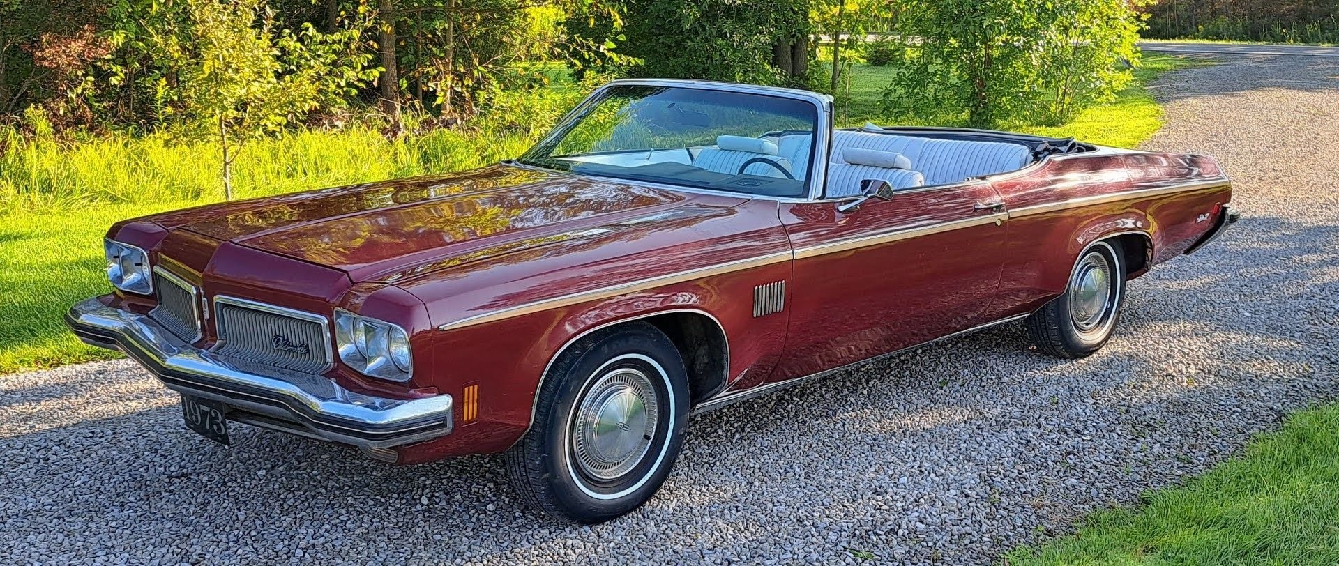

I don't know about being a mentor, but I'm glad to help you all I can. I have a very similar car, a '73 Delta 88. Mine, however, is very low optioned. It doesn't have air conditioning at all. It is a convertible, which makes up for the lack of A/C.
