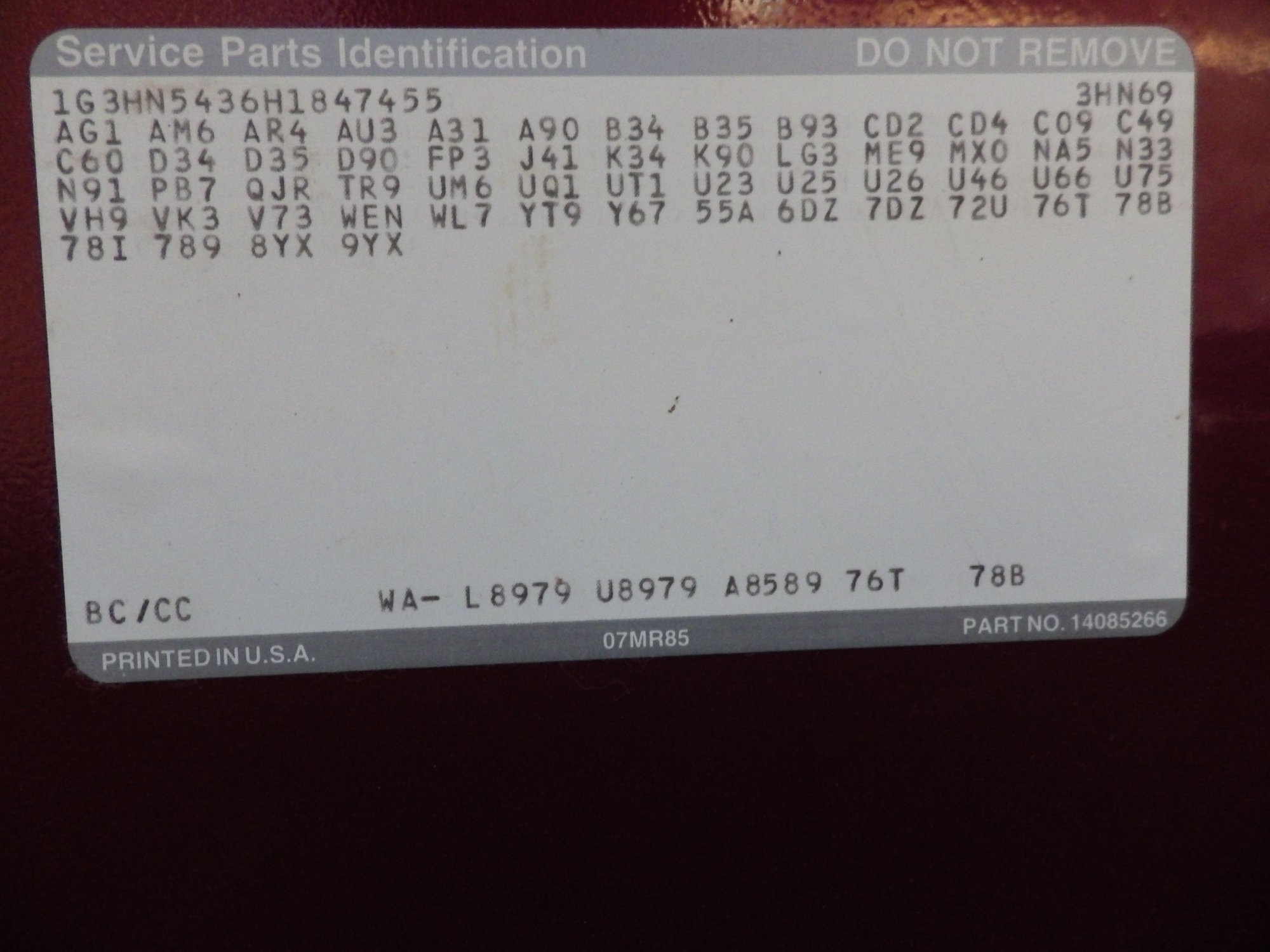

Here's a SPID from a 1984 Regency Brougham, and it shows nothing as far as paint type. I'd bet it's lacquer though.

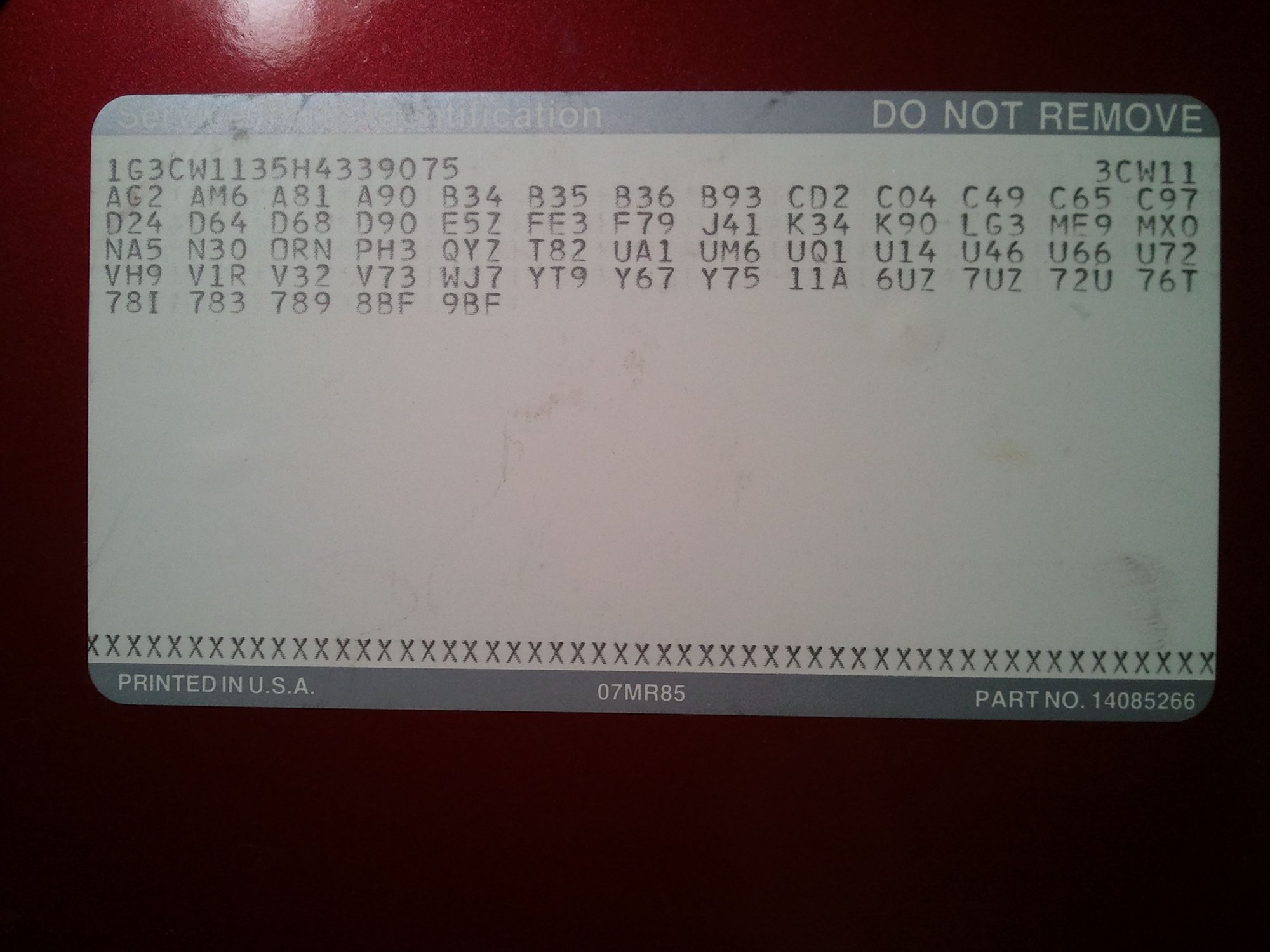

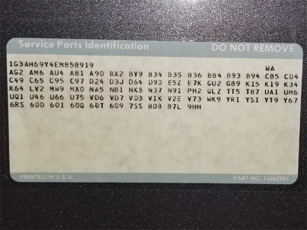

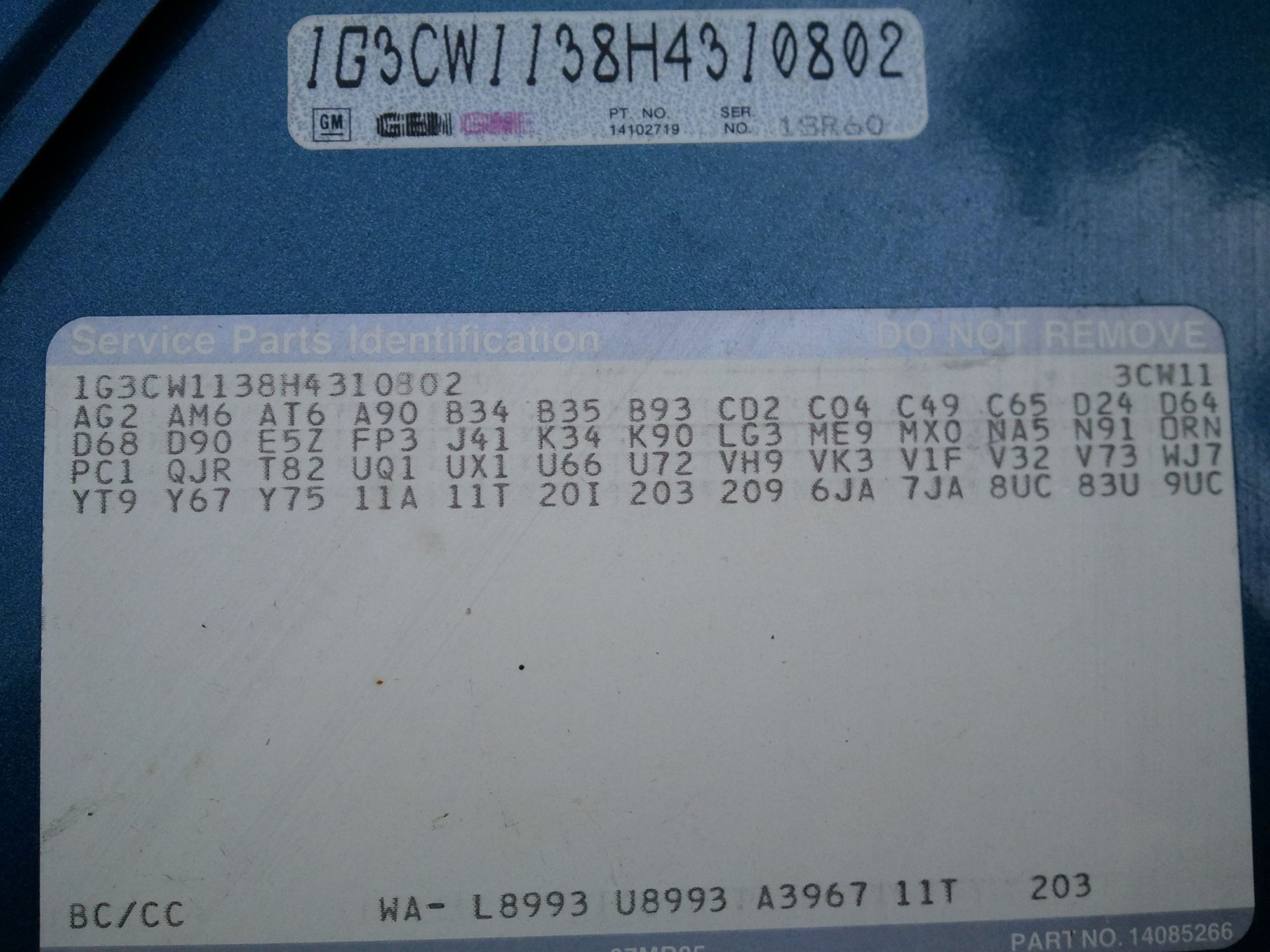

One of these is from my '87 Ninety Eight coupe and one is from a deck lid that was on a '87 Ninety Eight coupe I bought from a salvage yard. Nearly identical cars, and look at the paint codes.
