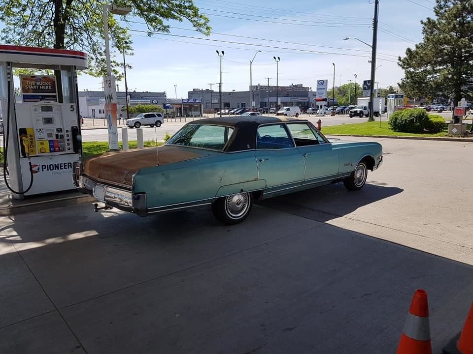

Good evening to all. Would like to share a 1966 Oldsmobile Ninety-Eight LS sedan we saved from a sad fate. We call the car 'Ocean Mist' in name of the paint color. We got the car in 2018, literally driven out of a field, the fate was the car to be used as a demo-derby by the person we got her from. We did a round-trip of almost 1500 miles to get the car. She looked pretty solid from the pictures, we were not disappointed when we first set eyes on her when pick up time happened. The car was very weathered though not worn, the fact the speedometer said 68,000 miles, and pedal wear etc. seemed to indicate this. What really caught our fancy was the car had a decent an\mount of options. Some were/are factory cruise control, power vent windows, cornering lamps, tilt- telescopic steering wheel, AM/FM radio, A/C. With lots of patience checking and repairing connections due to tarnishing, and having the factory service manual, every one of these accessories works just fine now! Even the points-style clock functions! Getting the car to look reasonably decent again required a lot of hours of work on our part, as farming out the bodywork would have been cost prohibitive for the budget we had. Scrape, scrape, scrape, sand sand and more sanding was done on many evenings. I honestly thing vinyl tops are the most evil thing on a car to remove! Thankfully, by some miracle, the roof was in excellent shape, the windshield cowl was the most damaged, that took a bit of welding and ingenuity to fix as replacement parts for B and C- body Oldsmobiles are hard to find in reproduction. All to many classic cars rust at the base of the windshield! We decided to paint the roof, it was a lot less expensive then fitting a new vinyl roof, and the light cream color keeps the interior fairly cool, the factory A/C only being needed on the most hot and muggy days. The color combo looks so 'tropical' as many friends have said, we agree. The 425 V-8 and Switch-Pitch Turbo-400 work very well, the car is quite snappy when the accelerator pedal is pushed. The rear axle is a 3.08, we do have a limited slip Anti-Spin axle to fit 'just because'. Since the car is now not original in the sense of work being done, and it is for us to enjoy, some upgrades have been done. 1968 Oldsmobile rear side lamps have been installed on the rear fenders, taillamps have additional LED bulbs installed inside to brighten the rear stop/turn lamps, third brake lamp, front side markers hidden in the cornering lamps, and the parking lamps now stay on with the head lamps. The brakes were thoroughly examined, new brake hoses were put on, wheel cylinders replaced, premium brake shoes replaced the almost worn front units. The rear 2.5 - inch wide shoes were just fine. The car stops swiftly and silently. We do not hot-rod the car, so the drums are fine for now. I do have a disc brake assembly from a 1970 Ninety-Eight for the future i
Power vent windows!
The cruise control gets lots of questions when folks see it.
The AM/FM radio
This was a real chore to tidy up!
So was the underside.
Plenty of before to take care of!
f needed. Most important, the single master cylinder was replaced with a dual-circuit master cylinder which was a part used by Cadillac from roughly 1962 to 1966. MC36373 is the part number for any other large Oldsmobile owner who may wish to switch to a dual circuit system on a 1965-66 B or C-body, I am not sure about the earlier years. New springs, shock absorbers, Air-Lift rear airbags and an idler arm took care of suspension and steering concerns. The interior is weatherworn, but still presentable, we do have material and leather for the seats and are saving up the funds to have this done. We intend to get shoulder harnesses installed for the front seats at least, the fasteners will have to be done by a professional welder when we replace the head liner, as it is torn, albeit slightly, in a few spots. Overall, we are really enjoying Ocean Mist, she drives like you are sitting on your living room couch! Our only concern is that she sometimes stumbles and misses when sustained heavy throttle is given, some tracing of this will be done in the spring, fuel pressures etc will be checked. All ignition components except the coil have been renewed, so the coil could be suspect. She gets pretty nice attention at cruises we go to. Ocean Mist is anything but perfect, but we have done our best with what we have. The classic car hobby in Canada can be crazy expensive so one has to be resourceful and careful how funds are spent what with high cost of living ETC! We are very happy to have this elegant car to compliment our Vista Cruiser. C.O. has seen us through with the many interesting threads. Thanks to all!
Old Jan 28, 2023 | 06:38 PM
Sugar Bear's Avatar
Posts: 4,109
Beautiful work, it looks great. Enjoy!!!

Very nice !!!!! The back seat is roomy and definitely "deluxe". That is a "boat. Ocean Mist is a beautiful color Thank you for sharing.

Well saved. You've done very nice conservation work.
