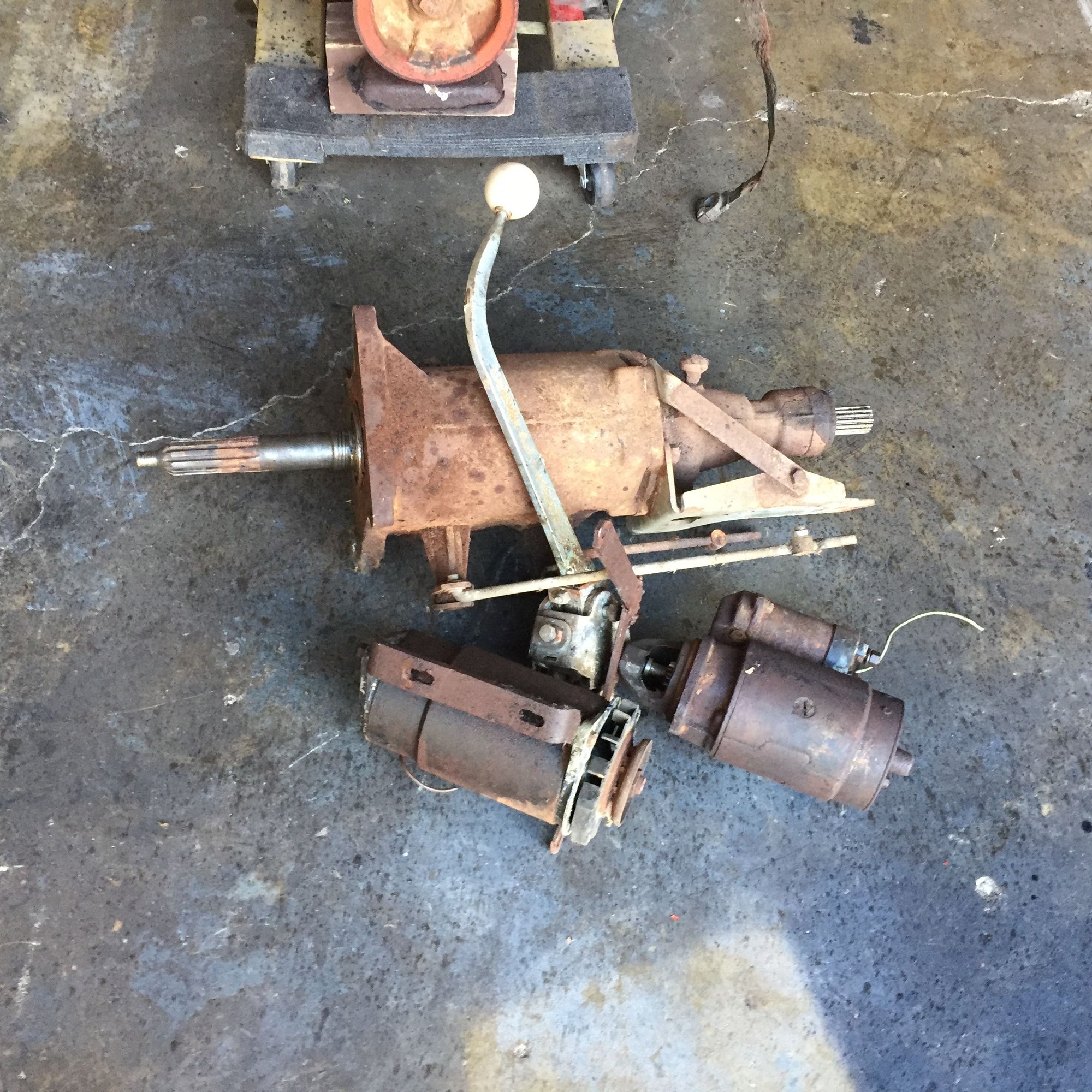

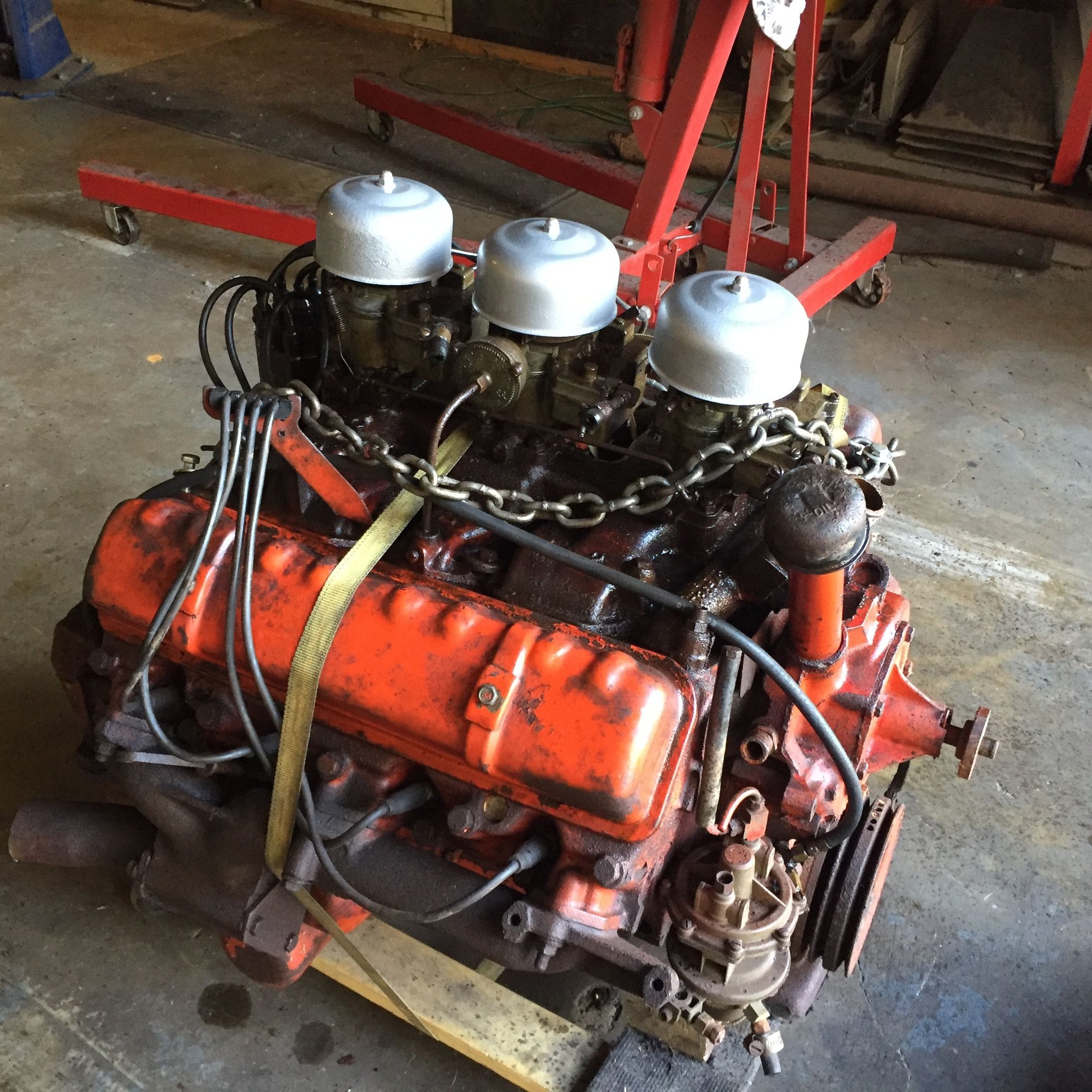

This is what I picked up. J2 and 50 Olds trans out of a 49 oldsmobile drag car. Engine appears to be early 57. Real nostalgia
anyone recognize the rockers, springs, are the stands 1.5?

Looks like you have some sort of dimpled valve covers on it. Does it have adjustable rocker arms ?

Oh Boy. I bet it does. Waiting for for you to pull a valve cover. Does the engine run?

It does have adjustable rockers. It is a pure builder. Turns over
ns

What a great find.
Camcraft Cams in Canton, NC makes great cams for them
https://www.camcraftcams.com/

Thanks, I am especially interested in the cam. I am thinking of degreeing it in the motor to get a sense of what it is. The race car it came out of had Jahns and iskenderian stickers. Hope it bodes well for what I may find.

Jahns forged pistons were quite popular. They had "domes" that bumped compression ratios up as high as 12.5 to 1. Isky sold a lot of cams back in the day. My friend preferred Engle solid lifter cams in his J-2's.
CamCraft has a nice cam about 270 degrees (advertised duration), .495 lift that works well.

Solid lifter?

Hydraulic I think.
