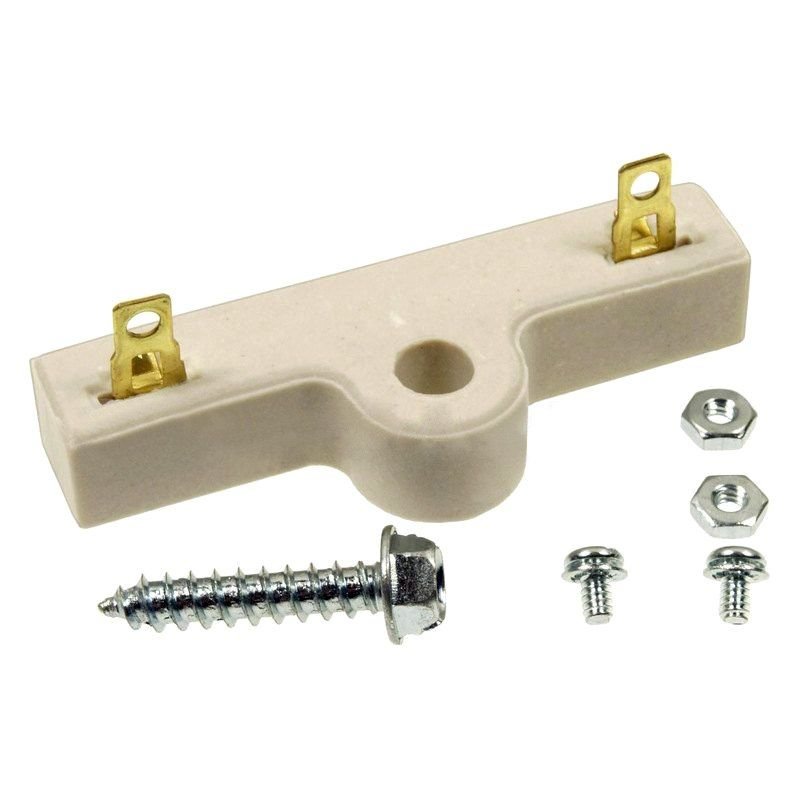

Hi all. I have a ceramic part with electrical passing through to my ignition coil, thinking it must be the voltage regulator. However, I can't find any photos to verify this. All external voltage regulators I find are the typical black box type. Do I have some ancient type of regulator or is this something else?

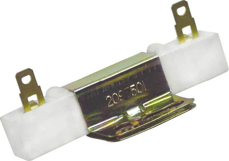

Um, you do realize that the voltage regulator doesn't connect to the ignition coil, right?
I suspect the item in question looks something like one of these?
Those are aftermarket ballast resistors. They are not factory installed. Someone added this to replace the factory resistor wire built into the harness, apparently.
