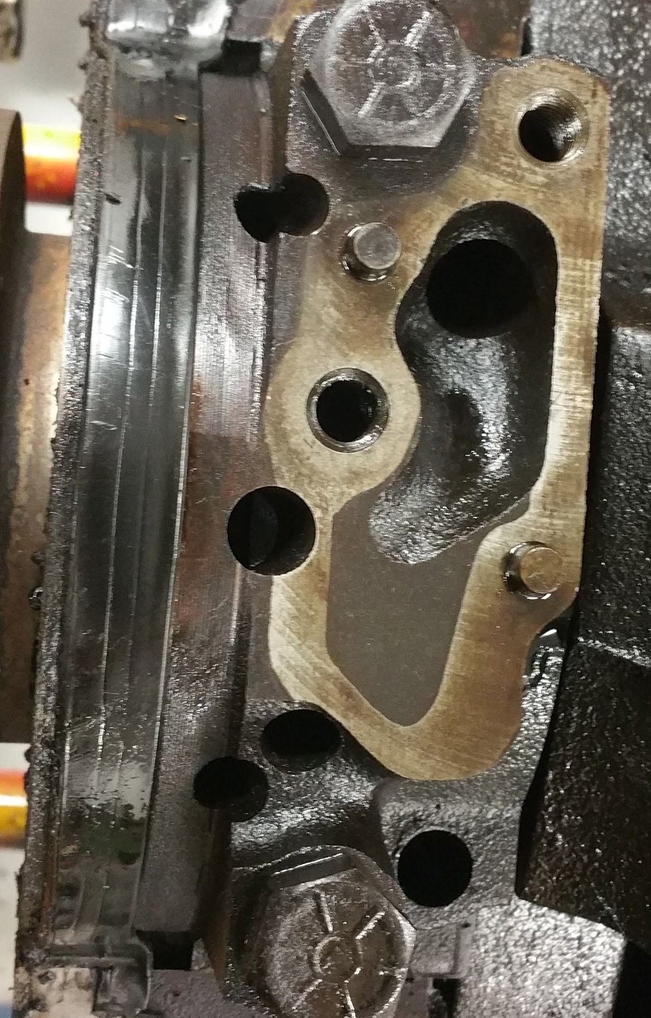

The rear main cap on the Oldsmobile engines has an oil drain back passage for the rear main seal. This passage sometimes interferes with the oil pump to main cap seal allowing oil pressure to return to the oil pan causing low oil pressure. It is my understand that Melling has redesigned the oil pump mounting flange to correct this, but it should still be checked. Because of the nature of performance engine building , once an engine is labeled with " poor oiling system" it is very hard to change that opinion. So it is my opinion that in the past the rear main cap issue caused oiling issues in the Oldsmobile engines forever branding them with having "bad oiling systems" leading to many necessary oiling modifications. From what I have found the oil drain back in the engine needs attention. Other than that, just the normal engine building techniques. Just my thought.

A few weeks ago I scored an unmolested 1974 Olds 455 at my local pick and pull. Here are some pictures of the "oil pressure Issue" that may have cause the 455 to be branded as an engine with a poor oiling system.

Olds Oil Pump

That probably doesn't help. Most of the failures I have seen on here and knowing guys who owned the 455, much less with the smaller main 350's, is improper machine work or too tight of clearance on the huge main bearings. Also factory soft rods, so so bottom end that can flex with the heavy parts flying around all lead to disaster. Olds didn't design the 455 to be a high RPM motor but guys have made it work with the right parts and machine work. Cutlassefi tested the OB4, he thought it was a terrible design and the Dyno numbers showed it. Nice car, enjoy.
