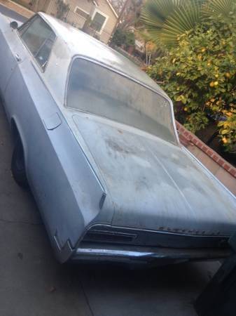

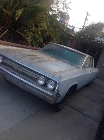

Thanks for all the welcomes. I had done a little research before purchase and figured out the main specs. Was very disappointed when I found out that the "bad engine" was no longer with the car. Seller claims it had a cracked block so he scrapped the whole thing. I mean, heads, intake accessories... everything! I'm getting over that but don't know where to go from here. It is in poor primer and has appeared to have some rough bodywork in the lower 1/4s. A friend went and purchased it for me and I'm driving to get it tomorrow morning (2hr drive). So as for plans, it really all depends on what I find. My friend facetimed me while he was with the car. Seems to have the factory exhaust which I thought was pretty cool and a trans that us chevy guys could only identify as not a th350 haha. Definitely console shift auto though. Power breaks and steering. Trunk contained a lot of small stuff. But the factory air cleaner was in there! So if its in decent shape I may paint it the factory color which I'm still unclear of and see about getting an appropriate engine. No clue where I will get the right one and I'm not quite enough of a purist to look too hard. If its rough around the wheel openings I'm not going to do a ton of sheetmetal work. I'll likely tastefully radius the wheel wells and go a bit more hot rod with it. 60's stock car feel.

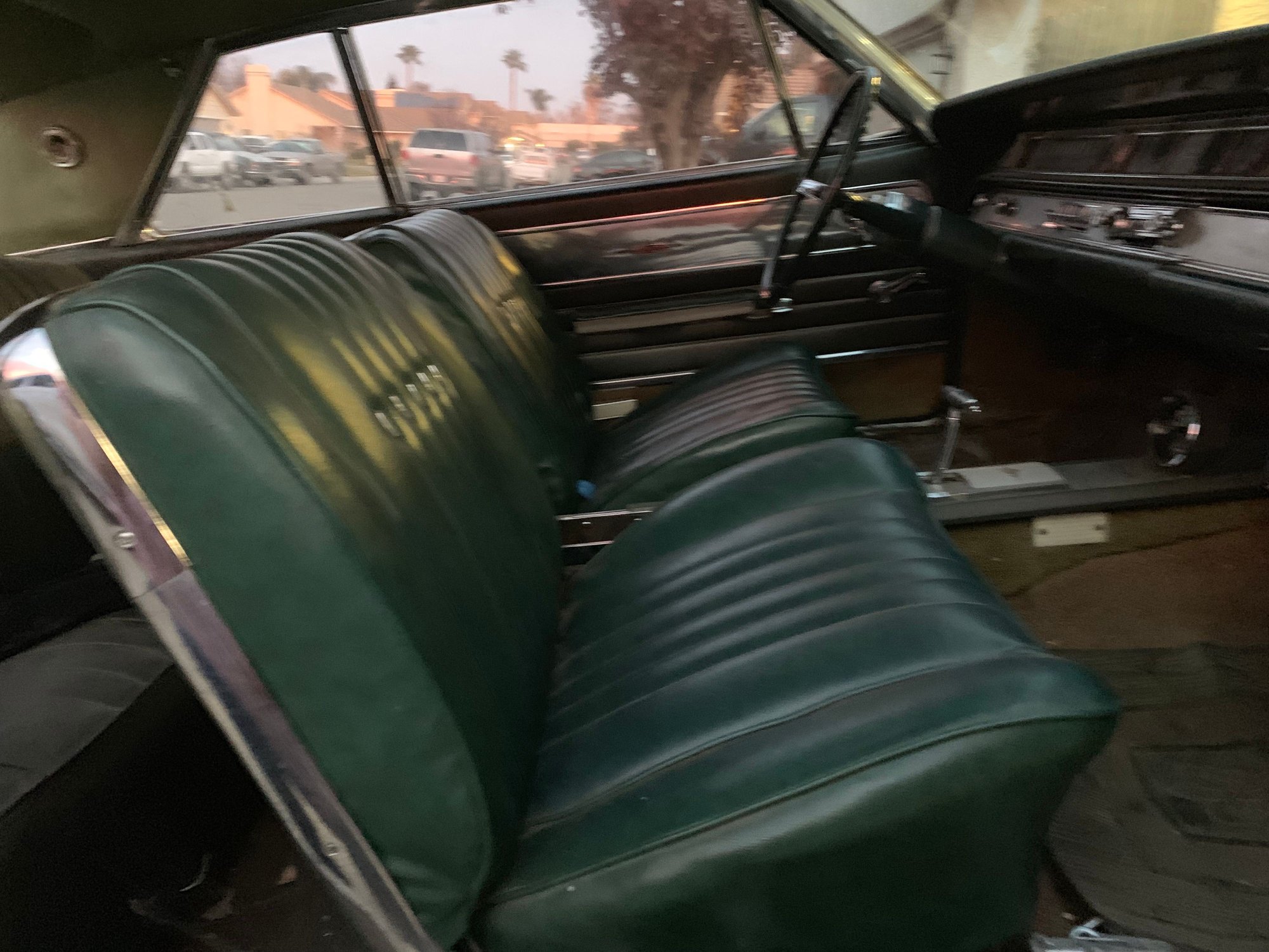

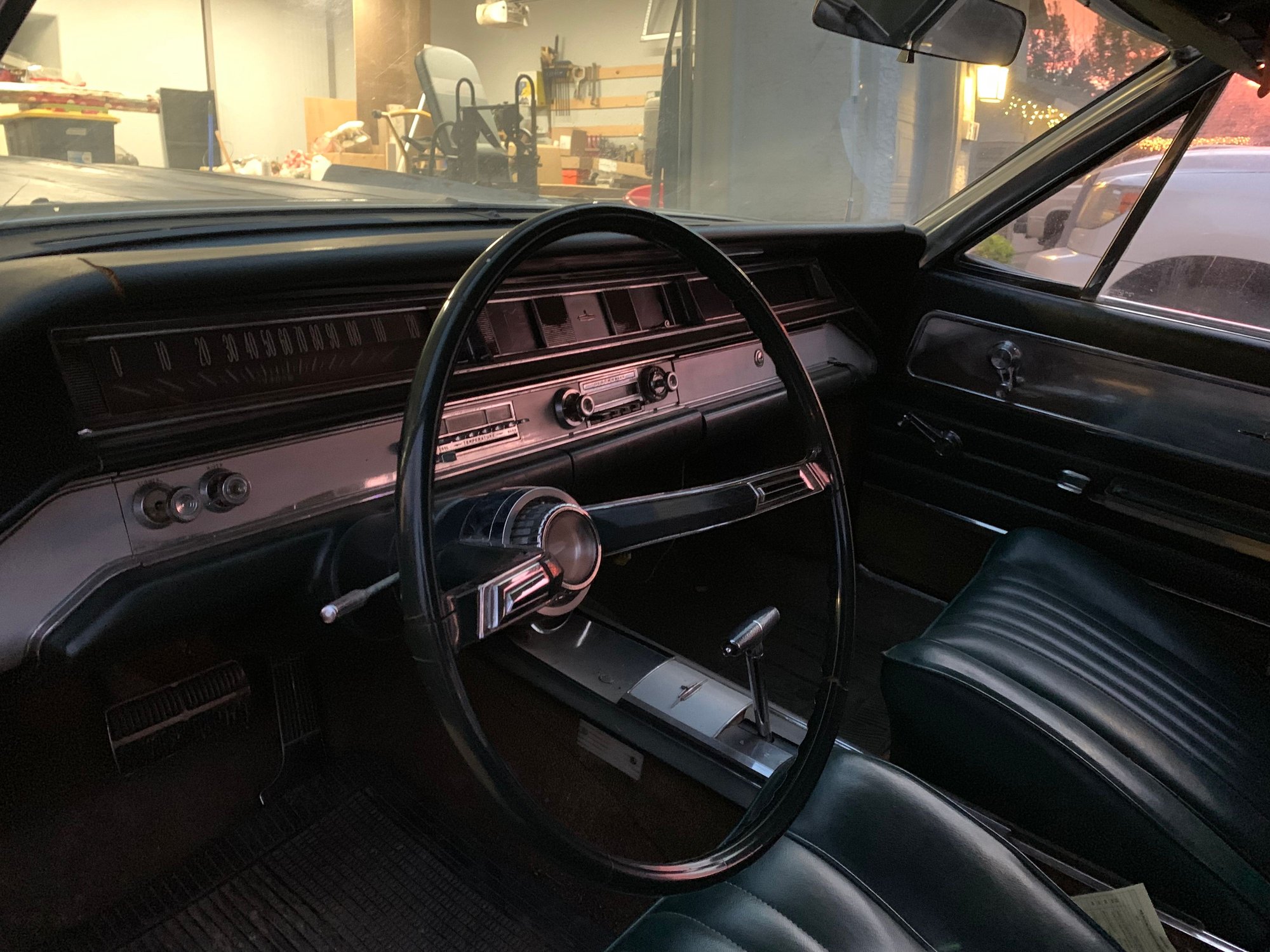

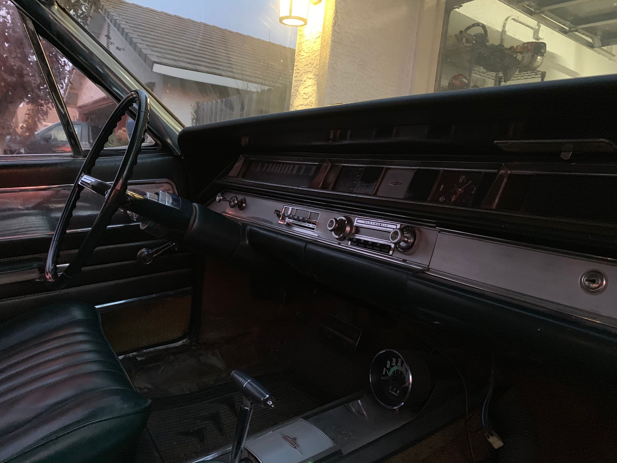

Pics
Dash complete
Front buckets nice

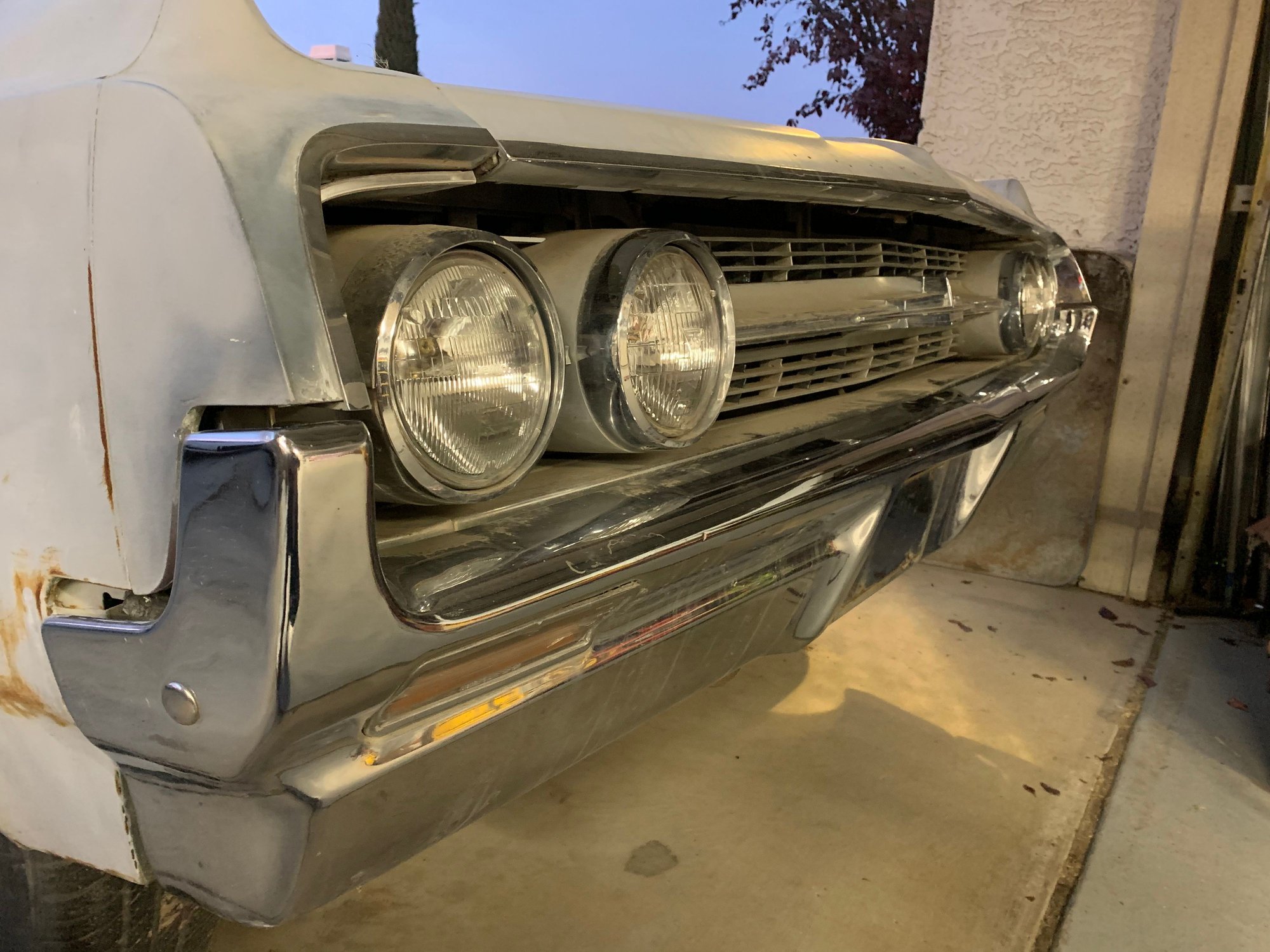

Immaculate grill/bumper

Wow ! Once you get it cleaned up , mechanically sorted , and painted you will have a sharp car .
Looks like carpets may be all that's needed inside .

Look on data plate underhood and we can determine original color. With the dark green interior, probably white, one of the two greens, or gorgeous Tahitian Yellow.
