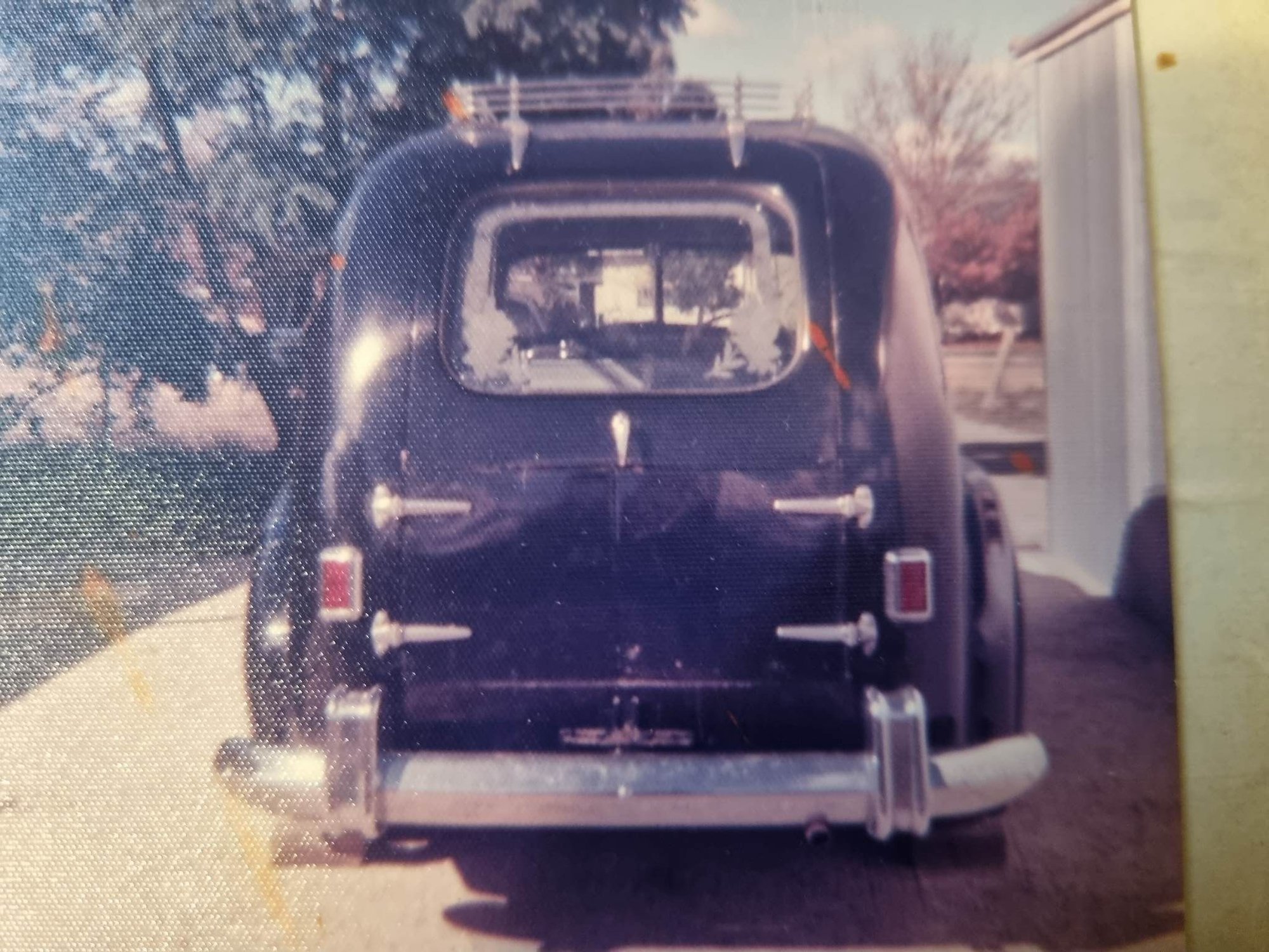

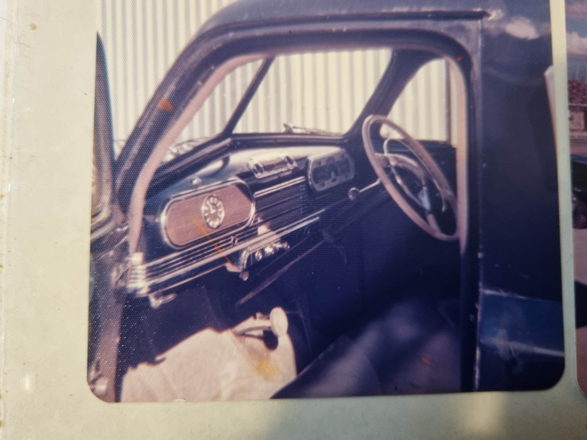

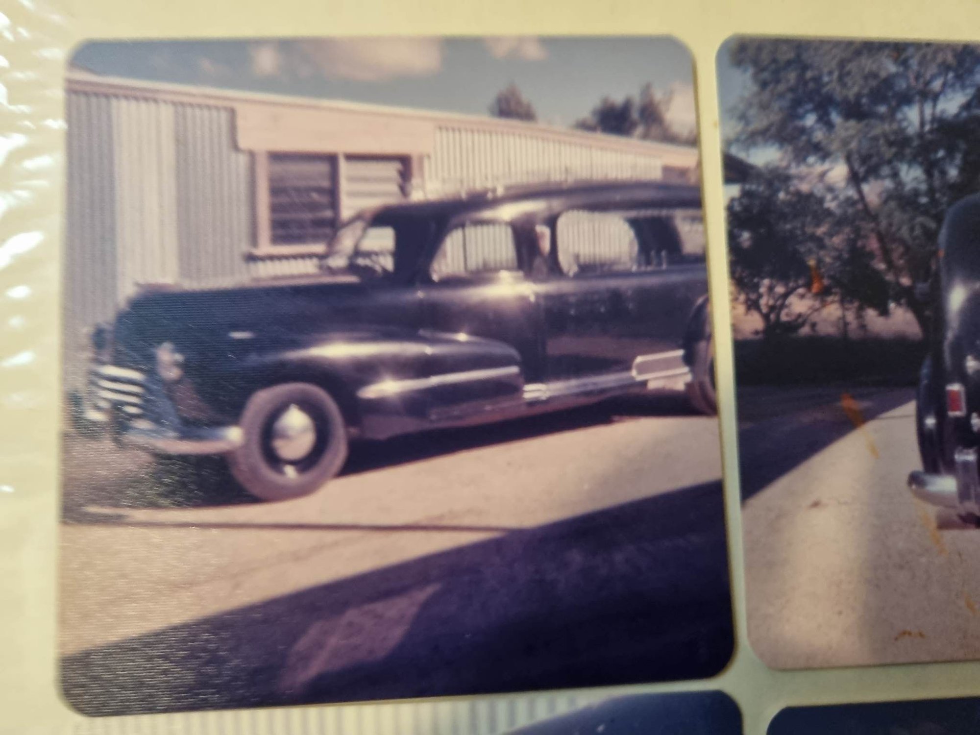

Bonus photos from the funeral home in 1977!
To this day, 46 years later the clock hasnt moved an inch!
Chrome was a bit nicer! My friend and fellow hearse enthusiast took these photo's and was offered the car for $1600aud in 1977 from the funeral home.
