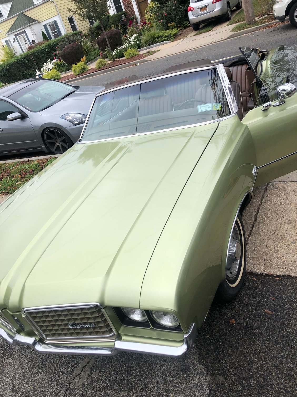

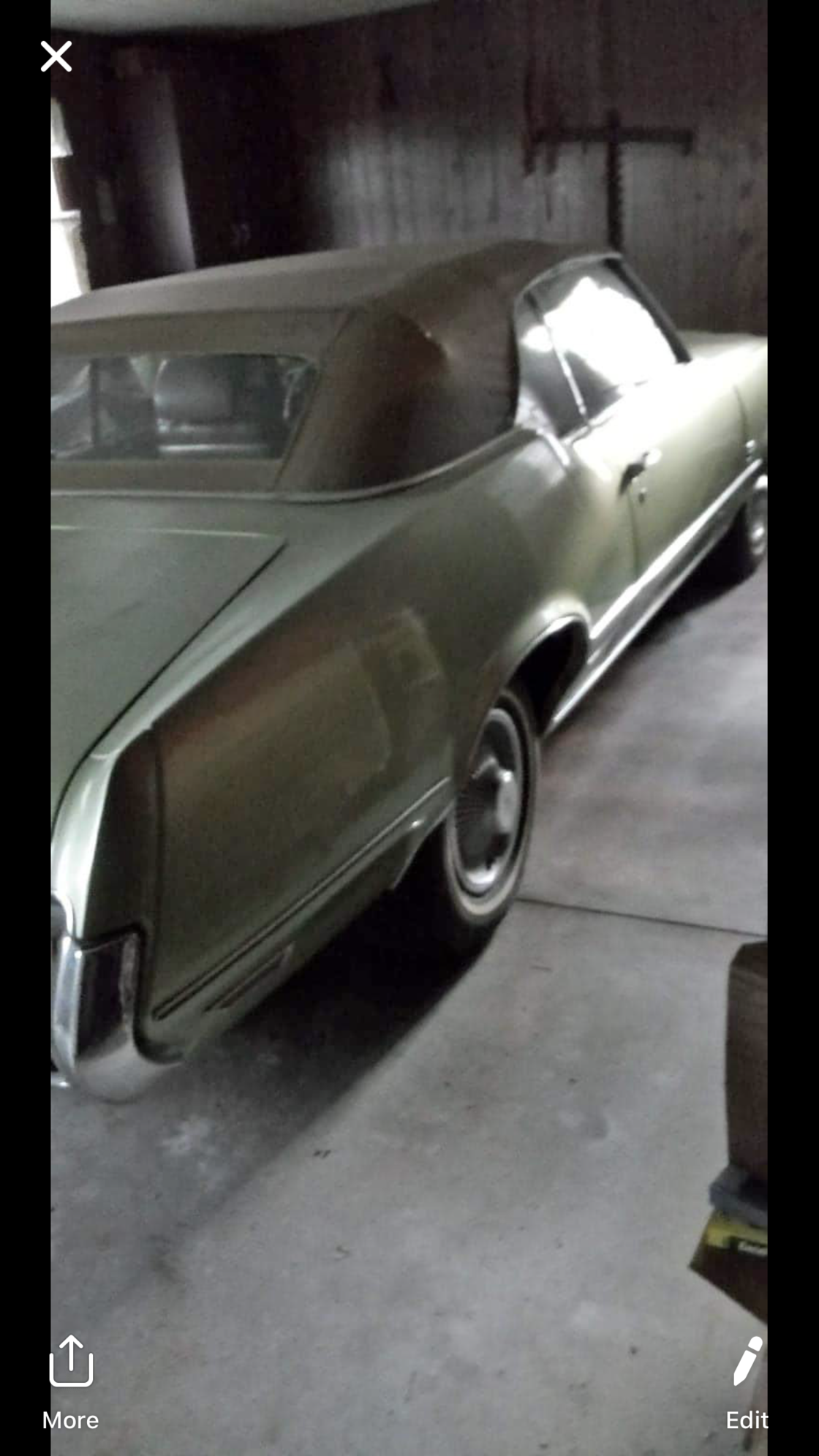

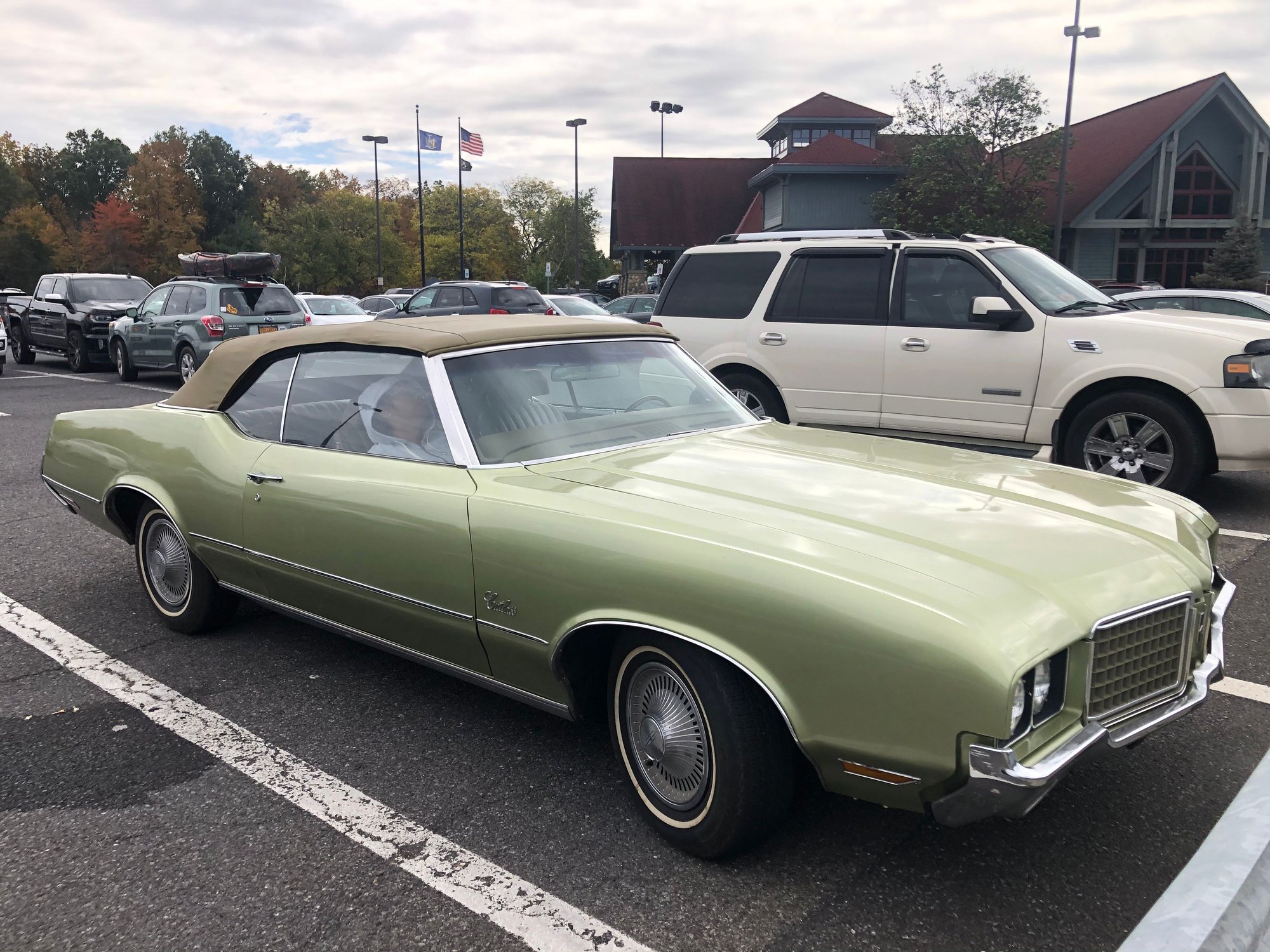

Good day gents...looking for a little help in a possible future purchase...So I’m interested in possibly purchasing a 1972 cutlass convertible...I’m far from knowledgeable about these models...I’ve read a lot of information that you guys have posted and I really fell in love with the style of the early 1970s models...I think I’m ready to pull the trigger on one that I found...it has 160k been garage keep as far as the info I received...and I have pics...asking price is 6k and it’s currently registered and driven...any input would greatly be appreciated

Welcome to the site. Although your pics don't really show much $6k is probably a reasonable price. What about mechanical history, do they have maint. records?

The first input I'll give you is that you need to post MUCH better photos if you want a meaningful response.

Not the best pics but what I can see if there is no frame or floor rot it’s a good buy. Mechanical issues never worry me, don’t know about you but it’s body/chassis rust that’ll kill ya. Fender misalignment might indicate rusty lower section but needs eyeballs. Repaint? What’s under it? Looks like a presentable car with drop top, buckets, console, etc, see if you can get some help from someone knowledgeable to check the car over & if no big issues drop the money & acquire what will likely be a fun driver. Even if you have to put a few bucks in it you won’t be abused.

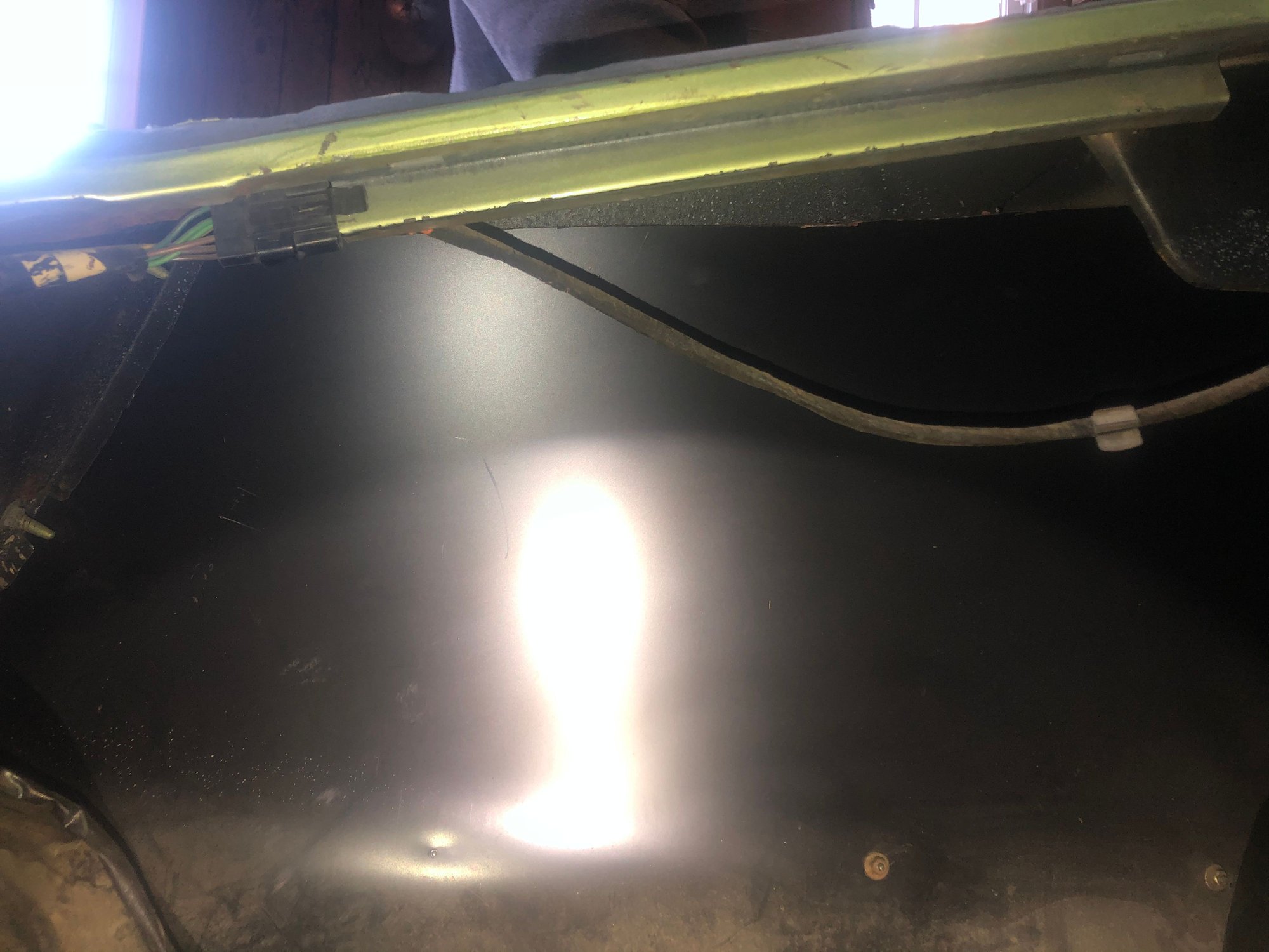

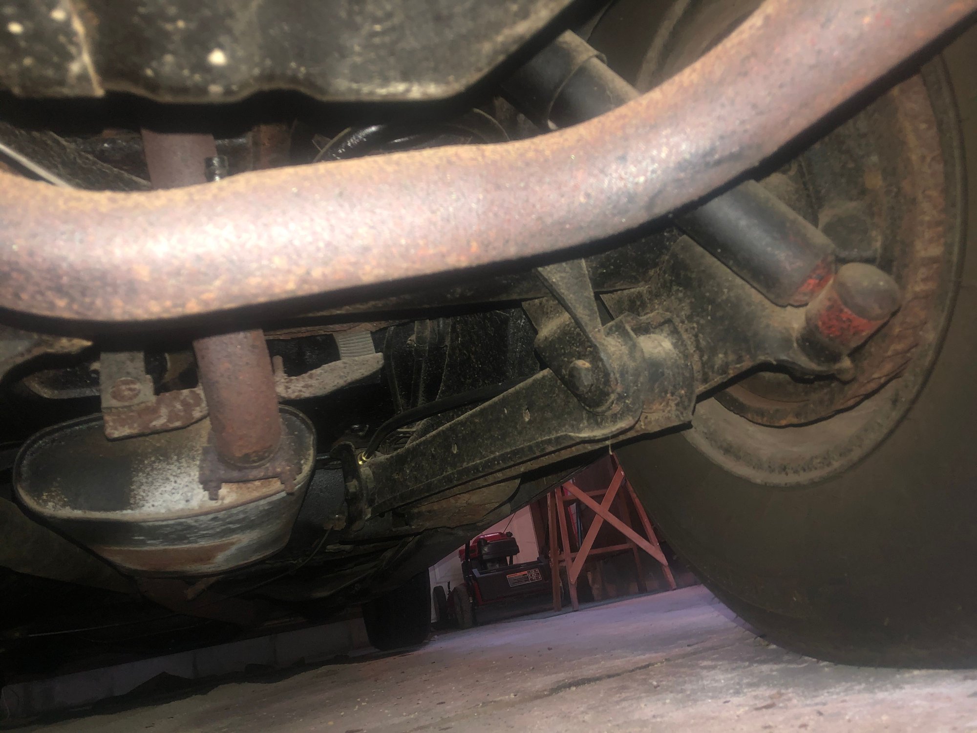

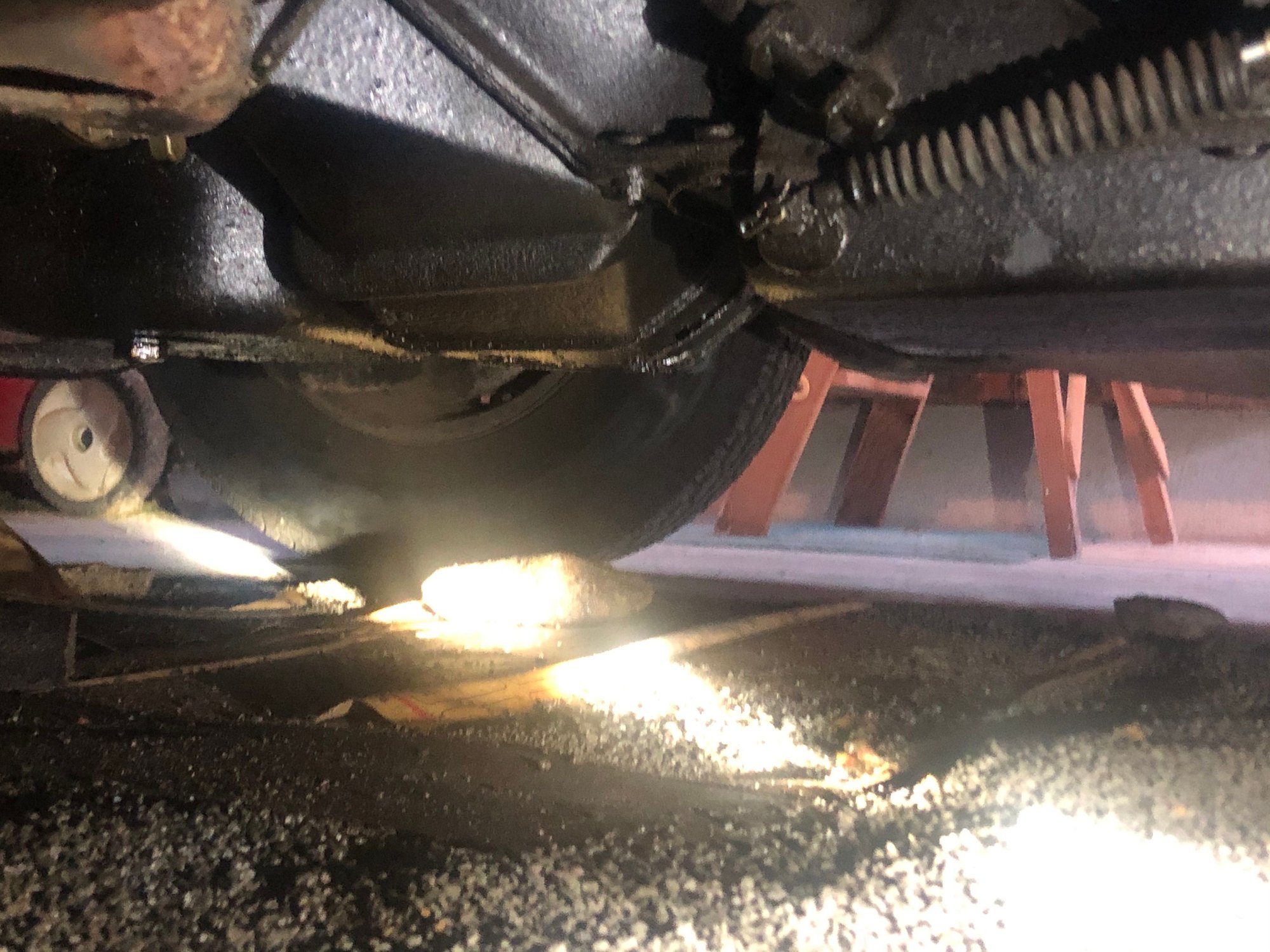

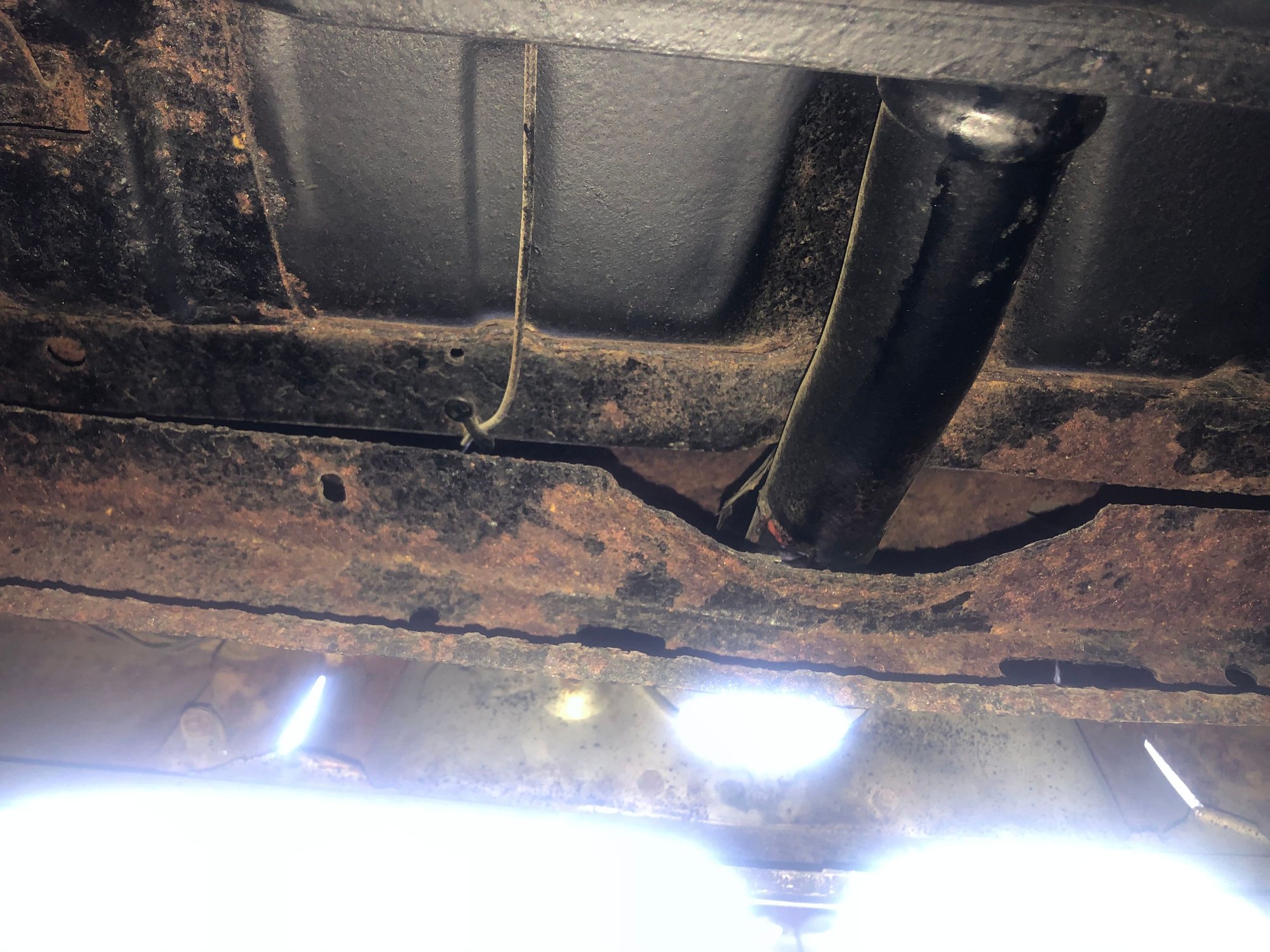

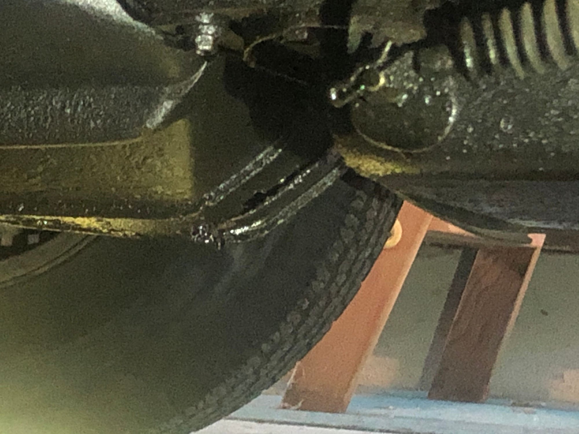

Ok guys here’s the update...not sure if this crack is normal
Old Oct 11, 2019 | 05:10 AM
Posts: 18,133
The pic is quite difficult to make out. Is that the passenger's side frame near the transmission? Was the crack a rusted hole? Other than that, how did the car run?
Old Oct 11, 2019 | 05:39 AM
scrappie's Avatar
Posts: 3,442
From: eastern MA
I can't see for sure but it looks like the trans inspection cover? (plastic). If thats cracked its not a big deal and easily replaced in a few minutes. Maybe just bottomed out on something or caught on low ground?
When you say up north where are talking about? maybe someone on here in the area can help?
Old Oct 11, 2019 | 06:02 AM
scrappie's Avatar
Posts: 3,442
From: eastern MA

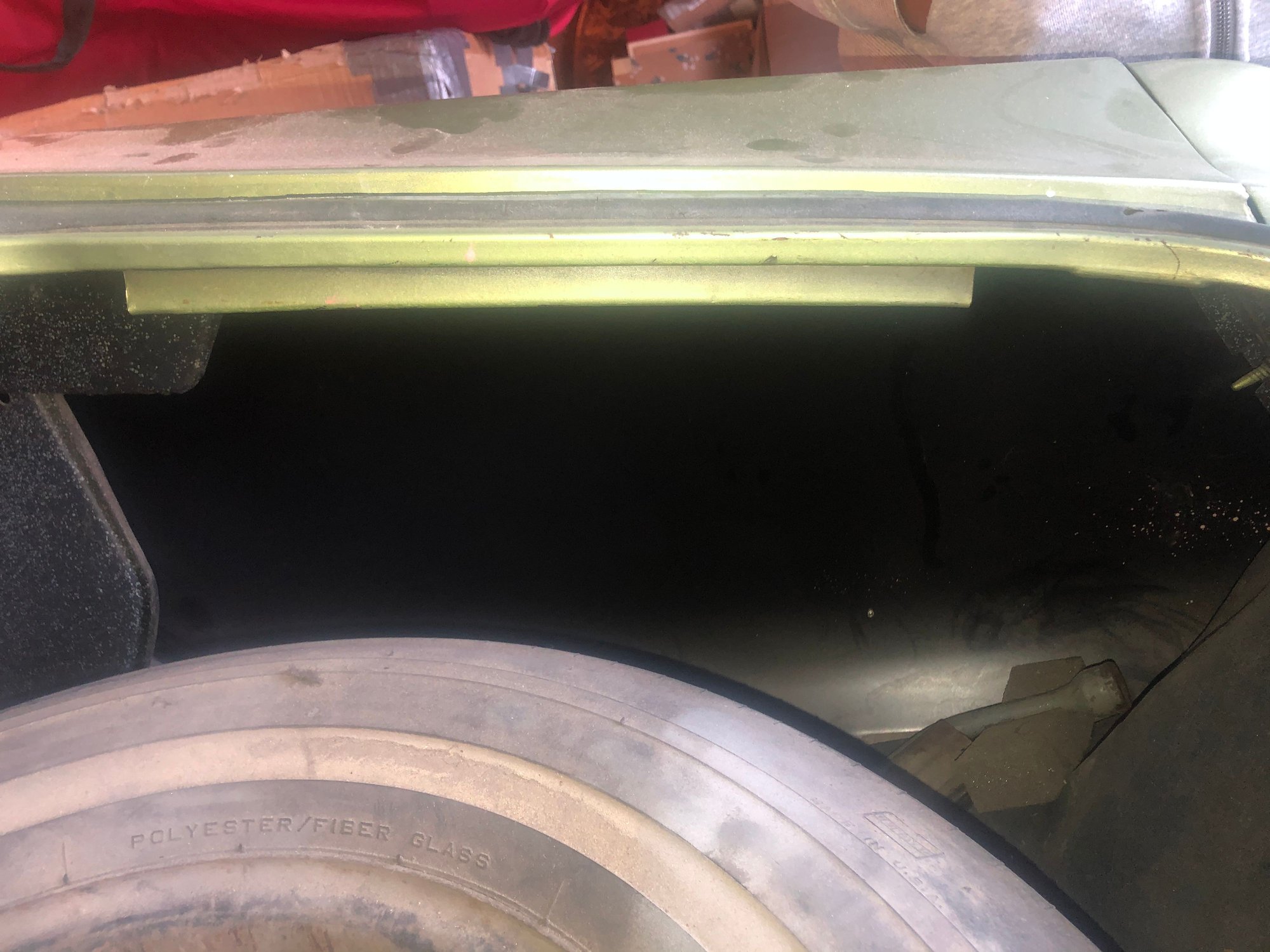

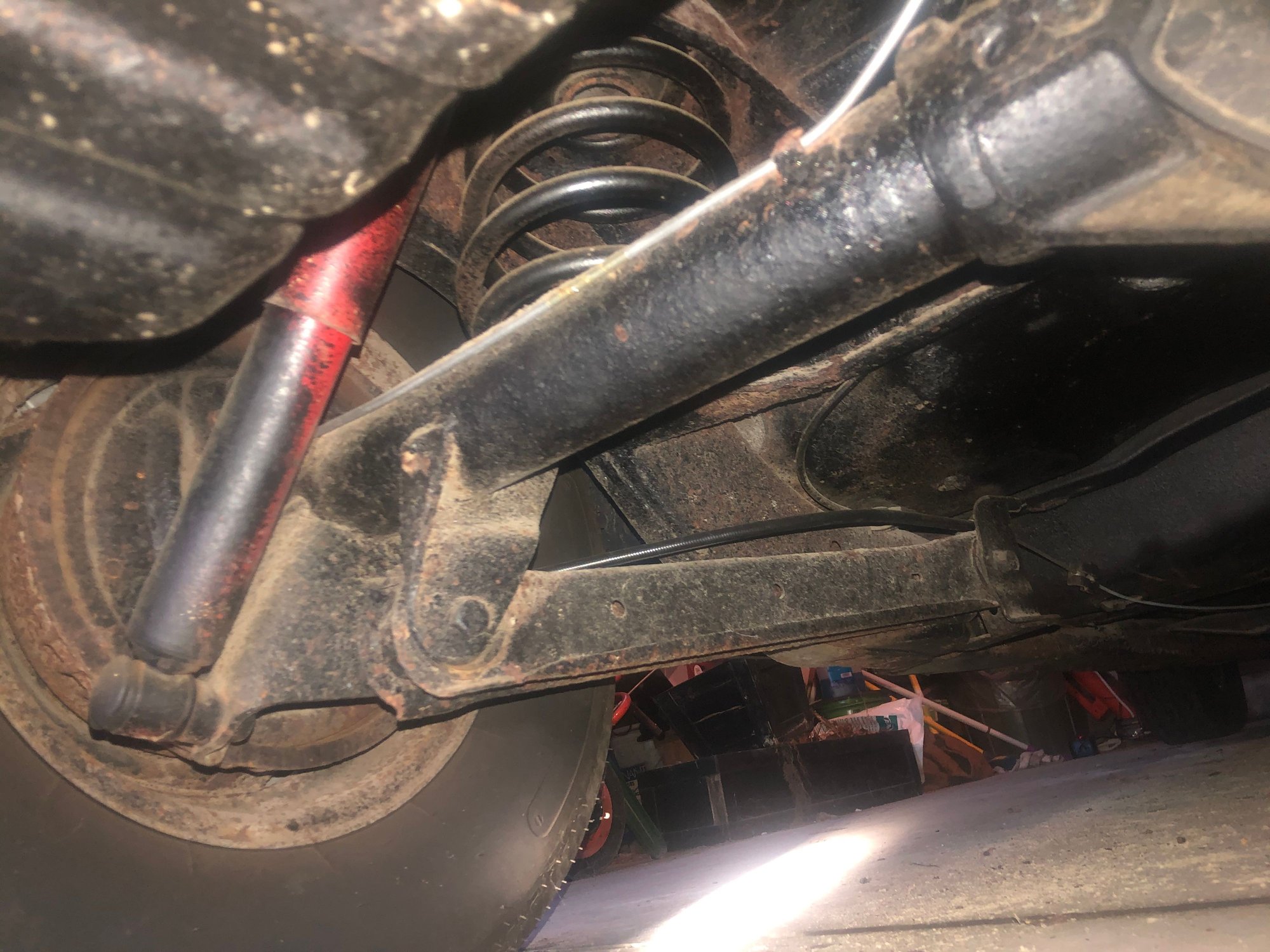

The circled area is the metal boxed frame. I would inspect the whole frame on the car for rot, heavy rust or cracks. In the trunk up above the wheels is a common place to look for body rust and rot. You really need a knowledgeable eye for these cars to make a good decision. If no major rot, rust or cracks? $6k is a good price but you have to know what your looking for. Mechanical issues will cost $ but nothing like rust repair and body work.

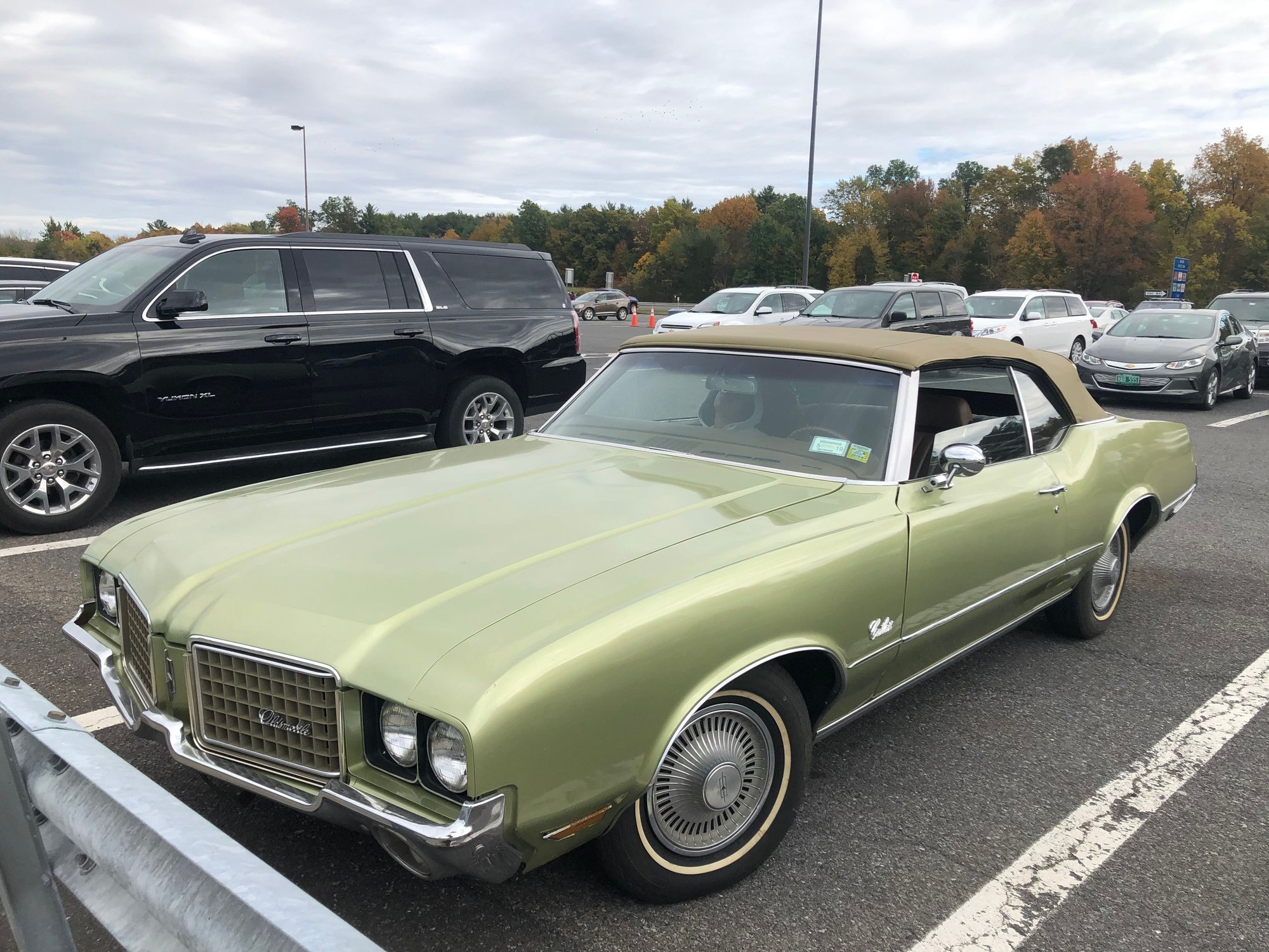

Going by pics looks like rear quarter or quarters have been replaced. The job doesn't look like A+ since you can visibly see the seam. Car has been repainted obviously so there is filler and what its covering or hiding is not known. The rear of frame looks like typical 48yr rust prob Northeast or midwest car? Undercarriage has been painted or undercoated so that could be hiding a lot also. 1972 convertible with ac built in Lansing MI. Car has a dual gate Hurst shifter which is pretty desirable in the automatic cars. Id look closely
Old Oct 11, 2019 | 09:06 AM
Jdapokergod39's Avatar
Posts: 18
Quick update! I’m driving her home!! 3.5 hour backs home and she drives great....ended up paying 5k flat
didn’t get any maintenance records because it was an estate sale and they didn’t come across anything as yet...but it’s a one owner original car!! I will update once I get her home safe...you guys are great thanks again for all the input and info

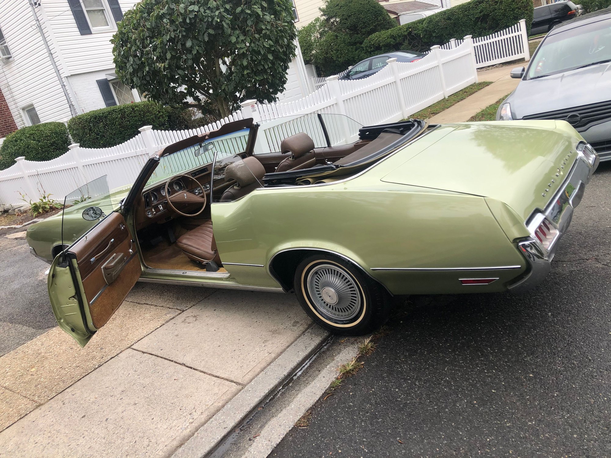

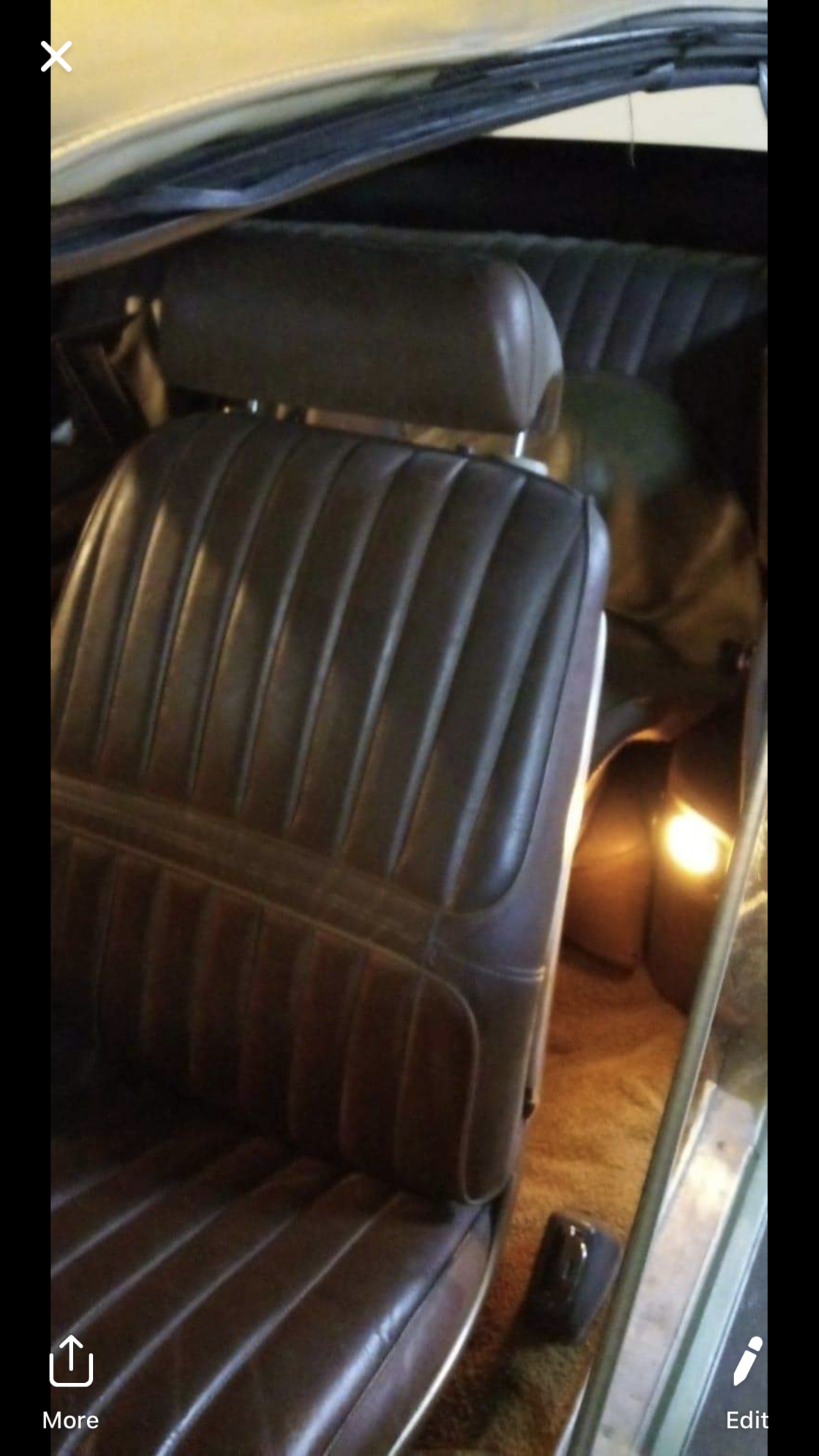

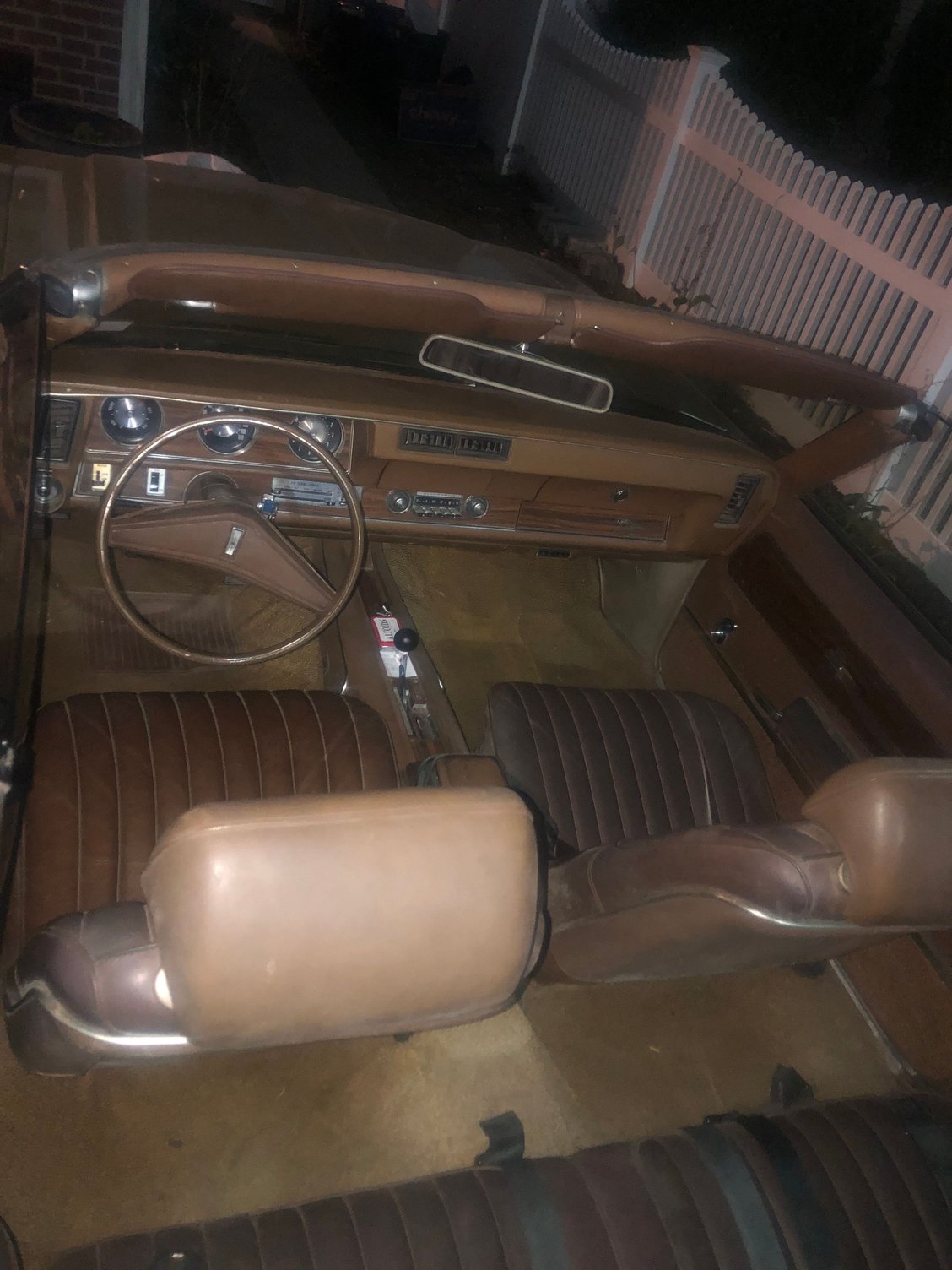

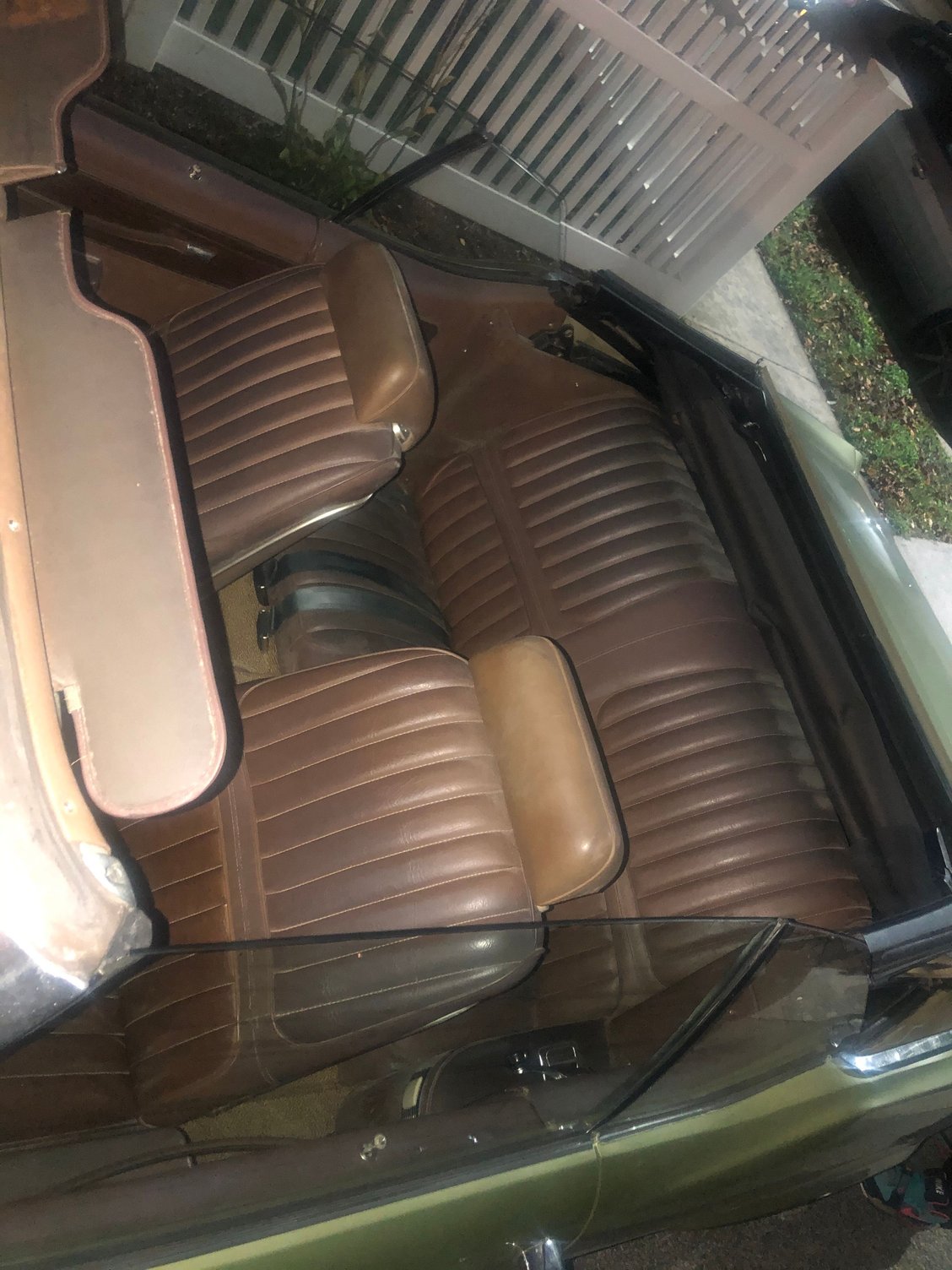

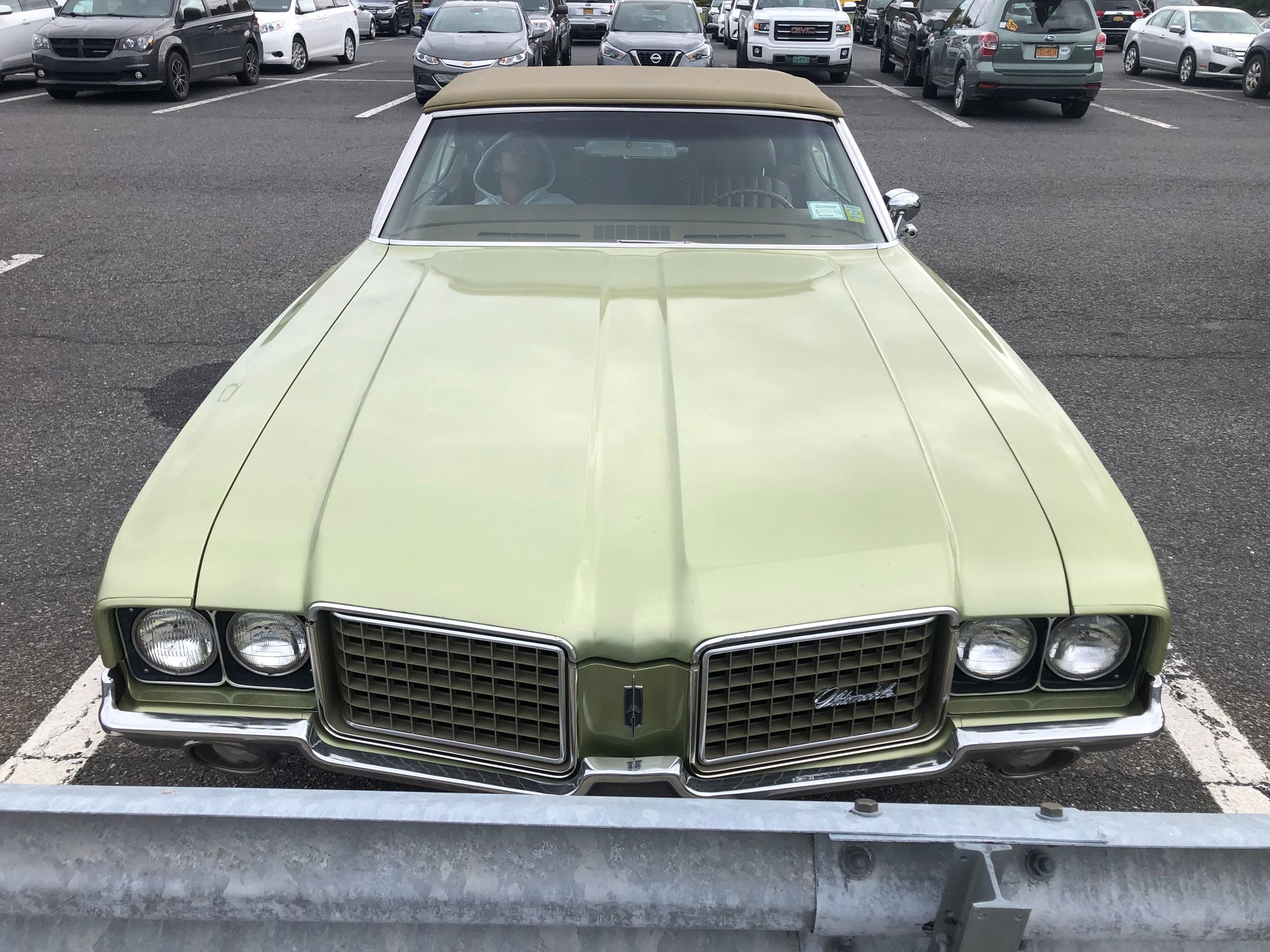

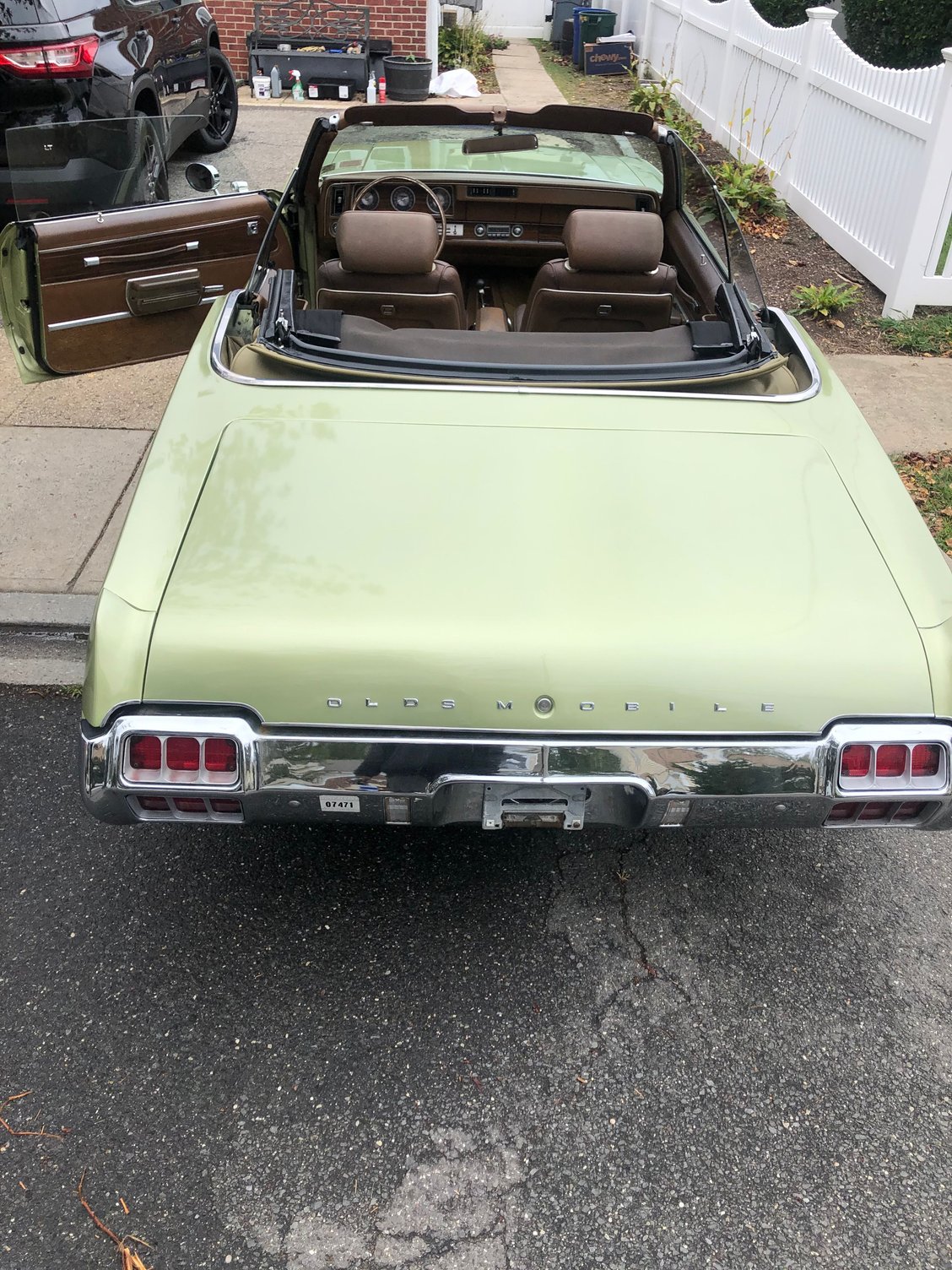

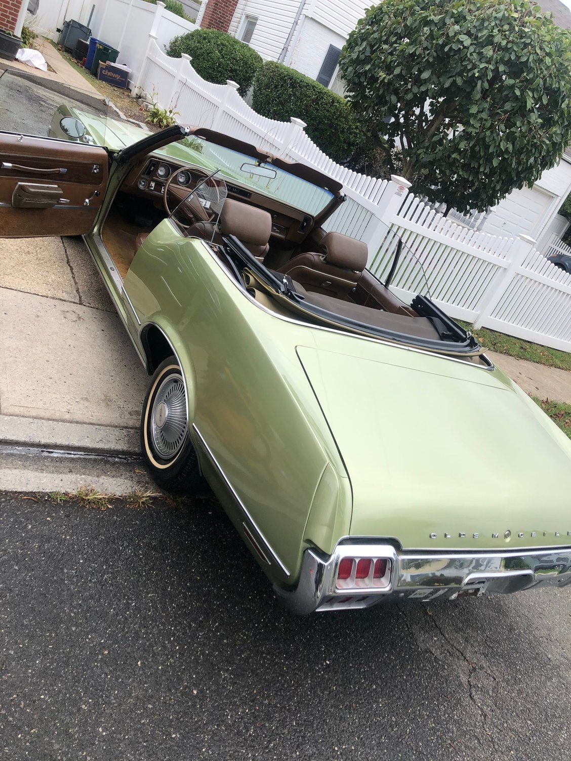

Got up n out early while it was cloudy and cool to wash her up...was able to clay, wax and clean the interior...came out great

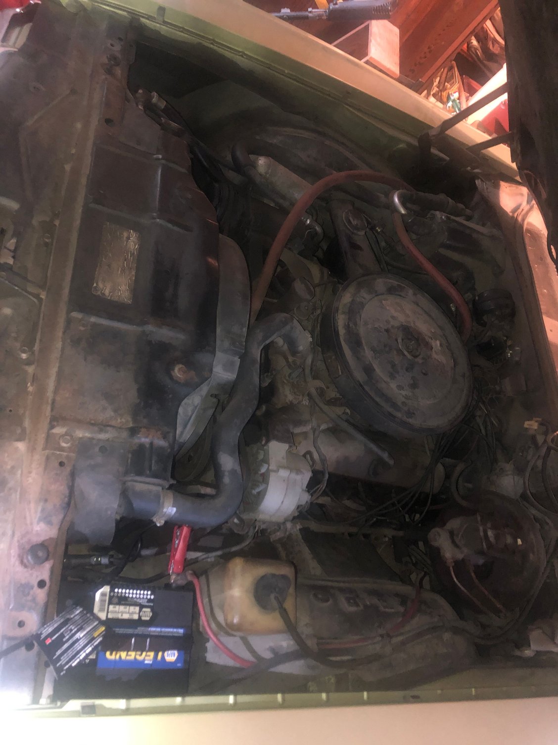

starting checking for what needs to be addressed and I’m gonna create a small list to start with...since I couldn’t locate the maintenance records I’m gonna start with a basic tune up (plugs, wires, distr, gaskets, oils, a.c. Compressor, weatherstripping through out, and floor shifter gives problems sensing park)
im sure I missed a few but I will try my best to update in a new thread....here’s the last of the pics for this thread! Thanks again guys you really made things possible for a novice like me with the generosity in all of your post...we read, listen and learn most of what we know thru this community...much respect!

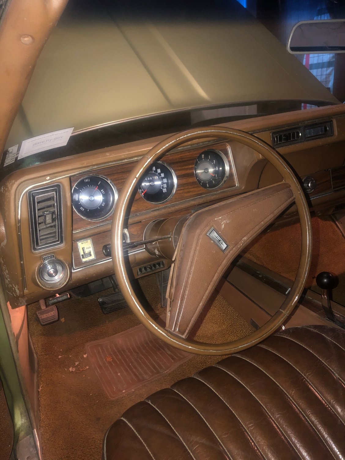

pics of interior were prior to cleaning btw...forgot to take after shots
Old Oct 12, 2019 | 03:39 PM
Posts: 18
Forgot to mention I realize this model has a thermometer by the mirror...so cool! Also the floor shifter has a 3-2-1 manual option...can anyone explain it? Lol pre triptronic

The shifter is a Hurst dual gate. Which was available on these with the console. Some people call them "his and hers" shifters.
Oh yea, we need after shots! Looks like a nice solid old car. Enjoy.

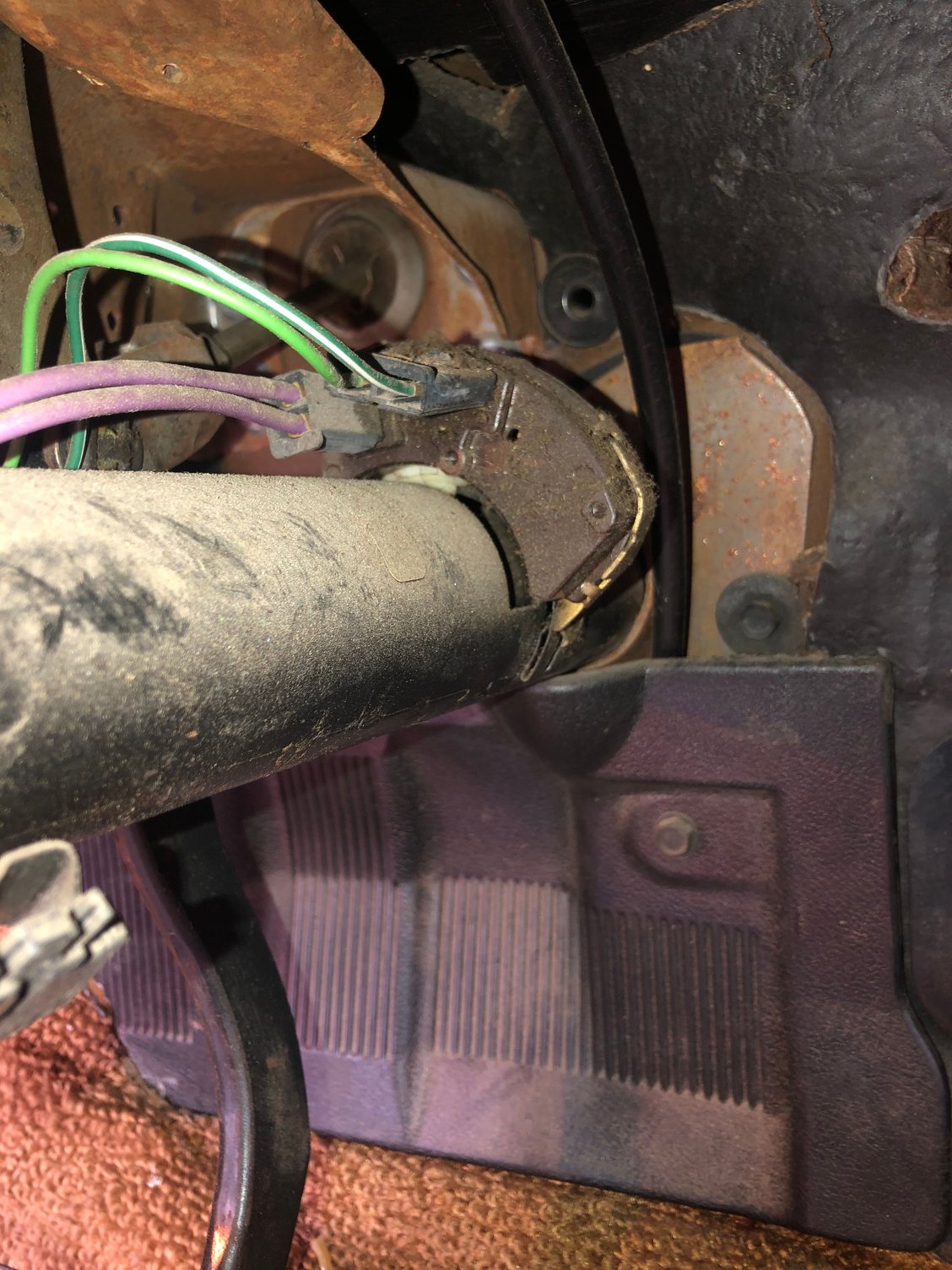

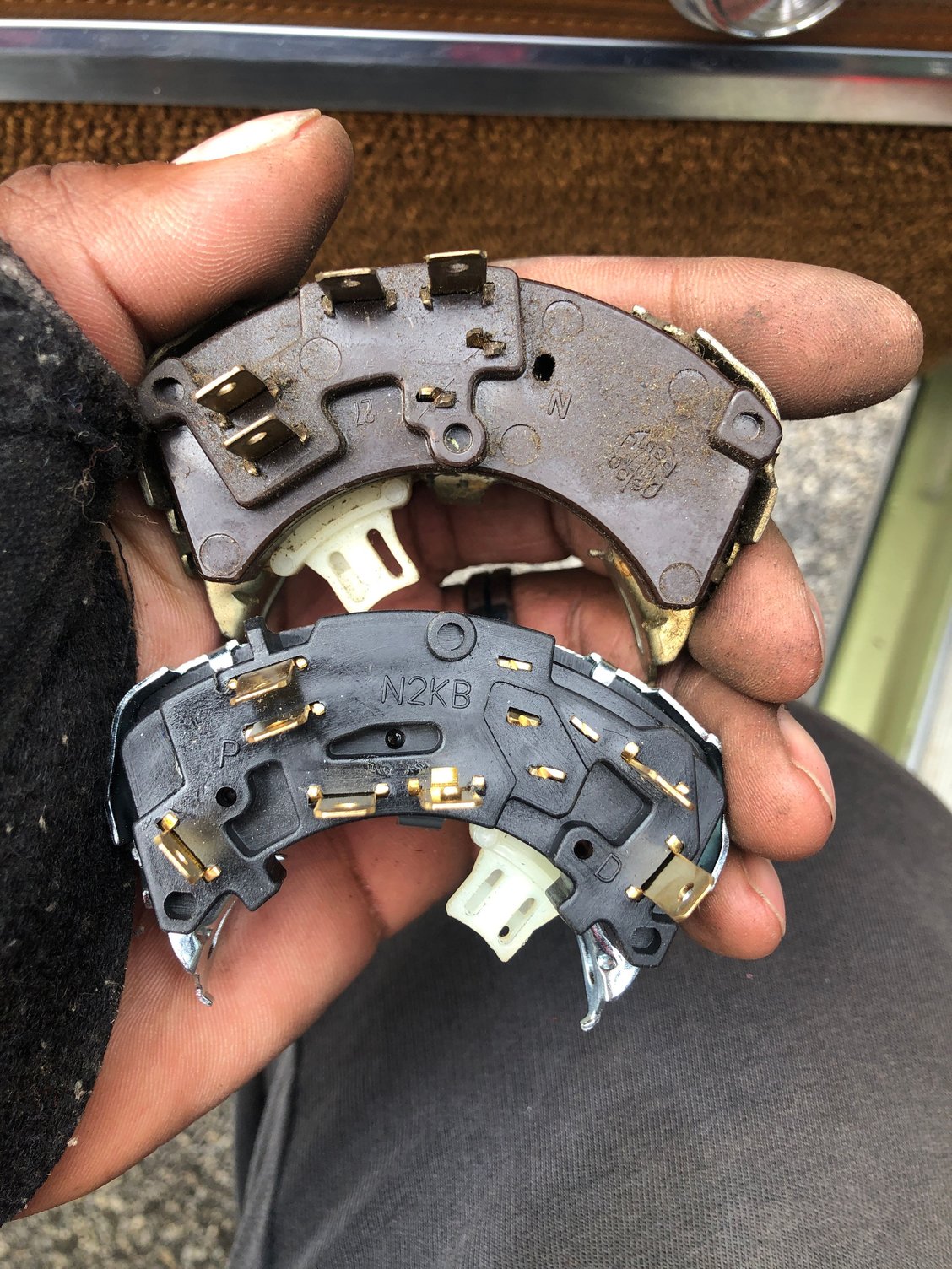

Gm
took the neutral safety switch out
The new one I got doesn’t look the same....it’s got the same make up but contacts are in a slightly different orientation...
Guessing it’s because it will work for different models...
any input?

Yeah, that's a later model one-size-fits-all switch. It will likely work fine, but be sure the contacts actually engage at the correct shifter positions. Or, you could just get a correct one.
