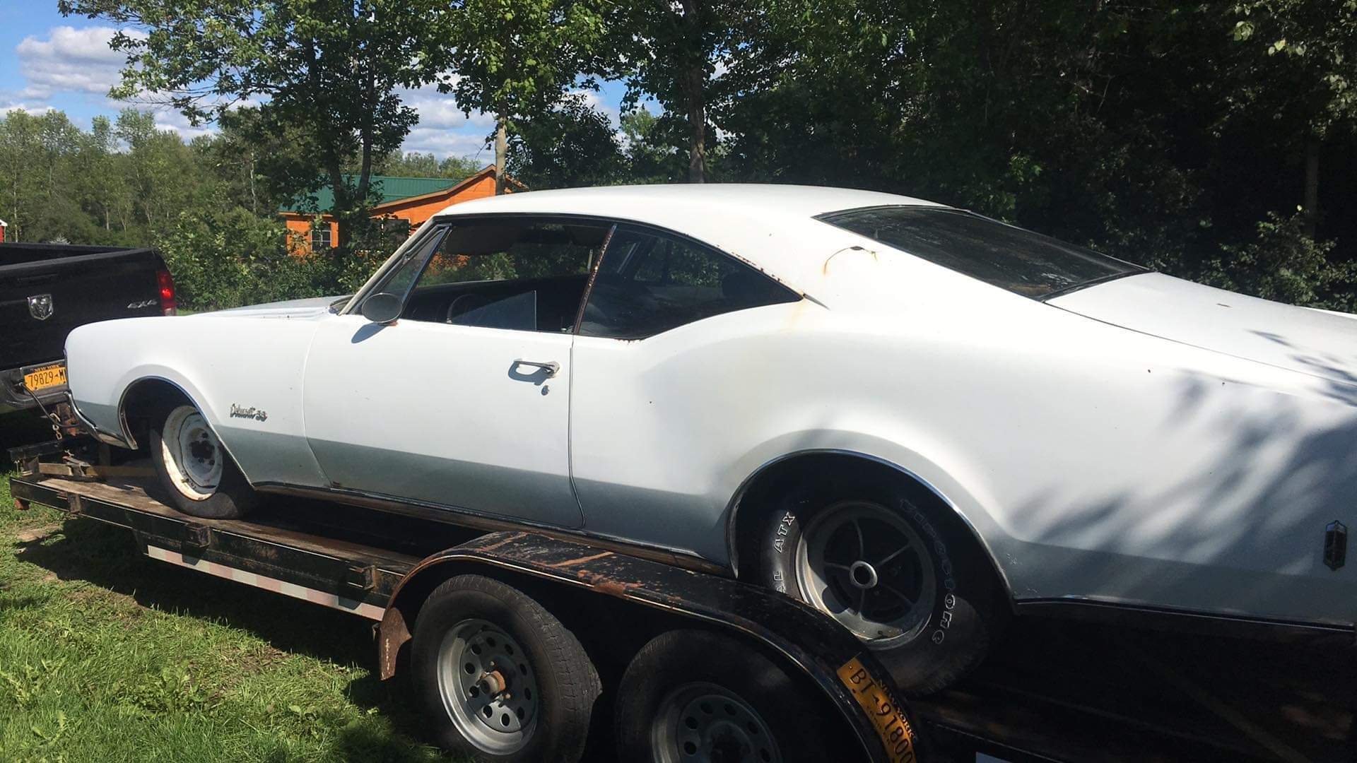

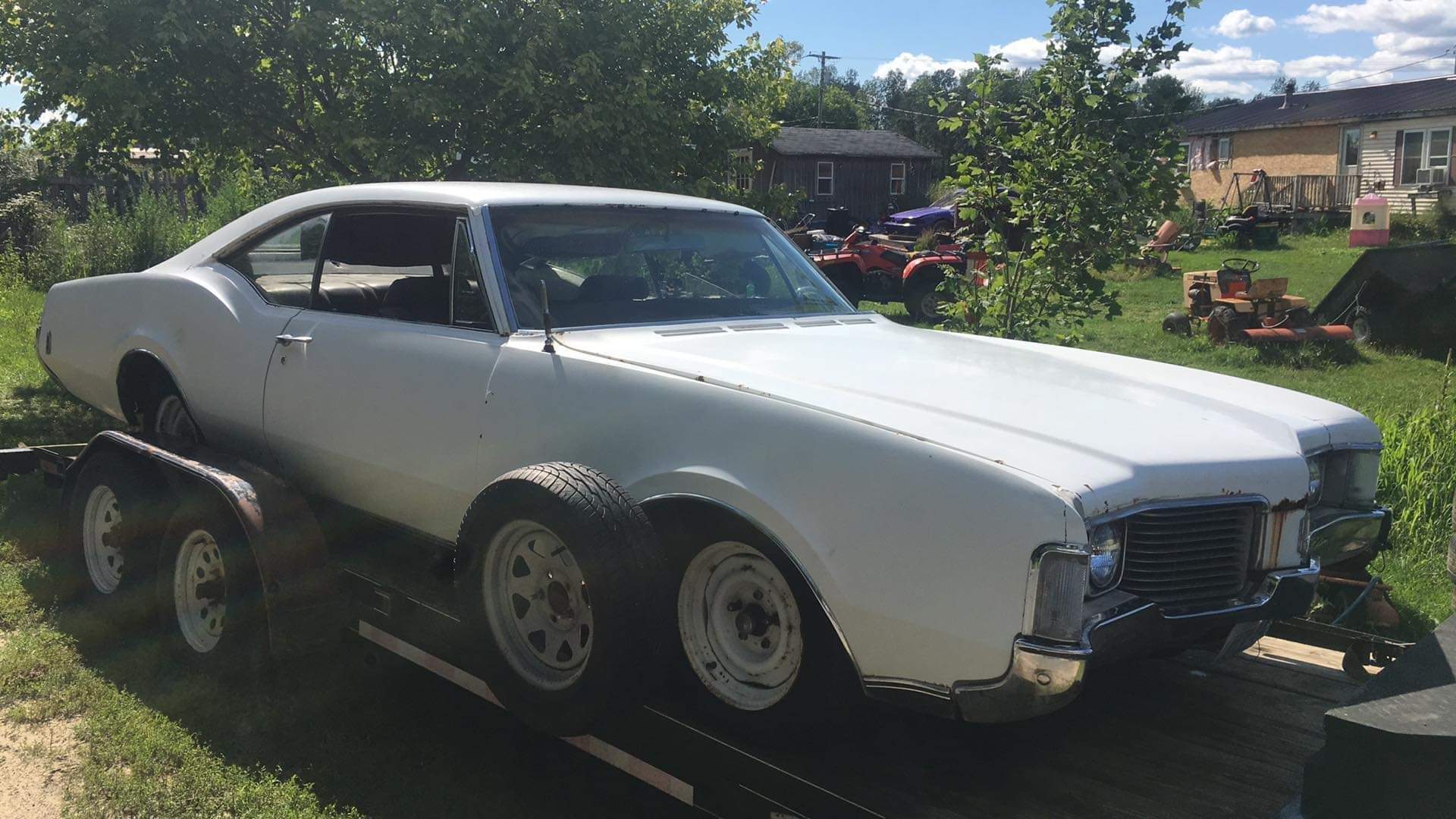

Hello all. Just picked up 68 olds delmont 88 for father son project came to site for help points and tips. I'm Chevy guy all my life this car came up from high school friend. I know its history. My 13 year old loves it so hopefully one day will go to him

Welcome to the site, we love father and son projects. What's the plan?

Welcome to the site! A little harder to restore than other cars as there's not much reproduced for the 1960's full sized. But they are nice to drive! Also knowing the history of a car is cool and not very common! Please keep us posted with your progress and if any questions come up be sure to post them. There's several people here with similar cars.

Welcome. Beautiful Olds!

2 door hardtop, nice!
I say make it mechanically sound and have fun with it!
Once you get into paint and chrome then it becomes a "only drive it twice a year" car. No fun, especially for a kid. Remember, he's gonna want to take it out.

that's pretty much the plan it wont be sitting much wanna drive her and enjoy the car
