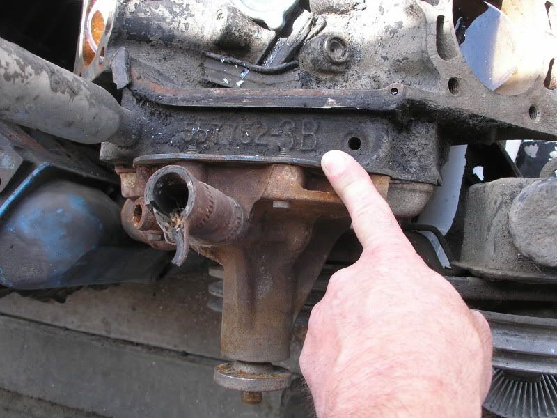

Def not the original 330(?)...I was told that it was a Chevy 350 crate motor. Don't know when it was put in...don't know how many miles are on it. The air cleaner has a fading Oldsmobile decal, but who knows what that means. I've only had the car for a little less than a week, and there are plenty of mysteries to solve. Hopefully, this weekend I'll be able to get some work done on it. I've been working too much to give the car a deeper looking into. If someone had a list of questions at the ready...
Old Jun 2, 2023 | 03:01 AM
Posts: 50,849
It's an Olds motor, not a Chevy. The block casting number above the water pump will tell you exactly which one.

This APPEARS to be a 1968-1976 350 Olds block. An in-focus photo from directly overhead would be useful. The VIN derivative stamp on the driver's side will tell you the exact year of the block.

The carburetor appears to be a 1968 or 1969 Quadrajet. You can decode the Fisher Body data tag at http://datatagdecoder.com. As Joe mentioned above, we need a better picture of the engine casting number; also you should post the large casting number of the cylinder head as seen at the front of the driver's side or the rear of the passenger side head. In the Tech Editor's Desk forum there is a "sticky" Low cost A-body disk brakes which may help you decide on a path to putting front disks on your car.
