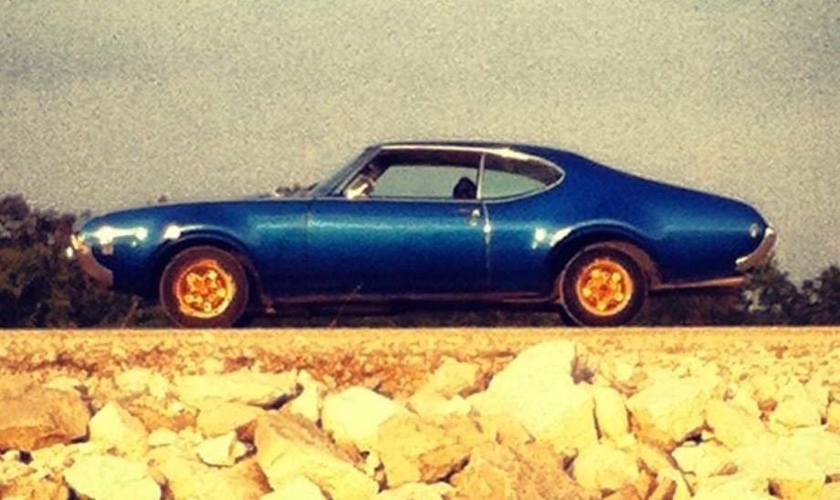

Found very helpful info on putting my 69 back together but after my son 18 yrs old blew up two 350's I'm putting an a 455 and taking the keys back LOL
I've searched hours for info on what headers will fit my 69s I'm dropping in a 455
And can't seem to find any headers with that application does anyone have any suggestions of what would fit I understand the break proportions valve issue and also probably a smaller starter but can't find info on headers any help would be greatly appreciated thanks
