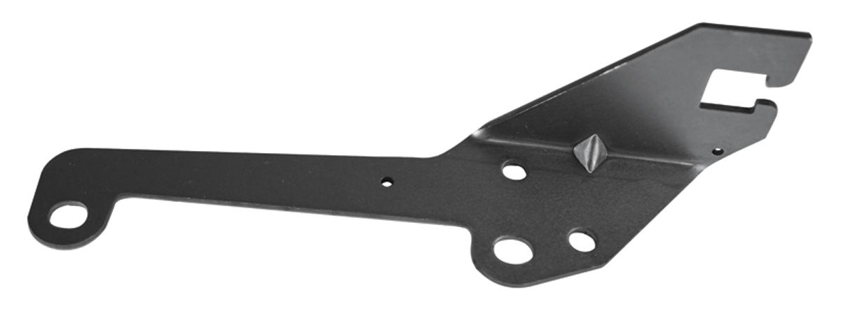

You don't need cable ends. The stock accelerator cable already has an eyelet. All you need is this throttle stud kit from E-brock.

The stock Qjet bracket is held by the two rear carb mounting bolts. There are different versions.

Be aware that the bolt spacing on the Qjet is different from that on square bore carbs. The Qjet holes are closer together. Your E-brock actually has both bolt patterns drilled into it. Your manifold likely does also. The brackets I showed will only fit on the inboard sets of holes. Alternately, you can cut the bracket and extend it to fit the wider square bore pattern. I've done that before also.
