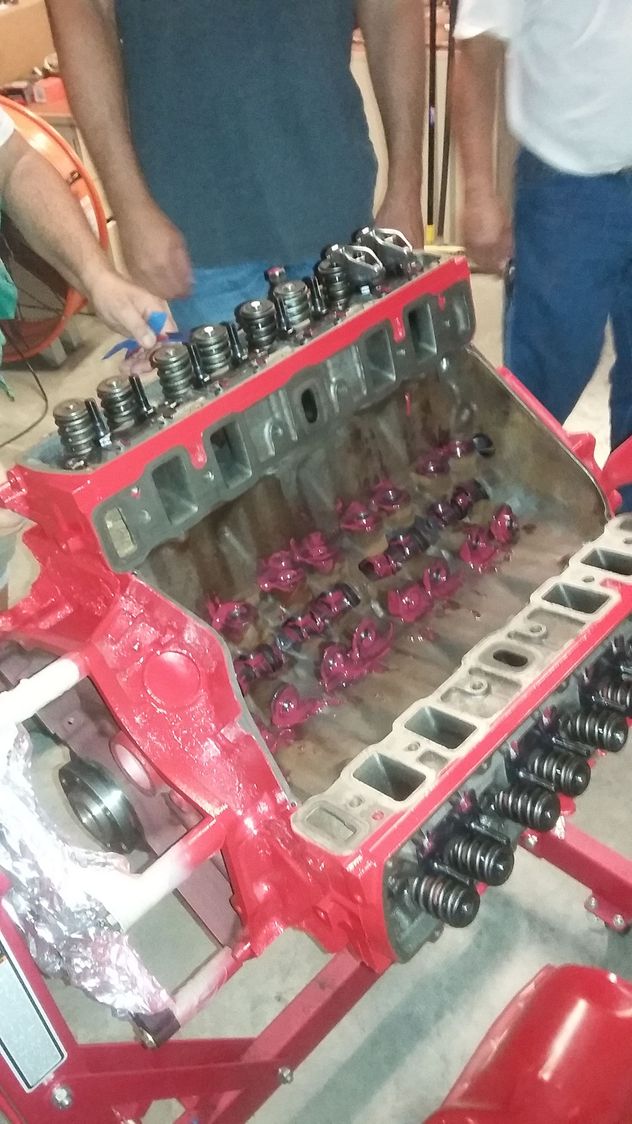

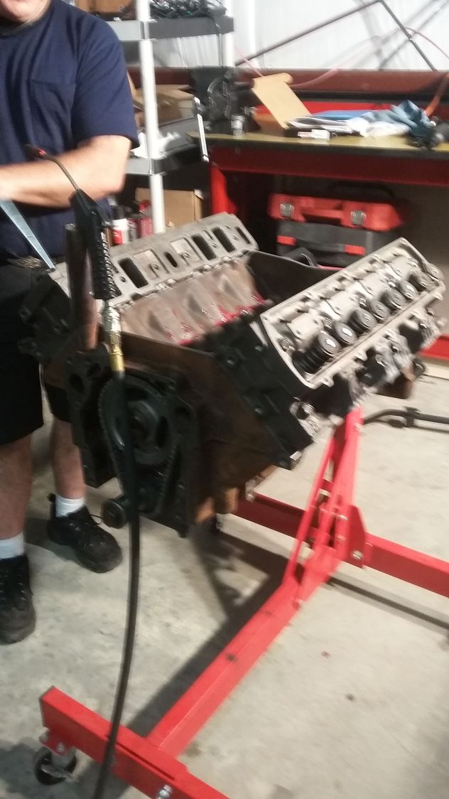

I thought I'd share with you guys the mess we've created. My 'normal' friends just can't appreciate! These pics are mostly for my own reference of what & how stuff hooked up so be kind!
1966 Olds 98 Convertible
From last spring when we helped the 425 out by putting on a new timing chain set.
Filthy 425 with rebuilt QJet, new water pump & aftermarket master cylinder & booster.
Pic for choke reference - choke itself is not original!
Pic for reference - original config we think.
Switch pitch controller after shadetree rebuild - it was pretty easy.
Pic for reference - original carb after rebuild. Primary throttle bushing leaked air - had to rebuild again.
New water pump.
Had it running great until a valve started sticking - Oh well, we got a summer out of the old girl.
Rebuilt suspension & steering linkage. New rubber & parts - repainted the arms & springs - The bracket is for a disc brake kit that didn't quite fit - currently shopping for another kit.
Dropped PS box & cleaned up best I could - pic shows new upper bushings & aftermarket master cylinder & booster that oxidized just about immediately - gonna switch that out for dual chamber unit.
Other side of bay showing new upper bushing & steering linkage parts. Blower motor & cowling taken off for cleaning & repair of inside/outside air diaphram & return spring.
Another view of another MC we tried and a bit more intensive cleaning & paint. Disassembled throttle linkage, cleaned & clear coated.
Finally got the block back from the shop - more cleaning cleaning cleaning - that tranny was filthy!
Orig exhaust manifolds after shot peening.
Rebuilt heads with hardened seats & new valves & springs.
Hi temp primer & paint
Hmm,.. original Olds Red isn't as bad as I thought it'd look!
Another view - 442.com shows this 390390 casting number as the same intake used on W30 engines.
Polishing the journals after having the crank Cryo'd - Steel crank baby!!

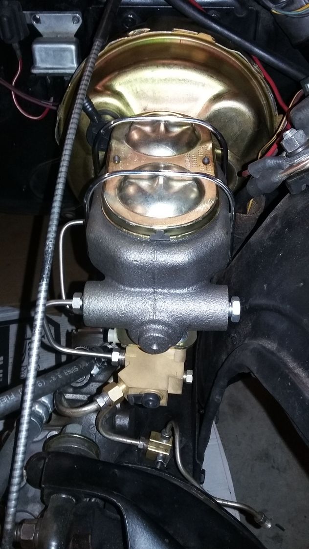

Kennybill, the disc brake conversion kit was made by SSBC. The bracket fit fine but the rotors they sent us didn't quite clear the the outside OD of the hub. We had the hubs lathed but then found the huge calipers kept the wheels from going on as the wheels that year weren't shaped the right way to allow for calipers. Might have gotten away with spacers but we didn't want to go that route. Also might have had luck with a '70's style 14x6-7 on 5x5 but our initial trip to the junkyard was unsuccessful. We're currently shopping for some kind of Tru-Spoke sort of wheel and a different kind of disc brake solution that has smaller calipers just to be sure. We think we've found one but I don't have their name on me. It'll be around $300 more iirc. The spoke rim we're looking at right now is http://www.ogrimsdirect.com/ProductD...x7AC%5F72%5FCL
The kit's instructions had us separate the hubs from the drums so we pounded away after soaking them in PB Blaster but still managed to damage the stud's splines on the hub. We had to go through a couple of stud interchange books and found some with .005 bigger knurl and going to have those pressed in and I'm praying they get centered correctly. If not then we'll be looking for new hubs and if so we might be able to use the opportunity to help fitment of the disc brake kit, but I'll admit I'm in uncharted territory for myself with mixing matching old GM hubs or perhaps even spindles to make it happen. Also, the combination block sent won't fit in the original spot. No big deal as we'll be going with a dual chamber MC anyway and the block sent was for a single.
m371961 -- Yeah the AC works too! It does have 14" rims and we'd like to keep them if possible with the disc brake conversion in order to keep those old hubcaps, but if we have to we'll go 15" or even 17".

Old February 17th, 2017, 04:35 AM
The Flash's Avatar
Join Date: Apr 2014
Location: Dallas
Posts: 79
i am in the same boat
i swapped my MC and using the stock booster my pedal is almost to the floor but it stops real good with the drums.
i was looking at the Kanter kit because it comes with all the parts but not sure if the stock wheels will fit

Old February 17th, 2017, 09:09 PM
Leander's Avatar
Join Date: Nov 2016
Posts: 26
The Flash -- The booster came with the aforementioned disc brake kit but put the included MC, which was like one of those old huge Corvette MC's, too close to the starter relay so we picked up a different one from a local guy. It's all going back though. We're only into trial & error stage on that right now and none of what you see in our pics are what we'll end up with. Where'd you get your combination block?
Your 98 looks really great!
Our AC works
We're going with a neoprene rear main seal, did you do the rope?
We've ordered a brake kit from these guys and are waiting -> http://hobbycar.com/disc-brake-conversion-kits.html
The owner acquired this car with an aftermarket radio hanging under the dash and a huge box in the trunk with 4 woofers in it. No room for the spare so we're going to have to do something. The rear power antenna was deleted when the former owner painted the car. Maybe he wanted clean lines back there..
We too are missing some brads off the convertible cover.
Serious cudos for your work to replace the support for the battery.
Totally jealous of your turning lights.
Yours is the 3rd 98 I've seen with that style of orig intake & carb. I guess ours was manufactured later in the model year as it's different but quite original too.

Old February 27th, 2017, 09:09 AM
Leander's Avatar
Join Date: Nov 2016
Posts: 26
The rebuild has slowed to a crawl due to us all being busy.
We're still messing with the brakes, but I'd thought I'd show you where we're at.
Seems like the kits we've ordered both wanted to put the MC ports towards the driver's side though the original had a single port on the bottom of the MC. Putting the ports on the driver's side sets them right up against the wheel well.
From the links on Tru-Spoke http://hobbycar.com/disc-brake-conversion-kits.html, we ordered a different disc brake conversion kit. This setup includes rotors with integrated hubs instead of just including a bolt up rotor to be used with the existing hubs, and along with the included calipers, does clear the original 14" wheels. Hurray!~ The kit did include new dust caps for the hub/rotor, however these caps do not have the original sprung receptacle for the speedo cable. Fortunately, the original caps still fit the new rotor/hub assy. Another problem was that the Hobbycar kit's caliper brake lines didn't fit the steel line while SSBC's did. We'll have to rectify that, grr.
Low profile calipers & new rotor/hub assy. Will work with original 14" wheels. I'm really not sure whether the calipers are significantly lower profile than SSBC's or whether the rotor placement with these integrated's are simply further inset than the SSBC kit, or both, but whatever the case, it works!
The included disc brake conversion M/C and Power Brake booster from the co. associated with Tru-Spoke. Disc brake (corvette/GM truck) style MC. Ports right on top of wheel well. We're looking for a MC just like this with ports pointing the other way, if it exists. Jegs showed one but pic might have been reversed. Crossing fingers on that unit. Also, the Power Booster was a much better fit to the brake pedal, where on the prior brake kit, would have required drilling out of the existing holes of the stirrup style threaded connector.
Edit: April 3rd - The 1st PB Hobbycar sent us was not correct as the eye rod connector to the brake pedal on the firewall side was too short (I missed that as the owner was on that side hooking it up). Had Hobbycar send us another one that looked identical but had an adjustable rod on the firewall side, it seems to fit better, offering much more stroke on the brake pedal, but we haven't bled it yet. The new PB came with a short & long rod for the PB to MC connection for us to choose. It took the long rod.
Had the idea to try the prior MC we bought locally to make it work, however this MC's piston bore is significantly smaller as measured at the rear, leading us to believe that it's stopping power may be much worse. We're not likely to go this route unless forced. That's the original combo block down below all cleaned up, but we will not be using that unless we decide to use it as a divider for the front brakes and block off it's rear brake port. Not sure yet. It has one inlet & 3 outlets, you see. The kit itself includes a larger combo valve unit (with sensor) that attaches to a 90 degree bracket fitted between the MC & PB and suspends the valve just below the MC. It's not shown here as these pictures were taken while we were just checking MC fit and didn't install the combo valve. This combo valve is flippable and it's mounting bracket has extra holes to accommodate the flip, so that we may face it's intake ports towards the pass side should we find the MC we're looking for. The valve's output ports are on the front & rear of the unit, so upon flipping, none will be facing the wheel well.

Old February 27th, 2017, 03:02 PM
The Flash's Avatar
Join Date: Apr 2014
Location: Dallas
Posts: 79
very nice
that second MC looks like what i ended up with i had to swap it several times to get the lines on the other side and like i said my pedal is very close to the Floor
will hobby car tell you what rotors these are?
i dont want to get stuck with something i dont have a replacement for.
also i was just looking for a MC like the one you need and i came across this
http://www.speedwaymotors.com/Univer...tyle,4316.html
they have a couple on there site wish i would have found this early on
has ports on both sides but the push rod is short and i dont remember if ours are short or long

So last night we worked on it a little bit. Gapped the piston rings and took a closer look at the TH400. You see, we have a switch pitch torque converter on this car but a few months ago before the rebuild, we sent the car down to the tranny shop to replace the front seal and filter, they also installed a new tranny mount and connector plug for the switch pitch/kickdown. But when we tore the car down, I noticed that the tranny plug had a single spade even though the connector receptacle had two wires, one for the kickdown & another for the switch pitch. So ok, the tranny tech isn't familiar with a two blade and thought this was some unnecessary ground maybe? We ordered a two blade plug and I go to replace it, but all I see when I uncork it is one wire on the inside. Damn, I get to drop the pan and fish the other wire out. Well, here's what I found.

Got the MC plumbed! Actually flipped then tweaked the original line to use for the front chamber to the original combo block. That's the original line from the rear brakes as well, it just made it to the rear of the new combo valve after a bit of wrestling and the addition of a needed adapter. The thing looks a heckuva lot tougher than the original MC. Only caveat is that block off nut on the driver's side front of the MC just touches the wheel well. We'll try to warp in the well a bit to have it clear. One question to those that have messed with these combo valves. As you can see, we have the driver's side front outlet on the new combo valve blocked off. We've been told that we can run the front left & right caliper off of one or both front outlets of the combo valve. Can anyone confirm? We're using one outlet and then the original combo valve as a divider, with the rear port blocked off.

[QUOTE=Leander;996031We've been told that we can run the front left & right caliper off of one or both front outlets of the combo valve. Can anyone confirm? [/QUOTE]
I don't see any reason why that would be a problem.
Looks great!

Guys, everything is still going pretty darn slow but at least we're starting to see the light at the end of the tunnel.
Just a view of the TH400 with switch pitch and kickdown wires showing
This strainer guffawed the guys at the new Napa store around here. They couldn't find it in their computer. I only thought after I'd left them that maybe it's because the chassis manual shows it as a strainer and not a filter and they were looking in the wrong place,.. I dunno. We'll run with this until after the first few miles to flush any FM that might have found it's way in there while we're had it open then find a new one to replace it with.
With strainer fitted.
Finally got the heads on a few nights ago. The Block 'D' '66 Oldsmobile 425 (non-Toronado) casting number 389244. These are the '66 'B' 80cc heads casting number 389395.
1966 Olds Red baby! We applied a couple layers of primer, 3 layers of the red and another 3 of clear coat, all hi temp stuff.
More eye candy
We had some new stock length 9.60 pushrods but with the thicker head gasket and guide plates, the geometry was looking a little whack. We have some 9.70's on order.
More eye candy
More eye candy
More eye candy
More eye candy,.. used to be the carb was by far the cleanest thing on the engine lol
More eye candy
Strange the air cleaner was orange and the block was red this year on this thing,.. but that's what the references say. Oh, and we're having a debate on the timing cover. I can get it shinier than that but the idea of painting it red or black has been flipped around. I'd like to leave it bare metal or maybe hi temp clear coat it. What do you guys think? The front of this engine is going to be covered in some pretty huge gloss blacked bracketry, so it'll be calling out just a bit from underneath it all. Oh, and we were thinking of repainting the valve covers black. Getting fancy valve covers is off the list for now.

I hope we didn't screw up on the pushrods. The stock length is 9.6". Going from the stock .017" head gasket compressed thickness to the Fel Pro's .045 compressed thickness is one thing, but adding the 5/16" guide plates are another at .3". Will those plates contribute to the factoring of the push rod length? If so, I fear we should've ordered 9.9" or 9.95" pushrods. Mondello offers them all the way up to 10".
