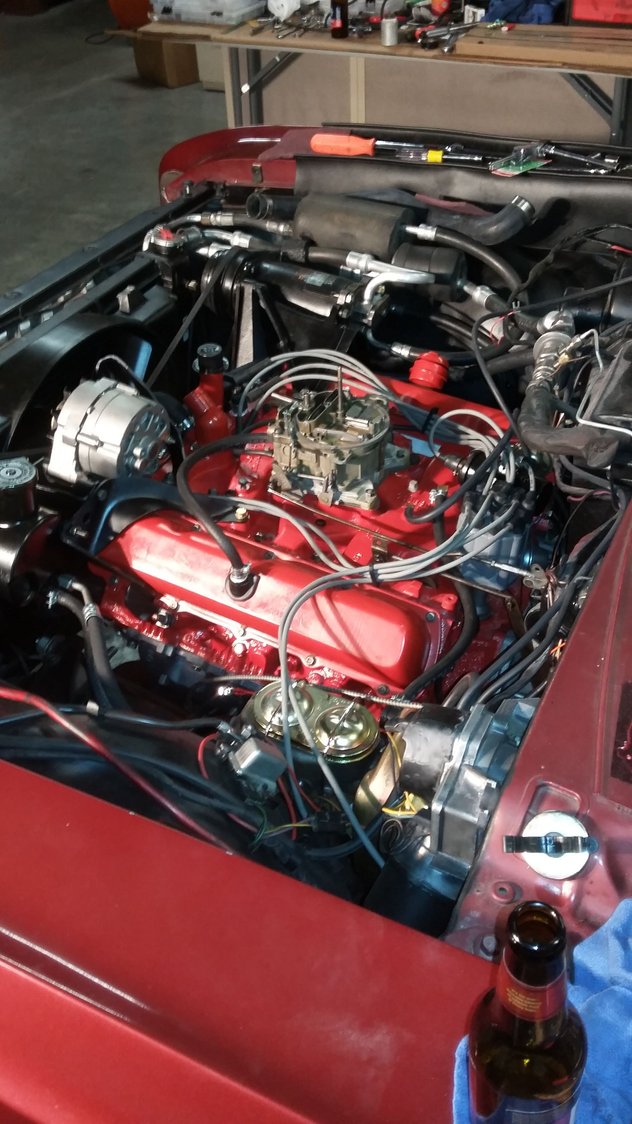

Filthy 425 with rebuilt QJet, new water pump & aftermarket master cylinder & booster.

Had it running great until a valve started sticking - Oh well, we got a summer out of the old girl.

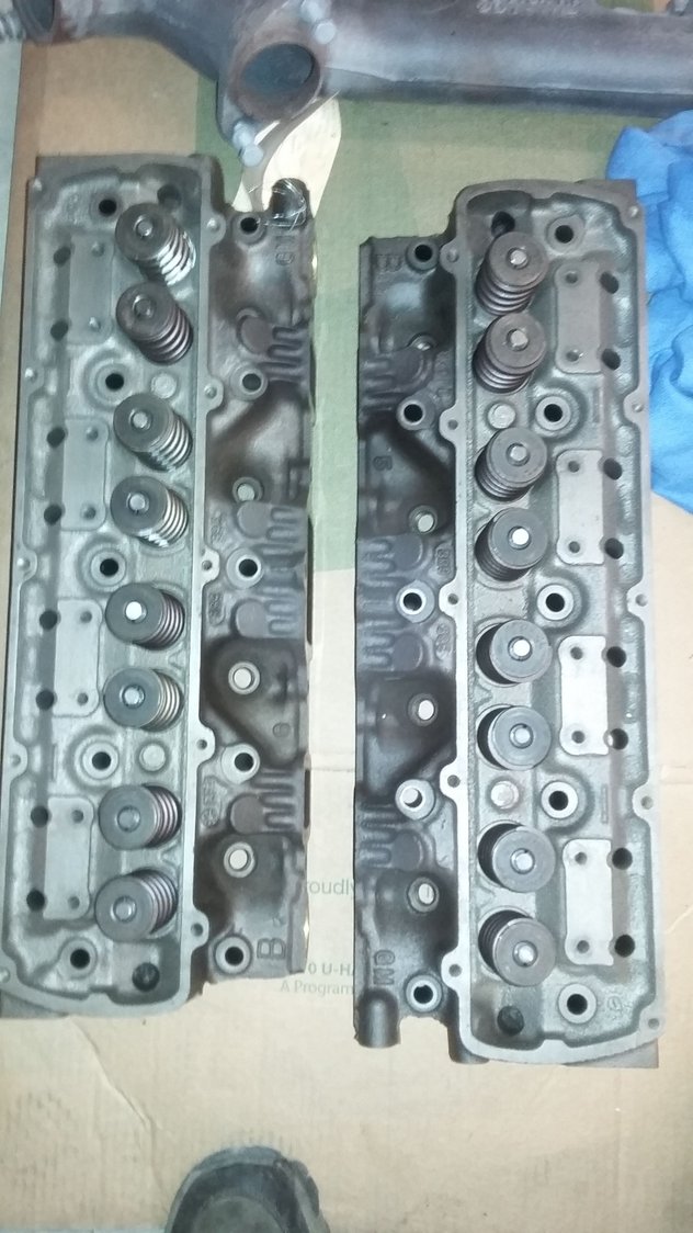

Rebuilt heads with hardened seats & new valves & springs.

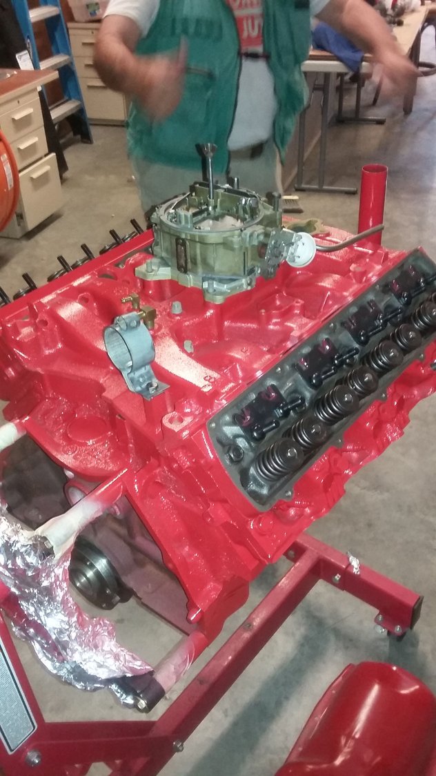

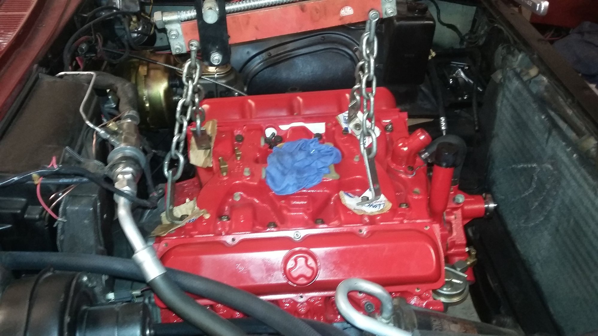

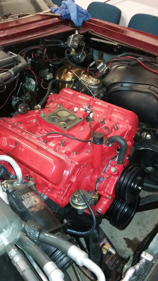

Hi temp primer & paint
Hmm,.. original Olds Red isn't as bad as I thought it'd look!

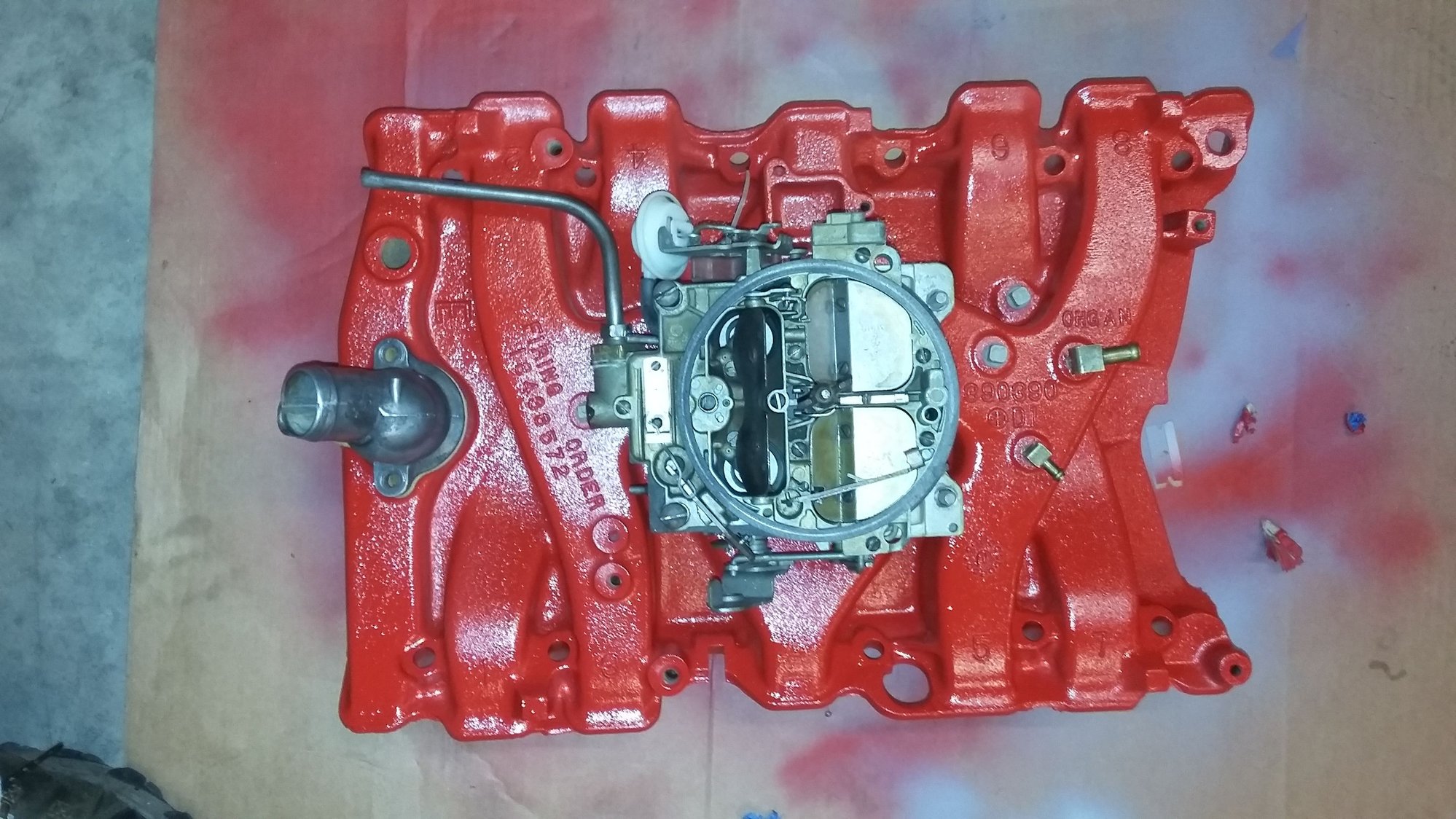

Another view - 442.com shows this 390390 casting number as the same intake used on W30 engines.

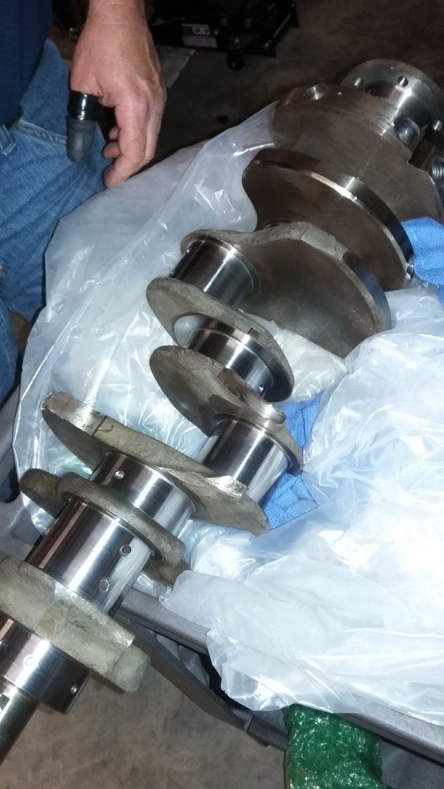

Polishing the journals after having the crank Cryo'd - Steel crank baby!!

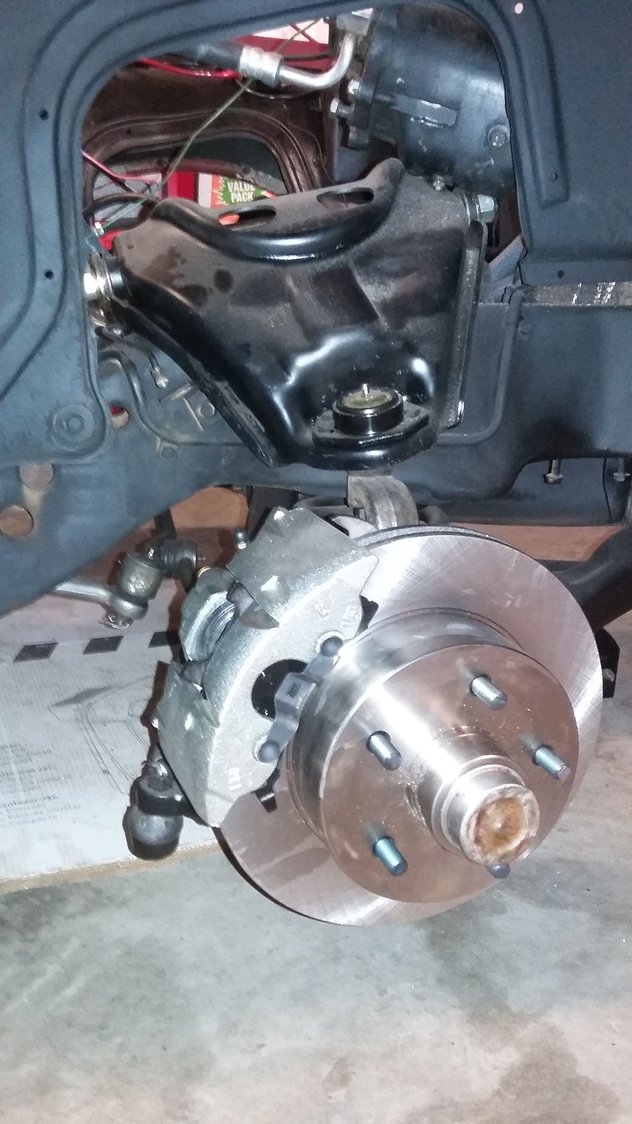

Kennybill, the disc brake conversion kit was made by SSBC. The bracket fit fine but the rotors they sent us didn't quite clear the the outside OD of the hub. We had the hubs lathed but then found the huge calipers kept the wheels from going on as the wheels that year weren't shaped the right way to allow for calipers. Might have gotten away with spacers but we didn't want to go that route. Also might have had luck with a '70's style 14x6-7 on 5x5 but our initial trip to the junkyard was unsuccessful. We're currently shopping for some kind of Tru-Spoke sort of wheel and a different kind of disc brake solution that has smaller calipers just to be sure. We think we've found one but I don't have their name on me. It'll be around $300 more iirc. The spoke rim we're looking at right now is http://www.ogrimsdirect.com/ProductD...x7AC%5F72%5FCL
The kit's instructions had us separate the hubs from the drums so we pounded away after soaking them in PB Blaster but still managed to damage the stud's splines on the hub. We had to go through a couple of stud interchange books and found some with .005 bigger knurl and going to have those pressed in and I'm praying they get centered correctly. If not then we'll be looking for new hubs and if so we might be able to use the opportunity to help fitment of the disc brake kit, but I'll admit I'm in uncharted territory for myself with mixing matching old GM hubs or perhaps even spindles to make it happen. Also, the combination block sent won't fit in the original spot. No big deal as we'll be going with a dual chamber MC anyway and the block sent was for a single.
m371961 -- Yeah the AC works too! It does have 14" rims and we'd like to keep them if possible with the disc brake conversion in order to keep those old hubcaps, but if we have to we'll go 15" or even 17".

Sounds like your will need 1971-1975 5x5 Oldsmobile 88/98 (disc brake) rims. I thought they were SSBC. I bought that same kit of the clearance rack at Summit Racing. I talked to a fellow at SSBC, he said they discontinued this kit because of hub problems. Keep us informed on your progress. Thanks, Ken

Seems like the kits we've ordered both wanted to put the MC ports towards the driver's side though the original had a single port on the bottom of the MC. Putting the ports on the driver's side sets them right up against the wheel well.
From the links on Tru-Spoke http://hobbycar.com/disc-brake-conversion-kits.html, we ordered a different disc brake conversion kit. This setup includes rotors with integrated hubs instead of just including a bolt up rotor to be used with the existing hubs, and along with the included calipers, does clear the original 14" wheels. Hurray!~ The kit did include new dust caps for the hub/rotor, however these caps do not have the original sprung receptacle for the speedo cable. Fortunately, the original caps still fit the new rotor/hub assy. Another problem was that the Hobbycar kit's caliper brake lines didn't fit the steel line while SSBC's did. We'll have to rectify that, grr.
Low profile calipers & new rotor/hub assy. Will work with original 14" wheels. I'm really not sure whether the calipers are significantly lower profile than SSBC's or whether the rotor placement with these integrated's are simply further inset than the SSBC kit, or both, but whatever the case, it works!
The included disc brake conversion M/C and Power Brake booster from the co. associated with Tru-Spoke. Disc brake (corvette/GM truck) style MC. Ports right on top of wheel well. We're looking for a MC just like this with ports pointing the other way, if it exists. Jegs showed one but pic might have been reversed. Crossing fingers on that unit. Also, the Power Booster was a much better fit to the brake pedal, where on the prior brake kit, would have required drilling out of the existing holes of the stirrup style threaded connector.
Edit: April 3rd - The 1st PB Hobbycar sent us was not correct as the eye rod connector to the brake pedal on the firewall side was too short (I missed that as the owner was on that side hooking it up). Had Hobbycar send us another one that looked identical but had an adjustable rod on the firewall side, it seems to fit better, offering much more stroke on the brake pedal, but we haven't bled it yet. The new PB came with a short & long rod for the PB to MC connection for us to choose. It took the long rod.
Had the idea to try the prior MC we bought locally to make it work, however this MC's piston bore is significantly smaller as measured at the rear, leading us to believe that it's stopping power may be much worse. We're not likely to go this route unless forced. That's the original combo block down below all cleaned up, but we will not be using that unless we decide to use it as a divider for the front brakes and block off it's rear brake port. Not sure yet. It has one inlet & 3 outlets, you see. The kit itself includes a larger combo valve unit (with sensor) that attaches to a 90 degree bracket fitted between the MC & PB and suspends the valve just below the MC. It's not shown here as these pictures were taken while we were just checking MC fit and didn't install the combo valve. This combo valve is flippable and it's mounting bracket has extra holes to accommodate the flip, so that we may face it's intake ports towards the pass side should we find the MC we're looking for. The valve's output ports are on the front & rear of the unit, so upon flipping, none will be facing the wheel well.

Scarebird makes the most successful "kit " for disc brakes for 61-70 full size Olds .
I say "kit" because all they sell you is a specially made hub and caliper brackets . The rotors (76 T-Bird) and calipers (71 Cutlass) you buy at your local auto parts store.
Everything fits right , but you must use 15 inch or larger wheels.
See this thread here;
https://classicoldsmobile.com/forums...elta-88-a.html
The 14 inch wheel kits I see use small rotors from a Honda or something . You would be better off staying with stock drum brakes.

Got the MC plumbed! Actually flipped then tweaked the original line to use for the front chamber to the original combo block. That's the original line from the rear brakes as well, it just made it to the rear of the new combo valve after a bit of wrestling and the addition of a needed adapter. The thing looks a heckuva lot tougher than the original MC. Only caveat is that block off nut on the driver's side front of the MC just touches the wheel well. We'll try to warp in the well a bit to have it clear. One question to those that have messed with these combo valves. As you can see, we have the driver's side front outlet on the new combo valve blocked off. We've been told that we can run the front left & right caliper off of one or both front outlets of the combo valve. Can anyone confirm? We're using one outlet and then the original combo valve as a divider, with the rear port blocked off.

Guys, everything is still going pretty darn slow but at least we're starting to see the light at the end of the tunnel.
Just a view of the TH400 with switch pitch and kickdown wires showing
This strainer guffawed the guys at the new Napa store around here. They couldn't find it in their computer. I only thought after I'd left them that maybe it's because the chassis manual shows it as a strainer and not a filter and they were looking in the wrong place,.. I dunno. We'll run with this until after the first few miles to flush any FM that might have found it's way in there while we're had it open then find a new one to replace it with.
With strainer fitted.
Finally got the heads on a few nights ago. The Block 'D' '66 Oldsmobile 425 (non-Toronado) casting number 389244. These are the '66 'B' 80cc heads casting number 389395.
1966 Olds Red baby! We applied a couple layers of primer, 3 layers of the red and another 3 of clear coat, all hi temp stuff.
More eye candy
We had some new stock length 9.60 pushrods but with the thicker head gasket and guide plates, the geometry was looking a little whack. We have some 9.70's on order.
More eye candy
More eye candy
More eye candy
More eye candy,.. used to be the carb was by far the cleanest thing on the engine lol
More eye candy
Strange the air cleaner was orange and the block was red this year on this thing,.. but that's what the references say. Oh, and we're having a debate on the timing cover. I can get it shinier than that but the idea of painting it red or black has been flipped around. I'd like to leave it bare metal or maybe hi temp clear coat it. What do you guys think? The front of this engine is going to be covered in some pretty huge gloss blacked bracketry, so it'll be calling out just a bit from underneath it all. Oh, and we were thinking of repainting the valve covers black. Getting fancy valve covers is off the list for now.
The air cleaner was orange-red and the block was red. That's just the way it is.
Not sure why you want to not paint the timing cover or to paint it a different color, but it's your engine, and you can paint it whatever way you like best.
Looks great, overall!
- Eric

I hope we didn't screw up on the pushrods. The stock length is 9.6". Going from the stock .017" head gasket compressed thickness to the Fel Pro's .045 compressed thickness is one thing, but adding the 5/16" guide plates are another at .3". Will those plates contribute to the factoring of the push rod length? If so, I fear we should've ordered 9.9" or 9.95" pushrods. Mondello offers them all the way up to 10".
- Eric
Eric, all the 425's I had, (about 8) had the block originally a red orange, just about matching the air cleaner. The red Fusick sells for 425's does not match the weathered original paint I have found on them. Just my observation.

Joe, I can't absolutely testify as to the exact original color of the Olds Red engines.
I know that Fusick's air cleaner color is dead-on right, because I've used it on an air cleaner that was in perfect condition on the inside, and when the paint was dry, you couldn't tell the difference between the inside and the outside color.
As for the cherry red block color, I do not specifically remember finding any protected internal spots of paint on a block to provide a good comparison, but it is true that the exposed paint that I did see was a bit more orange than cherry. I've ASSumed that Fusick matched their color off of original untouched valve covers, or something like that, but that may have been completely mistaken.
- Eric

Pictures look great, timing cover and thermostat housing also gets engine color paint. Fuel pump also gets a dusting of engine paint. Oil filler cap is black.

More eye candy - we ordered a hi volume oil pump and our original pick up tube won't work with it. Waiting on another to come in. Otherwise things seem to be getting there slowly but surely.

Well as we've got the motor put together, we sat down with a few beers and started making a list of everything else that needs to be done. To our surprise our list is up to 20 items with more stuff sure to make the list, lol.
We also discovered that our RH exhaust manifold replacement isn't correct, and the original's flange bolt holes have been drilled out in decades past. Figuring we'd need to have the exhaust re-piped anyway to make it work with the replacement manifold, dual exhaust is back on the table. Called up Thornton and are having a 65-70 Starfire set shipped. Now we'll need a new transmission linkage rod fabricated.
The saga continues,...

Just so you know, this is the engine placement on a '66 Olds 98 425cid when you have the motor mounts reversed. Don't ask me how I know.
From the pass side.
New master cylinder clearance. Had to take the driver's exh manifold off to get the block in. Haven't tried to fit it yet but it'll have to go on from underneath I think.
Correct placement.
