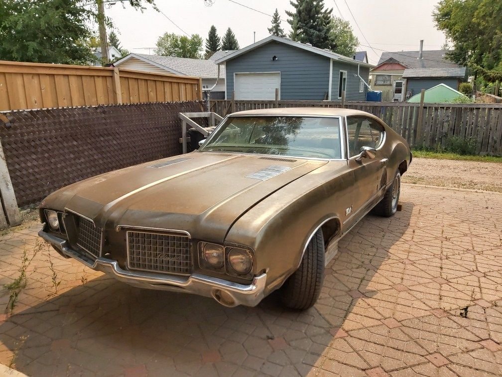

I'm sure this will turn in to a major rebuild that will take years to finish. Engine runs if you pour gas down the 2 barrel carb, so new fuel pump is on order. Both upper and lower rad hoses are just done, will also replace heater core hoses and probably the heater core when we open the dash up. Windshield need replacing but all the other glass is good. Needs new felt for the windows and new weather strips to seal the windows at the tops. Going to find better tires (these ones are done) and rims. Possibly sell the back rims. Back dash is made of plywood and is in really bad shape (not sure where to get this). Also don't know for sure what the floor pan is like but we'll find out when we take the seats and carpet out. All the seats need redoing and new foam. Transmission slips so I'm sure it will need a rebuild. Not to mention a new paint job.
So first things first. Get the engine running. Once that's done we'll fix the brakes (none of them work). Then the transmission. After that we'll start the body work and interior. I suspect it will take about 6 months to get it so it's safe to drive. Kinda depends on finances a bit.

Take your time and enjoy the process, ive had my car morethan a decade and im still knocking out projects. The rear deck is a cardboard like piece w thin insulation on it. Ive found many parts you can fabricate yourself and in many cases theyre better than the original. Some members have fabricated their own door panels, headliners rear decks etc w very good results.
in many cases original Good condition used GM parts are nicer and fit better than repops
ebay
tamraz
fusicks
the parts place
opgi
are all olds parts suppliers many have the same parts at varying prices.
In case your interested the 72s had 3 styles of grills availible, the supreme/HO which are on your car now, the S style that are horizontal bars and the 442 style that are different than the previous two.

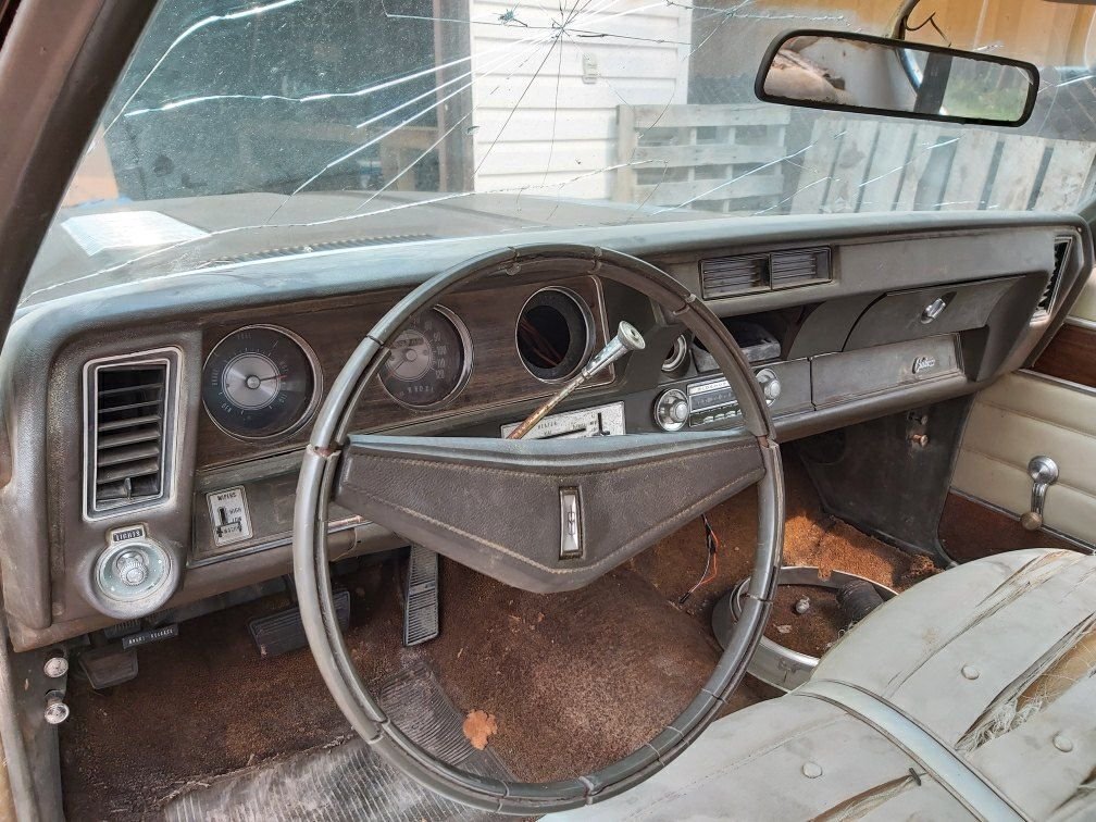

Posts: 15,411
No need to pull the dash for the heater core - the HVAC box drops out from below the dash. I’ve done a half dozen heater core replacements and have yet to remove the dash.
Old Aug 19, 2021 | 02:45 PM
VE6STA's Avatar
Joined: Aug 2021
Posts: 41
That's good to know. I've only ever done one. It was on a 1992 Chevy Lumina Van (APV) and while I didn't have to remove the dash. I had to undo the bottom bolts from the center and passenger side so I could bend it out of the way. Why I said we would do it when we remove the dash is we are sort of planning on removing it. There are ducts that have fallen off and there are wires just dangling so no sure where they go or what they do. On top of that the dash isn't in great shape so it may need some restoration also.
