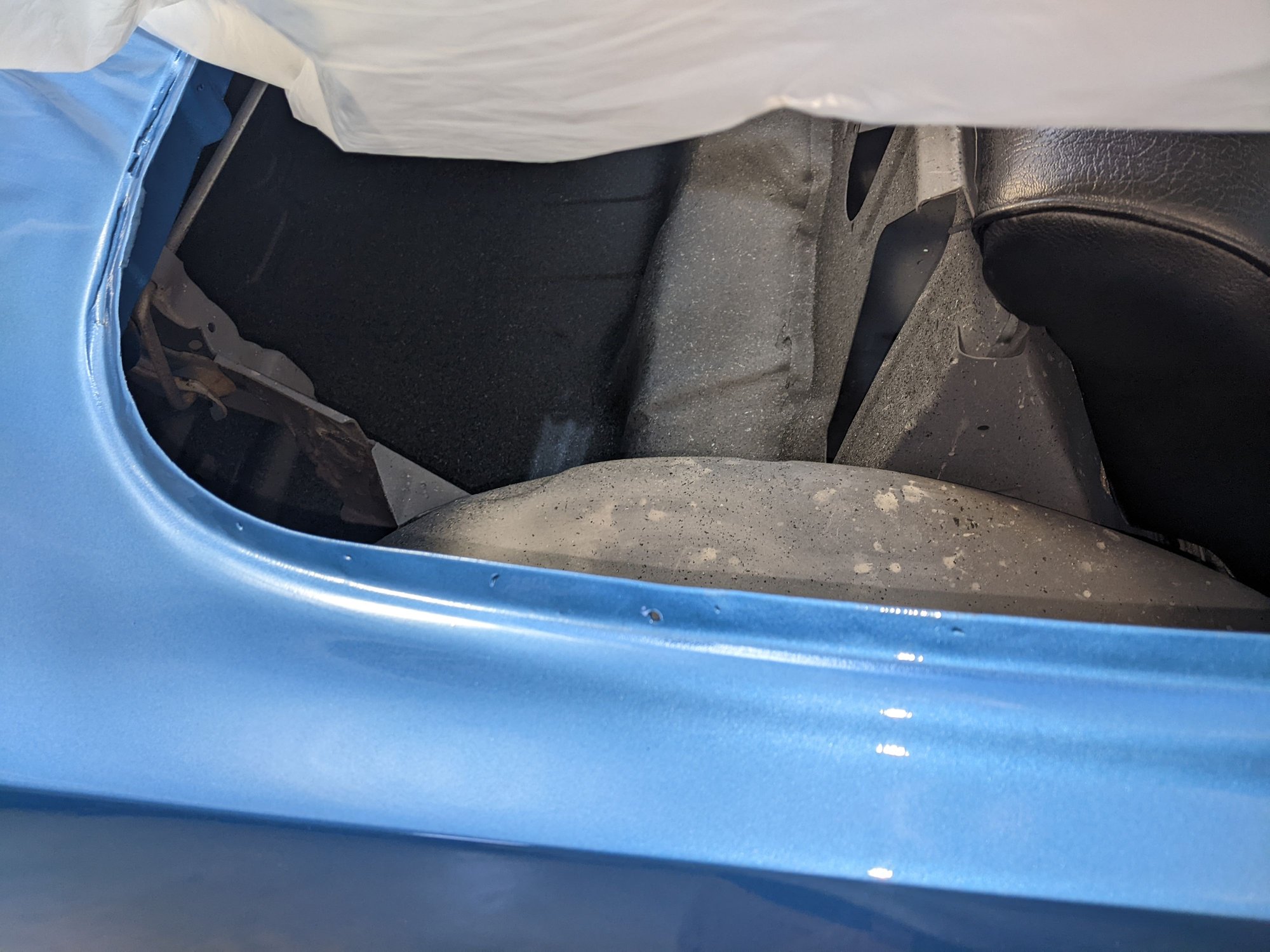

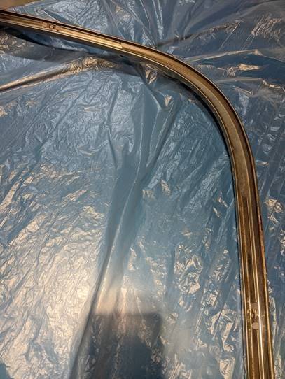

I don't know if my car was missing the clips, but I didn't have any clips on my '72 442 convertible. Here are some pics of my pinchweld, maybe I'm missing something but this went together well, like it was supposed to be this way.

IMO that is factory correct for your car Rodney. I think what may have happened is the factory changed the pinchweld molding attachment method at some point. Changed from the clip attachment method to the screw-on attachment method. As I mentioned above the pinchweld molding I pulled that had clips holding it on was a 68 or 69 Pontiac. I also remember pulling a set from a '72 Cutlass convert here (as well as a '72 442 vert) and it was held on w/the screws. Who knows??.....maybe it was a GM division difference, a assembly plant difference, a year model difference.

Looks to me like a change for the better. Those clips were a royal pain for me to get set firmly in place. Once in place, though, the pinchweld snapped on nicely. No snapping in place, as it appears, with the '72 pinchweld.
