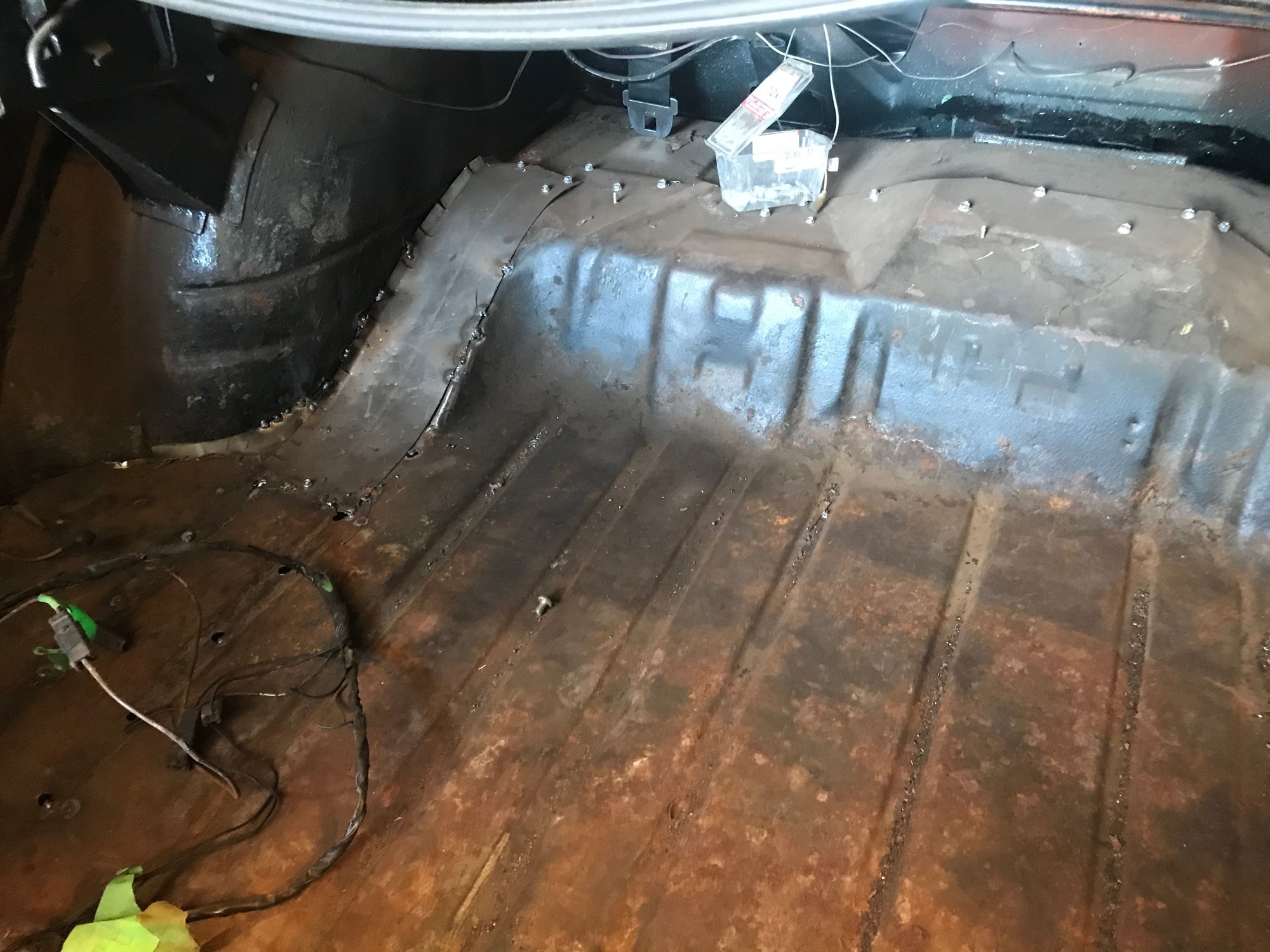

over the last couple days we got the rear bumper and tank dropped, and pulled most of the interior out:
The floor pan was alot worse than I originally anticipated, i new the cross members, and mounts were bad from underneath, however once the carpet was removed it showed some amateur repair jobs and more rust
So i welded in some cross members to help keep things square when I lift the body... with the floor in the shape its in it makes me nervous.
Just used some old angle iron.. nothing to fancy.. (old bed frame LOL)

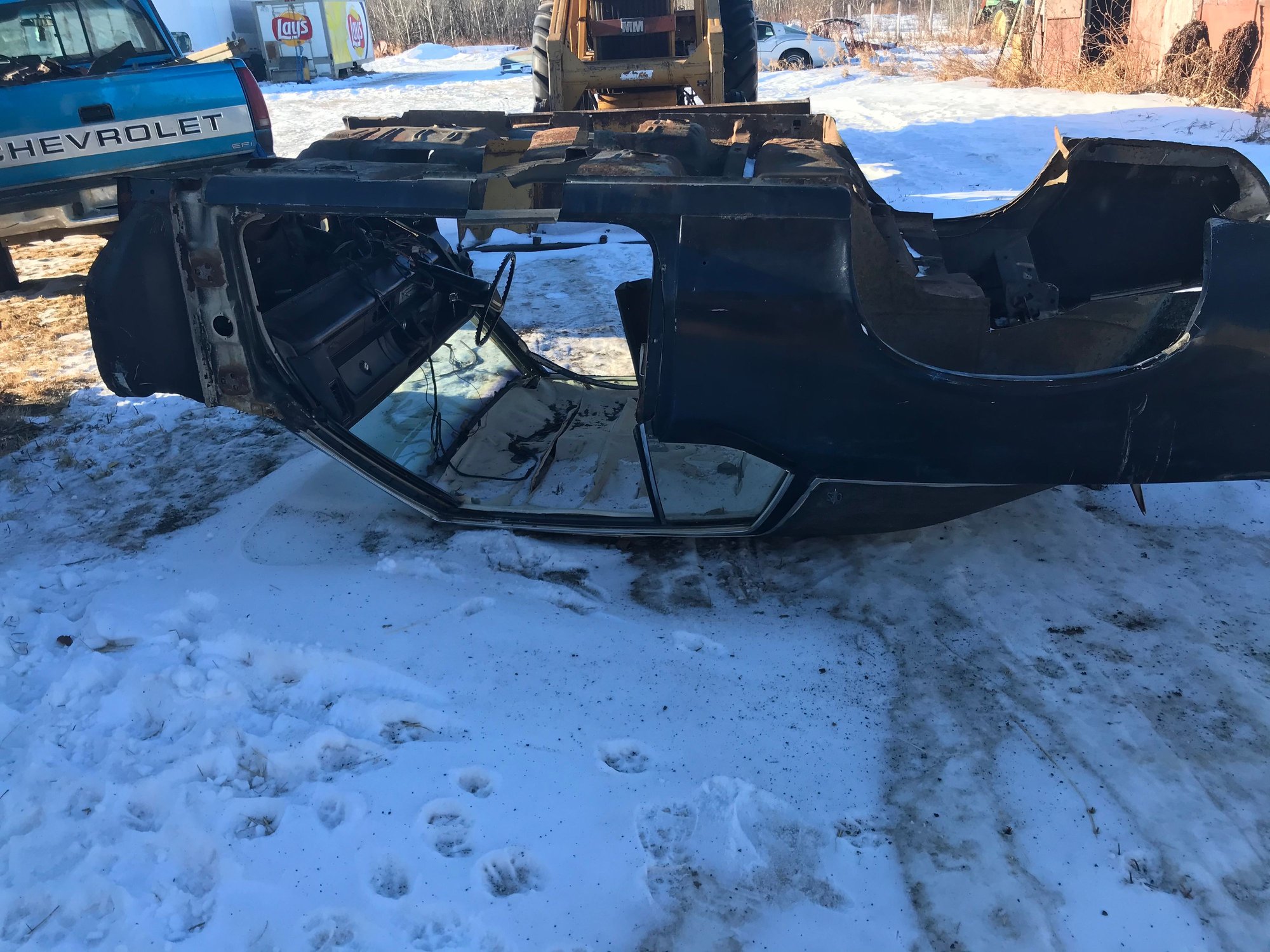

Lifted the body off the chassis this week, everything went as planned

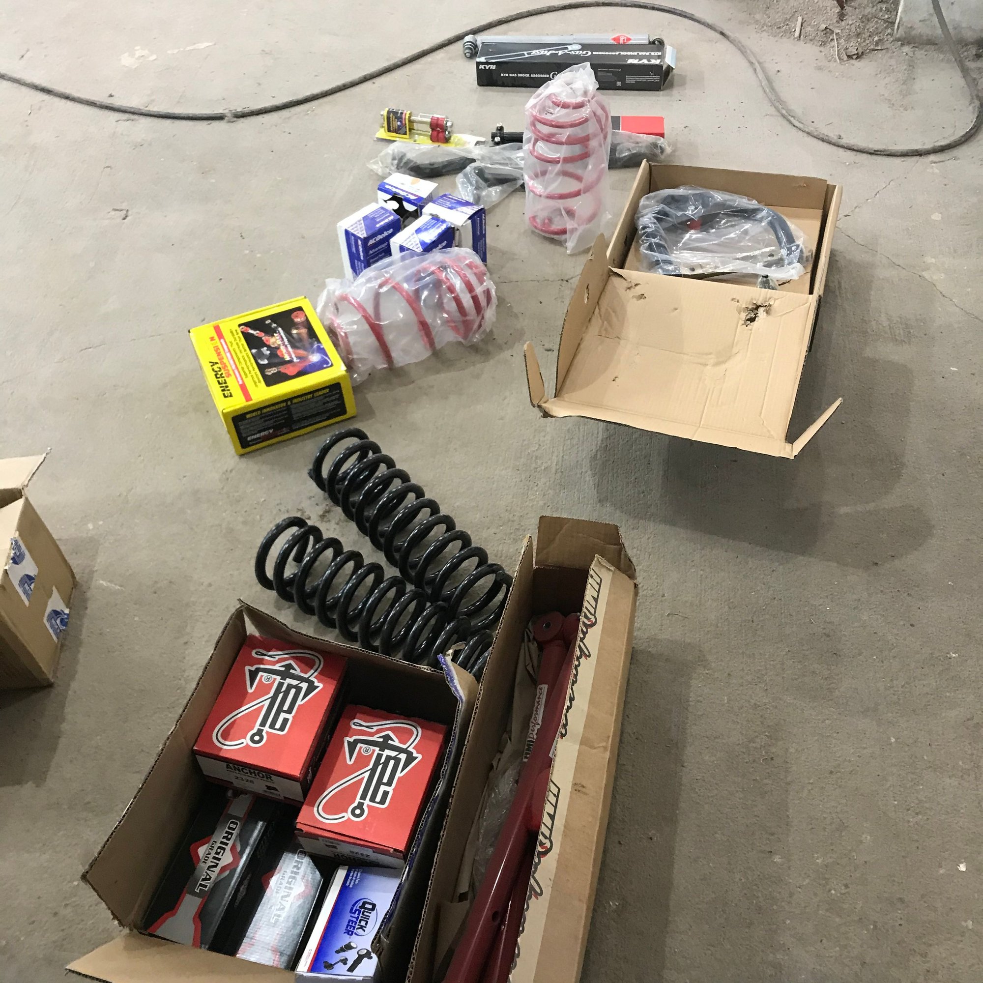

Got a bunch of new parts delivered as well, excited to get them all in
Got a 12.7:1 box in too

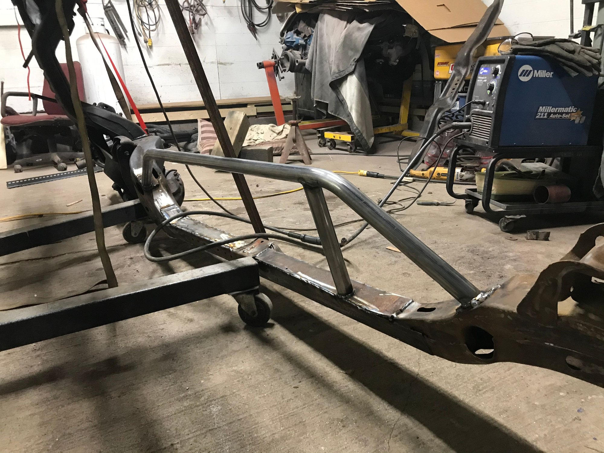

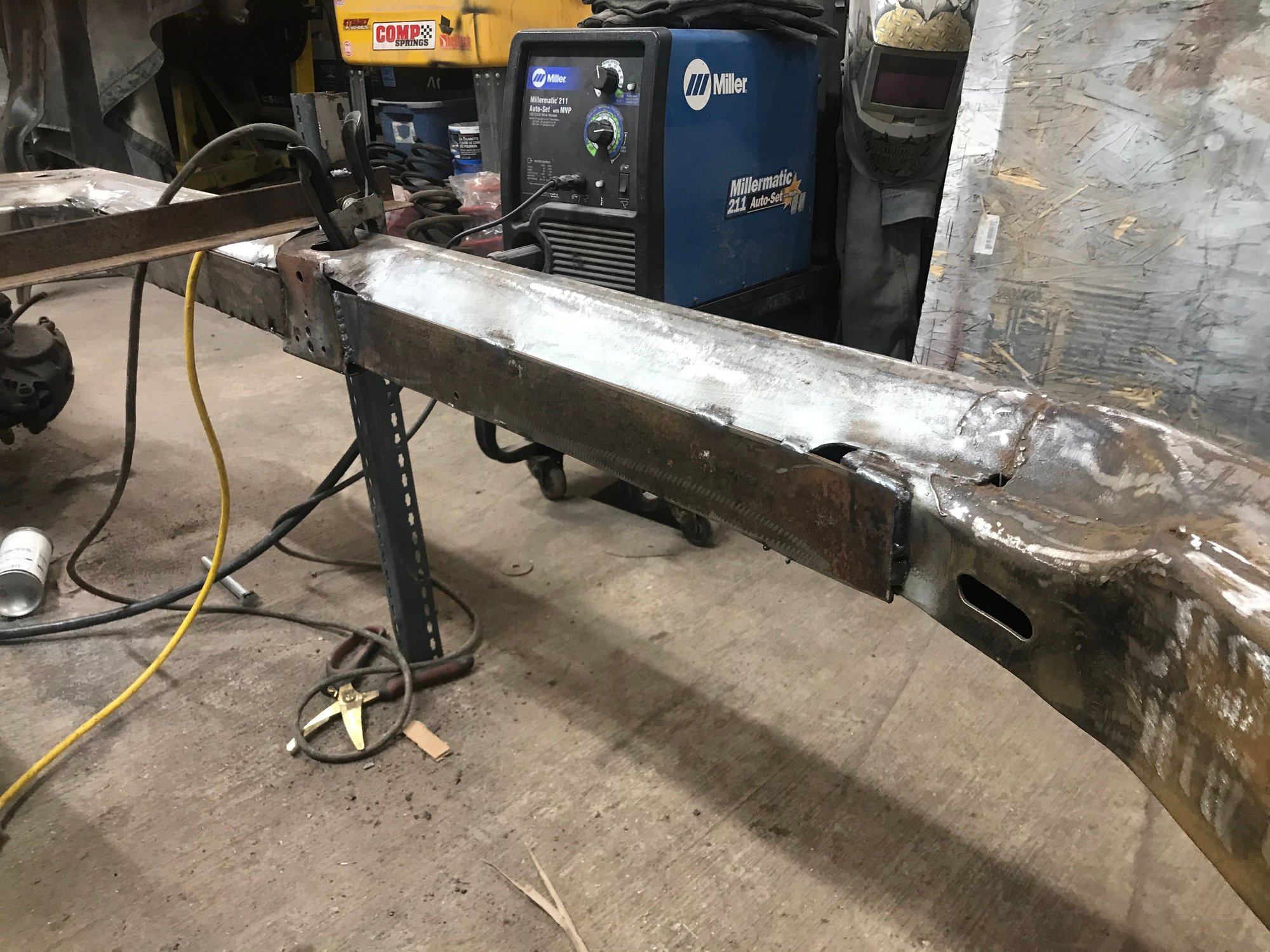

While I have the frame out and bare I thought I’d spend a little time to stiffen it up.. I want the car to handle whatever I throw in it in the future.

finished getting the frame bracing all fabbed up and welded in this weekend, time to give I a coat of paint and bolting things together

What about the trans crossmember? Will it still fit w the braceing?
no, I'm planning on building one once i drop the engine/trans into the car. that's also why there is no cross bars in the front yet.

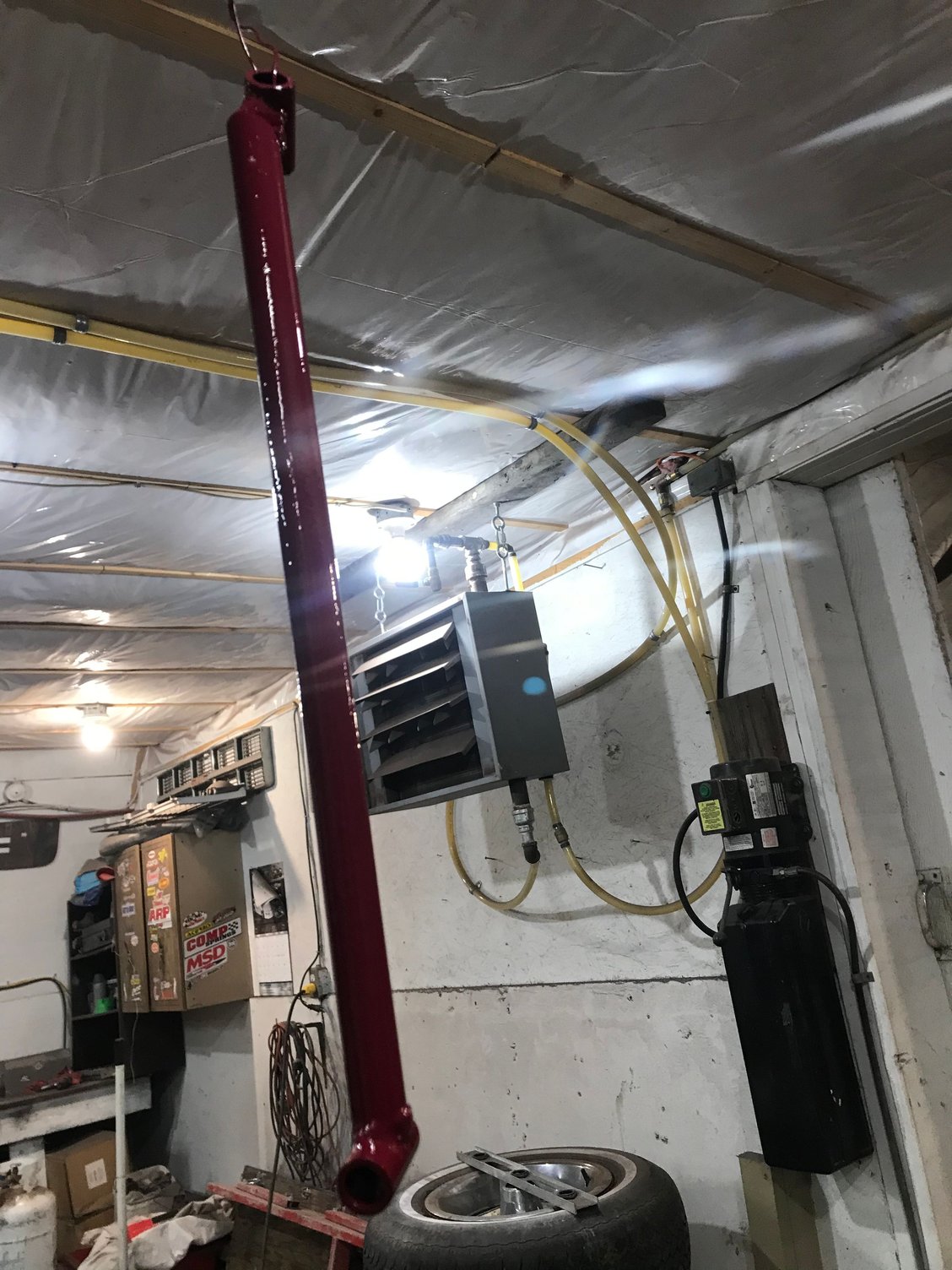

got the frame primed and painted, and started assembling the front end.. new lower control arm bushings, new tubular uppers, and new heavy duty springs (with a coil cut).

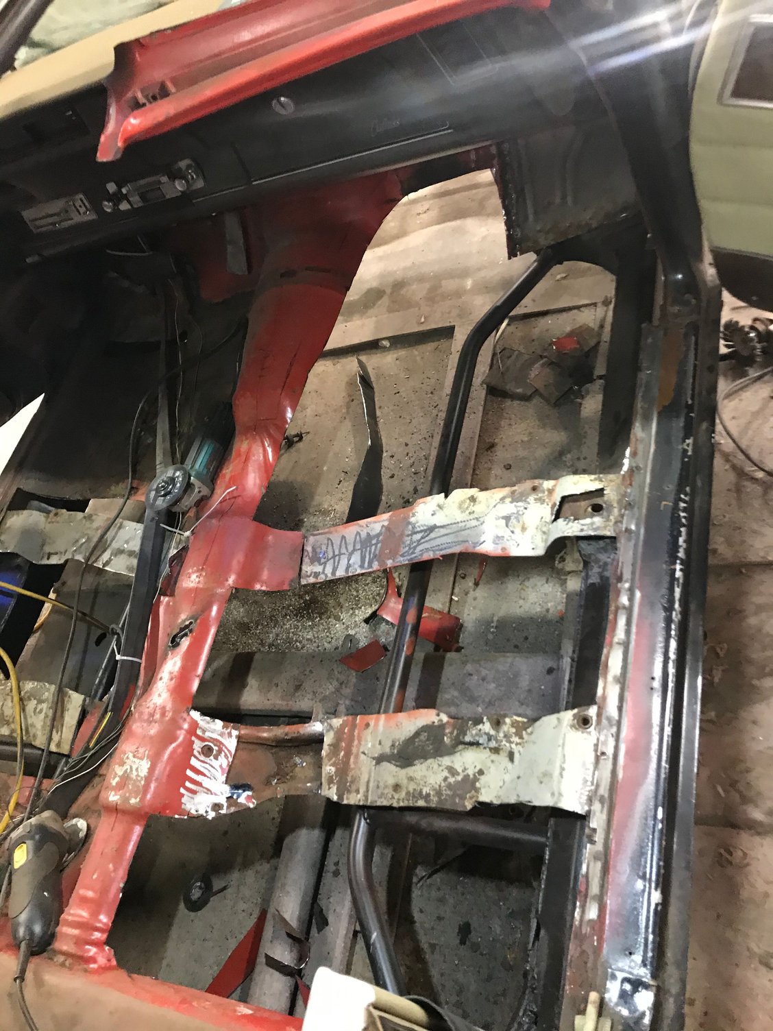

Ended up cutting the whole trunk pan and cross braces out of the donor car and welding them into ours.. thankful to have this car..
Welded the front mounts and cross mounts into our car. I have new floor pans to install next
Started fabbing the other trunk into ours.. got it all roughly welded in.. just have to finish the welding.

Cut out most of the old floor pan
Got a new one in the one side
Unfortunately ran out of welding materials to finish the other side, hope to get the other half done this week..

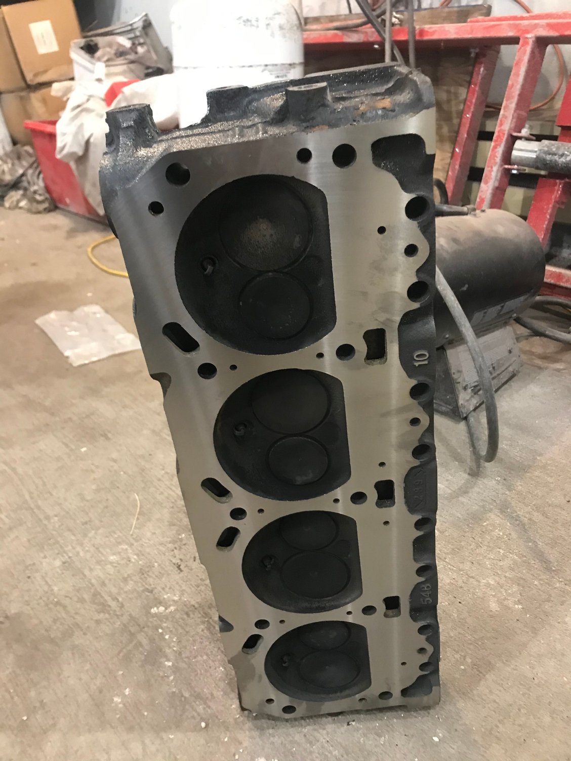

Going through the old 455.. it was from a 68.. big valve “c” heads, 30 over rebuild in 2014 (been in storage since 2016) the deck to piston is .030.. and the pistons are 13cc dish.. with the .040” head gasket and 80cc “c”heads I believe my compression will be 9.5:1.. considering sending the heads to a friend of mine to get them milled to bring that comp closer to the mid 10s

Got the heads back from milling .050 off..
New head gaskets.. between everything should have a compression of 10.3:1
Got my frame braces in
