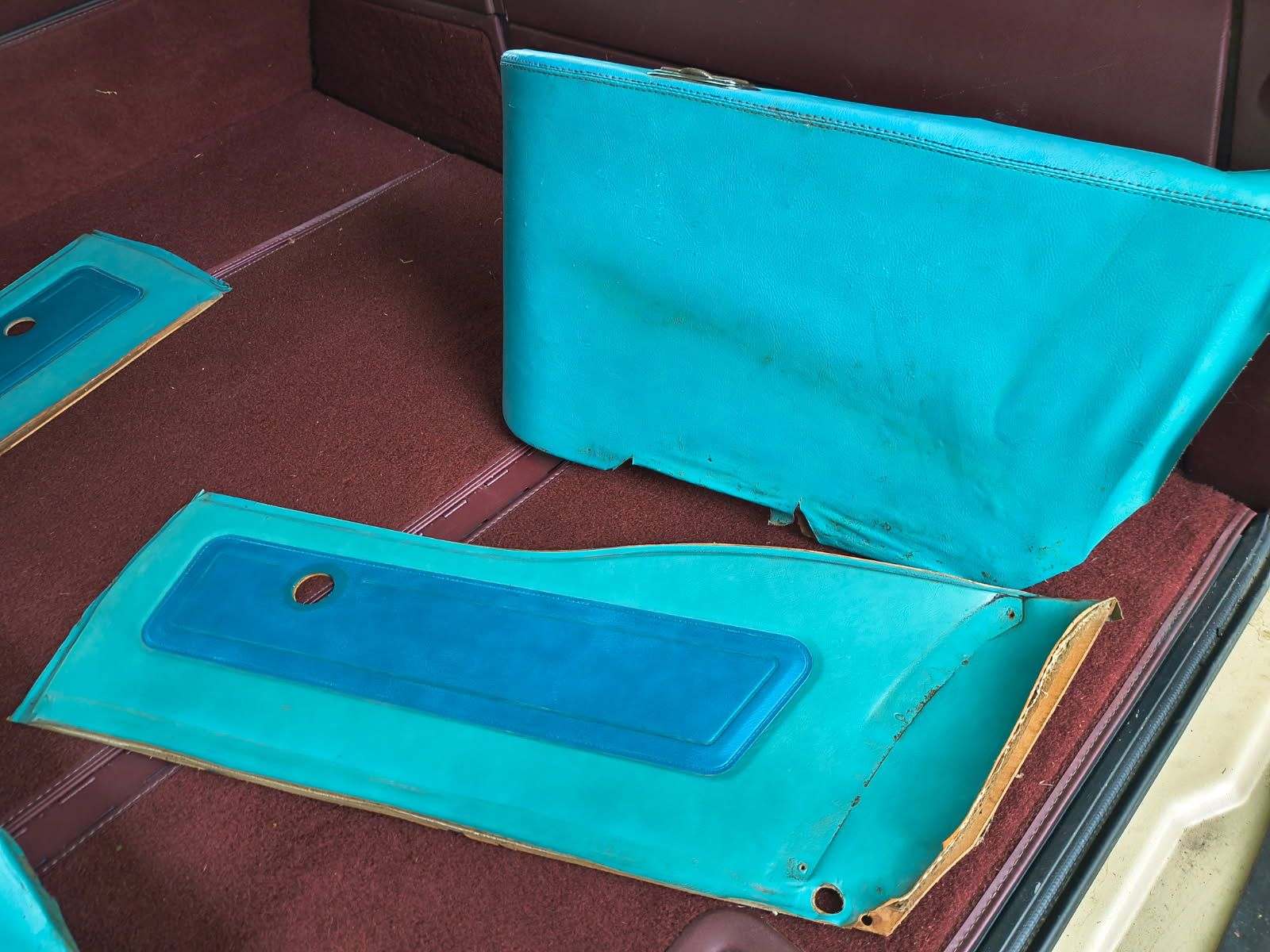

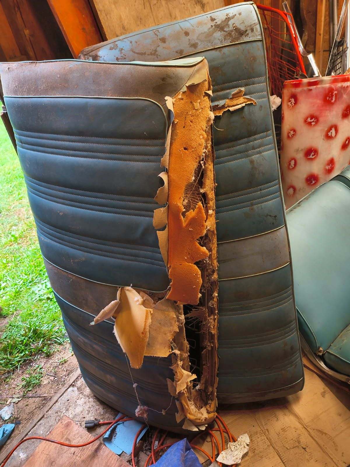

The de-turding process is about complete. Cleaned up the front bumper, it has been rechromed in the past and is in nice driver condition. The seats are gone but enough is there to recreate if I go that route. The door and side panels are for sure decent and rear armrests could also be reused. Have been busy ordering stuff needed to get the rotted sheet metal replaced.
Old May 21, 2026 | 02:05 PM
  #44
Posts: 11,686
Joe - That front bumper looks pretty damn nice! 👍 Keep on keepin on! Love seeing your work on these '67's! 😃
Old May 21, 2026 | 03:49 PM
  #45
Oldsmaniac's Avatar
Joined: Oct 2005
Posts: 7,318
From: NJ
Thanks! Such a rare beast with the bench seat aqua interior and 4 speed I had to have it. But with the blue 3 speed 67 post car not close to being done you see I am addicted!

Turd take 2, arrived last night. I want to know if there is a market for rodent feces as there is plenty of it in the trunk, bigger turds like opossum or racoon maybe? Was late so will post picts. Car sold new in Ft Wayne Indiana in April of 67 says protecto plate.
Sold new
Rice Oldsmobile INC
1912 Bluffton Rd Fort Wayne IN
