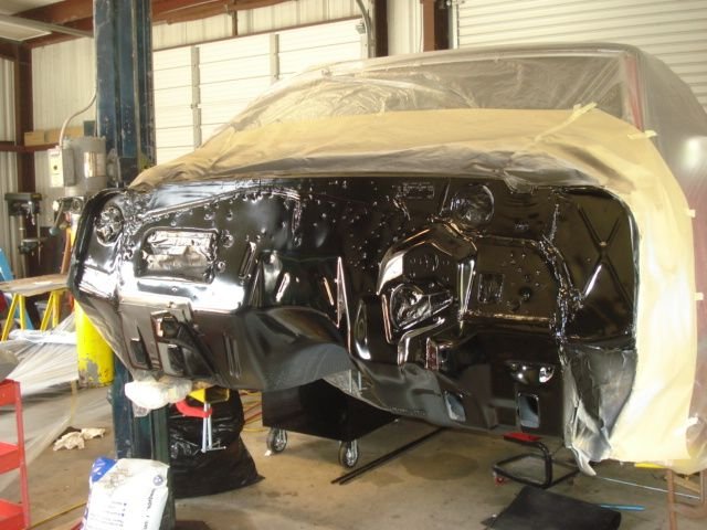

I was originally going to just do a quick wash and rattle can the firewall. Since I no longer have a target date I took it a little farther. The rest of the engine compartment will look so clean and detailed so I have to make this pretty too.
Used a heat gun and a wood paint stick to get the old undercoating and black body sealer off. The paint stick works good and does not gouge the metal. I left all the original white seam sealer.
I used a DA with 120 everywhere I could and finished by hand in all the nooks and crannies. I then shot it with 2K direct to metal primer. I have some Eastwood chassis black but its laquer and I was afraid if might attack the primer. I will try to find some paint this week.

Isn't it amazing how once you fix one thing to look great then the thing next to it looks bad, then you fix it and so on and so on until it takes on a life of its own, the checking account keeps taking hits, as you look for good replacement parts................The good news is once its done your proud down to the soles of your shoes. Can't wait to see the finished results. Keep up the great work. I am only in the engine transplant stage haven't started on the body of the 57 yet. Winter project will keep me out of the tavern. O'well still have beer in the frig
The sad part is when this all started, although original the body paint and interior were the best parts of the car. Then I am done with stage 1 they will be the worst. I'm going to have a hard time waiting to start on stage 3 which will be the body. Stage 2 will be a pretty nasty 455

heater box

Not much of an update as far as progress but did overcome a big hurtle today. I sold the wifes Tahoe so several small parts to buy and, plating and last little bit of powder coating can be done. I mentioned before I got myself out of debt last year. Its been so tempting to just order the stuff I need and pay for it later but I have just been patiently waiting.
I did decide to paint the gas tank since you will be able to see it from the back of the car. Since this was a Northern car it had a ton of undercoating. The normal method of heating up the coating to get off was not the best idea on a gas tank. I tryed several methods but in the end a razor blade on a windshield scaper was the fastest method.
It still took the better part of and afternoon to get it cleaned off. The blade left gouges in the metal So I primed with a heavy fill, blocked with 180 reprimed and wet sanding with 600.
I just finished painting it with dark gray metalic (same as wheel background) and semigloss clear. I think it turned out great. I will have the factory straps plated silver for a nice contrast and detail.
