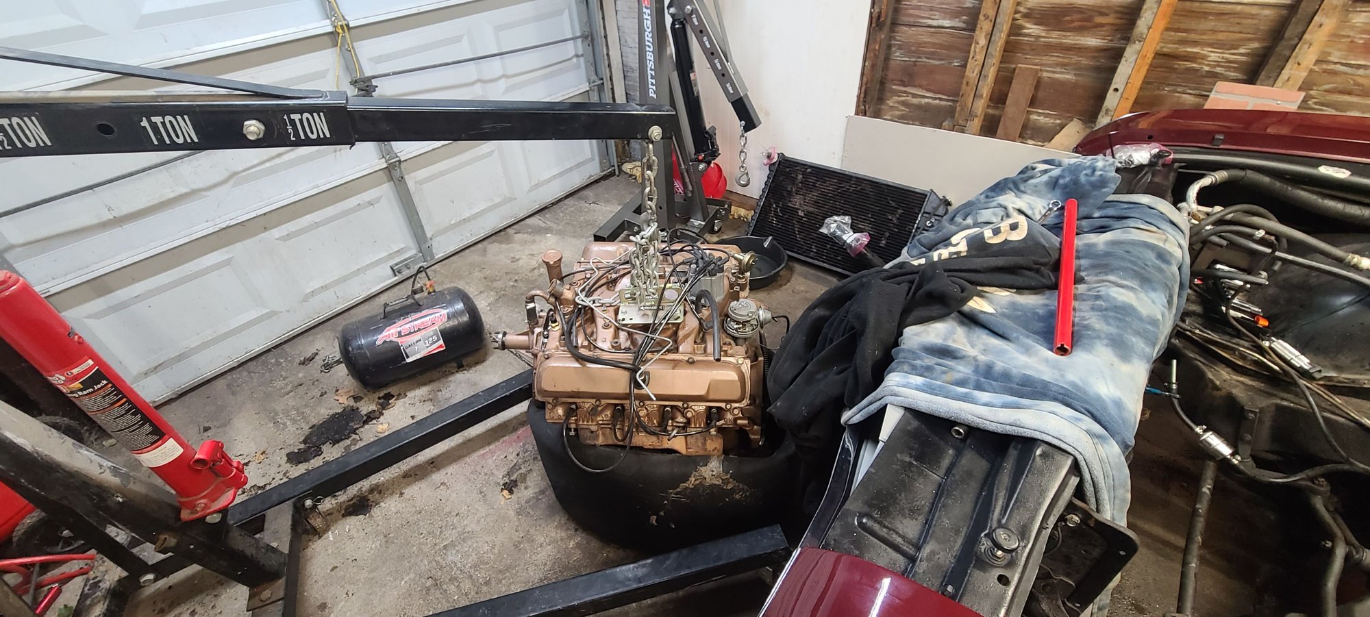

Well..its out. Gotta get things picked up and start working on getting the extra crap off the engine and ready to be shipped out.
Evidently, the frame pads for the engine mounts were a little wallered out..that may explain the excessive amount of shaking the drivetrain did.

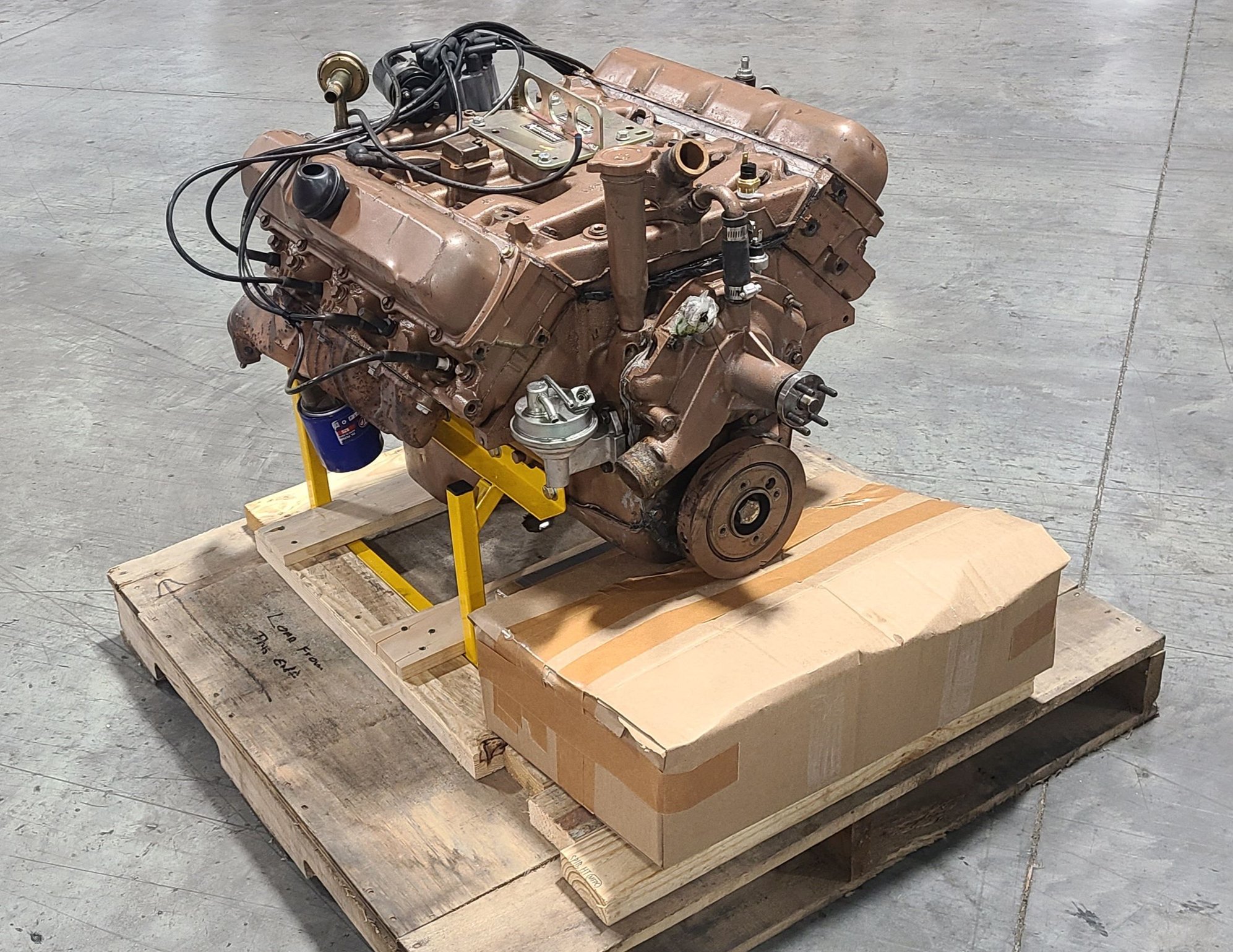

I'm sending it down to @cutlassefi. I'm not thrilled about having another engine bill, but I'm confident that he's going to not only find the issue, but correct it and I'll finally have an engine that'll run like its supposed to. I've bothered him enough with it over the years, whether it be asking the same question multiple times, or what have you..it's time to just not only admit I'm over my head, but get it done by someone who knows what they're doing.
I'm looking forward to the updates on it once it gets down there and he's able to start the process, but in the meantime I'm going to just keep myself busy cleaning/detailing out the engine bay. I've got a new (to me) EVAP box coming, so I'm going to replace the guts in it, paint it, and then pull my old one out to swap them. I've got a few more things on the list for engine bay stuff anyway (plus guitars that need work) so hopefully I'll be able to knock all that out and be ready for when the engine is ready to be reinstalled.

For the season finale of 2024...
We're all collectively anxious to see what the preliminary runs will show. Both overall health, and what direction to go in order to correct the issues.

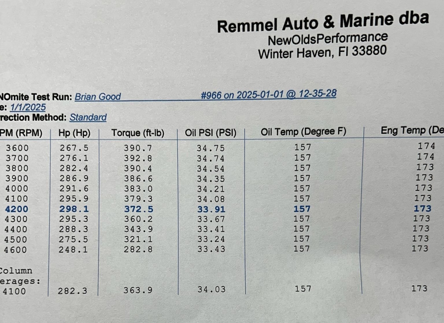

Preliminary test results show a few points of concerns. Oil pressure is an unexpected issue, but it also is missing above 4400 RPM, and is overall just down on HP & TQ compared to where it should be.
A couple more tests will be run for further troubleshooting, but beyond that I think the only thing keeping me sane about it is the fact that it's in good hands now.

When I first got it back, I'd expected at least factory numbers and had hoped for a bit more. Not even hitting factory numbers though was a surprise.
I have no doubt that it can achieve that, and then some once it's finished, however my main focus is to have a healthy engine that'll run like it's supposed to for another 50 years..lol

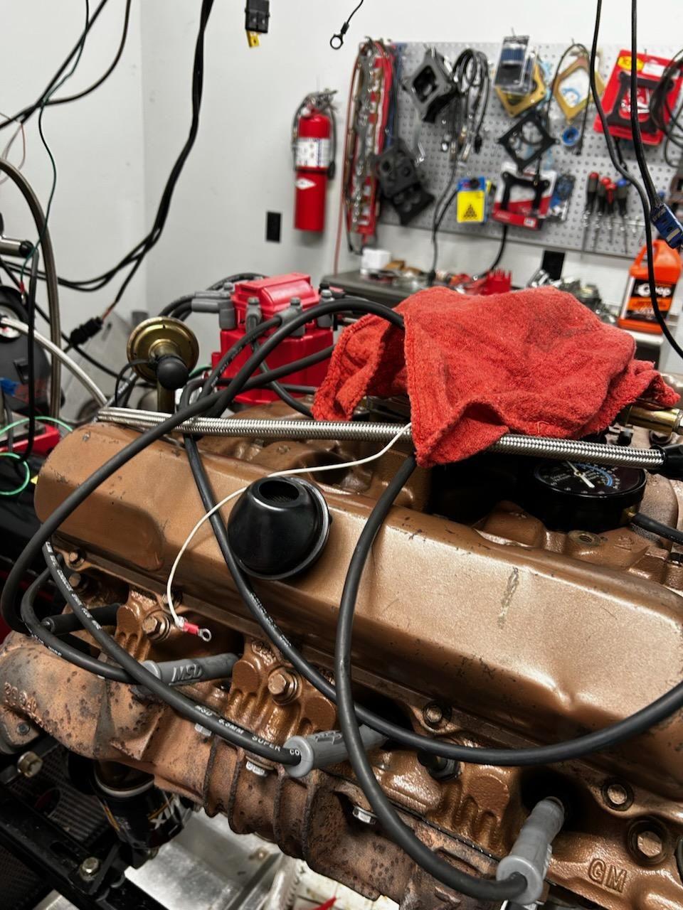

Got a bit of an update today. Mark threw on an HEI as well as the Jet QJet. The miss has disappeared and he found about 30hp. The Jet QJet also has some issues (too rich & leaks upon shutdown) but through all of that it's better than it was the other day.
The issues still remain though of oil pressure, low vacuum & cyl 6 & 8 being lower than the others.
The next step will be opening it up, so we'll see what that brings but it's nice to get continuous updates as things progress.

I guess we're about due to bring this back up to the top.
Super long story short..the previous iteration of this engine needed much more help than either of us expected..but we're nearing the end. It was actually on the dyno a couple weeks ago, and made 403hp/438tq while lean. I say a couple weeks ago, as due to a fluke incident..it had a valve stick open. Shoutout to Mark though..for tearing back into it and investigating what happened and working to get it fixed correctly. It ended up being a fluke deal, thankfully, but should be fixed, back together, and back on the dyno (most likely) early next week.
I am beyond ready and excited to get this thing back and installed, but also thankful that A. I know itll be right, and B. Its going to have more power than I had expected.

Glad you have someone who stands by his work, Mark definitely does. Not bad numbers for the least loved Olds BB. What compression did it end up at? Curious about the cam specs as well. Yeah building engines is frustrating and expensive, been there too. There is also luck involved and apparently you get none. You sure will appreciate it, once it is done right.
