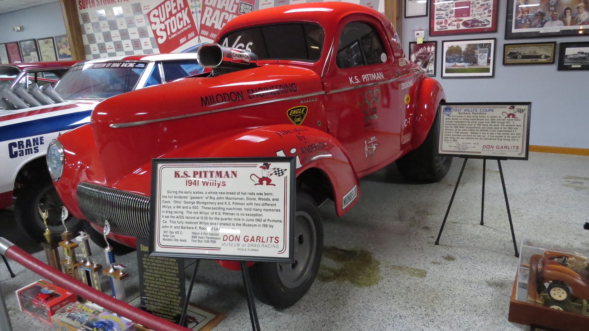

I took the block and crank down to Snow Performance in Saint George, Ut. bout 35 miles south of me. Earl Snow and his son Glenn are super stock drag racers and did the machine work on my 507" Cadillac that I built for a '32 Ford. Really good down to earth guys, Earl loves the big Olds and said he can't wait to dyno the thing. Anywho, he measured the cyl. and said they would be good with a .030 overbore. As luck would have it I found a new set of Wiseco Pro Tru Street .030 forged pistons, pins and rings for $400. I have to go kind of slow on this project as money allows, so when the bore/hone and honing of the crank mains are done I'm bring it home for a while. I also located an '06 4l80e core trans for $200 so now after I buy the Trans-Dapt adapter I can marry the two and set into the chassis to build the motor mounts and set the trans. mount........Dave
Old May 23, 2018 | 03:56 AM
OLDSter Ralph's Avatar
Posts: 5,219
From: St. Paul Minnesota
Old May 23, 2018 | 10:11 AM
Gascoop's Avatar
Joined: Apr 2018
Posts: 130
From: So. Utah
Yea man, isn't that car beautiful in a gnarly kind of way, kind of too bad it's in a museum and not out being driven. I remember K.S. but mostly in his '33 ****** along with all those guys. Another one was Junior Thompson's '41 Studebaker which ran in B/gas supercharged.....still a screamer. Thanks for the pic........... Dave
