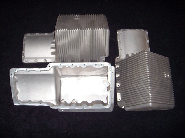

Time for an update, The engine assembly went well. I had to use the 63 Oil pan without the wind age tray because the "blueprinted" press fit pick up tube oil pump the vendor sold me would not work with my 61-62 pan. He said it would be alright but I'll only be running with a 4 qt oil capacity. The problem was the oil drain plug on the 62 pan was hitting the bottom of the standard volume oil pump.I was told by my cam vendor Charles at www.camcraftcams.com not to use the high volume oil pump Mounting the cross member and bell housing with my modified mounts was quite the challenge also. I built an engine test stand out of a stainless steel 2 ton sulfur cylinder cradle I got out of the scrap bin at work. I'm going to fire this engine out of the car so it's easier to fix any problems and set up the hydraulic release bearing. I had the distributor rebuilt by J at www.advanceddistributors.com and he did a beautiful job only to have the postal carrier drop it and did a little damage to it that I've since repaired. I was preoiling the engine and got oil to the shafts but not the rocker tips and the vendor I bought the assembles couldn't answer why the oil isn't coming out of the rockers. But I've come to the conclusion it's a factory design flaw that's new been fixed. So when you see all those rocker shafts on ebay there pretty much useless. I'm going to work with another vendor to try and rebush my original rocker assemblies to divert the oil to the holes. If that can't be done I'm just going to re drill the new ones I have. So the start up is on hold. I filled the block with water and had no leaks before I but the oil in. The radiator is a 3 core ebay special that I will actually use in the car along with the mufflers if they sound good. But I'm out of money for now so the start up is on hold. Here are some pictures.
