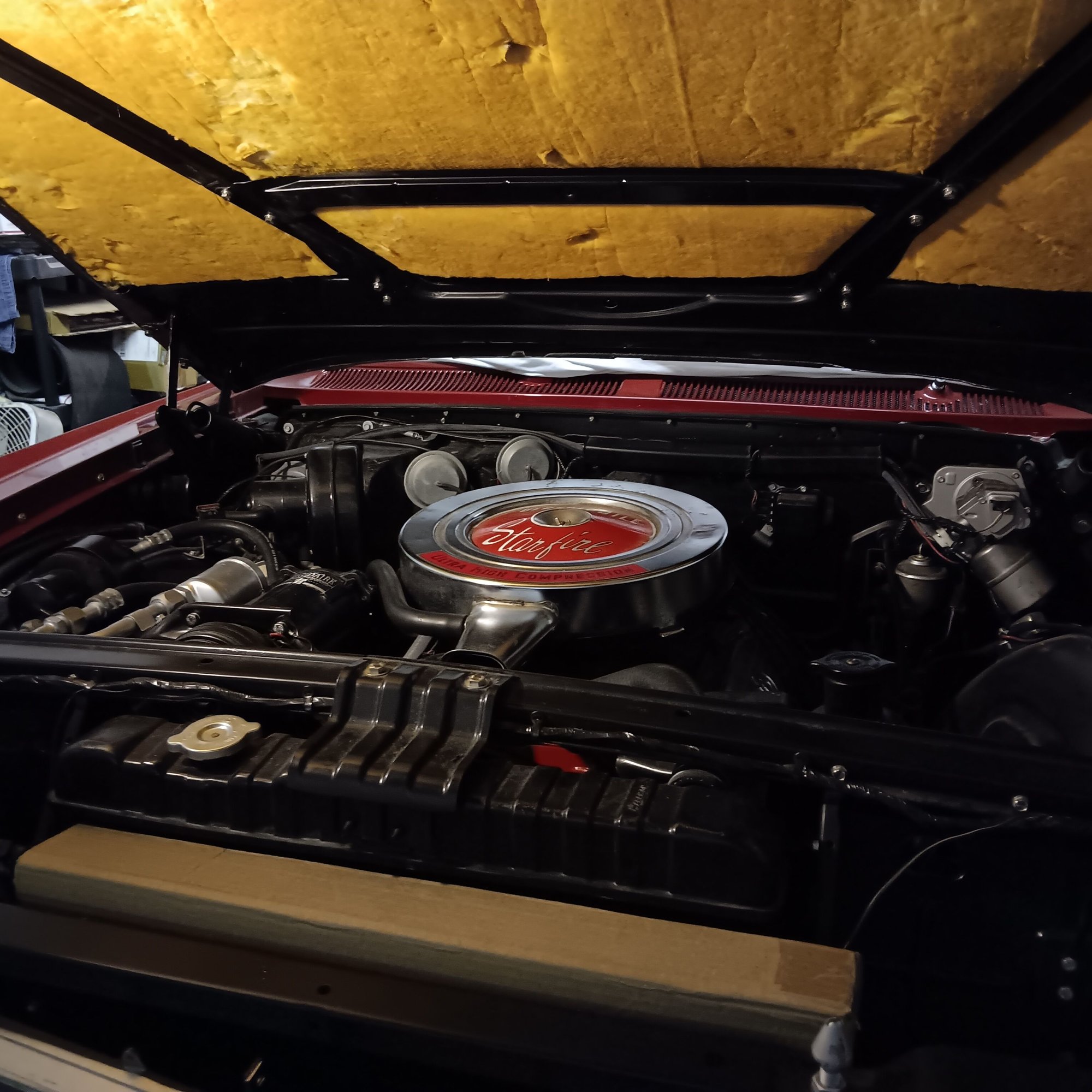

Power review from 394 build 07/18
Hello fellow Olds guys. A lot has redirected my life recently but it has also gave me an opportunity to finally see what all my work resulted in.
Lots of torque! 4500 RPM hydraulic clutch dumps leaves long patches of rubber in at least 3 gears. Chirps tires in all 4 gears, haven't tried anything with the overdrive. That Q-Jet is one serious carb! Will do smokey burnouts from dead stop or rolling, need to get a posi back under it. I had to sell my 3:08 awhile back. My sway bar engineering kind of worked out, the relocated shock brackets at bent a little and I have to drop the links to get the rear tires off. I almost got the brakes dialed in after installing the rebuilt booster. I can easily pull a small trailer with my motorcycle if needed. I was thinking of just wrapping up all of the mechanicals and taking it on a little 1000 mile roadtrip possibly this . Anyway for a 4400 lb car loaded with a souped up obsolete engine and a 4 speed OD trans, it is what it is....a blast to ride around in

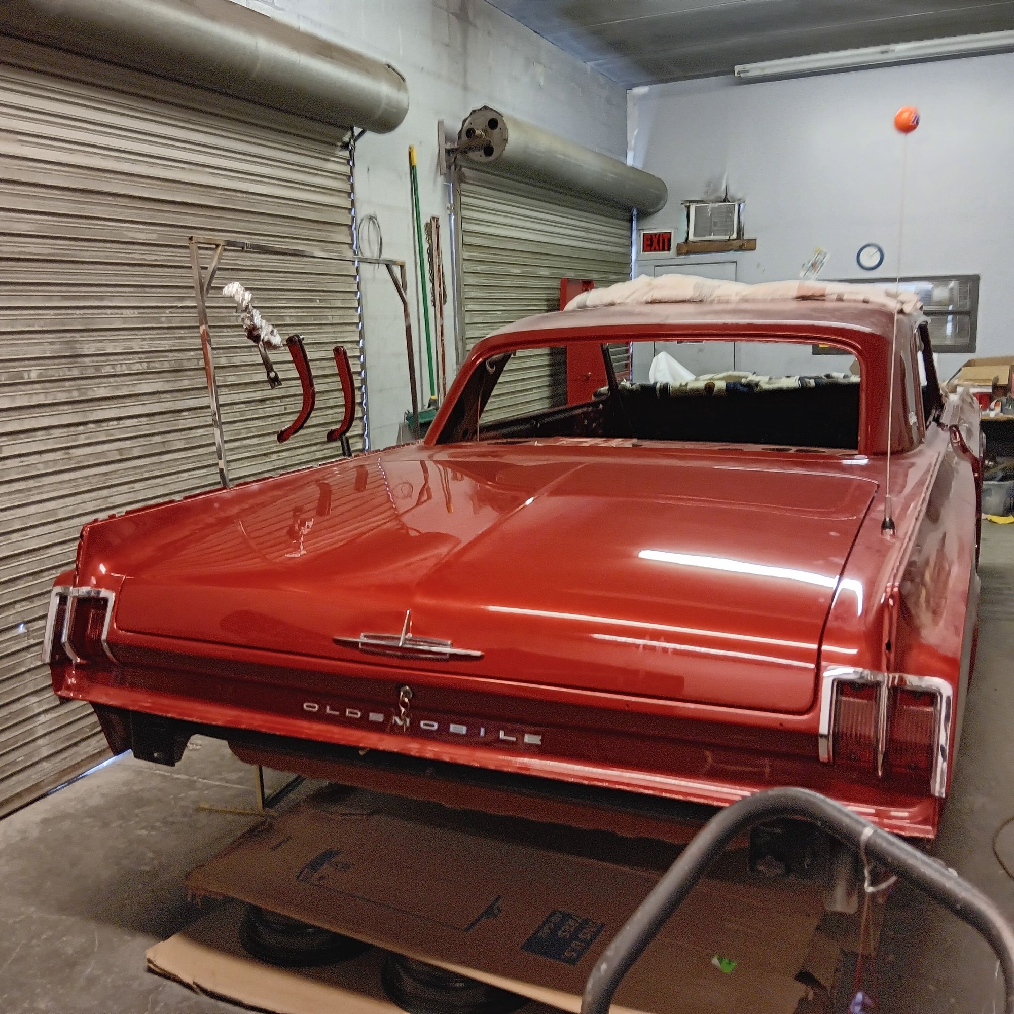

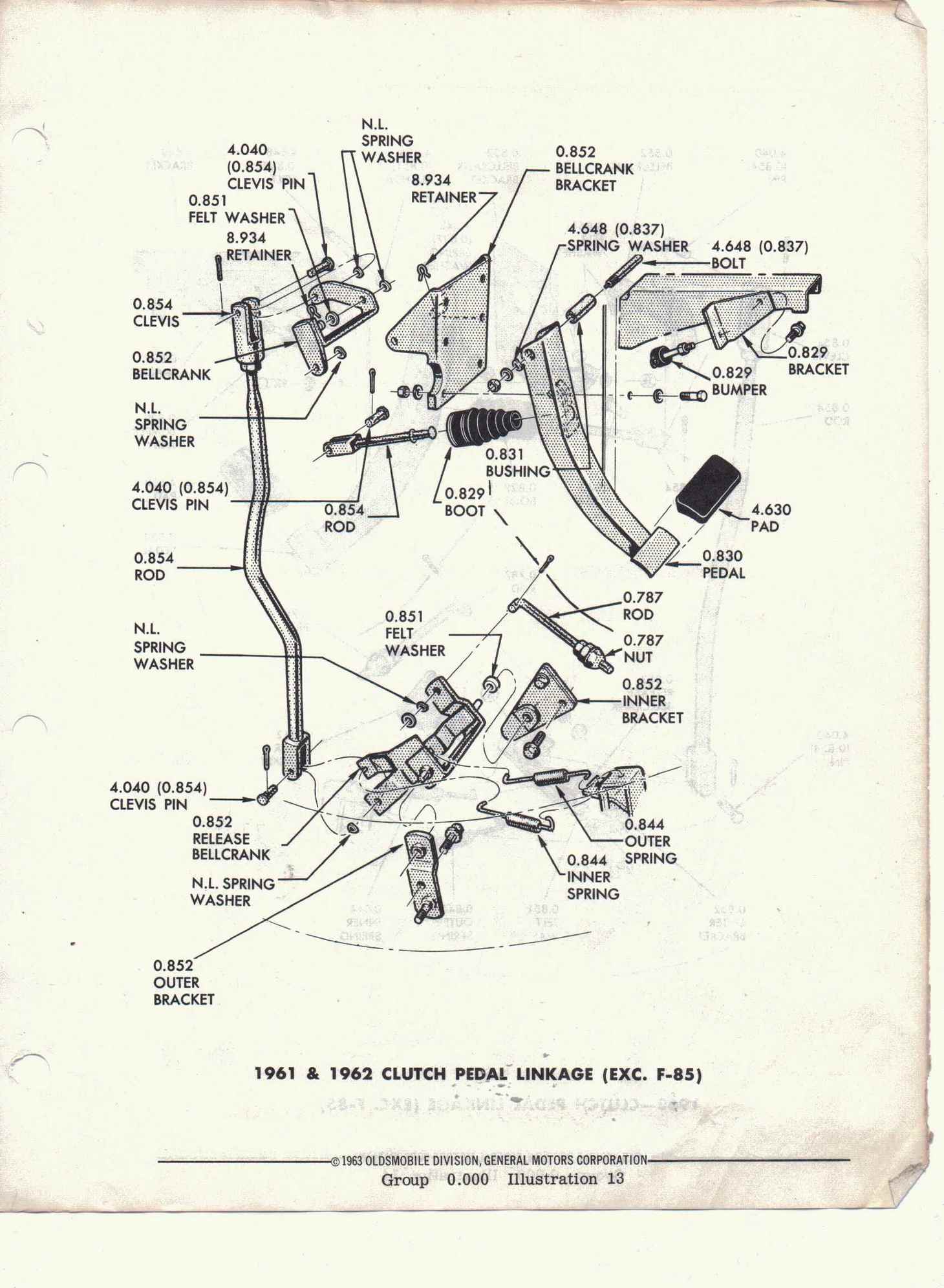

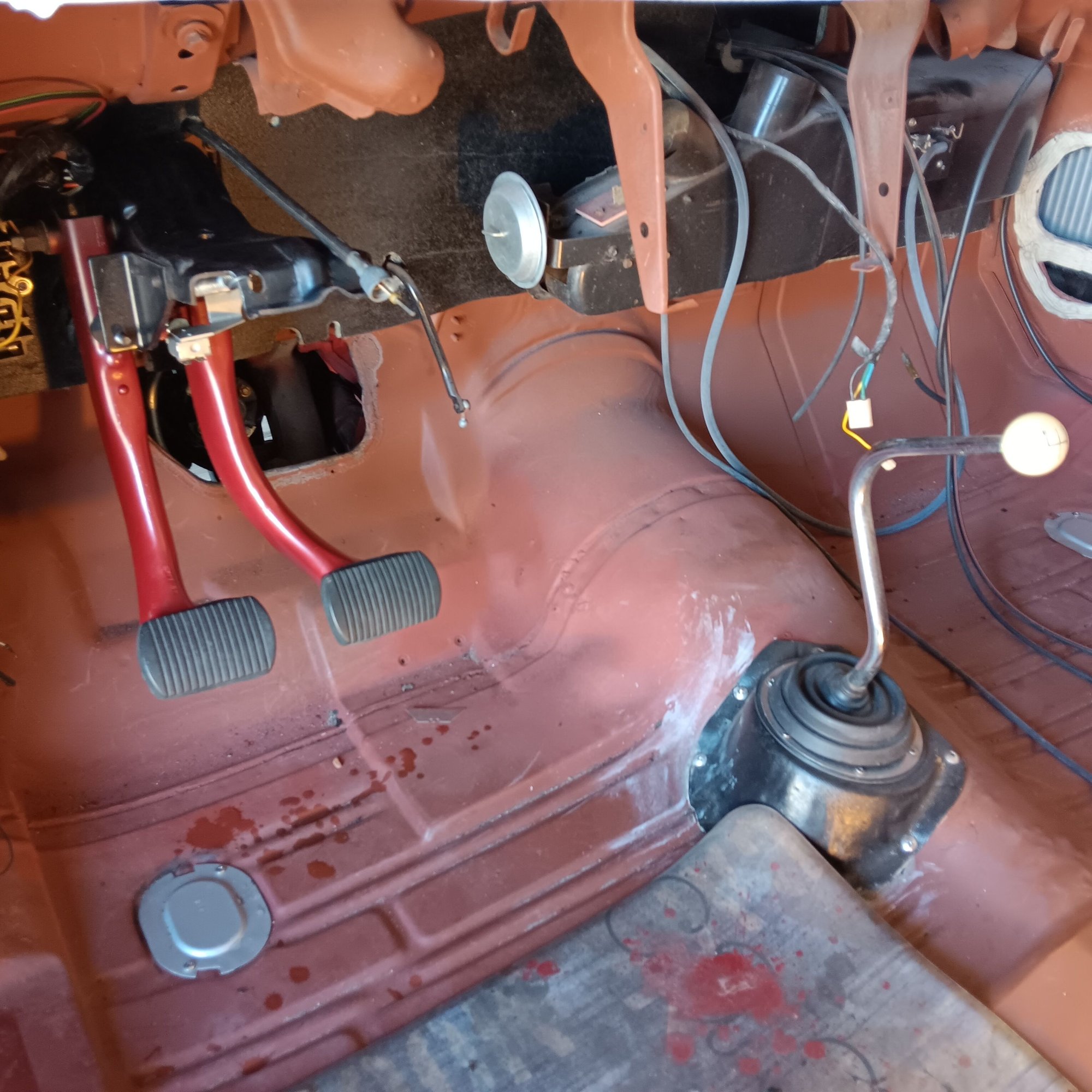

Pardon my talk-to-text Finally got a new workshop space in a warehouse,my hydraulic release bearing shims wer maxed out so when I was at SEMA last year I bought a new upgraded McLeod hydraulic release bearing. SEMA was awesome by the way. My driver side Starfire exhaust manifold also had a hole in it from hitting the steering box caused by the rear mounts moving , so after a failed repair attempt by the welding shop I went back to a regular manifold and I currently carved out some new rear mounts out of solid 3/16 angle that I will add gussets to I'm also fixing a few other things I'm going to have to Cobble together a modified exhaust from the stock manifold and also weld up the rest of my exhaust I had to cut to get the transmission out. The transmission went back in real smooth and now I'm finishing the mounts I tried to post some pictures on here from my phone but the phone couldn't attach them at this time I will post some pictures later with an update I have a new theme in store for the car I'm not going to Powderpuff restore it like I did my last two vehicles this one's going to be sort of a stock car replica That Never Was with removable magnetic decals and numbers. I also scored some Buick Riviera Wheels that I used to run on my 61 Olds Starfire and I'm going to use them on this car but I'm going to Black them out and run White letter tires anyway I'll be updating now that I'm back online there's a lot of great post on here and I can't wait to go through some more of them
NAS Backyard is offline

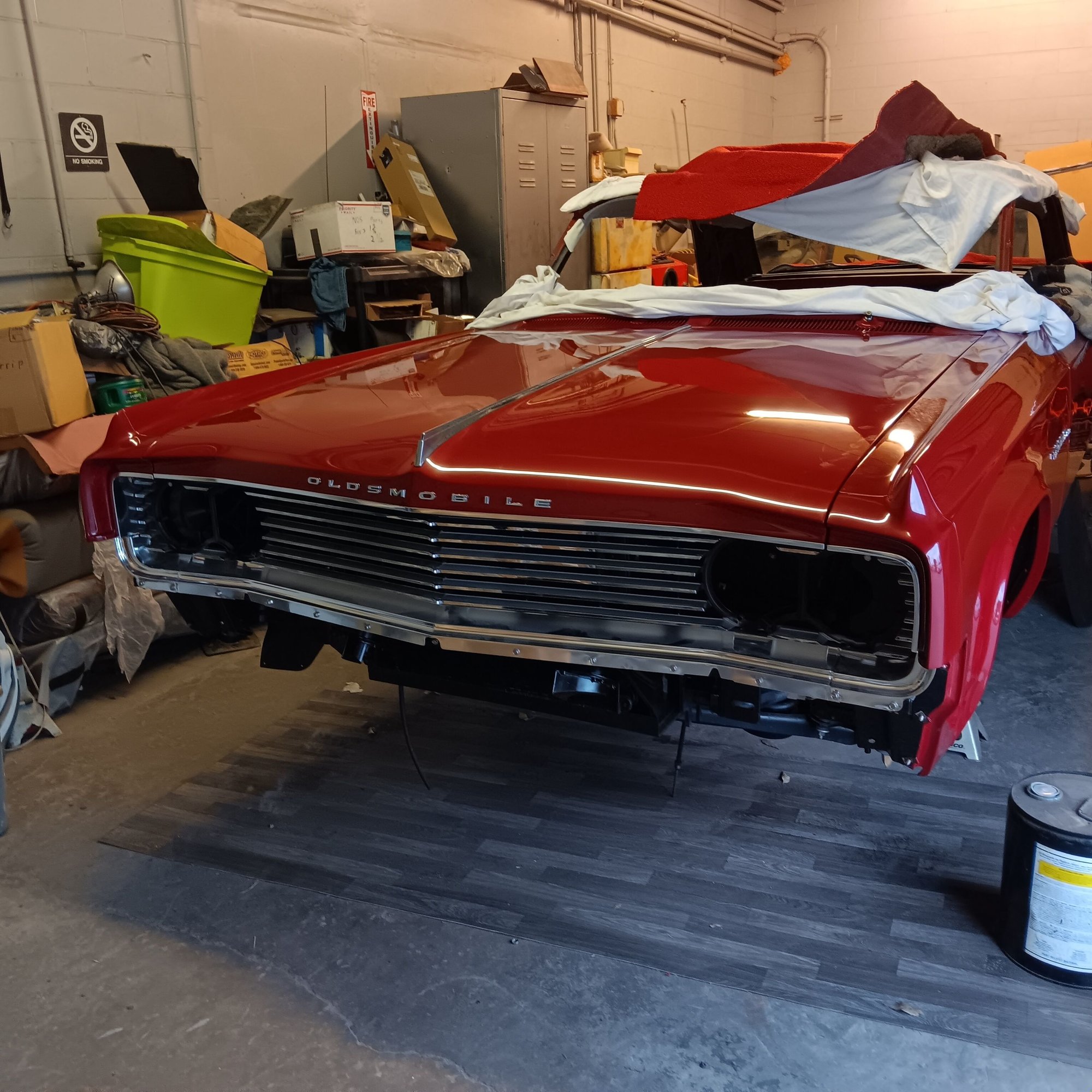

Yeah I was using tinypic and I guess they don't keep them very long but I do have all the pictures on my laptop in folders. Anyway I got my cool hydraulic release bearing Kool hydraulic release bearing bled Out and am buttoning up a bunch of loose ends should be ready for a test drive soon does anyone have any suggestions on how to post pictures on here easier? I think now I can just do it from my phone that's how I did that one with the transmission but the connection wasn't real strong I'll try that again when I have something to post thank you
New seat covers well actually NOS aftermarket that Actually match the interior
