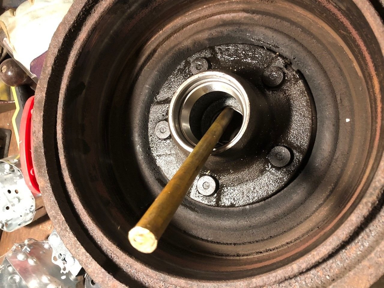

First stop on the rebuild, getting out those pesky old wheel bearings! I had a brass rod lying around and it seems to be working (tapping on alternate sides in the indents).
