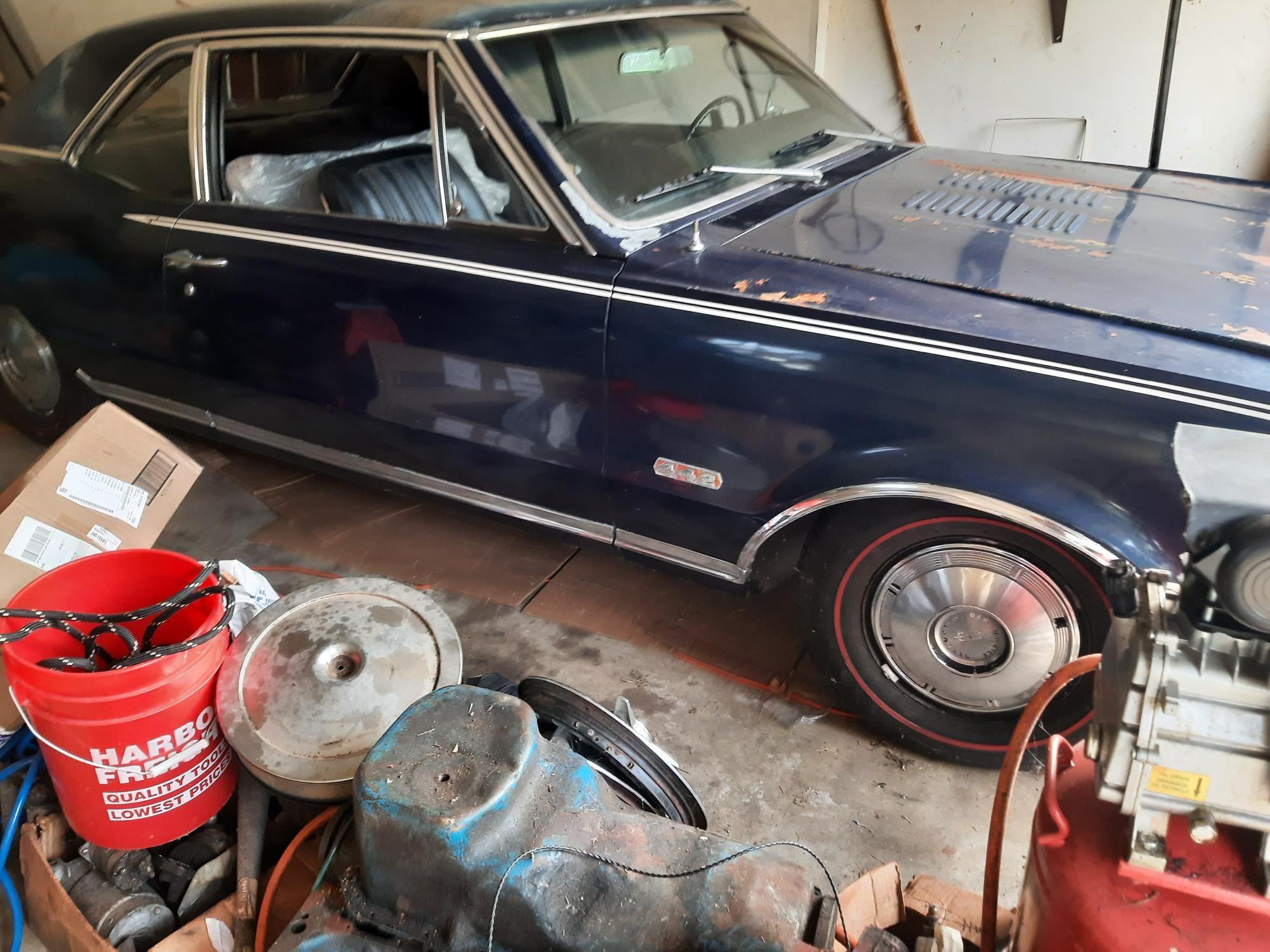

So I was in the right frame of mind when it comes to my 67 addiction and out of the blue fellow member A body messages me. "Hey Joe I picked up a 67 post car and maybe you are interested?" I said thanks but NO and thought man is this guy serious, he knows my addiction and this was like giving matches to a Pyro! He goes on to say yeah its a solid car, 3 speed stick with console, runs drives stops but needs attention here and there and vinyl top has been removed, paint is failing. My interest was growing and I still said no. So then he starts sending pictures. I then messaged another member here Giftman, my friend and 67 guy, hoping I could find some satisfaction if he got the car but after some thought he declined and thats when A body's bait was swallowed hook line and sinker and he reeled me in! So the Giftman and myself spent today going over the car, its solid as a rock, nice chrome and Odometer showing 62,000 miles. I love the 3 speed and console, original E block 400 and pretty much unmolested. The rear is a 323 non posi code SE Olds 12 bolt cover. Initial assessment is the quadrajet needs a rebuild and at a minimum the heads look to have been off. The dipstick tube is installed backwards, newer valve covers are not 67 era and pcv installed on the wrong side. It was told to me there was a noise in the engine, maybe a lifter tick. After we looked things over today it seems the noise is originating from the crankshaft hitting the oil pan and there is possibly the beginning of an oil leak there where the front bottom of the pan is pushed in slightly but time will tell. I will start a build thread here when I start diving into the project. I have to say its the most solid 67 project car I have ever bought. Thanks A body and Giftman 23 for feeding my addiction!

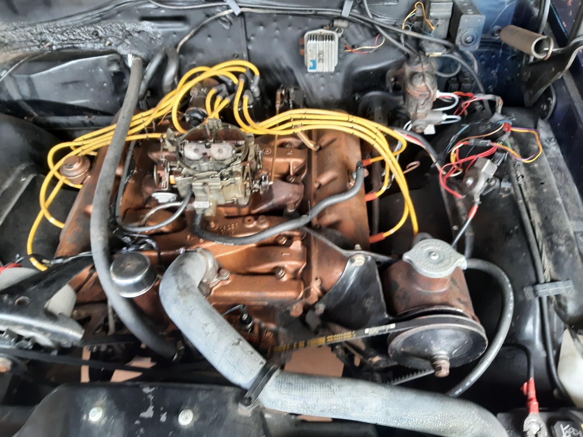

Pretty darn nice. The previous owner liked the car well enough to invest in red stripe radials at some point I guess, eh?
Yes the car has those as well as repro chambered exhaust pipes along with all new exhaust. My issue with the redlines is that they are only 205R 14 instead of the 215's

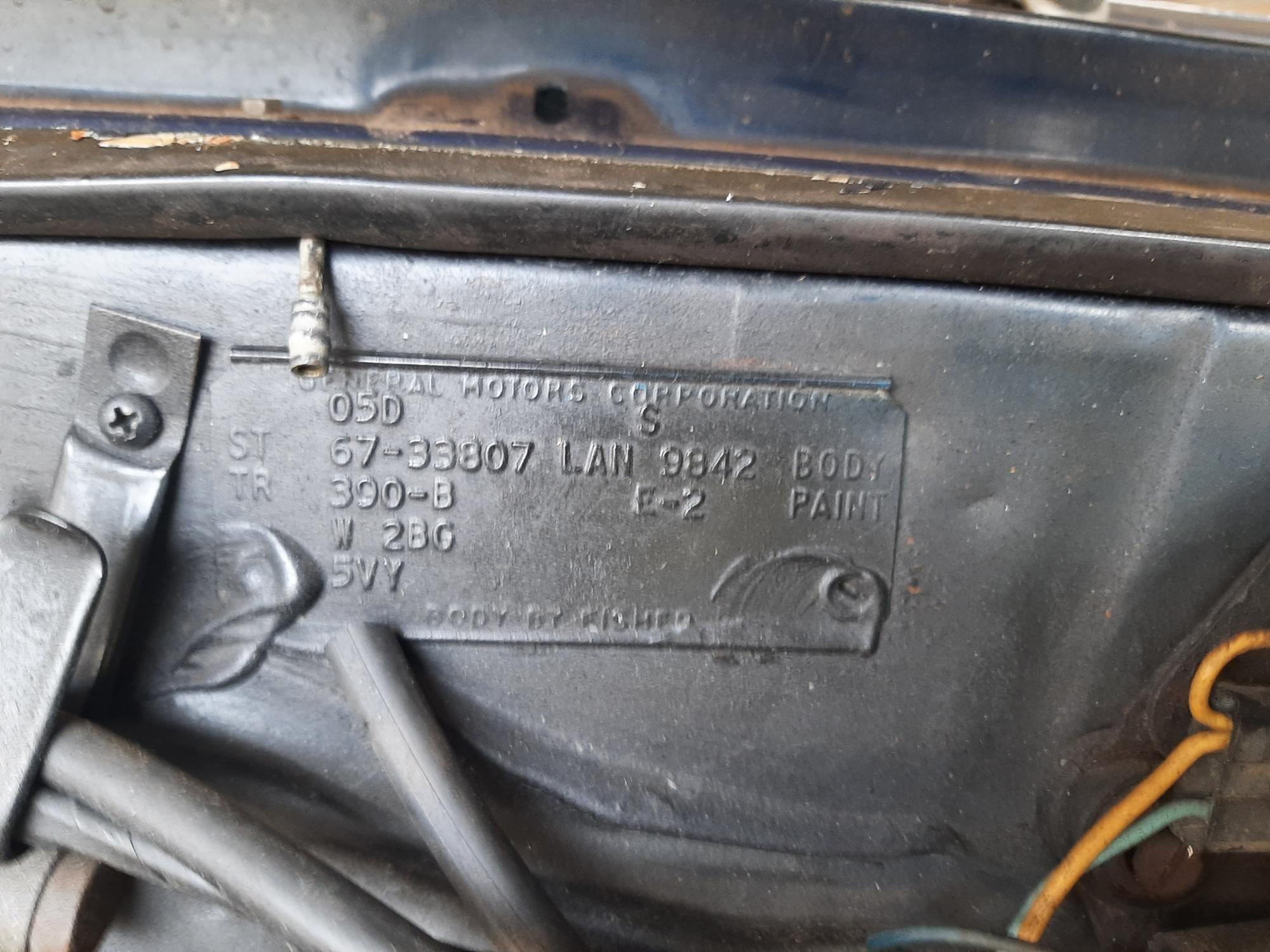

Originally Posted by Bernhard
Is the blue the original color?
Cowl tag demonstrates E2 (lower body color) = Midnight Blue. I suspect it's the original color it doesn't appear to have been repainted.
I think it was painted the original color sometime in the past, weird that the flaking paint is right down to the metal.... poor prep before paint.

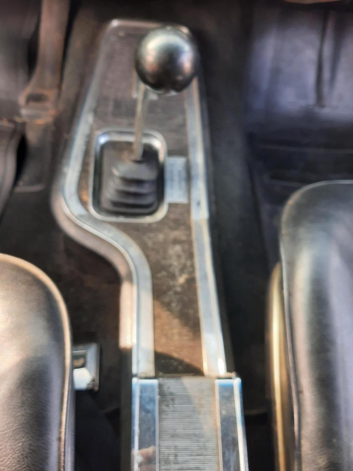

I think you are right, am cured for the moment. The 3 speed is different for sure and people will look and think, oh its a 4speed unless they look closely. When I drive a 4spd I end up skipping 3rd gear at times....

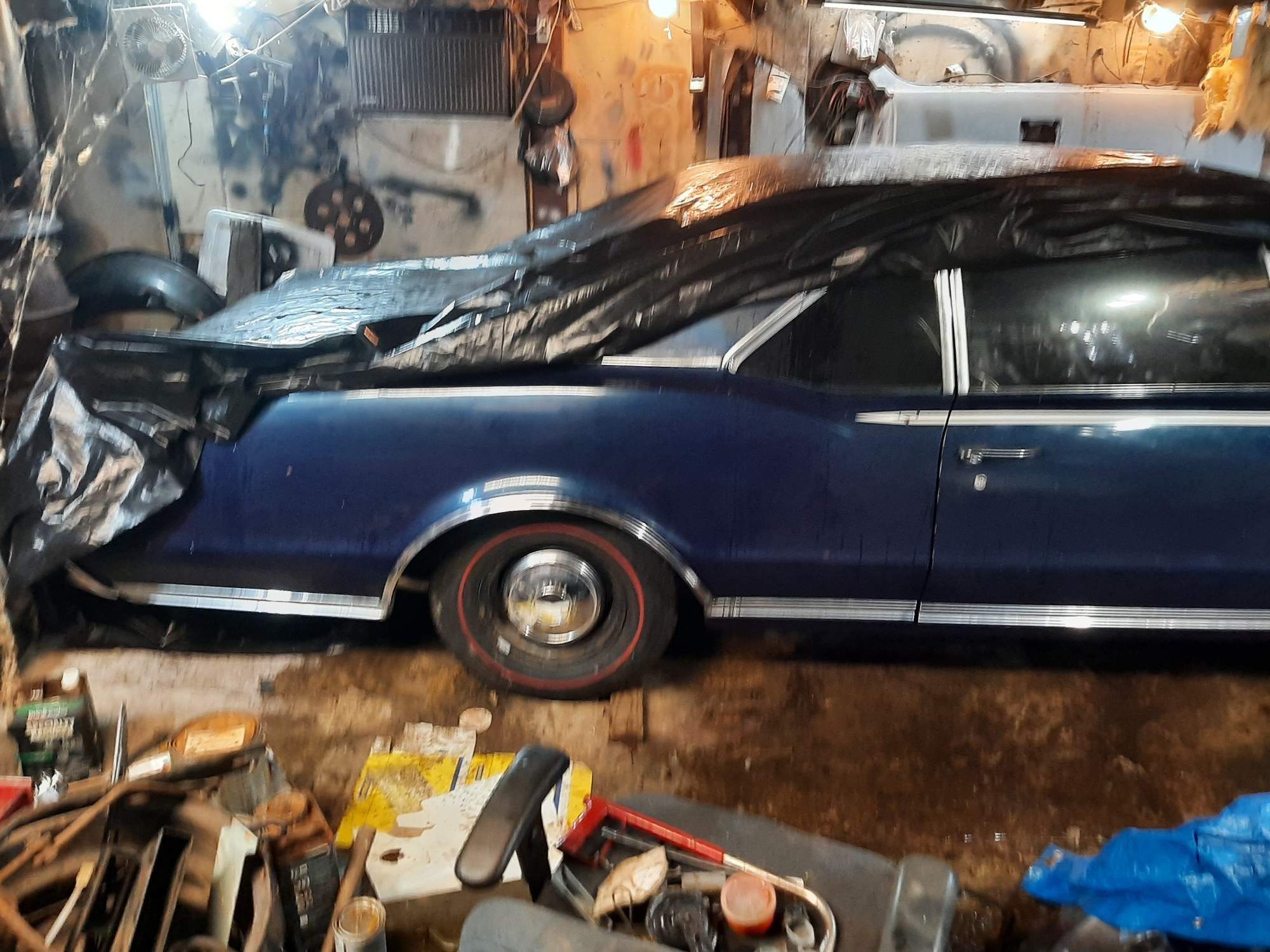

A few more picts.

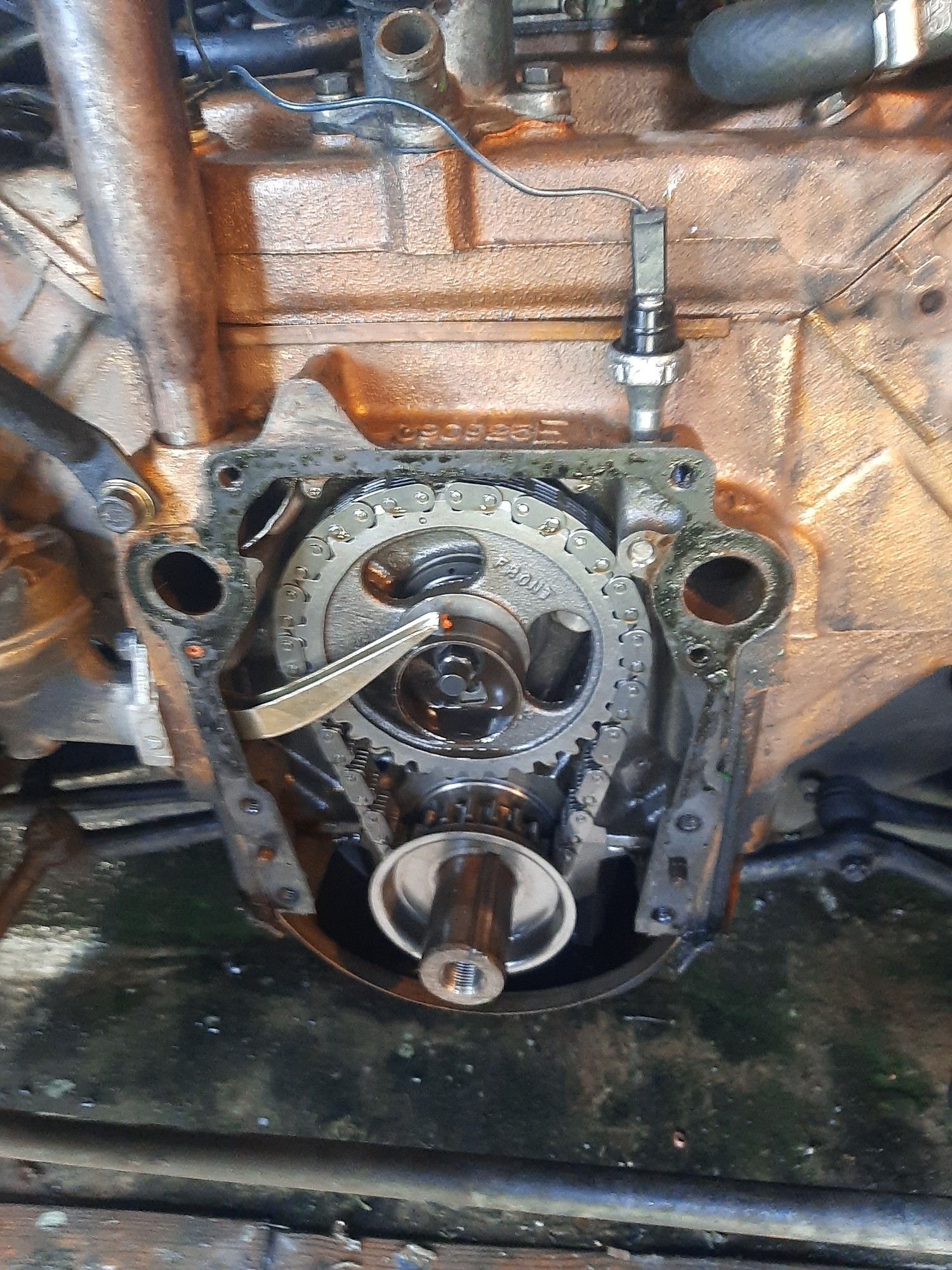

Spent the day fiddling with the 442. I figured I would start the oil pan removal since I suspect the crank is touching the oil pan where it is dented.. Draining the coolant I would say it was straight Prestone.... but was happy to see a new timing chain set and fuel pump. This along with new rockers leads me to believe the engine was rebuilt or maybe wishful thinking. It looks like the front and rear seals on the intake manifold are leaking and no RTV was used, the seals wiggle.
