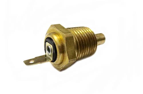

Joe,
Don't know if you found that sender or not?
This is on Parts Place. Their part number is: EL5399Z

Allan, thanks for the pic and link. This repro looks significantly different to an original 6402383 sender. Since it's so visible, I think I'm either going to do that mod I was thinking of or continuing to look for a good used one.
I bought an NOS one a few years ago for the Hurst from Ron Memmer - thought it was crazy at the time that I paid 85.00 for it.
