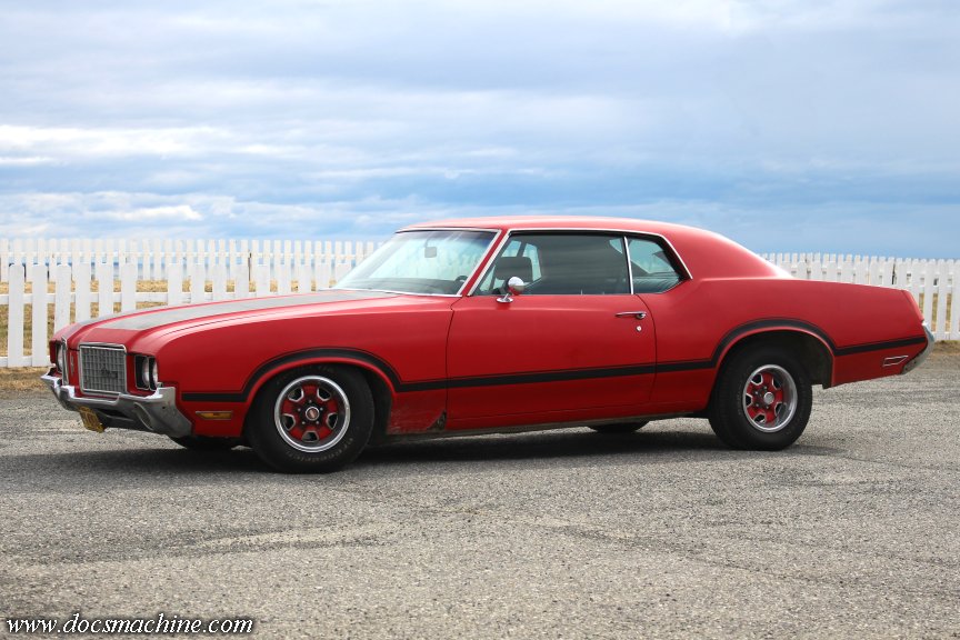

Finally! A dry-ish day I could take 'er out for a proper shakedown spin.
Note I didn't say a sunny or warm day.:
Still barely into the low forties (F) and it still sprinkled lightly a couple of times, but my main concern was road-spray getting splashed up into some of the still-rusty parts of the underbody.
BUT... she ran almost flawlessly.
(Yes, everything's still dead and brown- it's only early May, welcome to Alaska!)
Trans shifts perfectly, and as I said earlier, I can feel the lockup happen a half second or so after it goes into 4th. Really, with the limited power of this wimp engine, and just routine driving, I really don't have an issue with it. I'll probably still install the timer, and give it maybe a 3-5 second delay, but it's not as pressing an issue I'd thought it might be.
A slightly more pressing issue, though, is the speedo. I can't find anyone to 'pace' me in a reliable vehicle at the moment, so I blew it past one of those radar speed-readout signs. I'd ran past one a week or so ago, and the display agreed pretty close to what my SUV's speedo said, so I hit it with the red bomb.
60 straight up on the speedo was 48 on the sign. So that's what, 20% off? That's... rather a lot, really.
Let's see... the drive gear has 12 teeth, and the driven gear- the one that can be changed- is 31 teeth. 80% of 31 is what, rounded to 25? (Can't have partial teeth, of course.
OR... I could get 20% larger rear tires.
The ones that are on it now are about 25-26" in diameter. Bump that up to 30" and I'll be set.
I figure a set of some nice 18" wheels and some good rubber to pad 'em with would only cost me about $3,000 with shipping. Heck, I'm tired of tripping over all these buckets of money anyway...
As for the rest, she cruises comfortably at about 1600 RPM, is surprisingly sprightly from a stop (the 2004R has a slightly taller first gear than the T350) and shifts firmly. Not 'race' firmly, but I'd wager more firmly than the original family-sedan spec. There's been a few cases of having to slow for traffic where I've had to manually downshift to third to get back up to speed, but I'll get used to that.
Long story short, not much else to tell. A quick look shows no leakage or weepage, no untoward vibrations, no strange noises. It just works. I hereby declare this overwinter project both done and successful!
That said, the overall car is a LONG ways from any semblance of "done"- if a shoestring-budget job like this thing can really ever said to be "done". I still have a small list of things to be taken care of, but thankfully the majority of that can be done a few hours at a time. I won't have to have it off the streets for weeks or months at a time.
AND... while I was in town and stopped to get a Cheesy Gordita Crunch, somebody snuck by and put a flyer for the local car show schedules on my dash. I was kind of annoyed they'd actually opened the door rather than slipping it under a wiper or something, but to be honest, I'd been trying to find a copy of the schedule anyway.
As I mentioned, there was supposed to be a small show last weekend, but it was actually snowing that day- and pretty heavily- so I expect that was cancelled.
More to come!
Doc.
