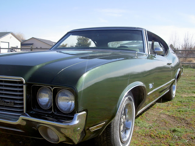

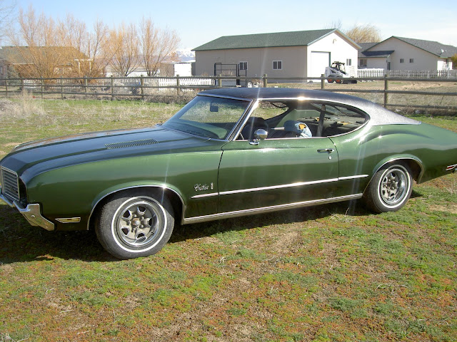

1st Sunlight!!
Here are a few shots showing her out in the sunlight for the first time! Still need to do some sanding and polishing but looking pretty good...
Richey
Old Mar 7, 2010 | 02:01 PM
  #86
70 cutlass s's Avatar
Joined: Sep 2009
Posts: 1,489
From: KY
Thumbs up Oh Yeah
Looking Good.
Old Mar 7, 2010 | 03:45 PM
  #87
richeyb's Avatar
Posts: 209
From: Idaho
Thanks, A big change from the rusty old car we stated with....
Old Mar 7, 2010 | 06:21 PM
  #88
gearheads78's Avatar
car guy
Joined: Apr 2008
Posts: 5,675
From: Dallas TX
huge difference looks good...now get out there and paint the wheels

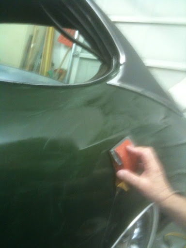

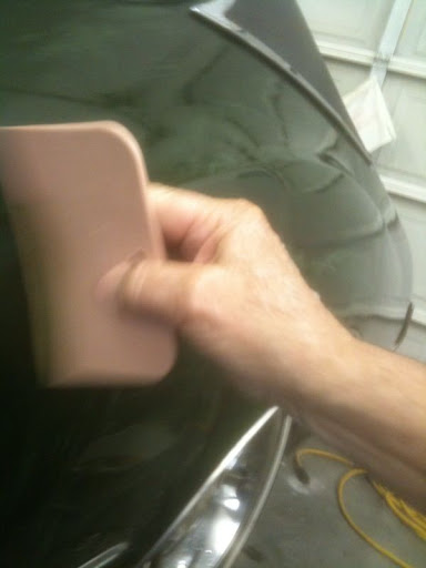

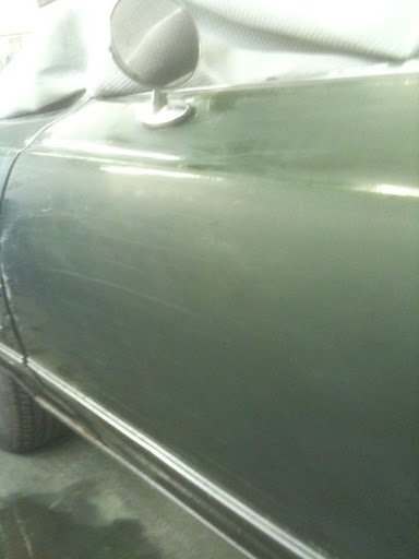

Smile Wet Sanding
Working this weekend to finish up the paint job…. Wet sanding and polishing the sides. I’ll be using 1500 and 2000 grit wet sandpaper working to remove some dust and orange peel..
Wet sanding using soapy water, 1500 grit paper and a 3m sanding block. I also used a spry bottle of soapy water to keep area damp/wet.
Using rubber scrapper to check to insure dull sheen with no shiny spots…
Finished 1500 grit sand and now soaking 2000 grit and watching Butler and Michigan fight it out….
Hope to finish tomorrow!! And polish up with a XXX 1 step polish…Cheers and Happy Easter!!
