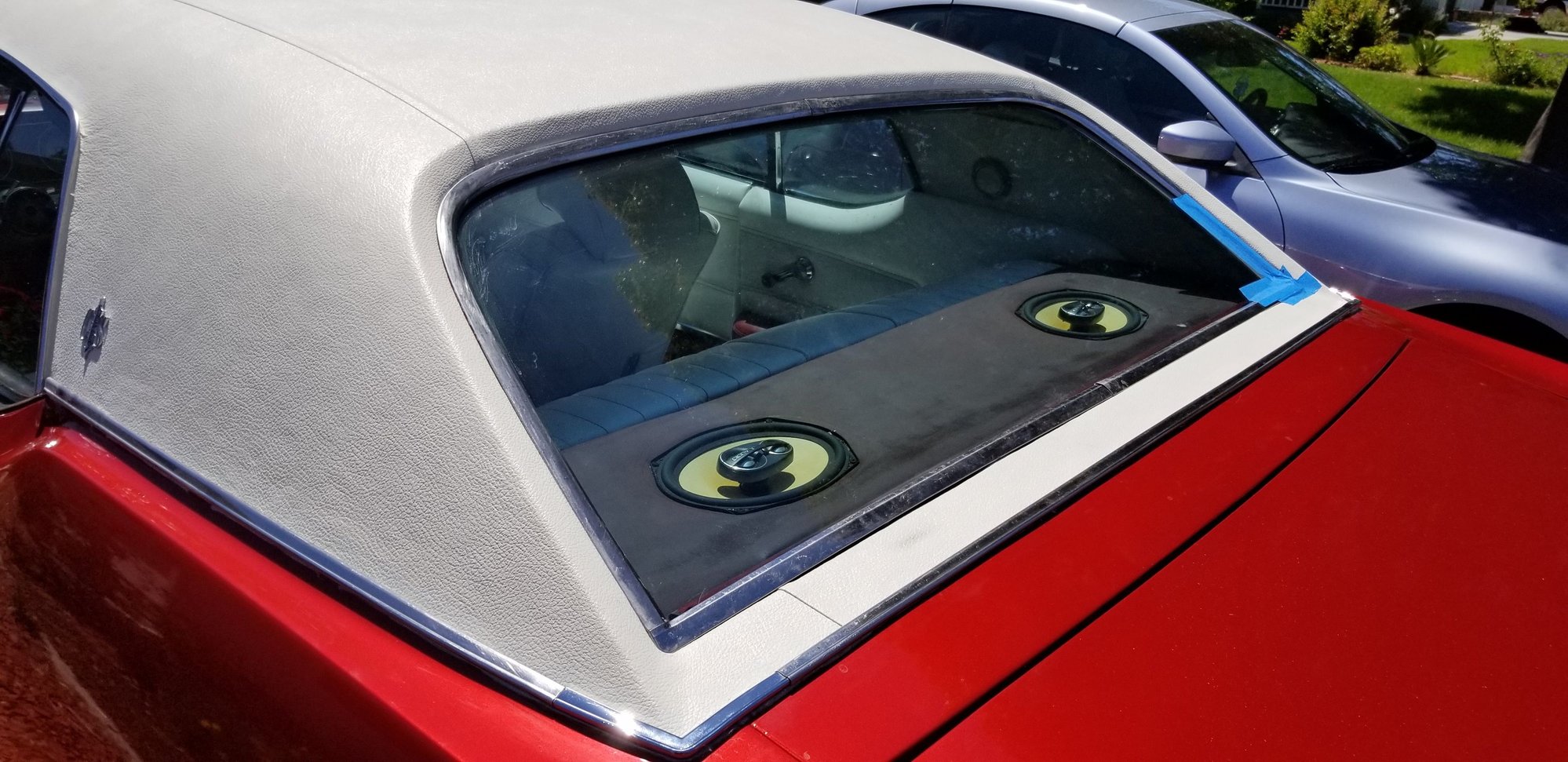

Update time and hopefully later this weekend will have some new pictures. Found a shop that was willing to do the vinyl top. They screwed up a bit. Where they went wrong is apparently the guy that did it didn't bother to mask off the paint, so when he made the cuts and removed the excess, he took some paint with it. Pretty annoyed given, I am pretty sure i could have made that dumb mistake all by myself. They made a half assed effort to touch it up, will see when the trim is on if I can live with it.
Latest issues:
1. My interior lights have decided to stop working, checked the fuses, look fine, so will have a good time troubleshooting that mess.
2. Now that i have the vinyl top, need to figure out how to install the side emblems "C&S" potmetal things that plug into two holes and get secured by a speed nut i assume, anyone ever actually do this? Not sure how to gain access to the back to put on the speed nuts, suppose I can just use 3m molding tape but would prefer to do it right

C/S emblems on the exterior rear sail panels are friction fitted using small expansion clips over the spokes, no speed nuts.
I like the roof painted red in your photos, but if it were mine i would go black top.

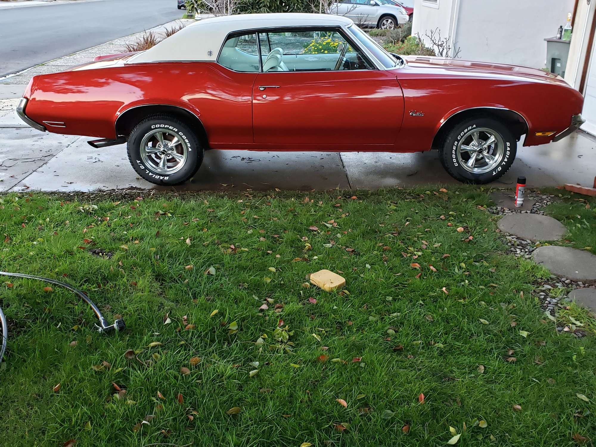

Post Vinyl Pics...moving things along
Some of you may have already saw the pictures from my question thread "So what happened was..." where the site gave me advice on how to get the emblems on the sail panels. Great pictures provided if you find yourself ina similar spot look that thread up.
Didn't do too much post vinyl, slapped on the drip rails, cut out some of the vinyl clip areas and did some minor weatherstripping replacement.
Lots more to do, but here are some updated pics post vinyl for those following along.

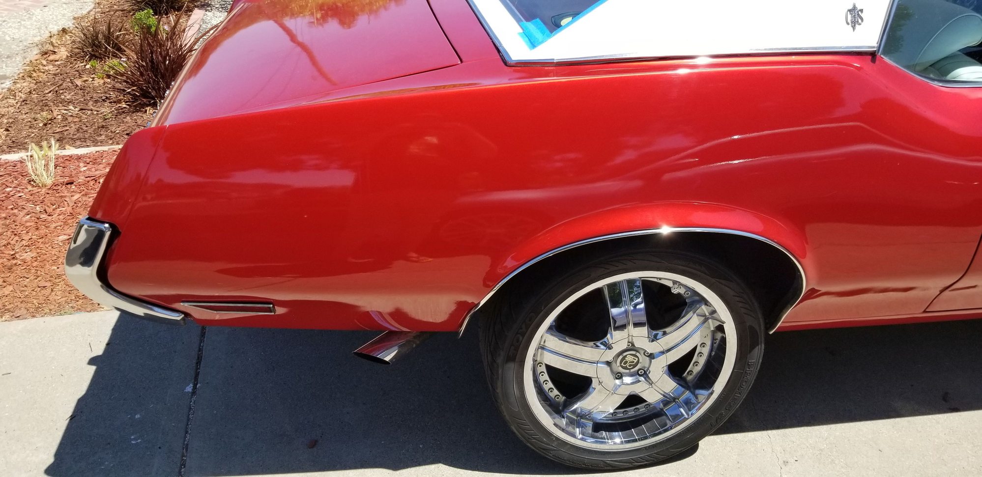

Has been way too long since I gave any updates, apologies!
More small bites taken:
1. Most of the trim/molding is on now (still need to put on about 5 pieces on the exterior)
2. Front and rear windshields now in all the way
3. Think I finally got my gas mixture right due to the high compression engine, needs about 93 octane to kill off normal driving pinging, and 95 octane if i really want to gun it. In California 91 octane is the best you can get at a normal gas pump. Do have one local station that has 101 octane so I just fill up some 5 gallon cans and mix 2 gallons of that with 8 gallons of 91 and the old girl is happy 99% or the time. If I know I am going to be hard on it, will up that to 4 gal 101 to 6 gal of 91.

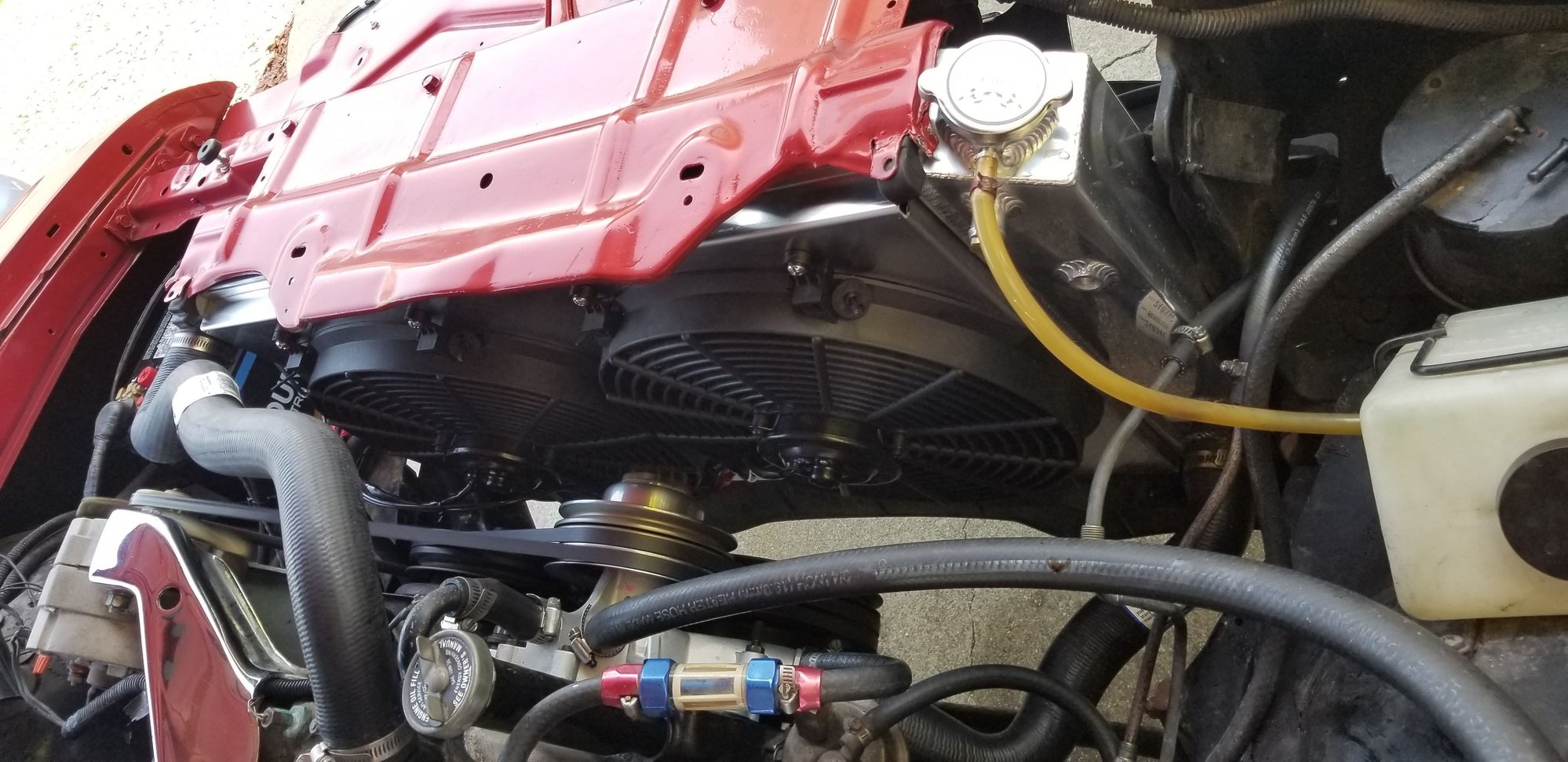

So took a nice long 100 mile drive and just could not shake a cooling issue any time I was stopped at a light for longer than 5 minutes. Nothing visually wrong that I could see and when moving, cooled right down so wasn't terribly worried.
Buuut, I can't leave things like this alone so started giving things a better look over and reading all the threads here about people overheating and blah blah. Followed what people said and didn't find any easy wins.
Bought the prestone flush, pulled the lower radiator hose to let some fluid out, and dumped in the flush dluid and filled back up with distilled water. Drove around for 30 minutes and proceeded to flush it out for about an hour. Lot of junk came out, it felt productive. So thought I would let her heat up again and see where I was at. Still overheating but then it was up to say 10 minutes before it would get to 230. So stepped it up and got two bottles of thermocure and let it do its thing for a few days. I only drove the minimum amount of time (4 hours) and then dumped the fluid out. Was very nasty black and smelly. Flushing was taking forever and it was so black that I figured, screw it, and pulled the water neck off and thermostat off as well to speed things up.
At this point I decided to remove that radiator cover, top metal piece, to really give it a better look over. Boom! I see a small leak on the other side of the radiator. Looks like it has been there a looooong time too and that folks had done the stop leak thing to it, a few times.
So now that I have everything out, the radiator, goose kneck, thermostats, I notice gosh it sure would be easy to change the water pump now.
So in typical me fashion I am now knee deep in another good time.
Have the ebay special 4 row champion radiator with 14" electric fans shipping, flowkooler water pump and gasket, thermo stat, bypass hose (cut it on accident) also on the way.
So think this is that point where the budget, is out the window. One nice thing about having fun and taking your sweet time and actually driving these old rigs, is it allows you time to get more $$$!
Will be interesting to see if this overkill gets me where I want to be, which is a solid cooling system I feel comfortable taking over the mountains in hot weather. I have read others comments on you shouldn't need all this to keep them cool, and maybe even agree on a technically accurate level, but see no reason not to take advantage of the modern tech to help my cause. A rock works but a hammer works better.
So the engine compartment is no longer a virgin to me. Such a pleasure to work on this car as opposed to some import that you have to remove half the engine to see a starter.
Looking at my list above again, did a half-*** cut n buff of the hood only, not so sure it is worth it. While looks better, doesn't look that much better so will see if I get bored enough to do the rest of the car. Have still done nothing with wheels, tires, suspension or the front end.
Had another embarrassing moment on here, asked about a part I thought was something to do with the A/C, if I could remove it. Turns out it is an aftermarket transmission cooler, so guess I will keep it and see how I can incorporate it with new radiator and fans setup.
New fun problem, interior lights decided to short out, someday will figure that out. No shortage of work at this point and takin g advantage of nice weather after work each day to get a little more done. Somewhat stuck at the moment waiting on parts to start arriving.
Pictures are just of the nasty water in the buckets and just a general one of the water pump.

Pic of the end of the day with new radiator hoses, new alternator and power steering belts, new flowkooler water pump, molodon thermostat and champion radiator, 14" fans with shroud installed.
Since it now cools insanely well, need to get a hotter fan thermostat temperature sensor so it wont turn on till 200 degrees and shut off at 185, to go with the 180 degree thermostat. As far as I can tell the current setup turns on at some really low temp, like maybe 160 degrees. American volt had a 1/2 NPT fitting that looks like it will do the trick, got a 200 to 185 and a 190 to 175 in case they have any variation I dont like and frankly power vs grounding 1/2 NPT units are getting hard to come by, so other will serve as a back up if it works out. Feeling a bit miserly, starting to stock up on anything that fits well!

Finally found a set of wheels I can live with, and purchased some Cooper tires. Went to get them installed and...problem! Didn't even see it coming AND will also expose something, I apparently have never even attempted to remove the wheels! Never needed too, with the big old 20" rims everything was very much so accessible.
So after getting the new wheels and tires mounted, went to install them on the car. Front driver wheel has a seized lug nut and a broken wheel stud to boot! Suppose I am lucky to have driven it some 1k miles like this without additional issues. So will see how big of a deal this will be to get fixed up. Seems like a labor mainly issue which is right up my alley, parts are a few dollars. Will see if I can do it.
If curious what I went with:
Wheels: 15x8 Ridler with -12mm offset, link: https://ebay.us/Byp0Wo
Tires: Cooper 245/60r15
Goal of course being to get away from the "donk" look and get back to a more classic/original look. Also will be nice for the speedo to be somewhat accurate, currently shows 70 when going 80. 15" wheels with more tire looks better to me at this point in life. Will see when on the car though. Keep in mind anyone looking at older pictures those 20" rims have 275/40/20 tires on them, which is much taller than stock. So may be of interest for anyone else in a similar situation.

Small items fixed up along the way, put in stereo and speakers. Nice to have tunes. Purchased some kick panels and they worked out well, painted them to match. Also took some time to clean up the wiring under the hood, has made a huge difference in the one off random electric issues, just a ton of corroded wires replaced. Got way more out of that than I expected. And last thing of interest is fixed the seized lug nut and replaced wheels n tires fully now.
