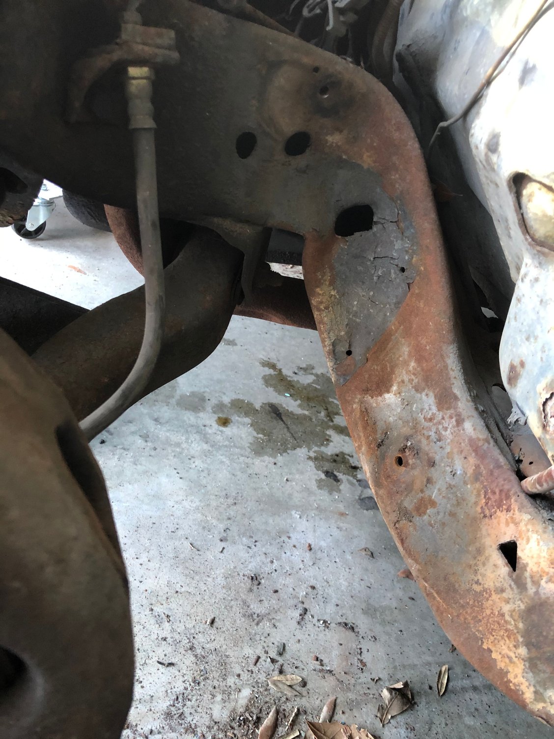

Last week I bought this 72 cutlass convertible. Finally got it into the garage. Took the core support off and boom! Is it me or is this frame severely bent?!
I’m literally standing right in front of it. Im
not sure what to do at this point. Any help. Suggestions. Please!

Hard to see what your looking at?

From the front horns? You will need to do some measuring , I’ll see if I can find the specs for you, frames can be straightened and worse case replaced all is not lost please explain your concerns better as was said hard to see what your referring too

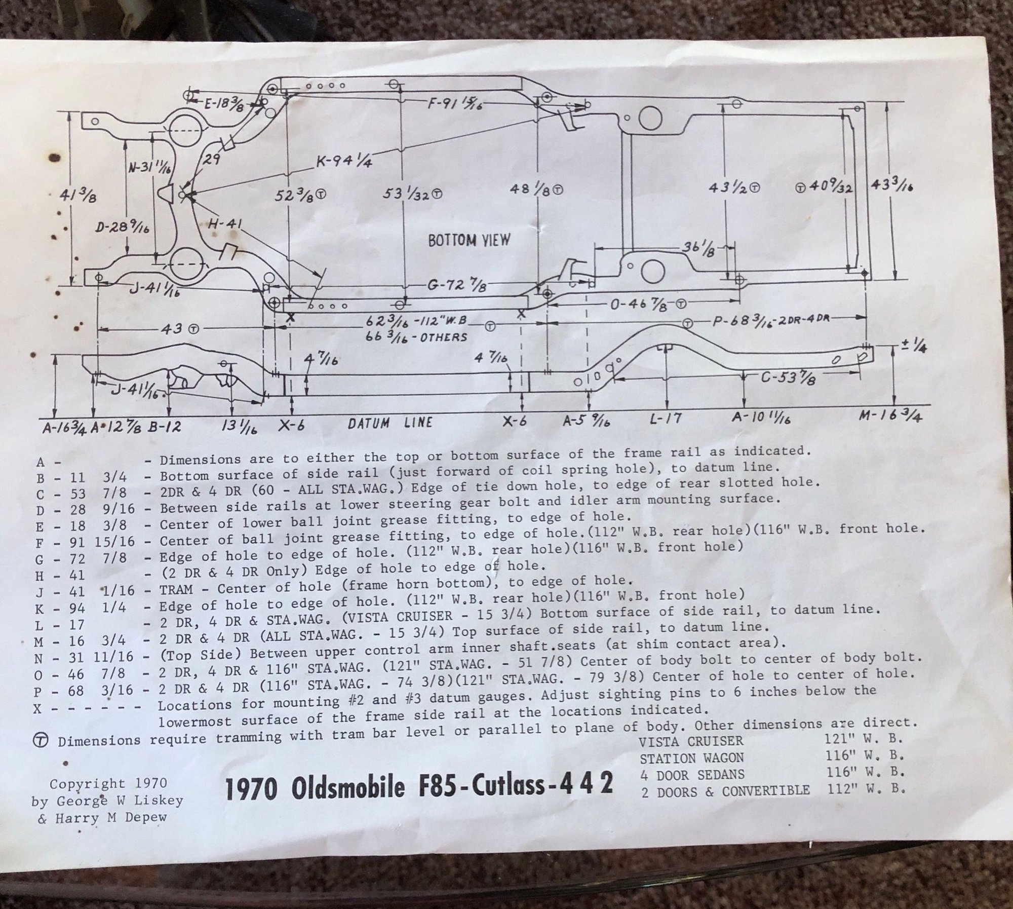

Old Jun 17, 2020 | 11:45 AM
tdhill01's Avatar
Posts: 1,138
From: Middlesex County, MA
Here is a frame chart for the 70 Cutlass 442 models, it should be the same for your 72.

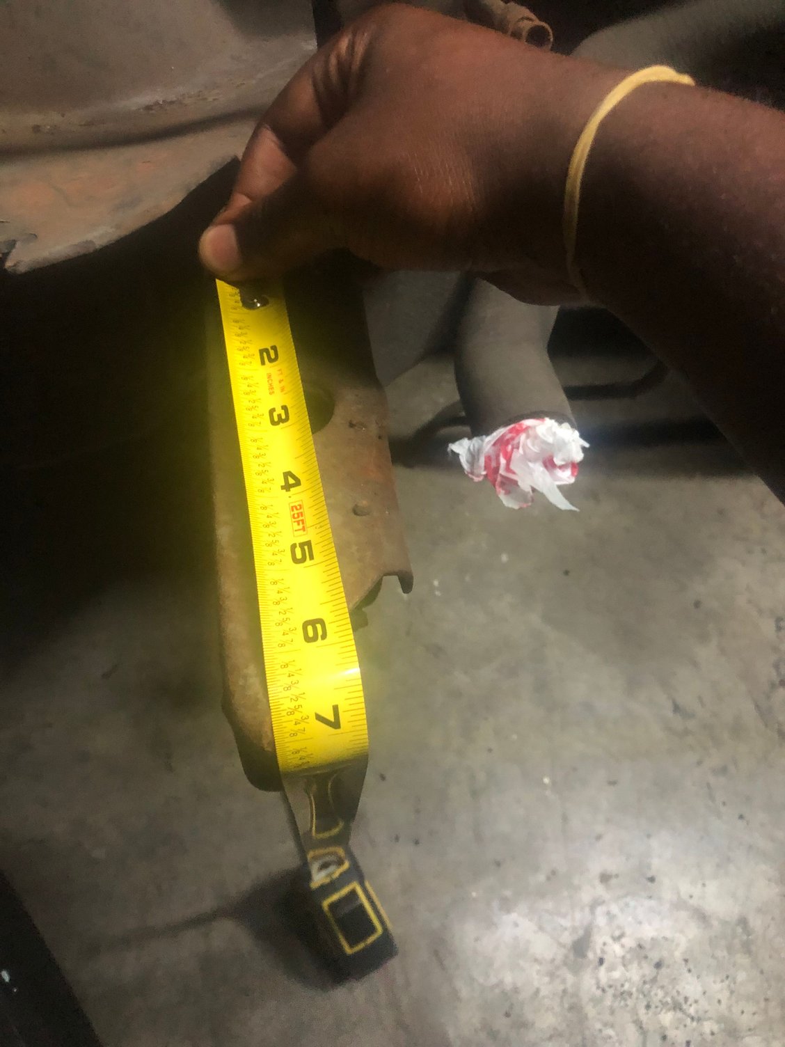

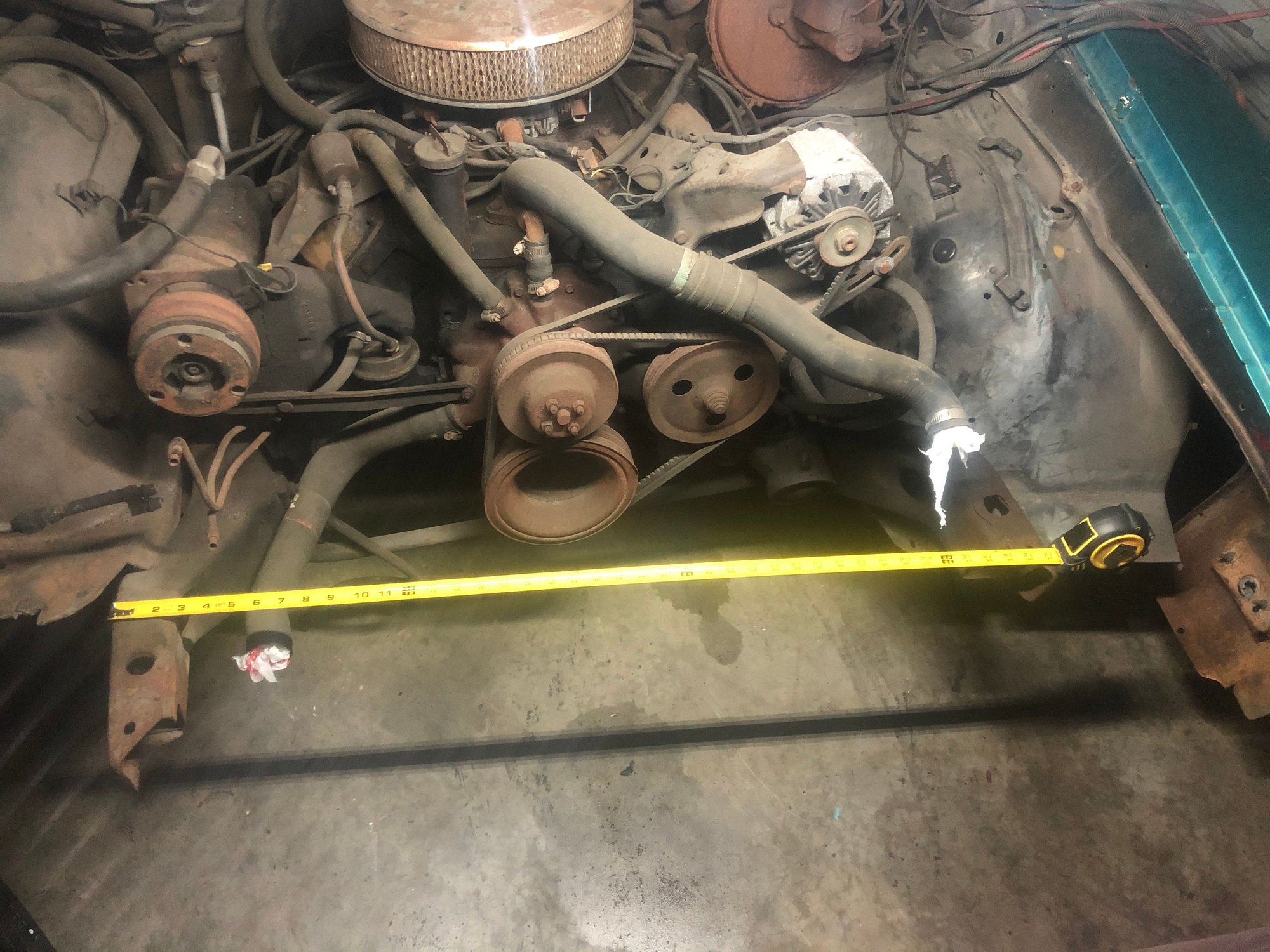

Old Jun 20, 2020 | 06:20 PM
Foushi's Avatar
Joined: May 2020
Posts: 7
Got some work done on the vehicle today. Verified that the frame itself is actually bent on the drivers side.
Used a measuring tape to go straight across to give you guys an idea on how off that side really is.

Is it shorter by ~6” on the DS? Where did that length go? there must be a significant crumple somewhere. the frame doesnt appear to have much rust perhaps a donor piece could be spliced in. If not donor frames are availible.
Old Jun 21, 2020 | 07:16 AM
Foushi's Avatar
Joined: May 2020
Posts: 7
it’s about a 6/7inch difference

Bent Frame
Foushi,
From the about picture, you can definitely tell the frame is severely bent. Is your plan to take the body off the frame. It is going to need a lot of work to repair it, may even be easier to find a replacement frame. Good Luck.

From: Raleigh, NC
A competent frame shop can fix that with the above frame chart. If you get another frame, remember the convert frame has the additional supports welded into the frame. Also just an FYI, in NC when you buy a car from out of state that is older than 35 years (I believe it's 35 years), the DMV inspector must inspect it before it can be titled. This includes verifying the vin on the frame and other "hidden" spots. Not sure if your state is like that. Good luck with it whichever way you decide to go.
