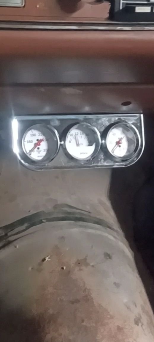

I've also installed an old school tach in the blank clock opening, and a new three gauge panel under the dash to keep tabs on everything...

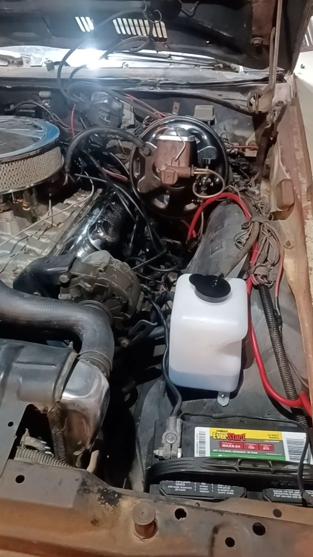

Cleaned up a lot of wiring.
Hooked up electric choke, and realized that was probably why it was running inconsistently. I think the choke was partially open, or just opening and closing whenever.
Got a washer fluid bottle installed, and got the squirters working.
New radiator and all new hoses.
New gauge cluster.

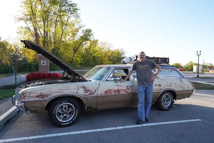

Are those wheels 14 inch or 15 inch? And, what is that you are holding in the last photo?
Old Oct 24, 2023 | 06:17 AM
  #62
Funkwagon455's Avatar
Posts: 2,843
From: Aledo, Texas
I believe that is a dead body (like aunt Edna)😂
Old Oct 25, 2023 | 10:20 AM
  #63
David Sloop's Avatar
Posts: 113
They are 15" from a later Delta 88, and that is indeed, a dead body.

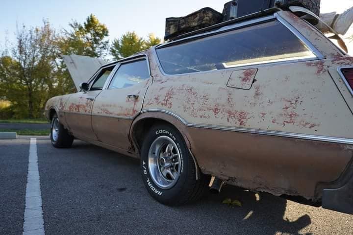

Trick your Trunk...
Theme was "That 70's killer Family Vacation"
Drove around town with the body on the roof a few days leading up to the event... Got a few stares, finger-pointing, and laughs.
And we just got my daughter the yellow Nissan Frontier, and I just knew we had to do the Baywatch theme with her truck.
