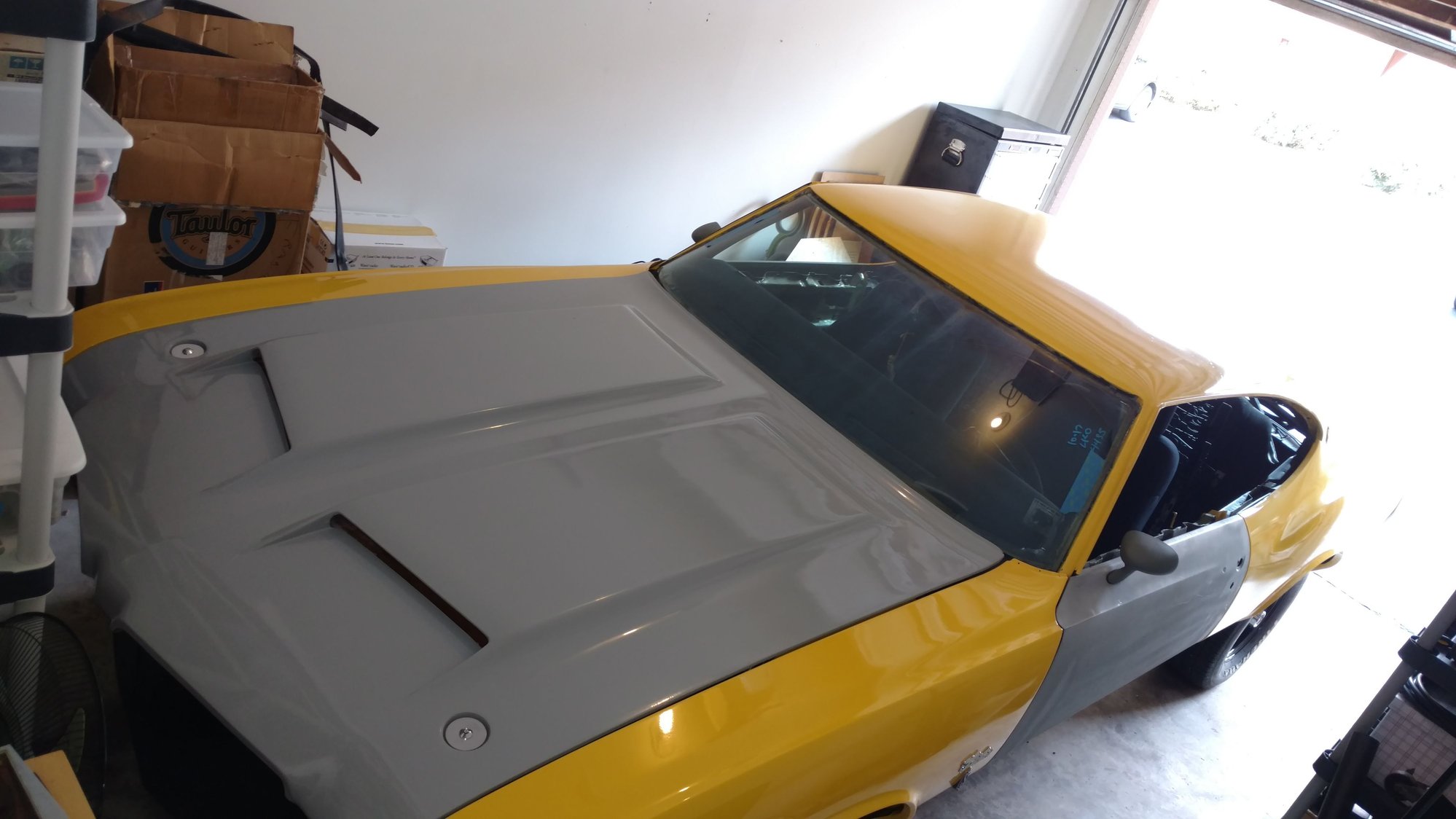

Installed the W - 25 hood and did minor mods to get it fit good. Local Hood from company called Stinger fiberglass. Pretty decent hood, fully functioning air box, fiberglass framed underneath, fully caulked\ glued attachment points between frame and hood, also riveted. I talked to guy at length about his process in forming hoods before hand, and visited his warehouse in Cocoa beach. He bought several (under $1k) aftermarket W-25 hoods to inspect design. He didn't like any of them. Made improvements in design using an original 71-72' hood in near mint shape as the form. It really does fit awesome. Real straight, consistent. Only issue so far is the rear molding lip is a bit thick, and probably will need some shaving to get molding on. I also left hood out in sun\heat to see if air pockets formed, no issues. He said he took care of that possibility up front by curing properly and was aware of some of the air pocket issues in other hoods. He said he doesn't know how some of these hoods could even be sold with such crap quality control\ manuf process. Kind of a scary thought.
Just a temporary mock up, hood will be coming back off.
Also removed front windshield for other restoration reasons. Might need some pinch weld metal replaced too. Its 50-50, not terrible as some you see, but some lower areas on pillars not so hot. Not sure how far to go here.

Jim, who made the W25 hood and what was the price point? Is it reinforced for regular hood springs or do you need to go with lightweight. Also does it have the cutout for the hood latch? Curious to hear about this hood.
Jim:
X2 on the hood info. That hood looks very straight, I like how the curve of the hood follows the fender line so closely. need more info!

Ok , I did mention the company of the Hood above - Stinger Fiberglass in Titusville, Fl. Basically cape caneveral area. Al, yes it does have cut out for latch, I had latch Powder coated and installed it already. No issues. I know I examined hinge area carefully long time ago, but I honestly cant exactly remember!
( this is getting stupid, this aging thing!) I dont think they are reinforced with metal. HOWEVER, I know that my normal steel hinges did work ok, but I got temp lighter springs on it right now anyways. They hold hood up fine for now. The hood cost $650 and I picked it up in person. I believe shipping to a business is $165. I like this hood alot so far.
Ed, I've already got aluminum heads planned, probably those worked up Bernard Mondello pro comp heads with some porting done. I think I'm pulling the trigger on that 70' block with orig E heads we talked about and that will be the start of the next build. Probably will be starting a new thread on that engine rebuild, but that will be a long term, slow project. I really enjoyed reading your thread, i'm up to page 5 right now.I really wish I even had a little bit of your metal skills, but I'm a real chicken s*** in that area! I'm a total retard when it comes to metal work/ body work. But I did just recently cut off some clean a pillars off of a donor car for the front windshield pinch welds in my car just in case I want to do mine, I have a set now. But it sure as hell won't be me welding in those things if I do!
As to those wanting info on the hood, please let me know if there's any other info you need re Hood. I'll get you whatever you need. I will try and take pics this weekend of the underside and post them.

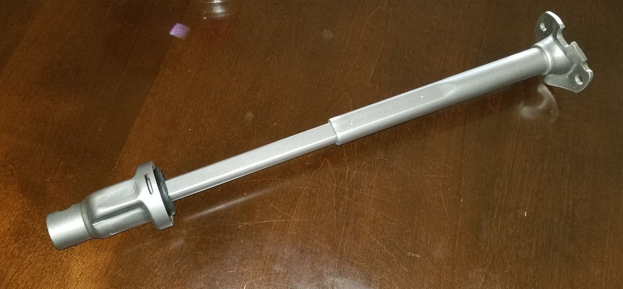

Had to redo Intermediate shaft as clear coated polished steel did not hold up. Also disassembled and added new grease.
P/S pic to come

Bolts, very disappointed in EW blackening kit stuff which includes clear coats after process, looked great at first but does not hold up to anything like evaporating water for days...Some held up fine, others did not. So to me, a FAIL!
Most other bolts done at factories held up fine.
EW blackening kit has had probably 30% fail. Again no direct water contact, just standing water 2-3 in deep evaporating. None of this stuff got wet, just evaporation.
Lesson learned, paint everything. Cant rely on clear coats alone.
