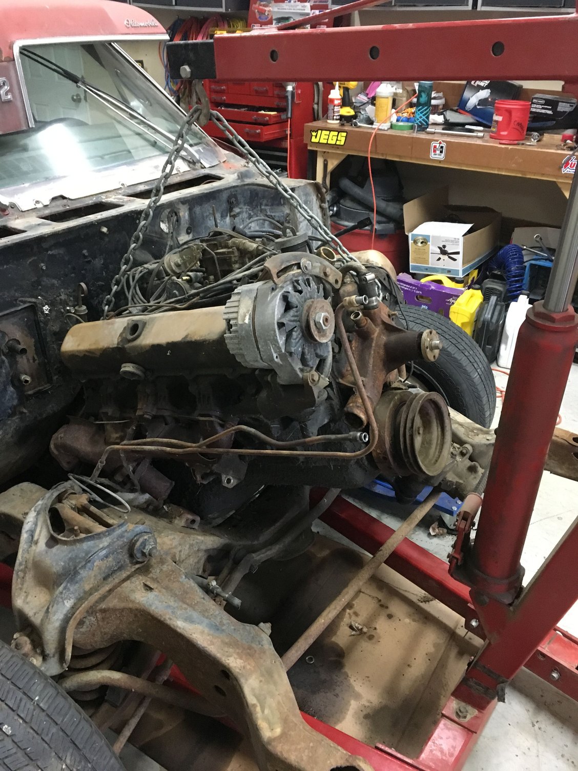

old engine and trans pulled from the car. Engine is seized so basically gonna get used for brackets and such. Still debating getting the trans rebuilt to simplify things compared to changing to a 400. I know a guy in town who rebuilds a lot of 350s for chevies that put out quite a bit out power that seem to hold up.

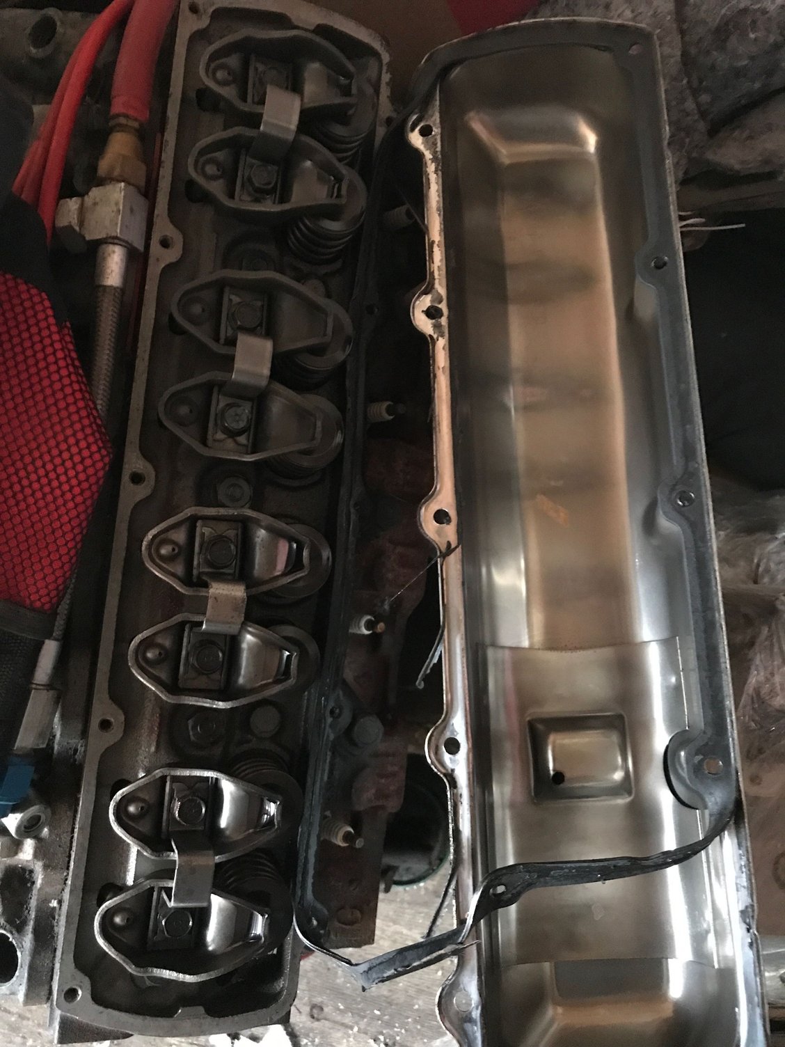

The 455 I'm putting in is back in town and on the engine stand. Was rebuilt recently and looks very clean, hopefully that cuts down a bit on the rebuild cost. Some info on the engine
71 Block .030" over with G heads, big valves.
stock crank and rods, speed pro forged pistons.
compression estimated at 9.5. Has the exhaust crossovers filled in the heads, some minor port work too.
Comp cams 280 magnum with lifters and double roller timing chain. Looks like stock stamped steel rocker arms but I'm not an olds guy yet so I'm not sure the differences between stock and repops.
Hooker 1 7/8" headers, edelbrock performer intake and I have a Holley HP 750 vac secondaries from the challenger I'll probably throw on top. Also came with an MSD ready to run distributor and msd wires I'll use instead of the HEI. Crank is also drilled for a 4 speed so that's a bonus if I decide to go that route sometime in the future.
Looks pretty good so far so it'll probably just get a refresh for the time being so the budget can be spent on other more pressing areas of the build. Anybody running a similar setup or have an idea of the power it will make so I have that information when deciding/building a tranny.
