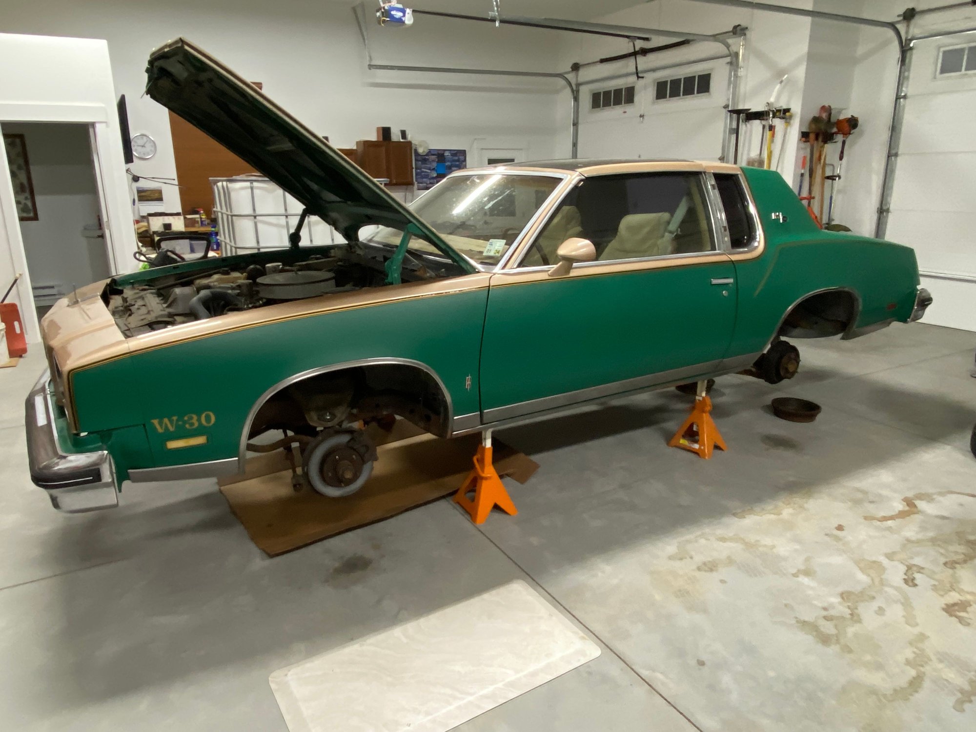

1979 Hurst Olds Cutlass
Old Dec 12, 2024 | 08:26 PM
The Fast Forester's Avatar
Joined: Dec 2024
Posts: 84
From: Colorado
Hey all! This looks like a great forum for classic Olds cars. I just came across a 1979 Olds Cutlass with the "R" VIN and properly coded trim tag and believe this to be an original T-top Hurst Olds. Not sure how it ended up green and gold with low-rider wheels? I'll plan to start a restoration thread here and see if we can't get it back to as original as possible. Looking forward to learning a lot from this forum!

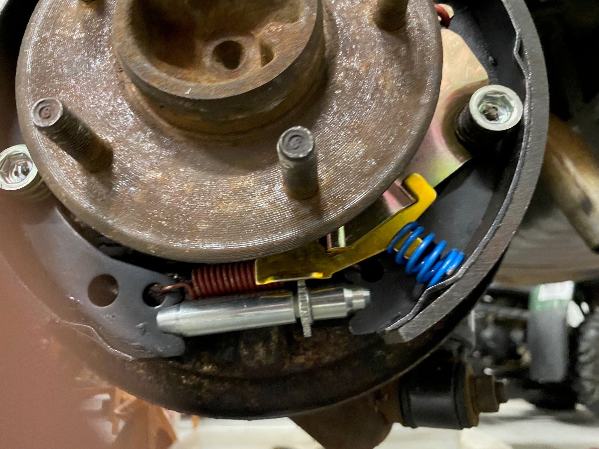

For starters...brakes are an issue (as in really not working)...so I'll most likely start there.

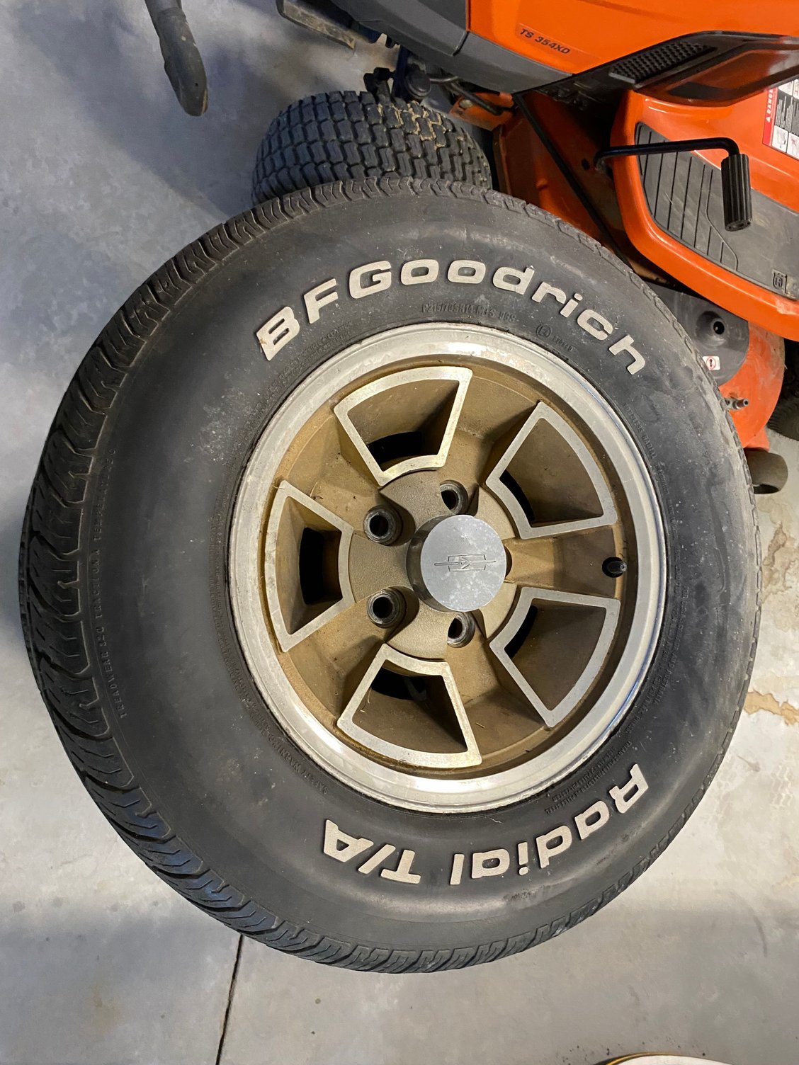

I'm glad the owner saved the original wheels, those will go back in due time.

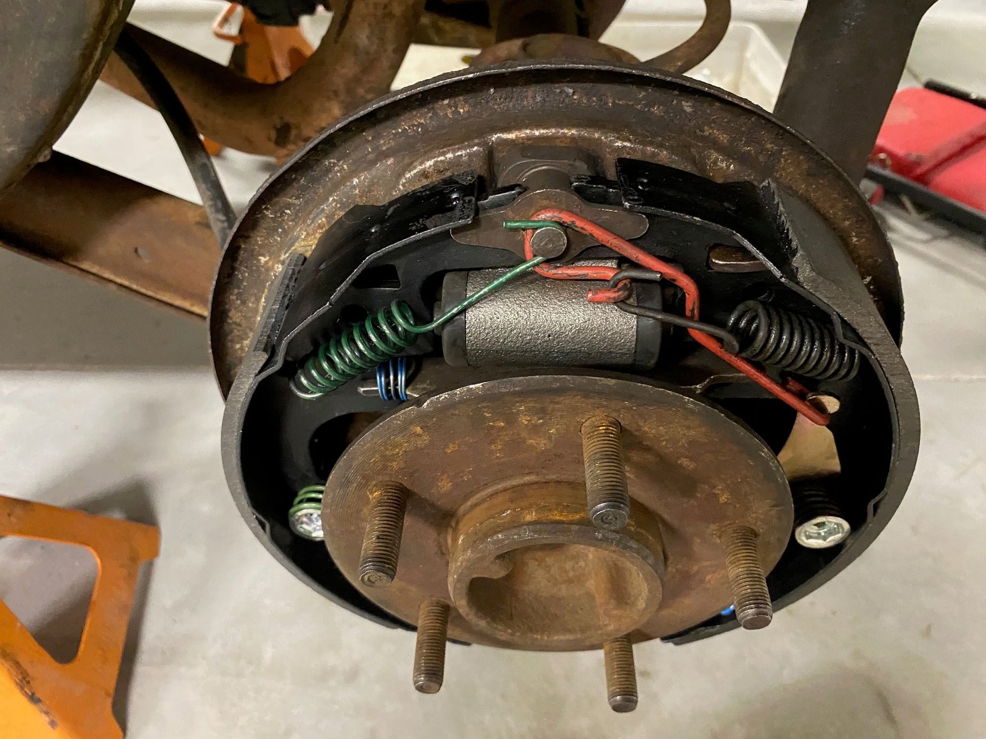

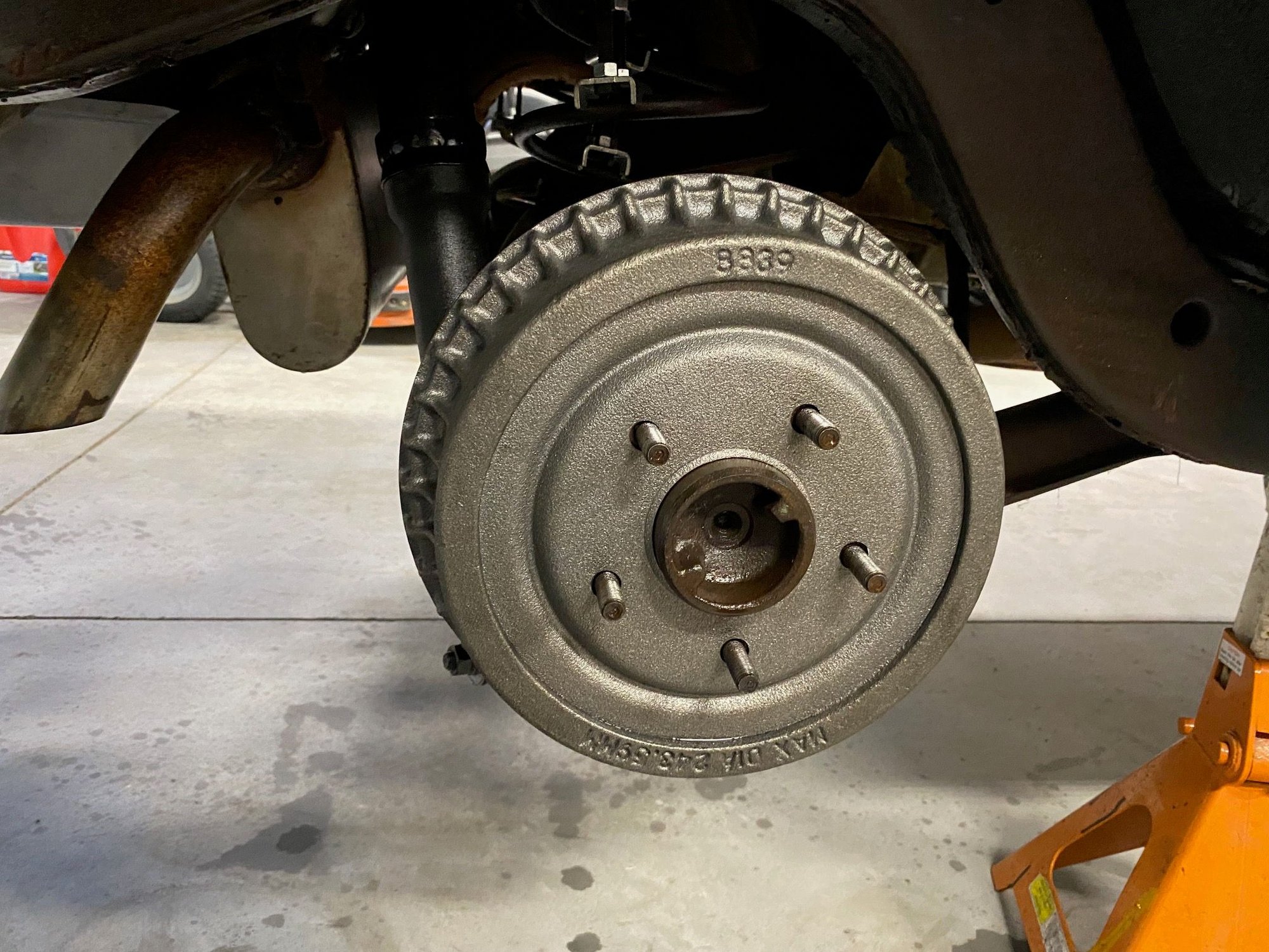

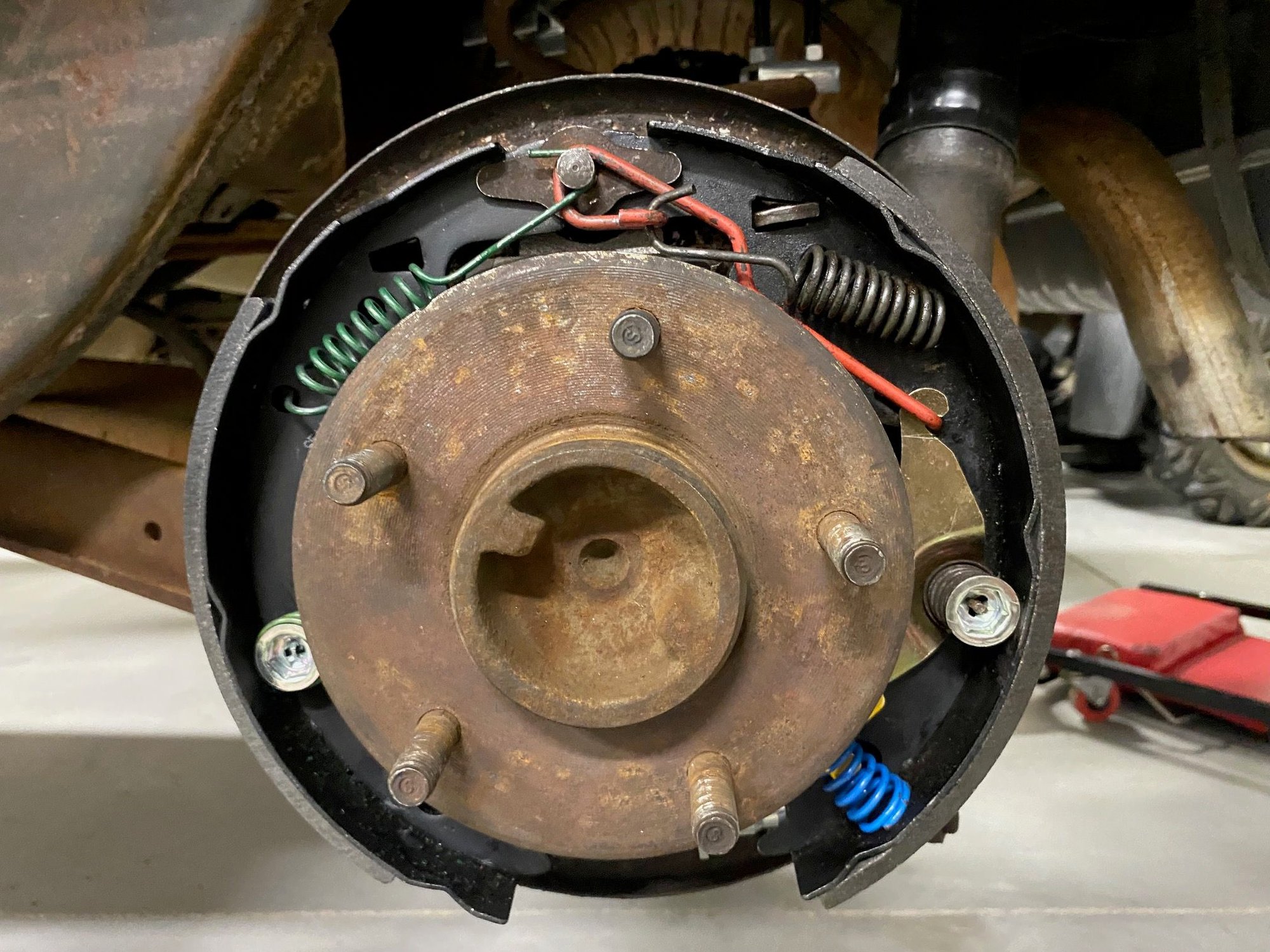

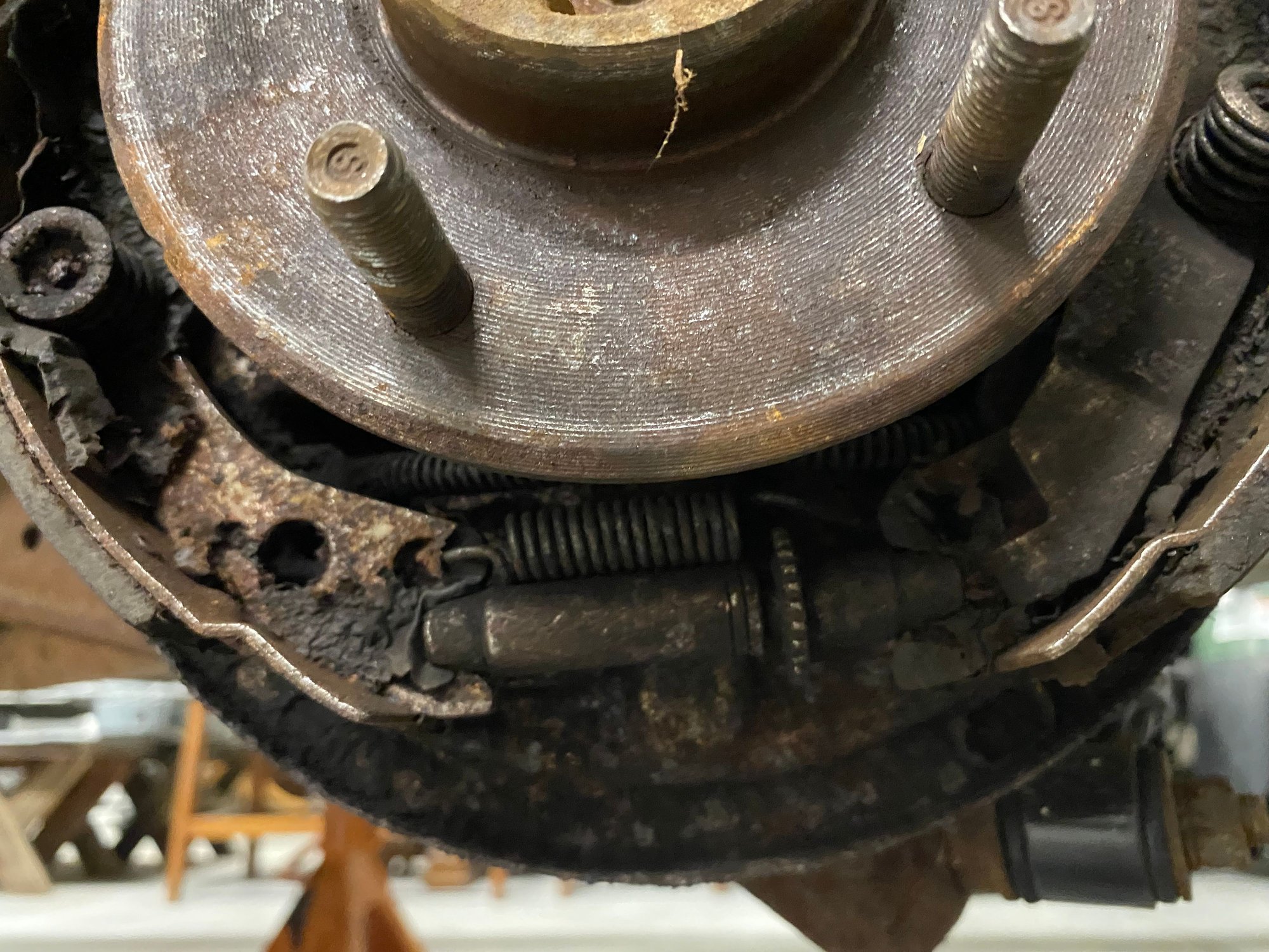

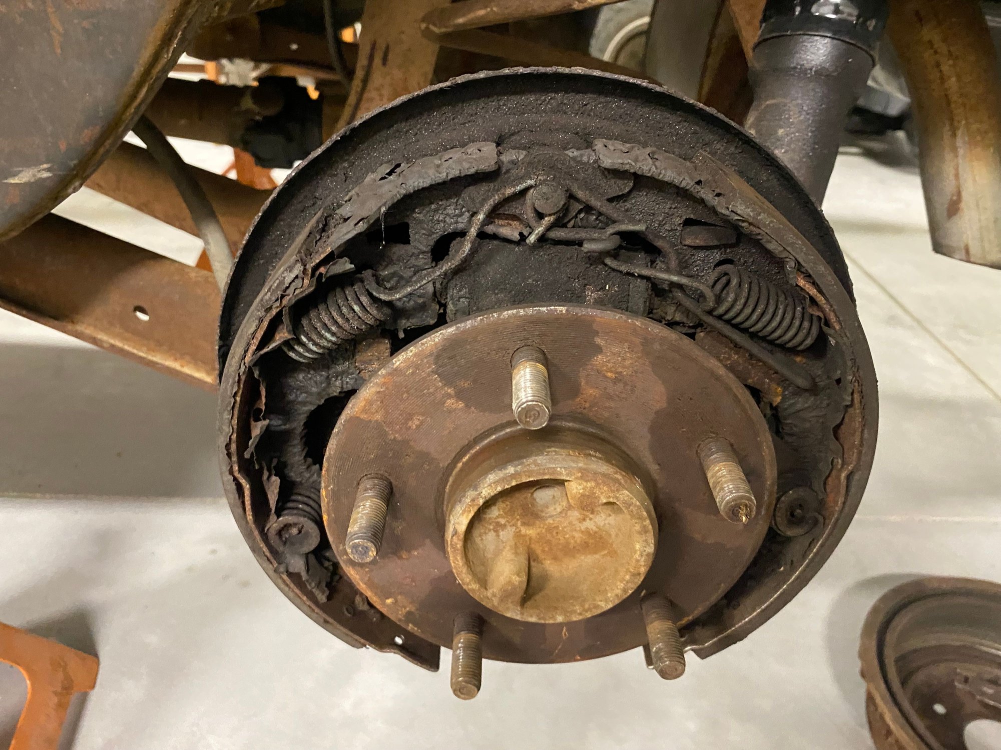

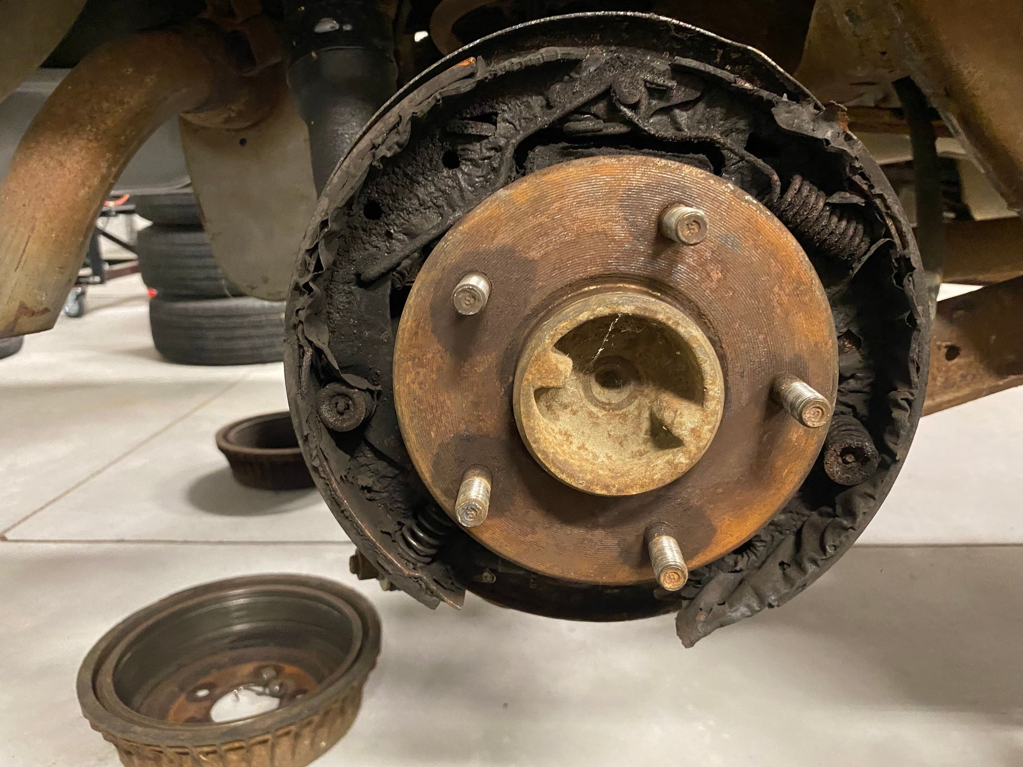

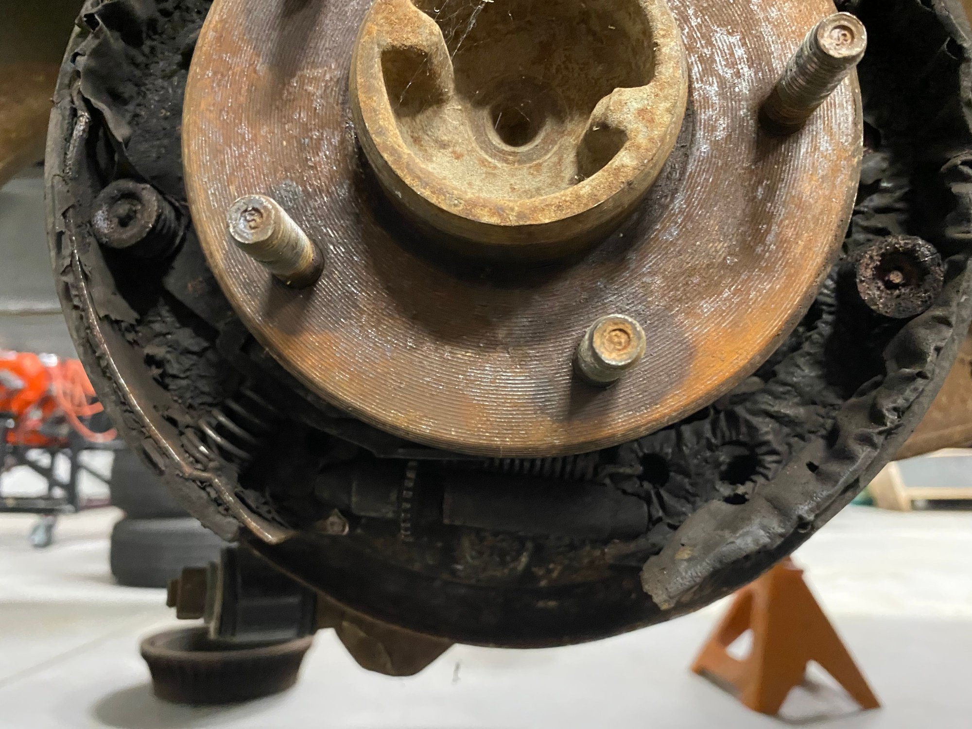

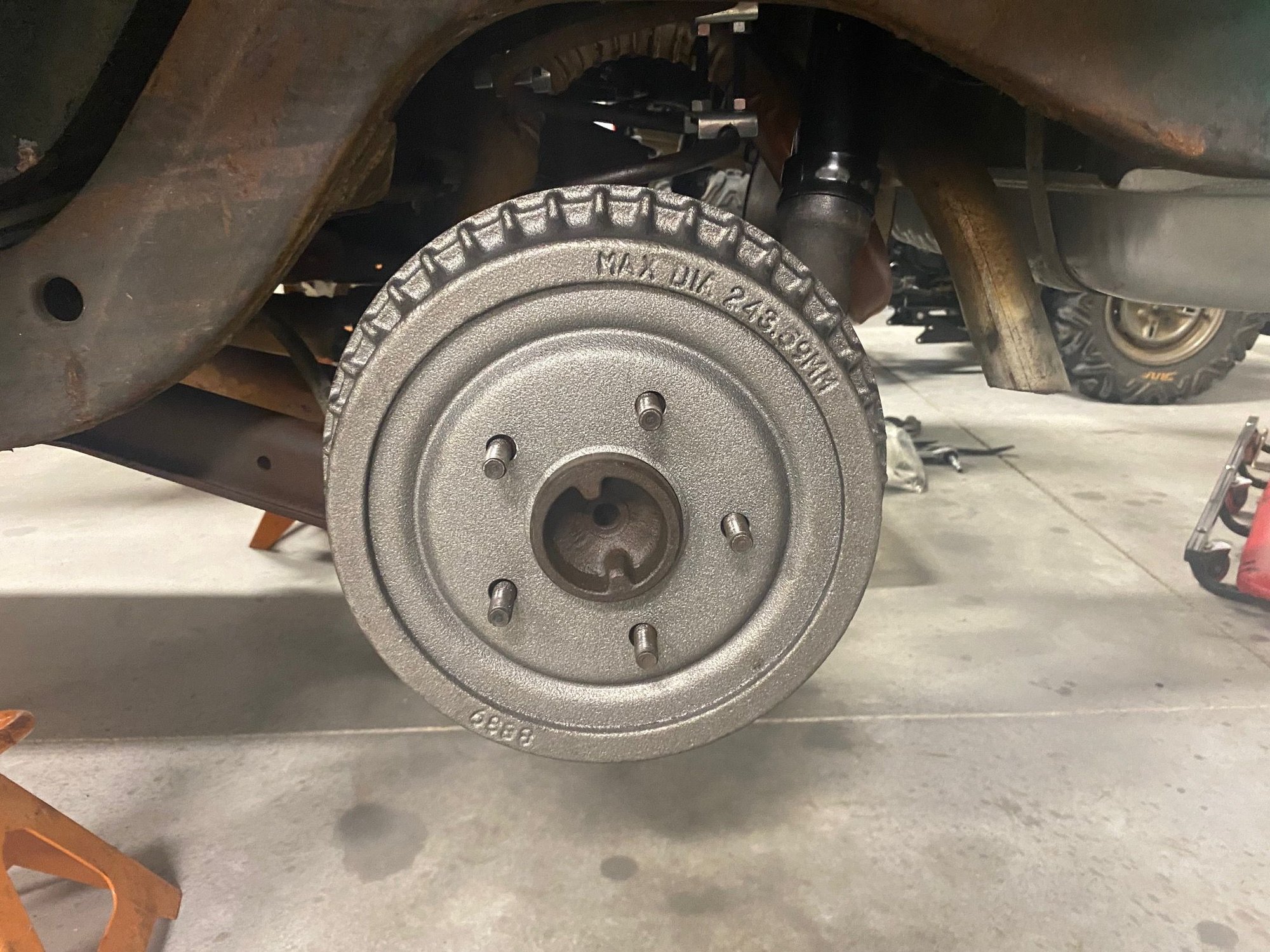

Rear drum brakes before and afters.
Old Dec 31, 2024 | 05:04 AM
BlueCalais79's Avatar
Posts: 1,710
From: McCormick, SC
Superb job! If you need a source for re-finishing the Gold Hurst wheels, I have one. They may also do the center caps, not sure.

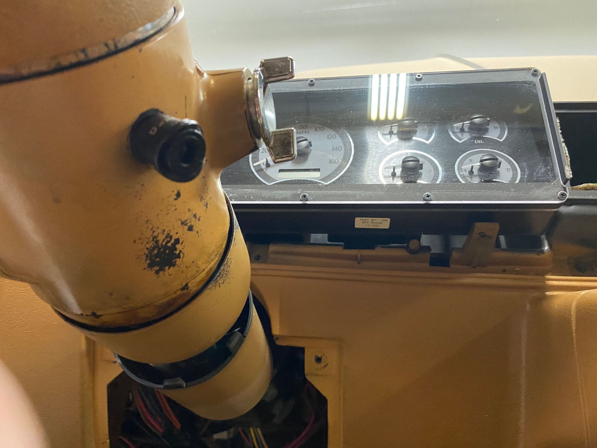

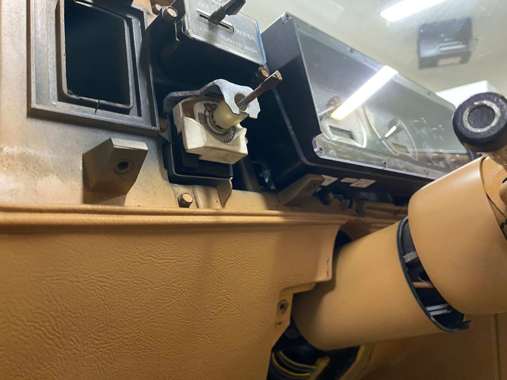

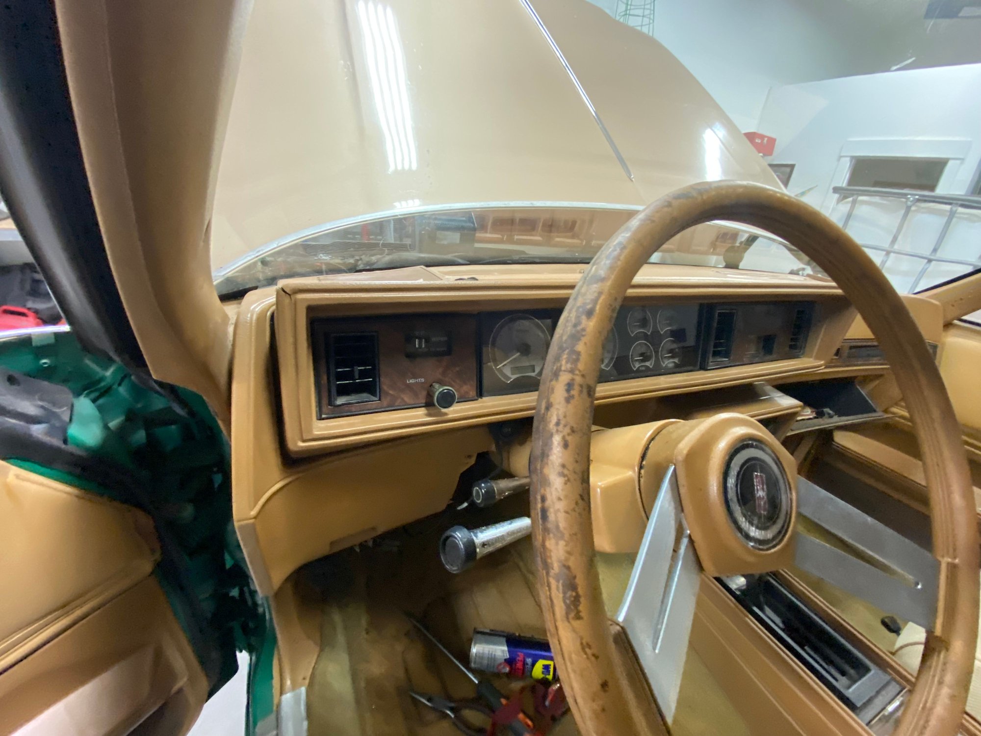

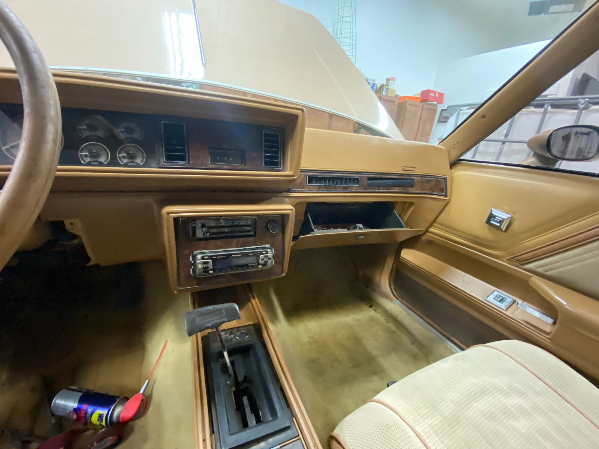

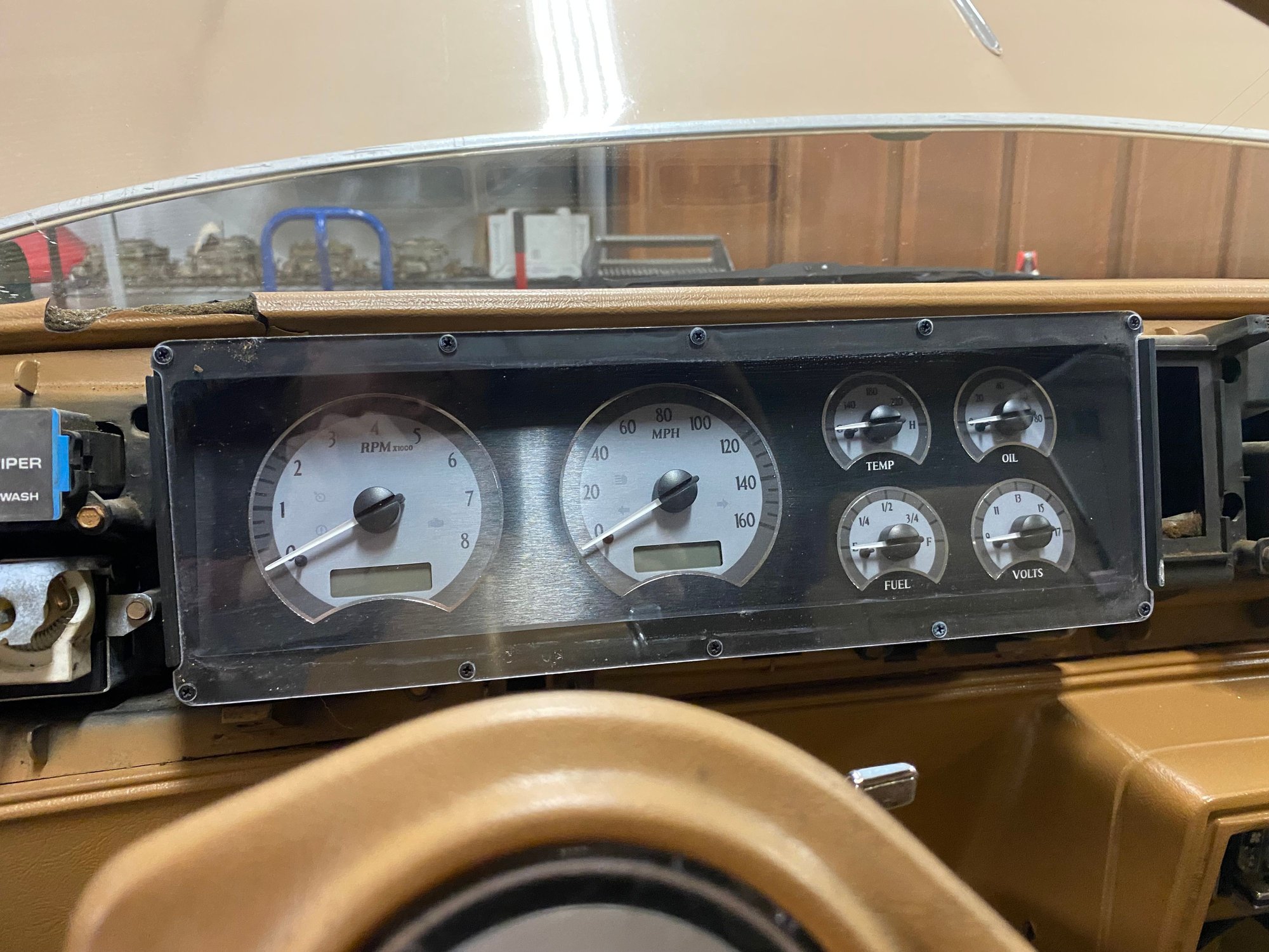

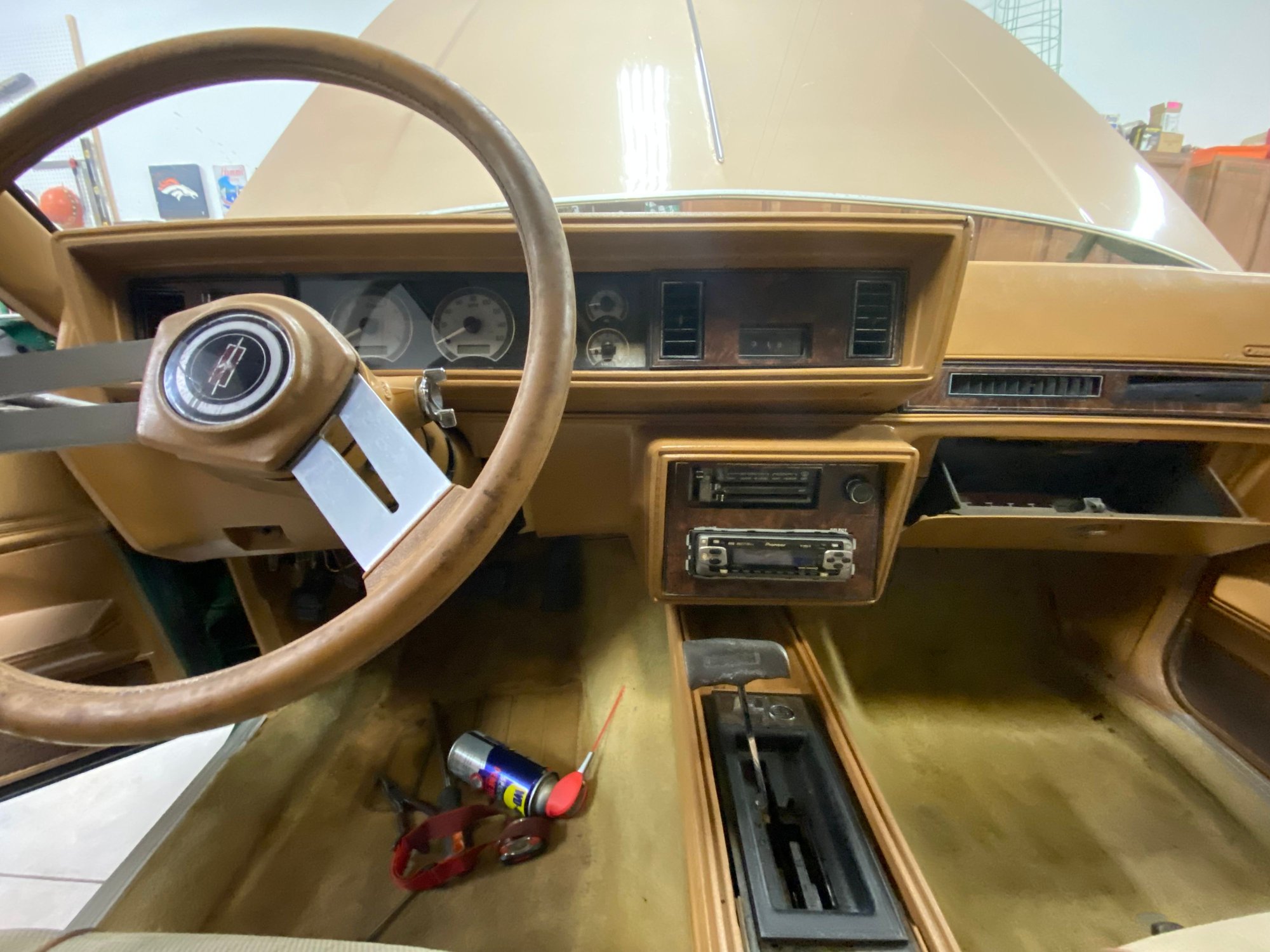

To get this e-brake functioning again I need a new release handle, so that inspired me to tear into the dash a bit. Pretty rough in there but it's a start.

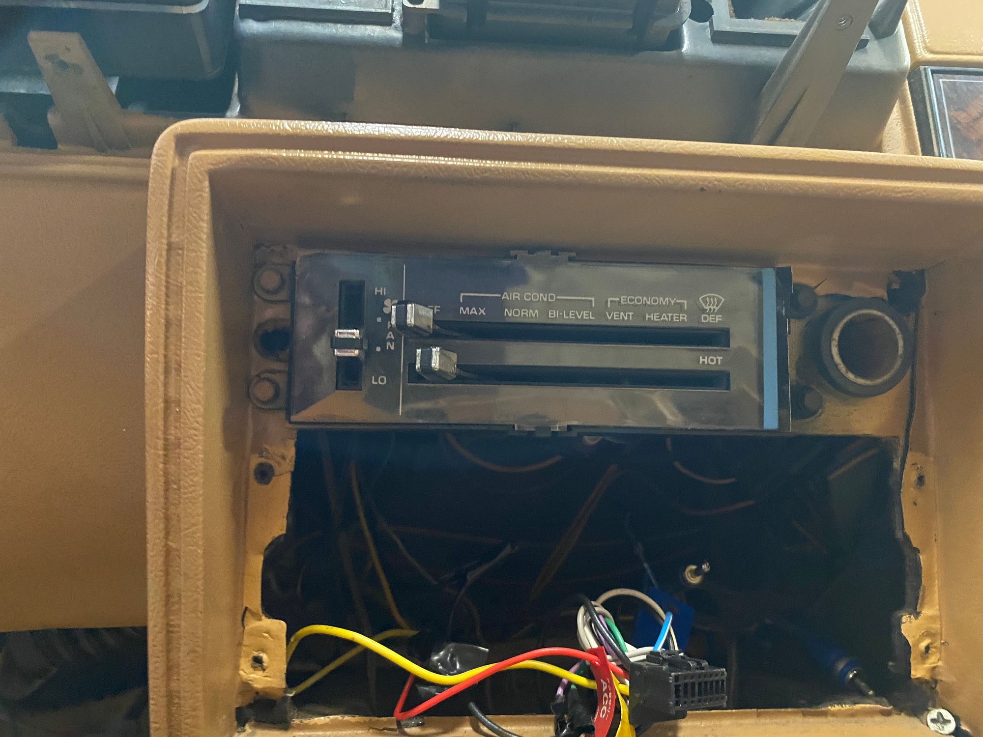

I think the after-market gauges and radio will have to go, I've got the original gauges but not sure if they work or not.

Sounds good F442. I'll be testing these before I remove them, then also testing the originals and see what I have to deal with.

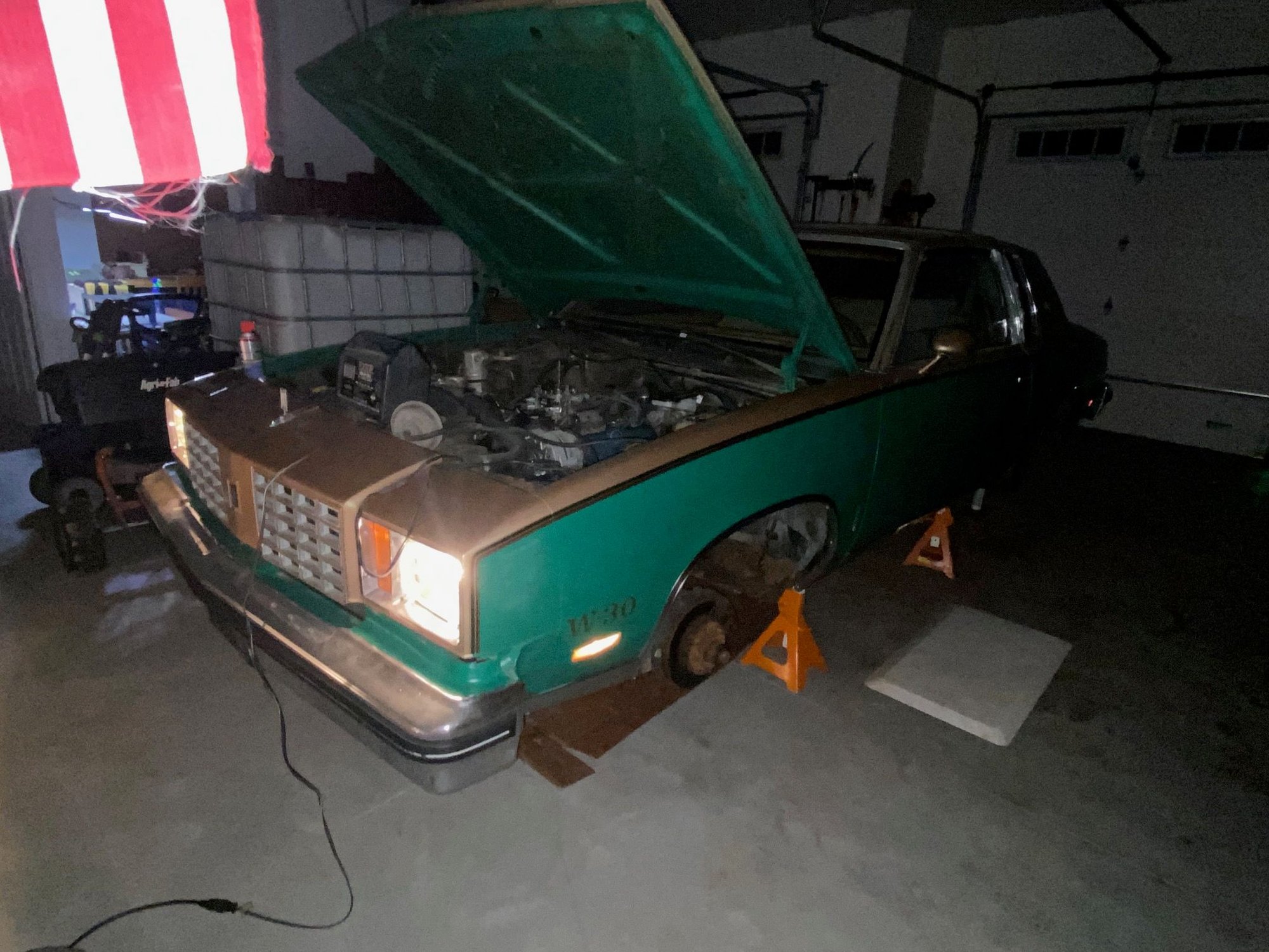

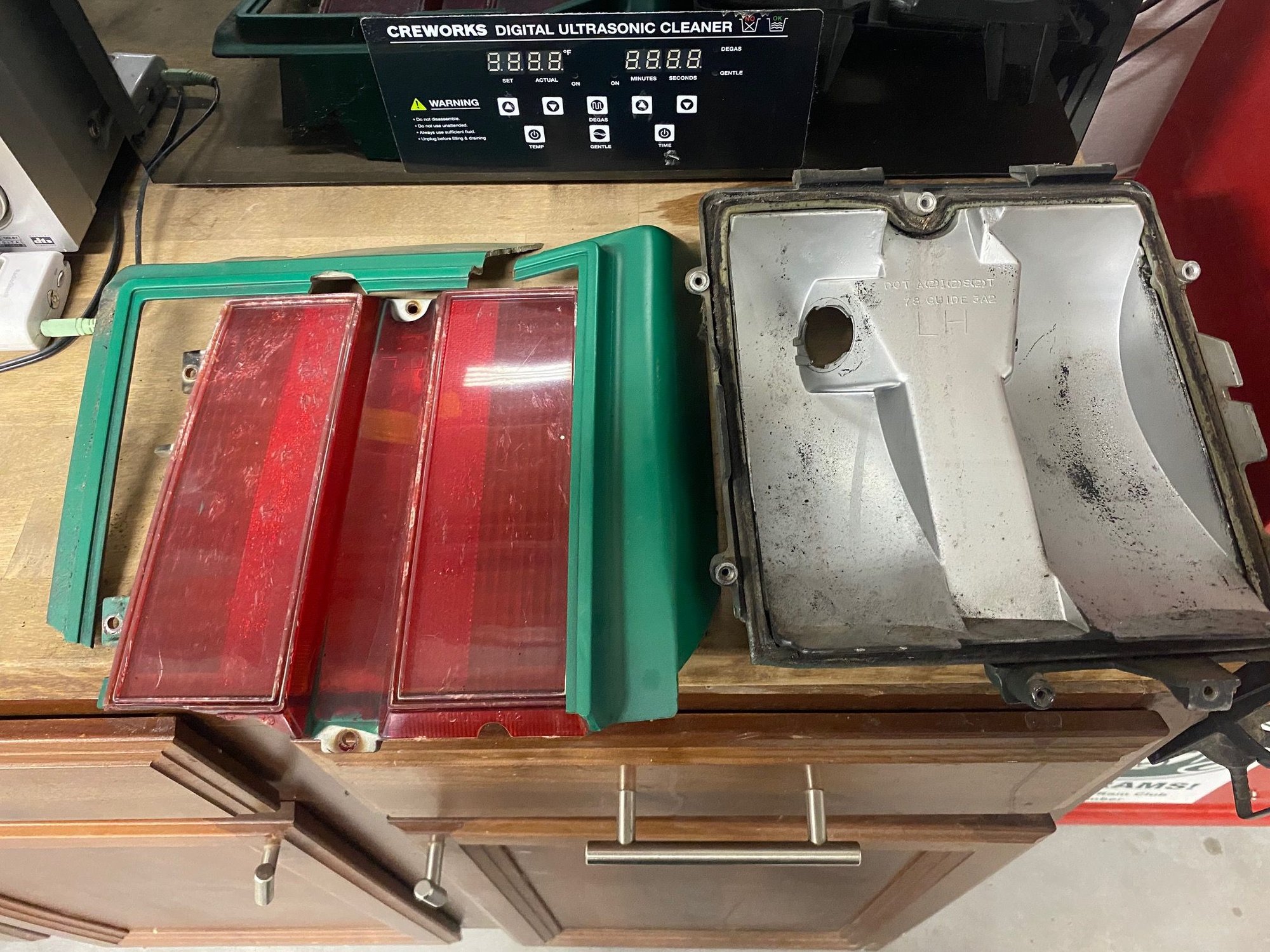

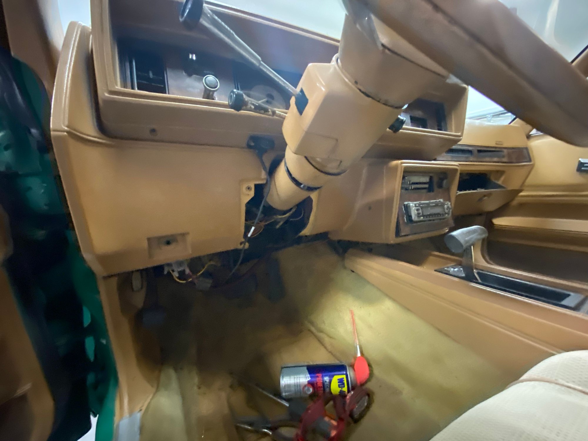

Decided to work on lights for a bit. No power at headlights, had a broken LH tail light and 3 of the 4 fender/quarter lights were'nt working.

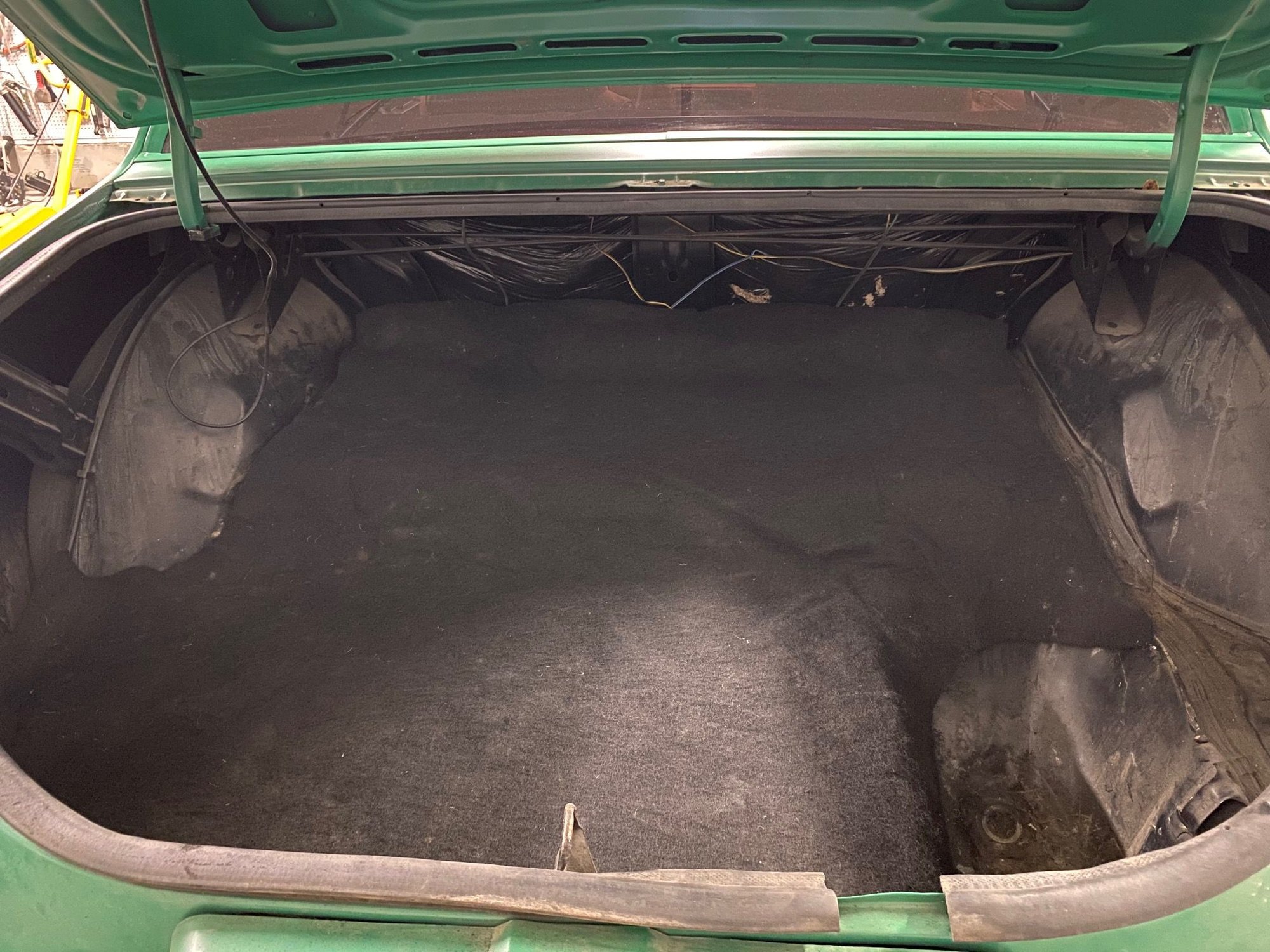

A little trunk time tonight.

You're going to need new pinchweld weatherstripping for that trunk for sure.
GM p/n 20641957, or 25558394, or 20490800. You could buy the aftermarket stuff, but I have absolutely no idea about fit or quality. Nothing I've ever seen aftermarket fits better or seals better than the GM stuff, but it's getting harder to find now. Good luck on the project. Doable, but a long road.

I found if you have a space saver donut spare, a trunk board that looks like this fits better and was the exact duplicate of what I needed, most of the repro boards are for full size spare tires and are different. some trunk repro stuff is the same as for Monte Carlo and Malibu..
https://www.thepartsplaceinc.com/pro...he-trunk/87041

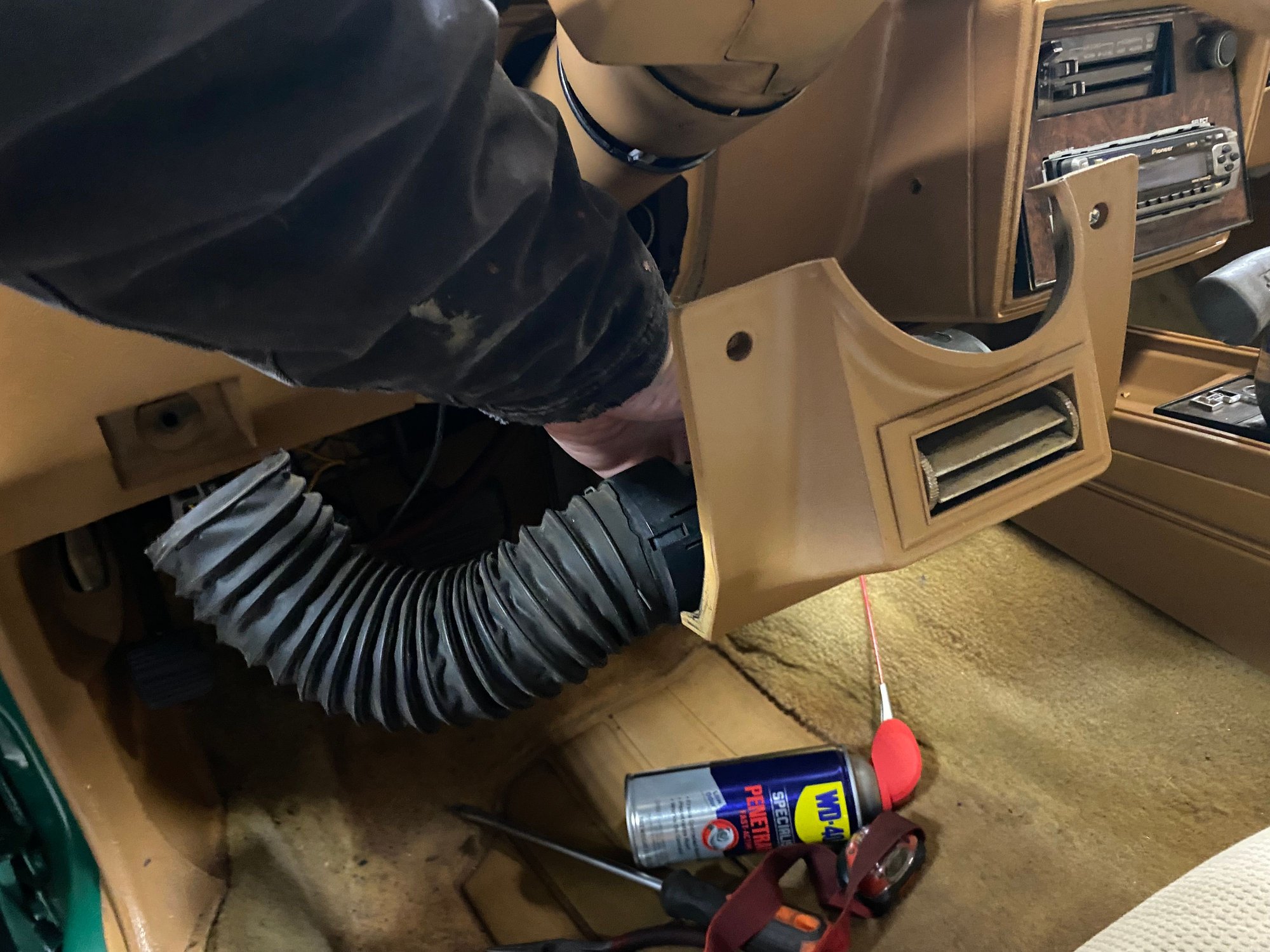

Looks like I'll be keeping and re-installing the after-market gauges. Too much has been altered with the wire harness to attempt to go back to the original dash.

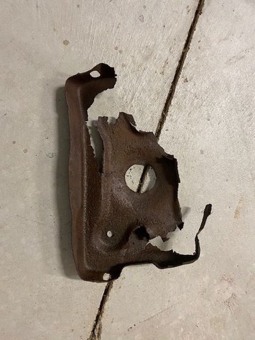

Might need a new battery tray...
This was fun getting out of there.

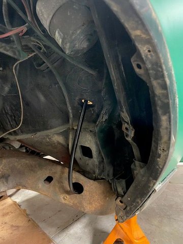

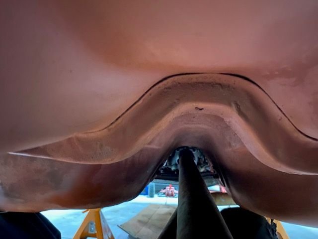

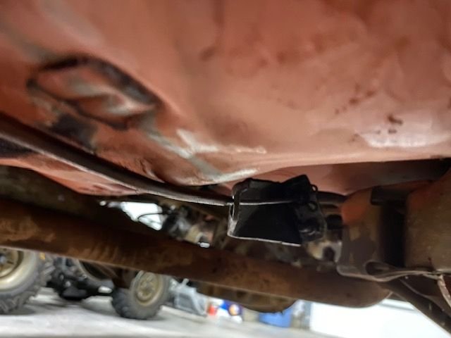

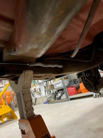

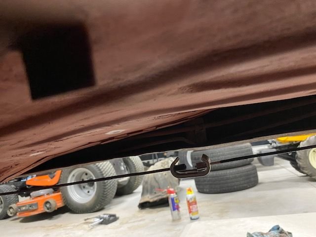

This parking brake has been a challenge to say the least. Finally got the old front cable out. It was rusted beyond movability for quite some time now.
Got the new one in tonight, cables connected underneath, and we have a working e-brake!
Also got the dent hammered out of the trunk spare area, and started touching up the underbody with some red oxide primer.

It's looking like your rear frame rails are in decent shape, a huge plus for the car. Also, Waldron's exhaust is now reproducing a correct-style exhaust for the 79's. Their stuff is EXPENSIVE but its on the money. I have on my 79 H/O an Imposter one-in-two-out muffler from them. It's a great muffler, no cabin drone with just a hint of growl at highway speeds, really nice. I used a Walker Cat plus Walker intermediate & tail pipes but not sure if any of that is available anymore, I bought it long ago and stored it until it was installed about 5 years ago. .

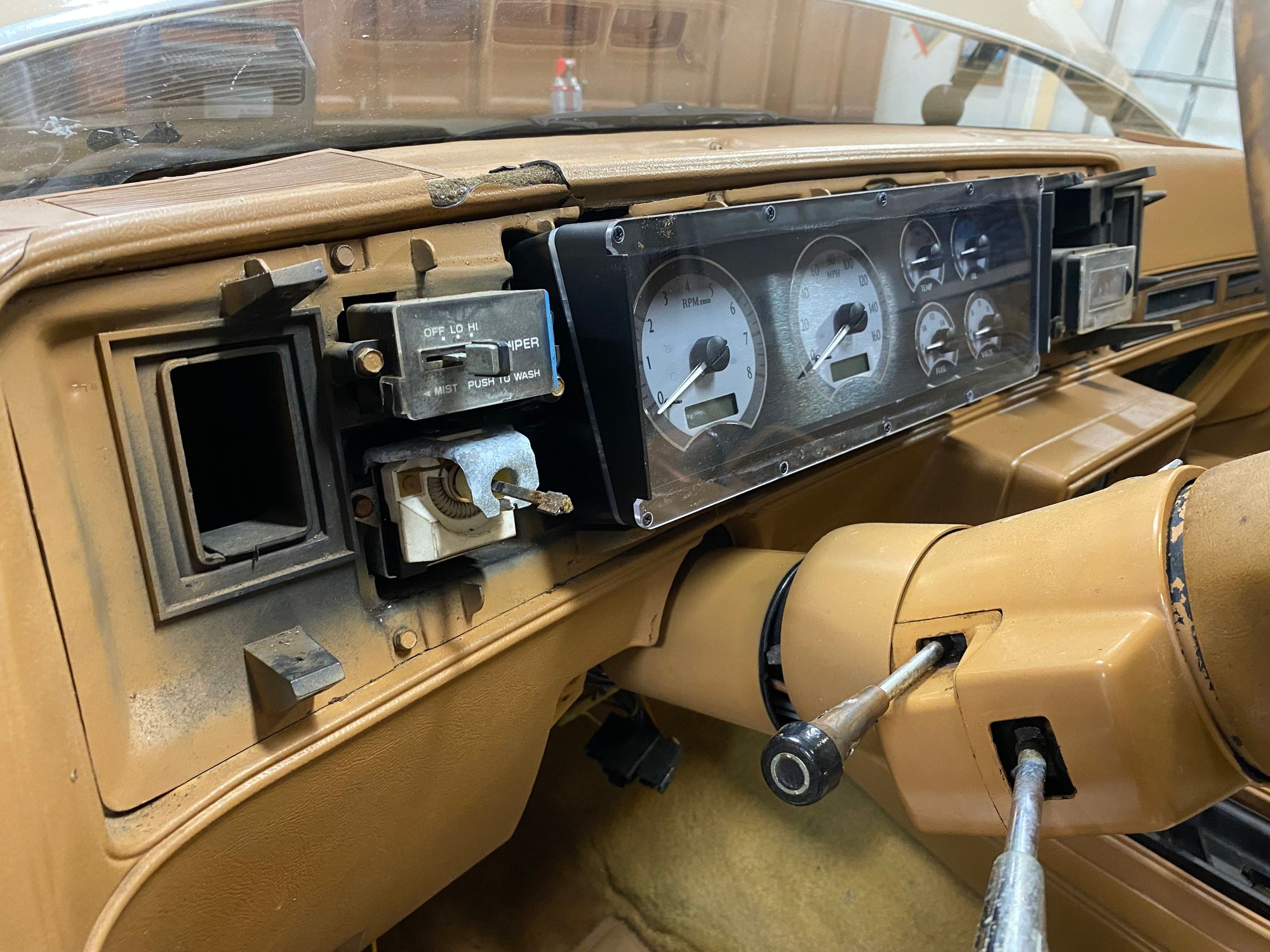

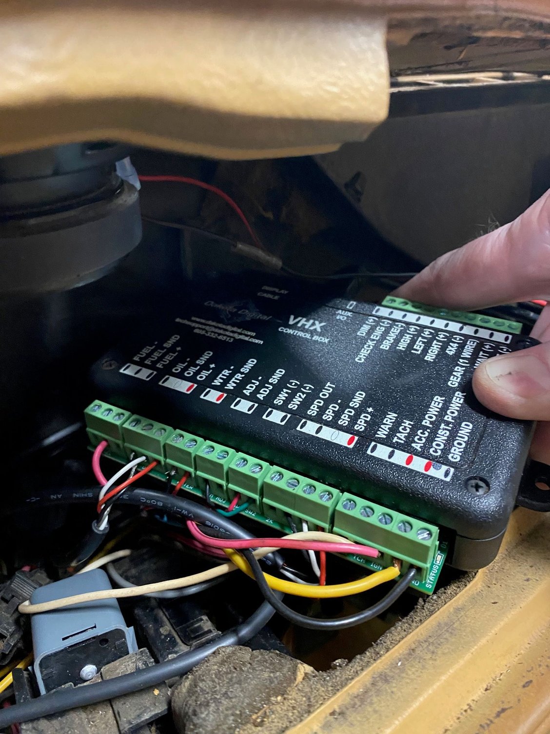

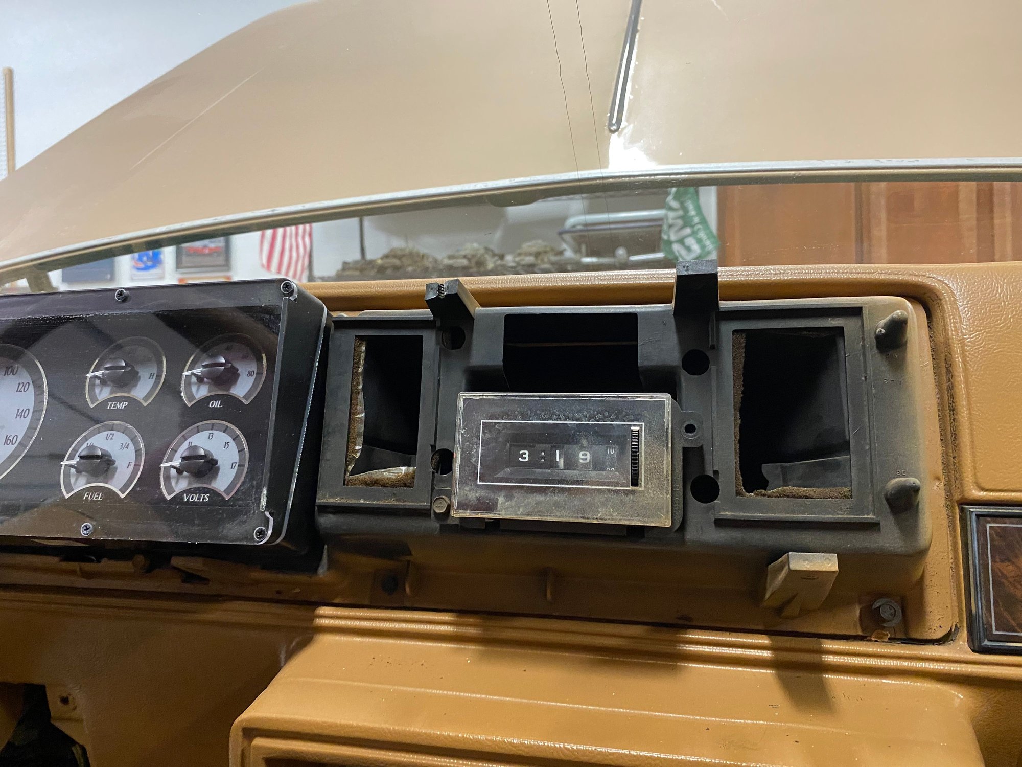

Rummaging around a box of parts that came with car, I found some original rally gauge components, including the connector plug for the dash instrument panel and oil pressure sender! Between that, and BC79's encouragement, I'm going to break this gauge set down and see if I can get it restored and working again. Wiring is a mess with the Dakota Digital unit behind the dash but I'll try and figure things out from there.

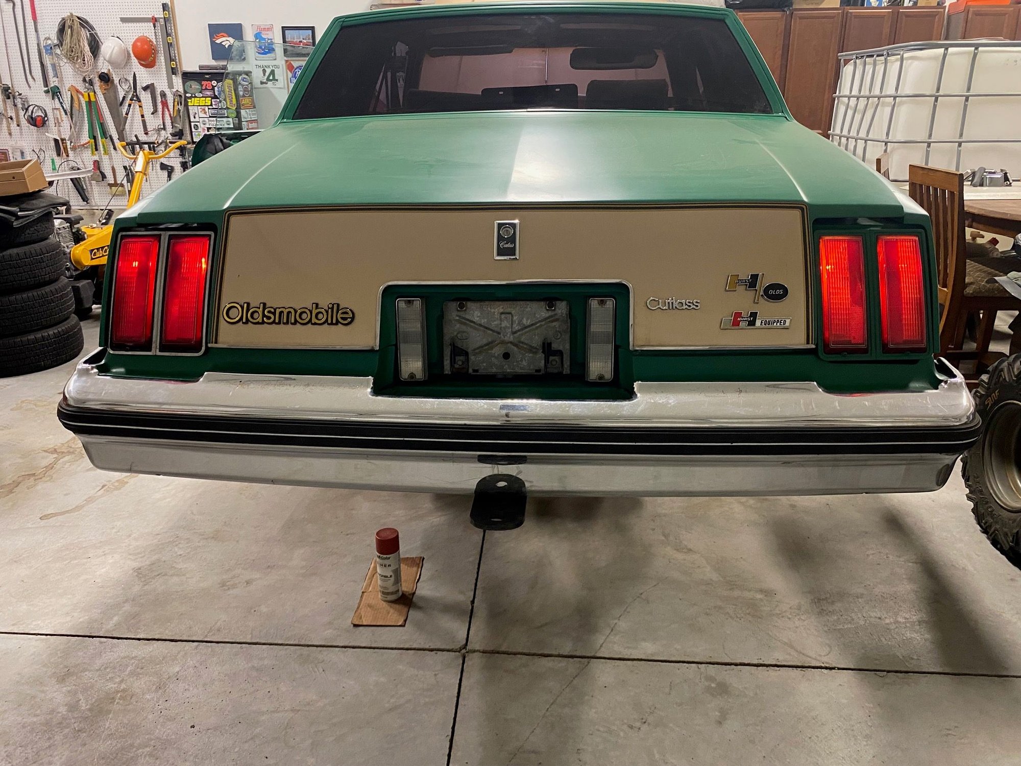

Taking a break from the gauges till I get some parts. Meantime removed the rear bumper to touch it up a bit. Nice hitch huh? Rear frame rails in pretty decent shape, hitch is welded to rear frame and bumper inserts, looks like it's staying.
