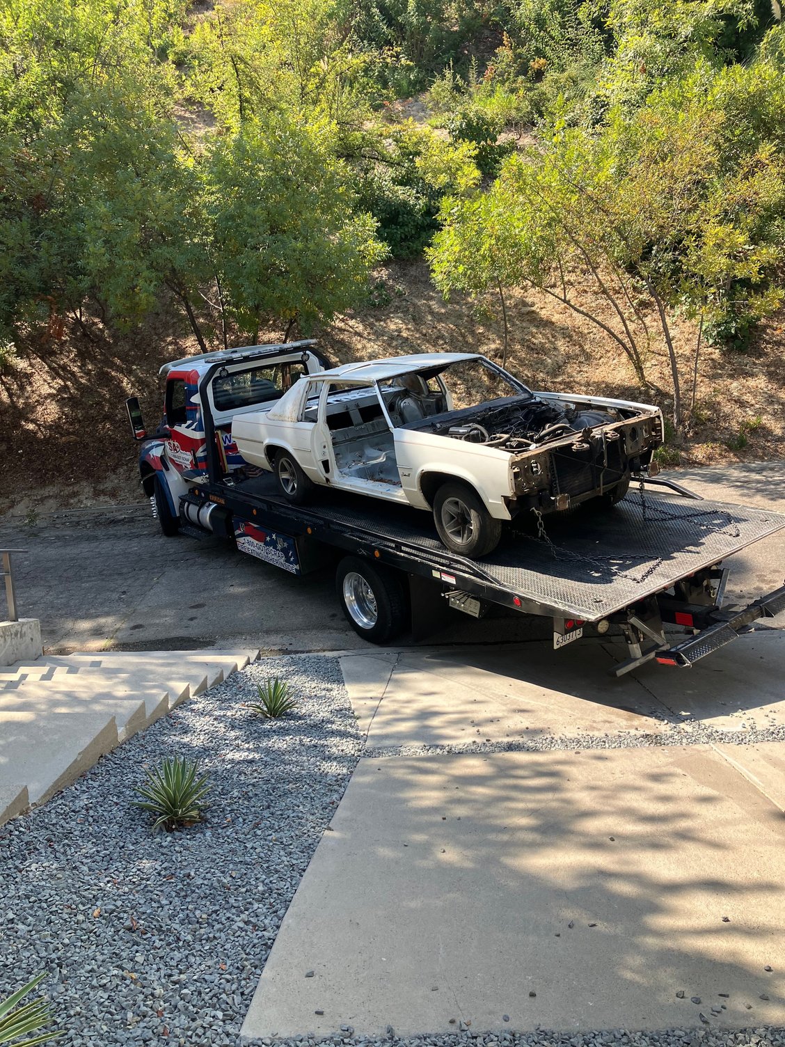

Sometimes we do things that don’t make dollars or sense. I think my 1978 Holiday 88 Project is one of those things.
But a Delta 88 was my first car. (It was given to me by an uncle — dark green on pea soup green, radio delete …. I dubbed it “The Think Tank.”) So I’ve always had a soft spot for these B-Body cars.
What I really wanted back then was a 1977-1979 2 door. Fast forward about 30 years and for some non-sensical nostalgic reason I started looking for one.
I went down the rabbit hole and discovered the Holiday 88 — a base model Delta 88 with the Y98 option package - buckets, console, T-handle shifter, sport mirrors, a sport steering wheel, color matched hubcaps and Holiday 88 badges.
Well, heck yeah. I just needed to find one. Apparently they are rare-ish. Not sure of actual production numbers. What I am sure of is that there Ain’t any of ‘em where I live — the Peoples Republic of California.
Hello Facebook. I found a few on marketplace (Indianapolis aka “Naptown” is apparently a hotbed - go figure?) but I missed out on a couple of good stock ones and didn’t want to pay extra for 28 inch wheels and who knows what kind of suspension and modifications to accommodate said 28 inch wheels.
One guy kindly reached out to me and turned me on to something similar but different — a 1977 Delta 88 Indy Pace Car with 70,000 miles… Having struck out on my Holiday 88 search and wanting to scratch my 77-79 2 door Delta 88 itch, I jumped on it. Of course that’s when I found (what I thought was) a great Holiday 88 deal. Luckily, one of the members of this community had been searching for a 77 Indy Pace Car so I sold it to him for what I bought it for (less shipping costs which I ate)
So the Holiday 88. White with a full white vinyl top, dark Carmine red vinyl interior, red pinstripe, optional SS wheels with the starfish center caps, 350ci engine, tilt, cruise, a few other goodies. Lots of original documentation. Lots of photos from the seller. Clean. Dead straight. Mostly original paint. Mint mint mint interior with uncracked dash and unfaded wood trim. All the exterior trim and chrome shined bright like a diamond (thanks Rihanna…) Seller said it ran good, but trans was slipping. Midwest car so I asked for pictures underneath. He sent me pics and video. I knew the rockers were bad. The only other bad spot (I thought) was one of the rear body mounts….
You know where this is going. It gets off the trailer and I immediately notice a couple spots hiding under the fender wheelwell trim. Drove it straight to the shop a couple blocks from me and put it up on the rack. The undercoating hid a few things for sure. Loud crunch as the rear body mounts come apart and the bumper drops about a foot. Frame ain’t bad. Floor pans are ok. I start poking around some more. A spot by the opera windows, a spot in the door jamb, another spot under the quarter wheelwell trim. I get home and do a compression test. Dead even across all cylinders. Check the transmission fluid — doesn’t smell burnt but down a couple quarts. Everything else works.
If this was a Cutlass, Chevelle or GTO I wouldn’t blink. But it’s a B-Body and no one makes patch panels and I don’t know how to weld.
So what do I do?? Donor car!!

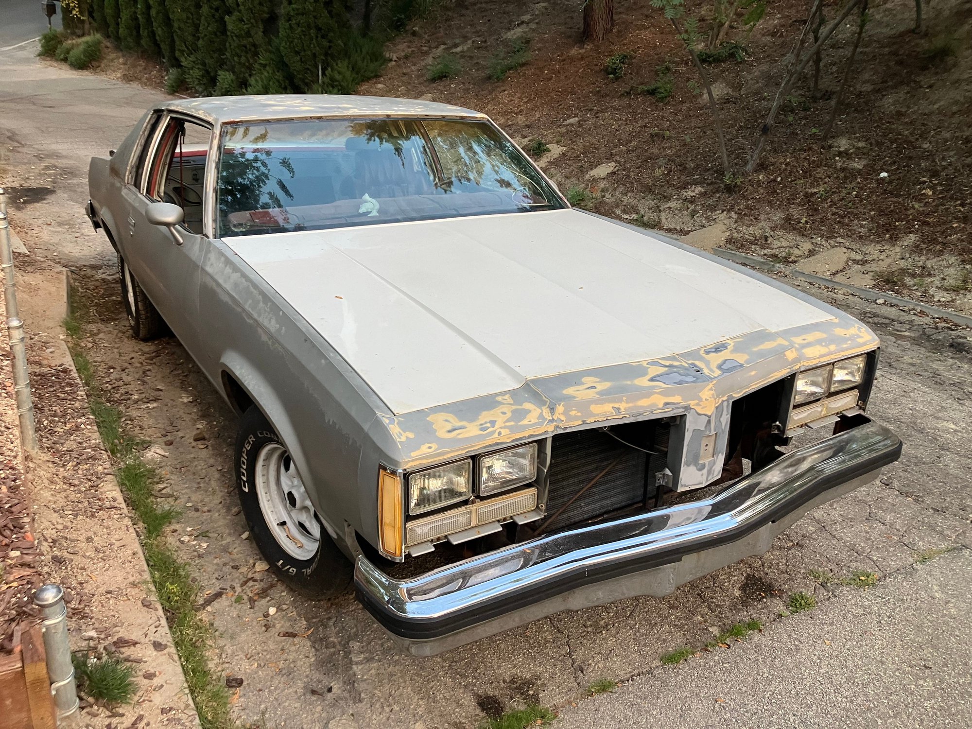

I find a sun-baked southern 1978 Holiday 88. Complete car. Interior is cooked. Paint is chalky as can be. But straight as an arrow, rust-free underneath and runs and drives…and almost identical build sheet as the one I have. So of course it’s on its way to me.
Plan is frame up and paint on the southern car and then swap over all the minty fresh parts (and likely the drivetrain) from the Midwest car.
Wish me luck. Pics to follow…

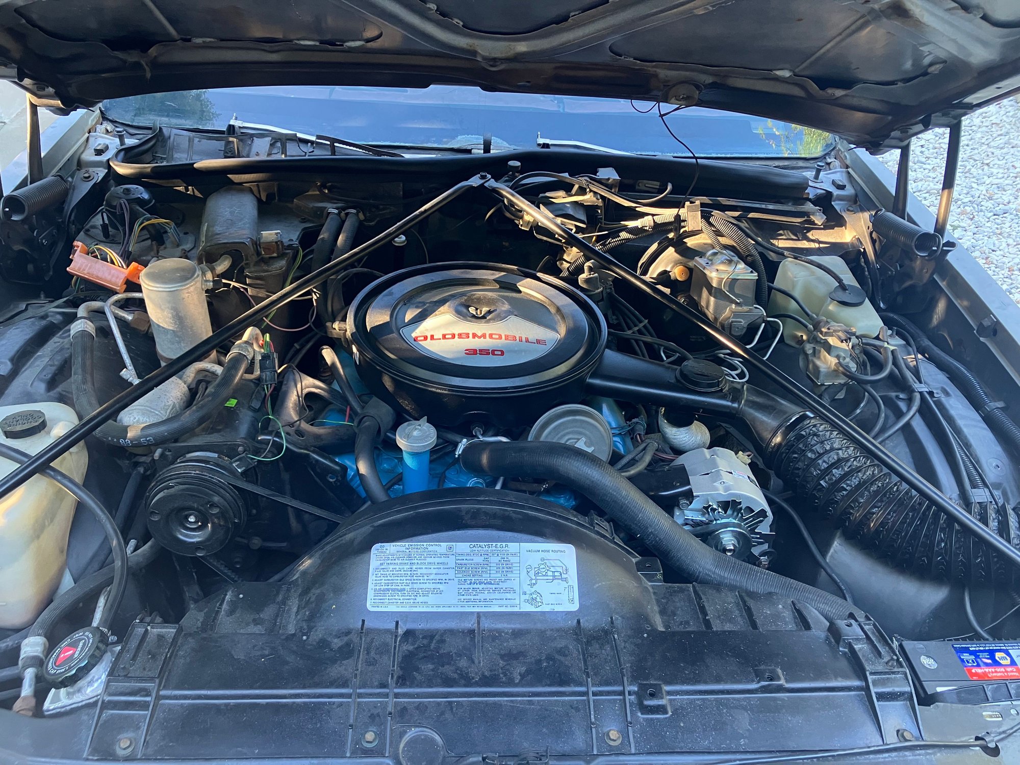

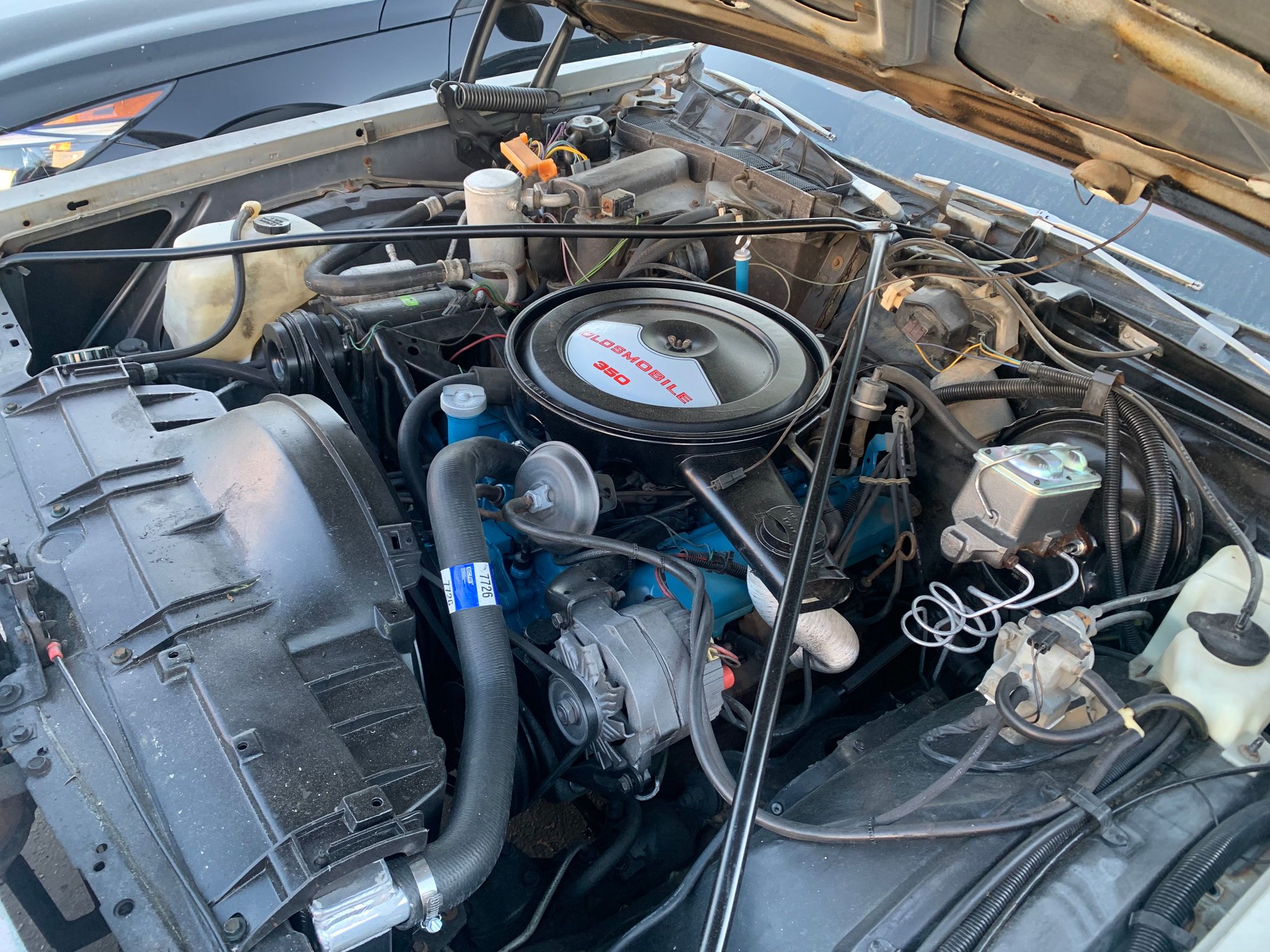

Been busy with work and then got some damn cold / flu thing…. but I did manage to make progress…
Lots of new stuff under the hood now…
*Carb (rebuilt Quadrajet)
*Fuel pump (and Fuel tank)
*Distributor
*Plugs and wires
*Ignition coil
*Belts and hoses / valve cover gaskets
*Master cylinder and booster
*Radiator (tried to fix the original but it was too far gone…)
*Water pump
*Battery
I’ve also done
*Front and rear brakes
*Front and rear shocks
*Body bushings
*Front suspension
*A/C Compressor
If nothing else it’s starting to look OK when I pop the hood …

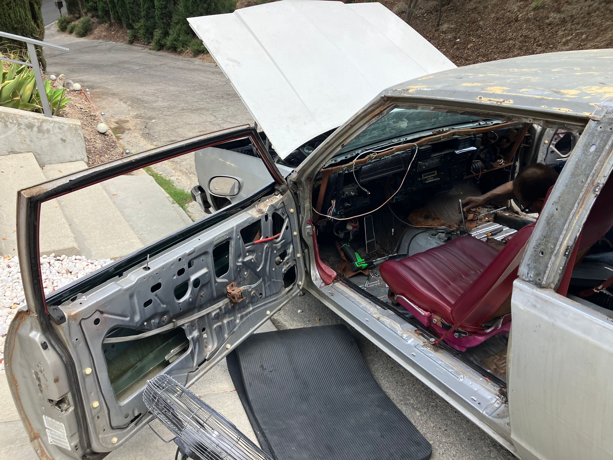

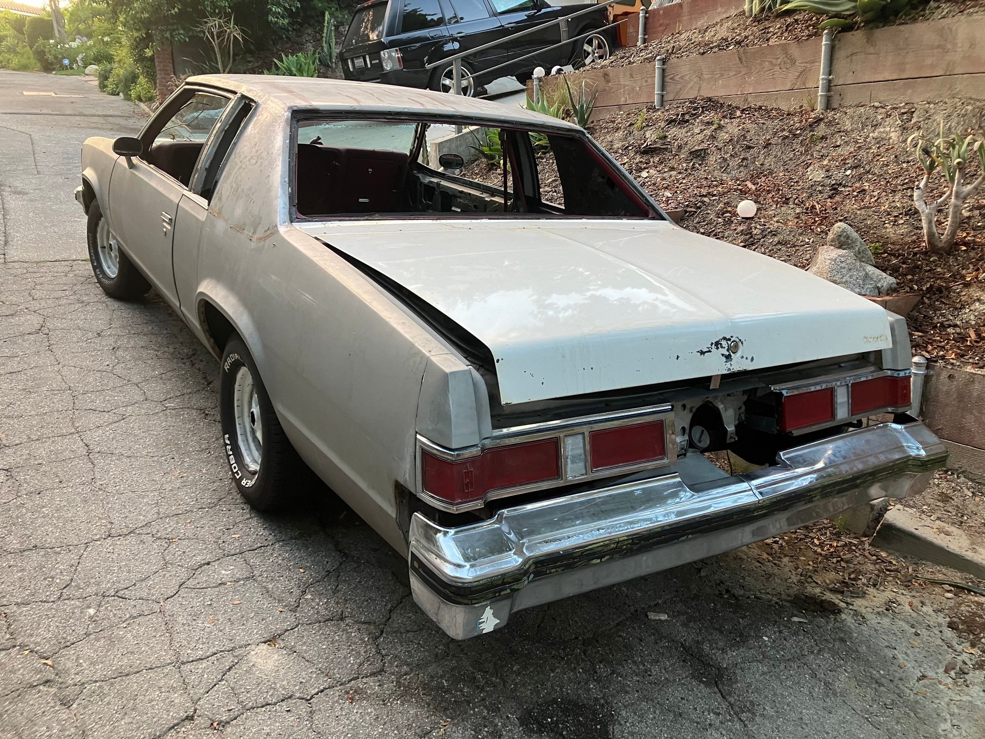

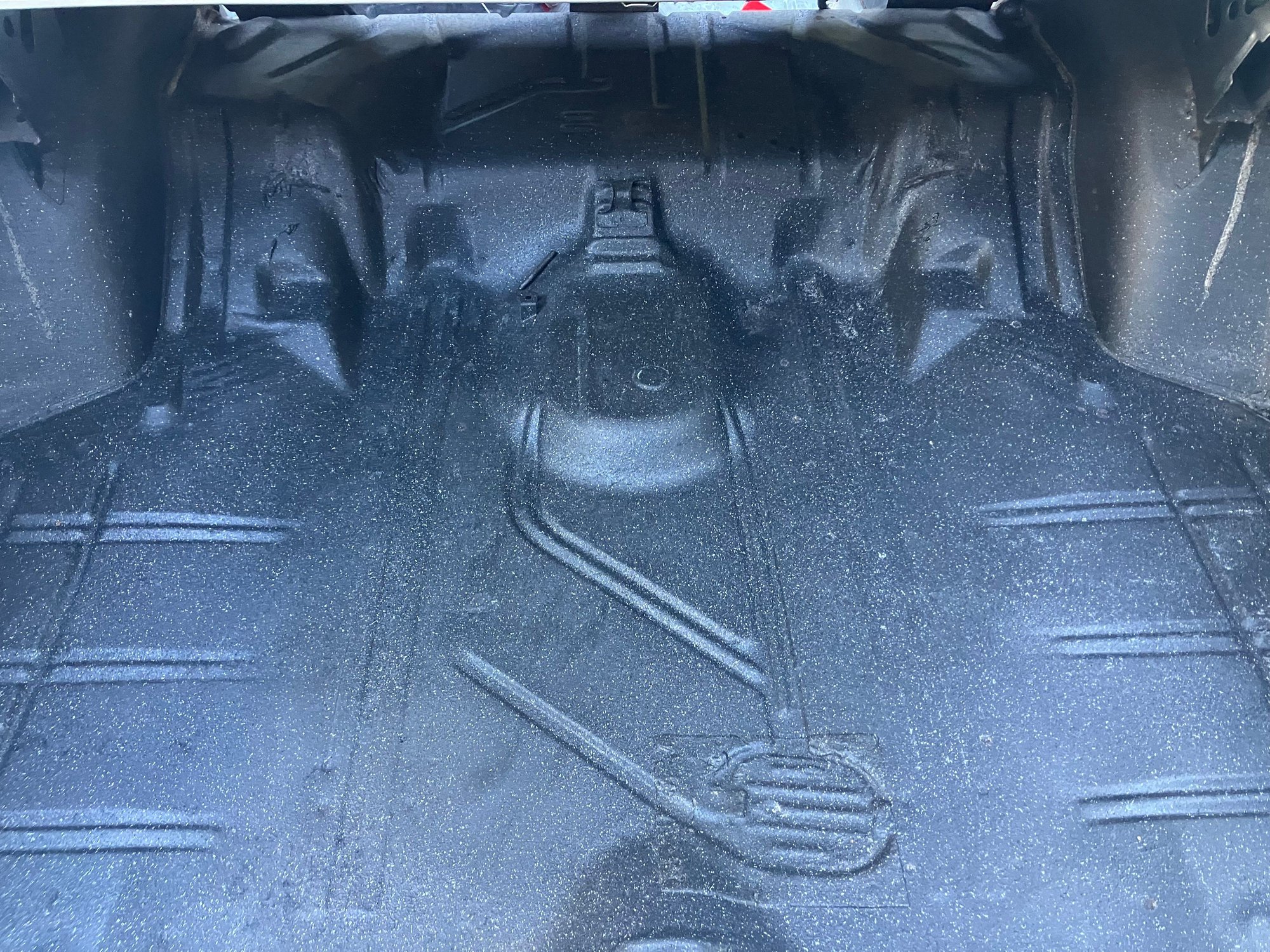

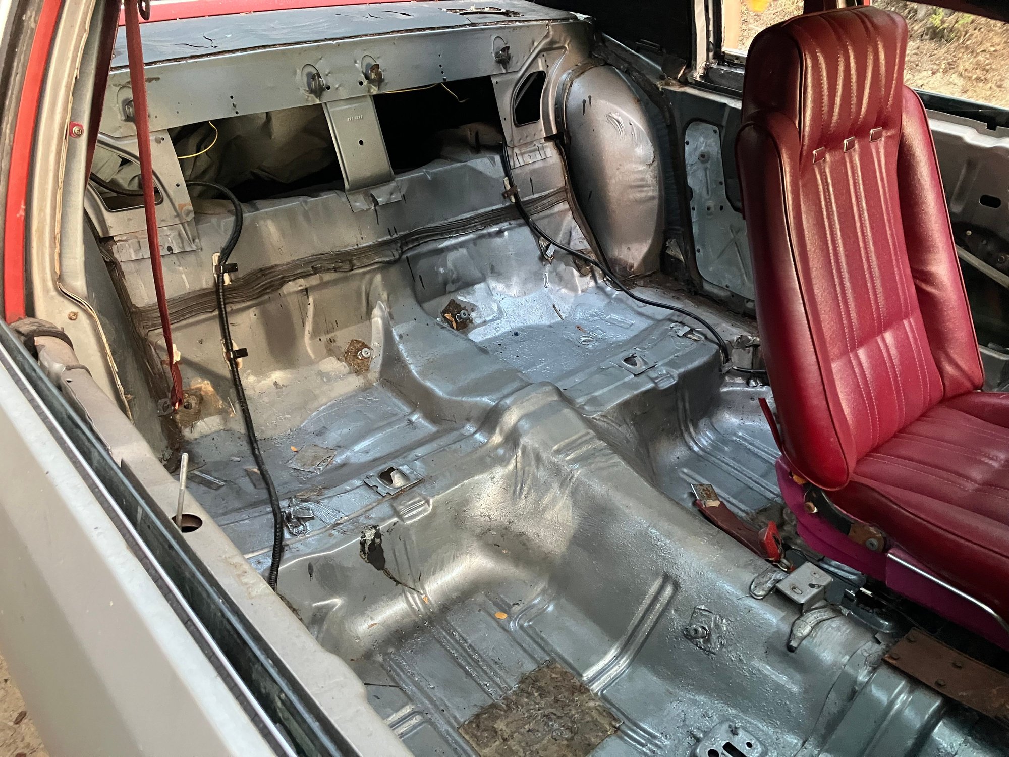

Stripped her down pretty good … lots of work to get it to this point. No big surprises so far… Need to order the rear bumper fillers and then I will be able to move to paint …

New alternator, the old one **** the bed
Got a black 4” duct to run from the air cleaner to the fender. Tried find the OE part but couldn’t… this one is close(ish) except for the clamp
Found the hood to cowl seal so that was good
Found the fan shroud sticker on eBay

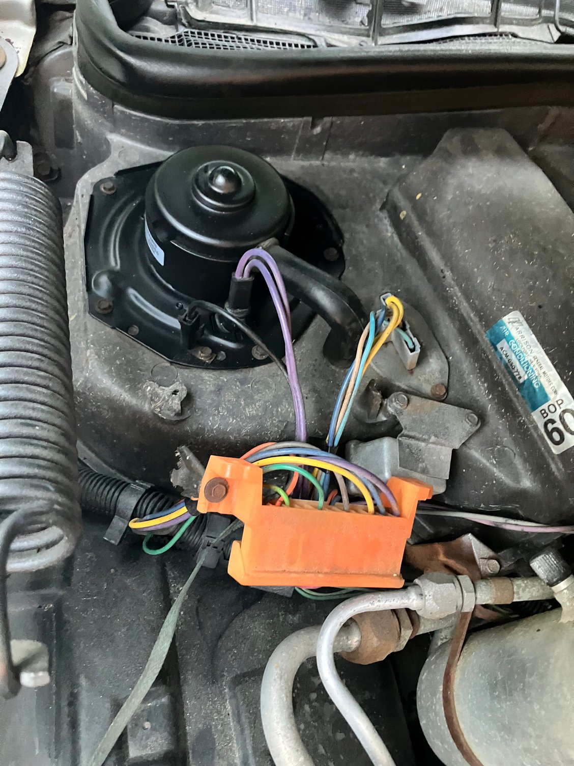

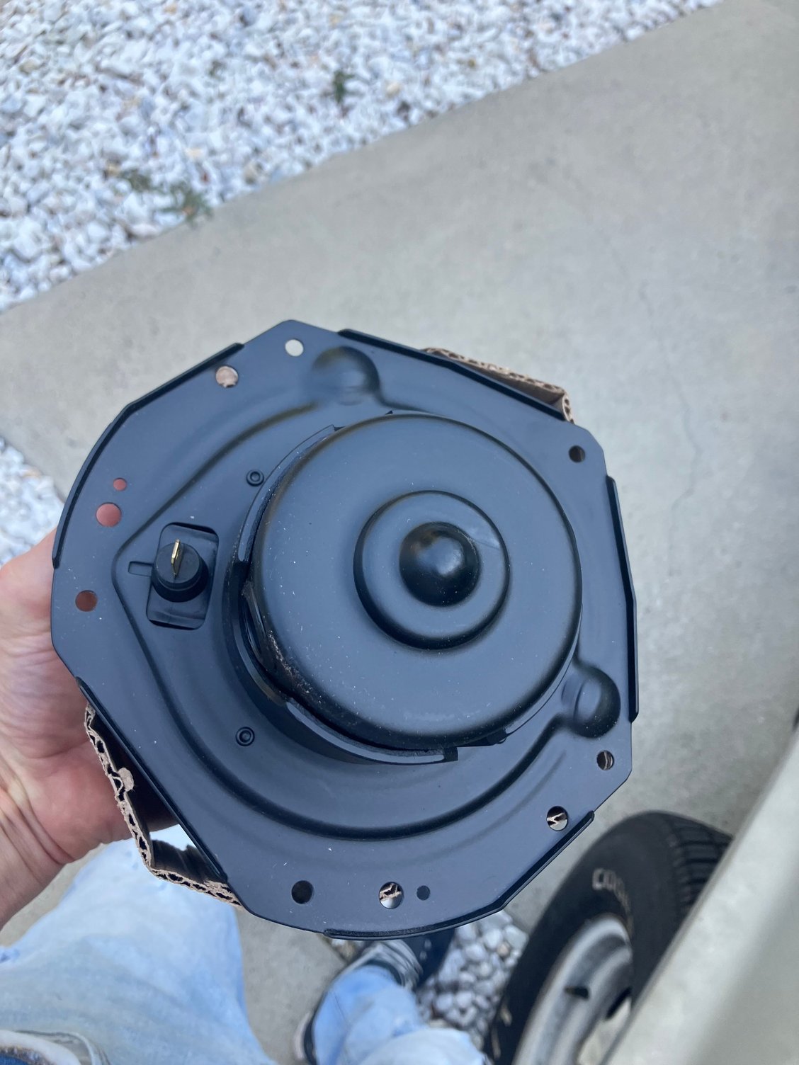

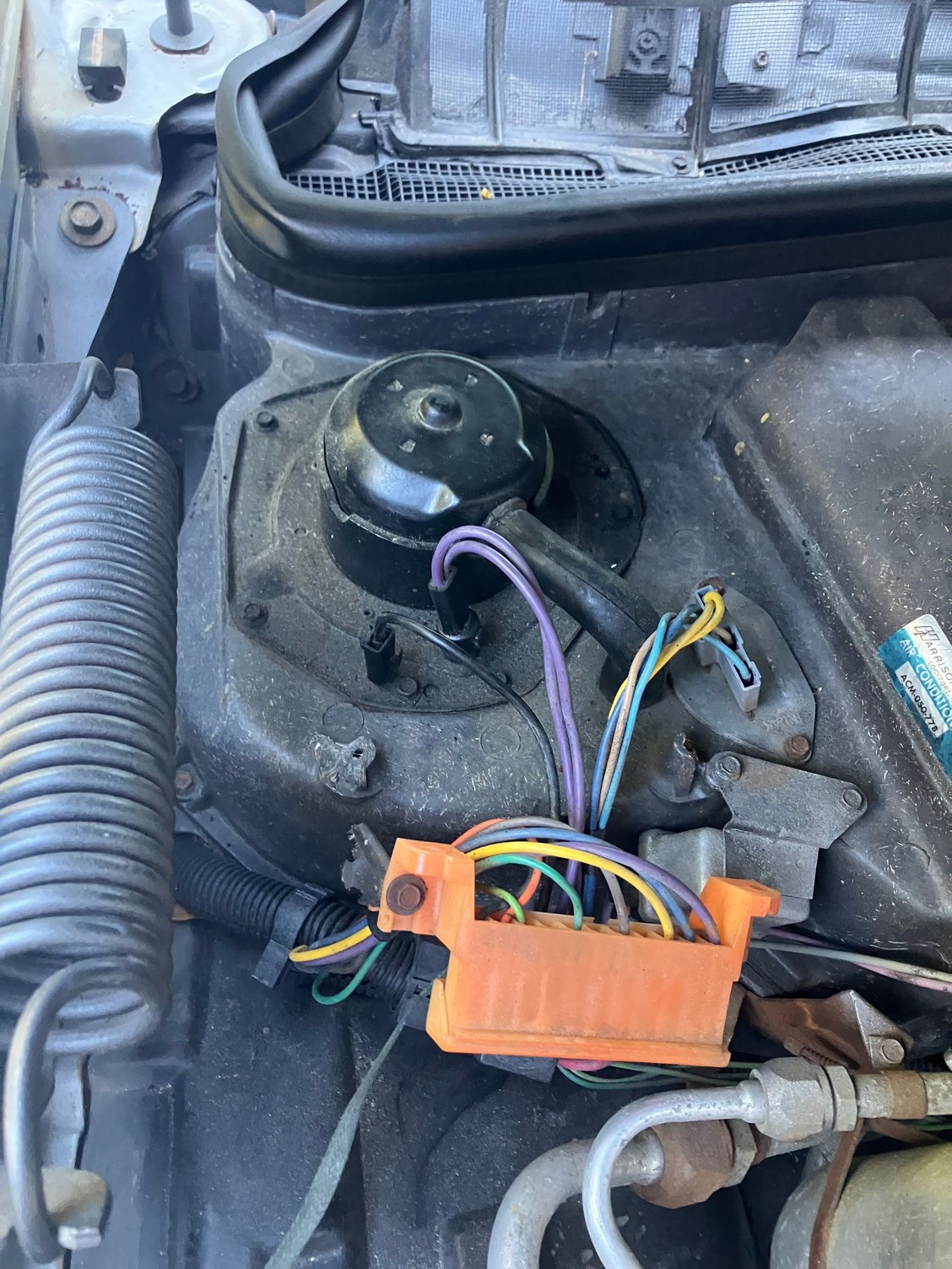

Ordered a new blower motor as well … gonna start in on the A/C and right now the motor is not working

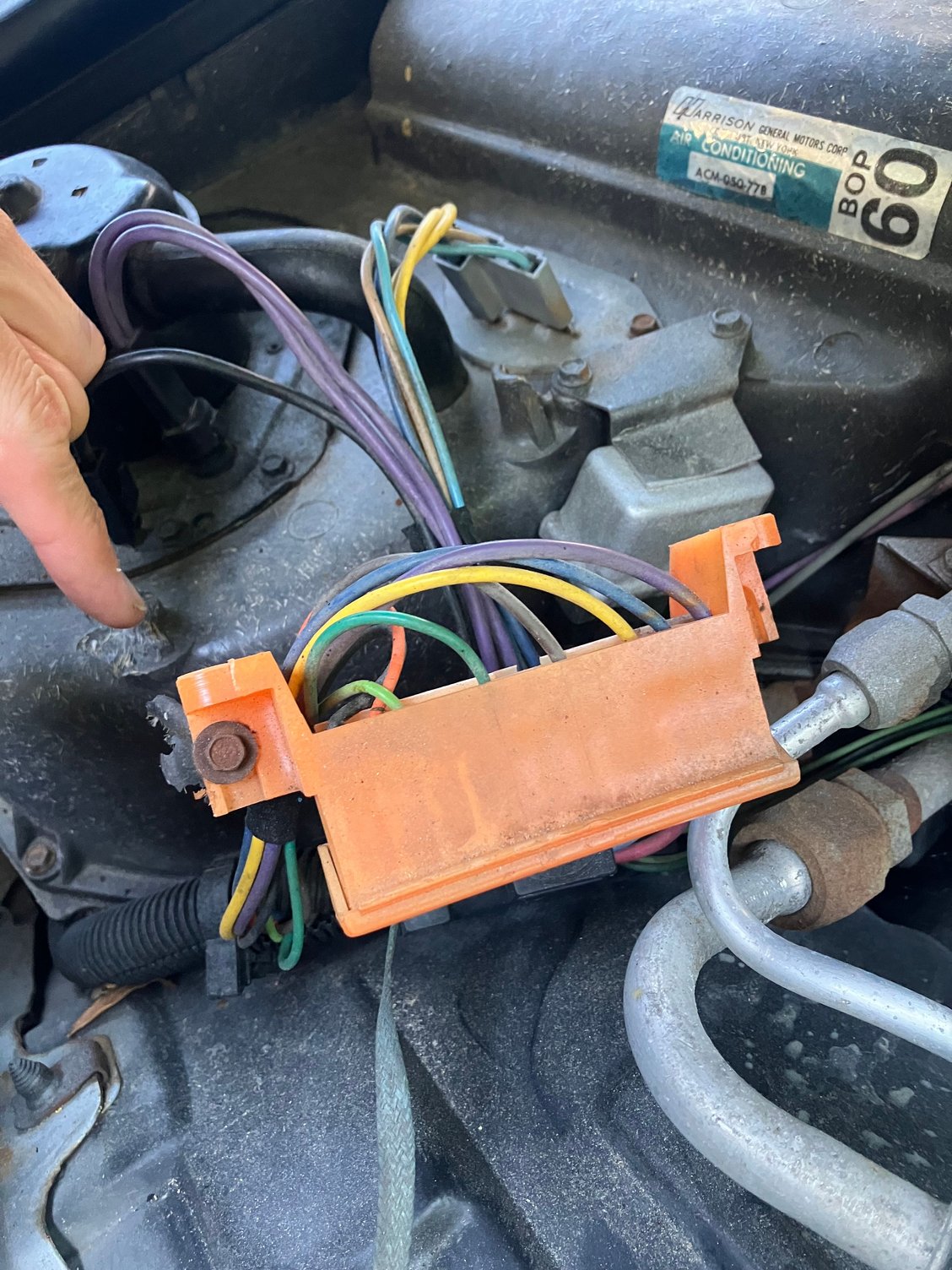

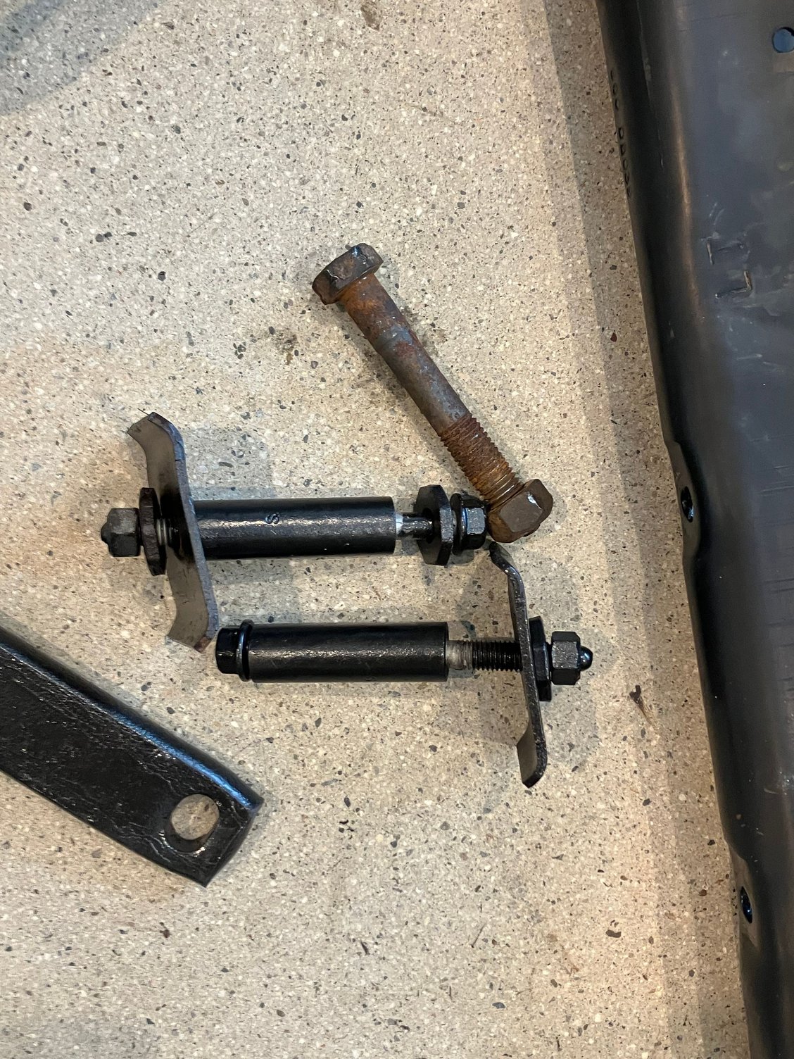

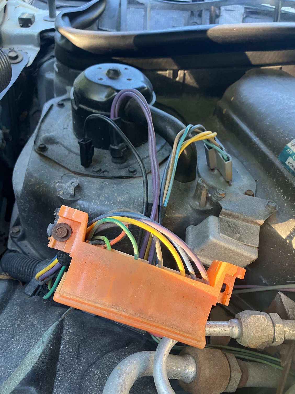

I also gotta figure out how to fix the orange housing / harness… the mounts were broken off
But it’s been running well, even in this awful heat

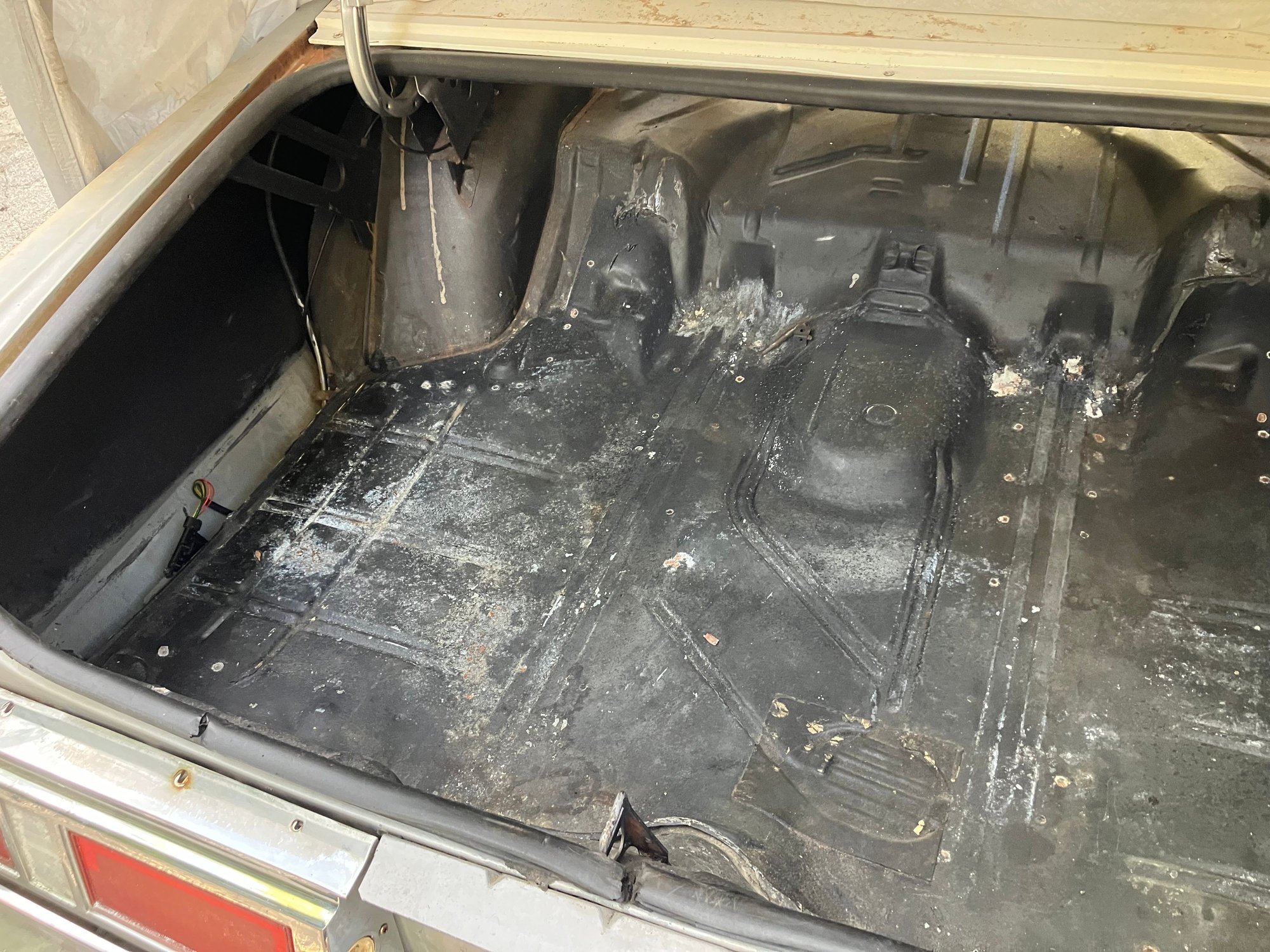

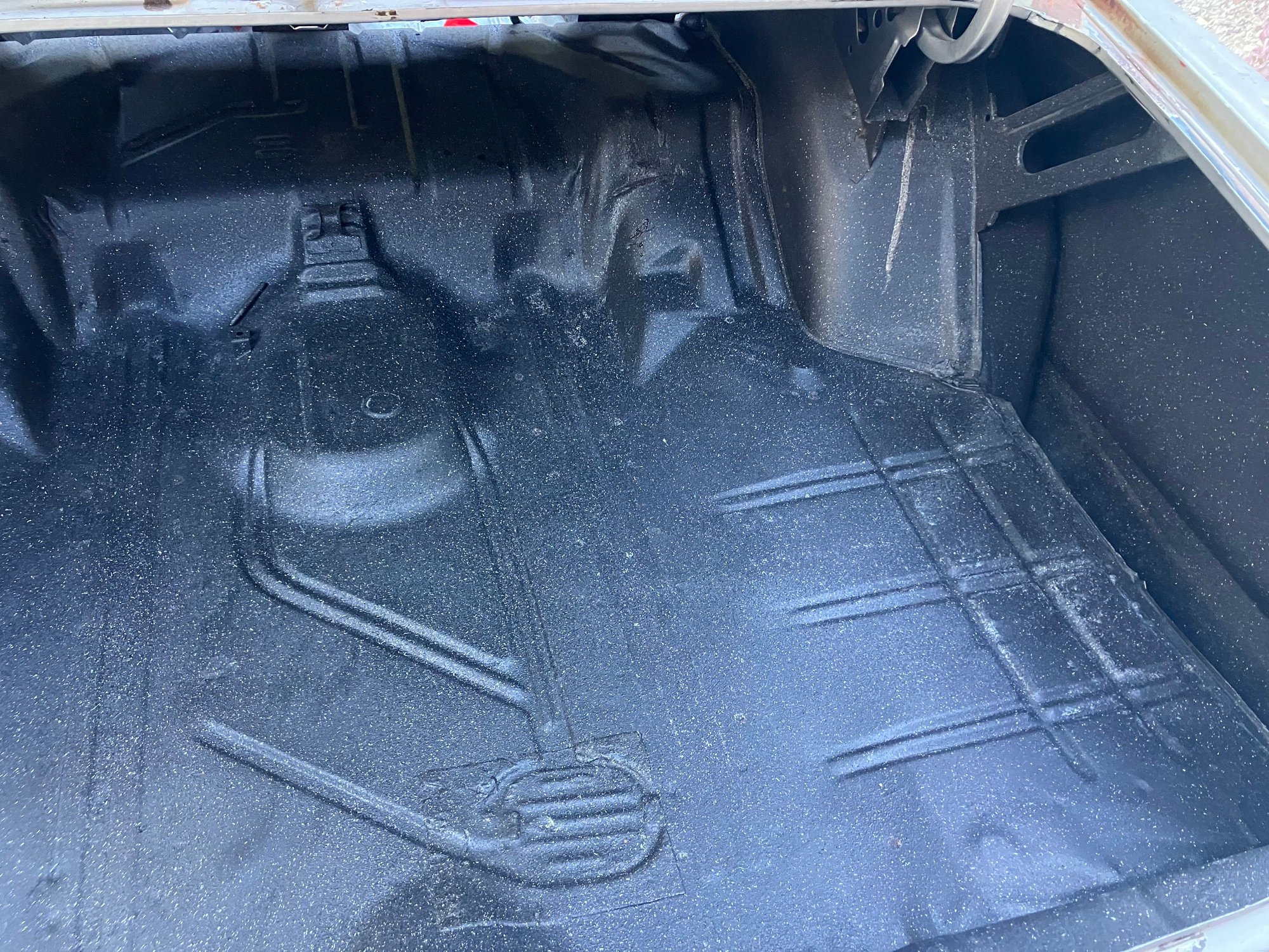

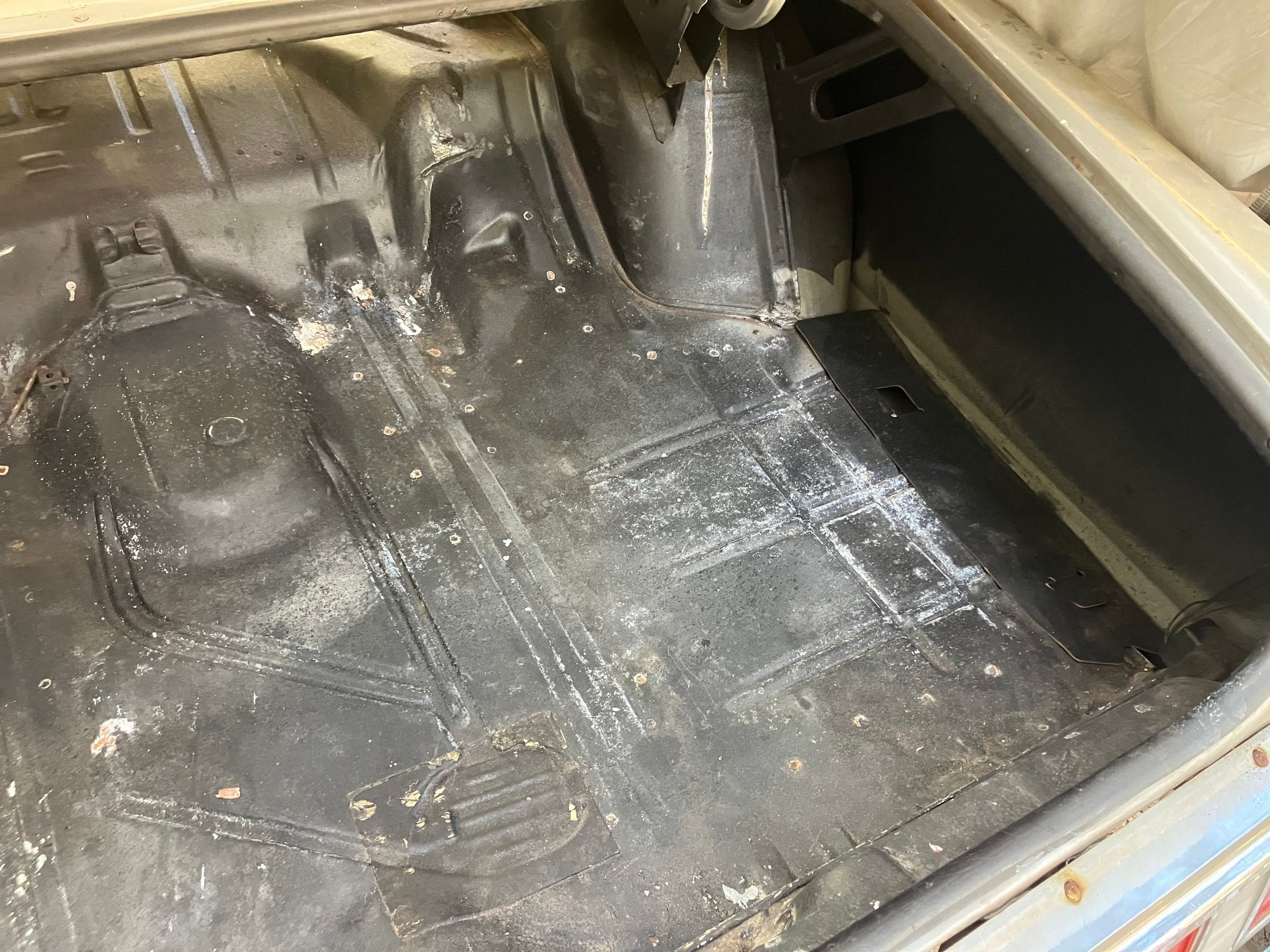

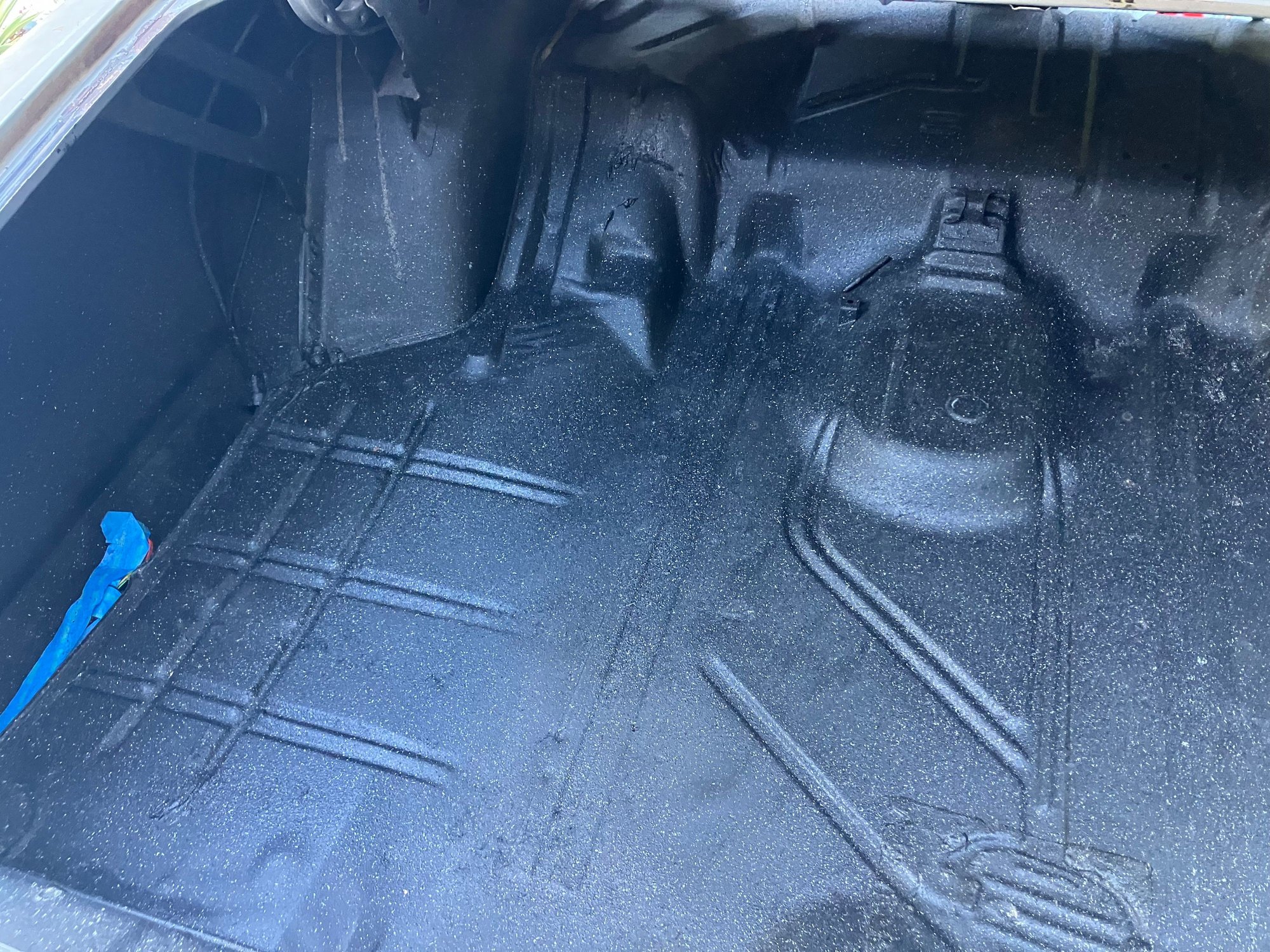

Also had to remove the trunk seal for when it’s in for paint… that was a PITA…. While I was in there I sanded and painted the trunk… I needed something that looks “new” to keep me motivated… I think it looks good for a rattle can job (forgive the blue painters tape I still need to clear coat everything).

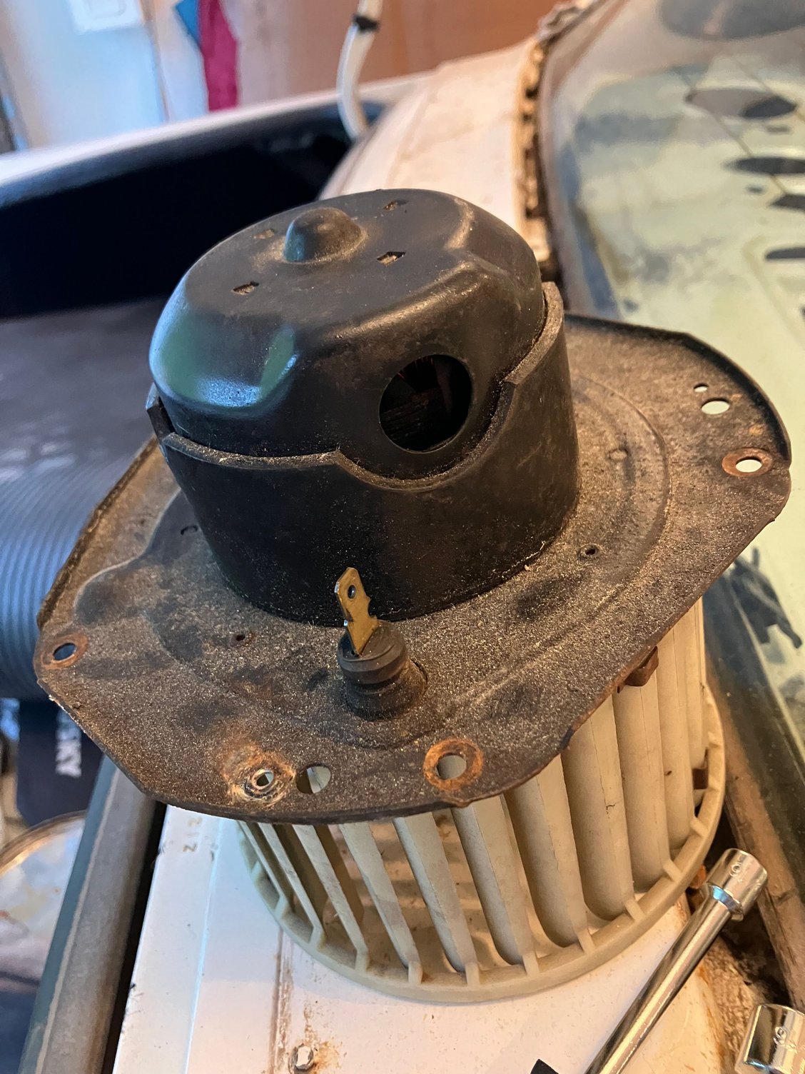

Started in on the HVAC last night . I had voltage to the motor so I thought the motor was bad and went ahead and replaced it…. Unfortunately that didn’t solve the problem so I will try and chase down what it is … first time dealing with HVAC so it will be a learning process…

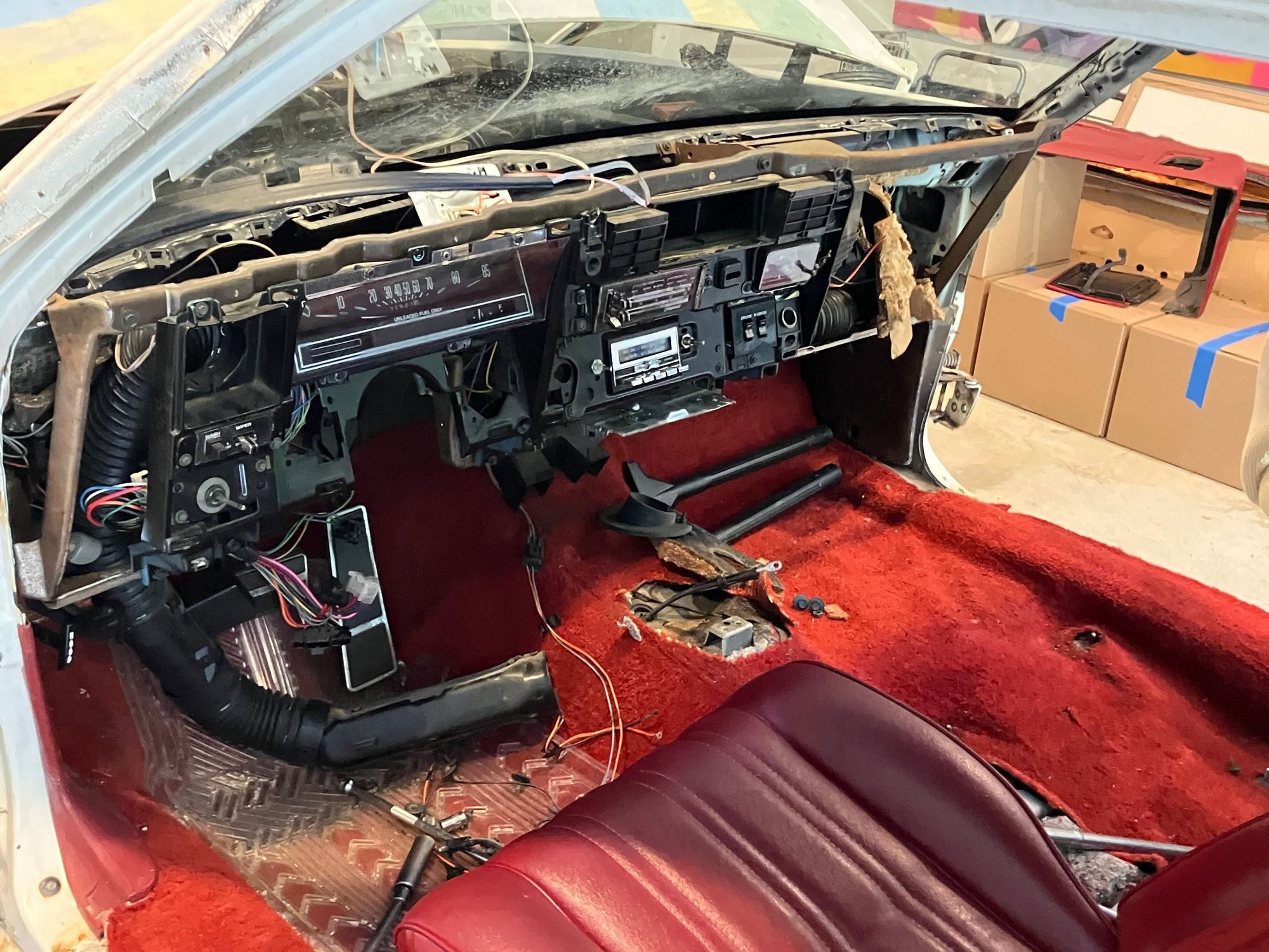

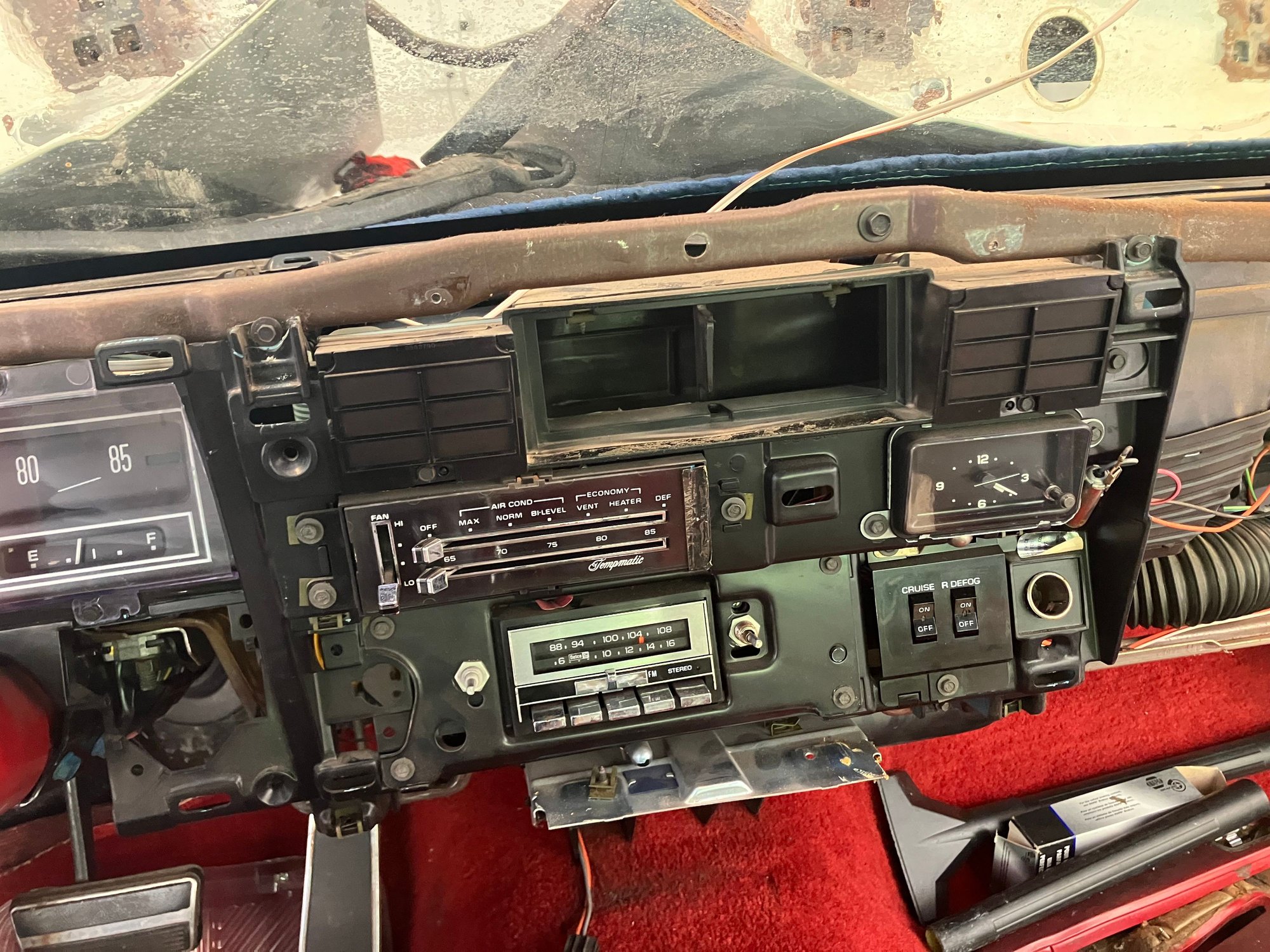

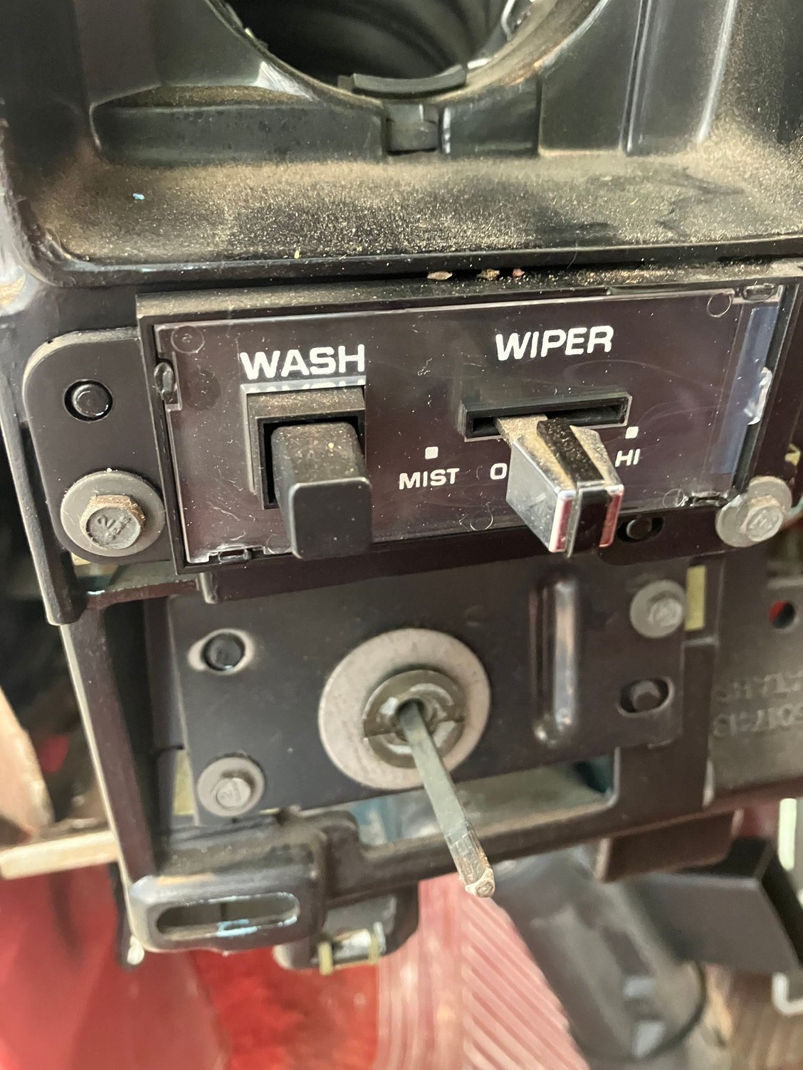

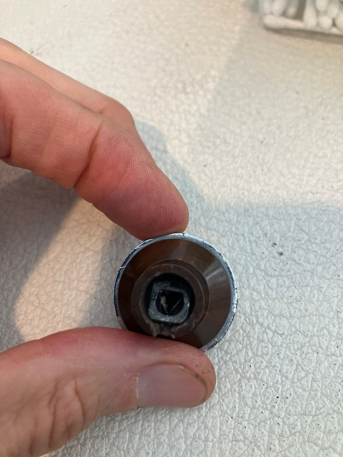

Took a break from the HVAC last night - sort of. I wanted to get the switch / assembly from the donor car - and figured I’d take apart the rest of the dash while I was at it…
On these cars taking the dash apart requires getting the headlight **** off FIRST… don’t let anyone tell you different (you can’t reach under and push the button the get the **** and the shaft like on earlier GM cars)
Took awhile but got ‘er done

Got the column out of the “donor” vehicle. I’ll get the dash off tonight.
I also got the column and dash out of the “recipient” vehicle so it’s ready for the transplant operation
Donor car has the clock option. Clock doesn’t work so I’ll find someone to sort that out. Donor car also has rear window defogger option .., because Midwest … unlike the clock I won’t get any use out of that.
Otherwise I’m keeping my fingers crossed that this is plug and play.

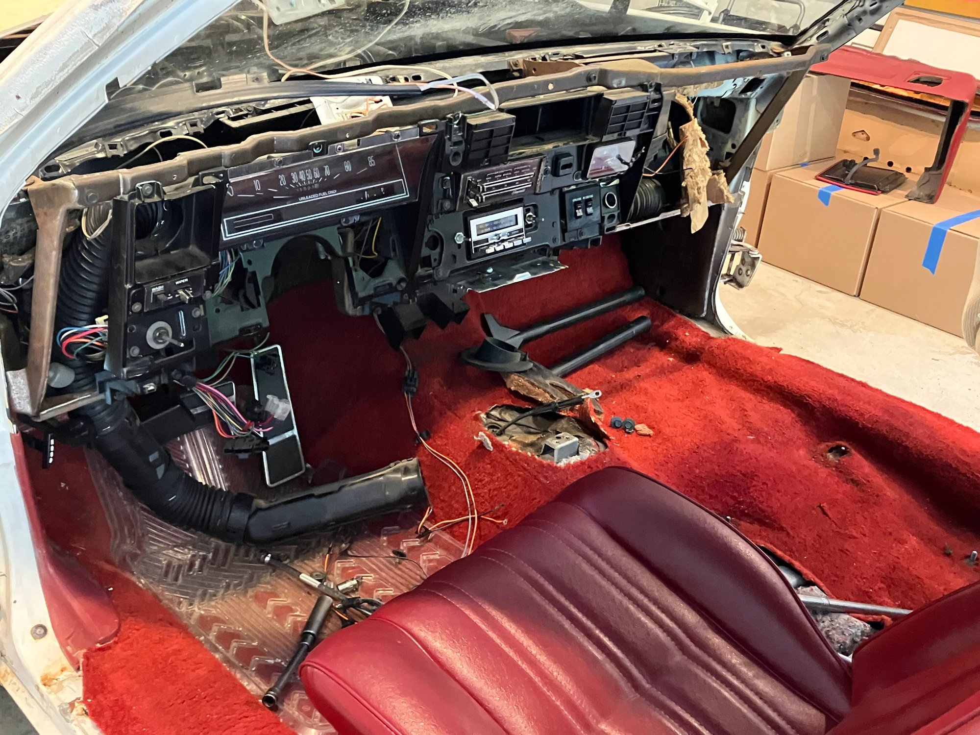

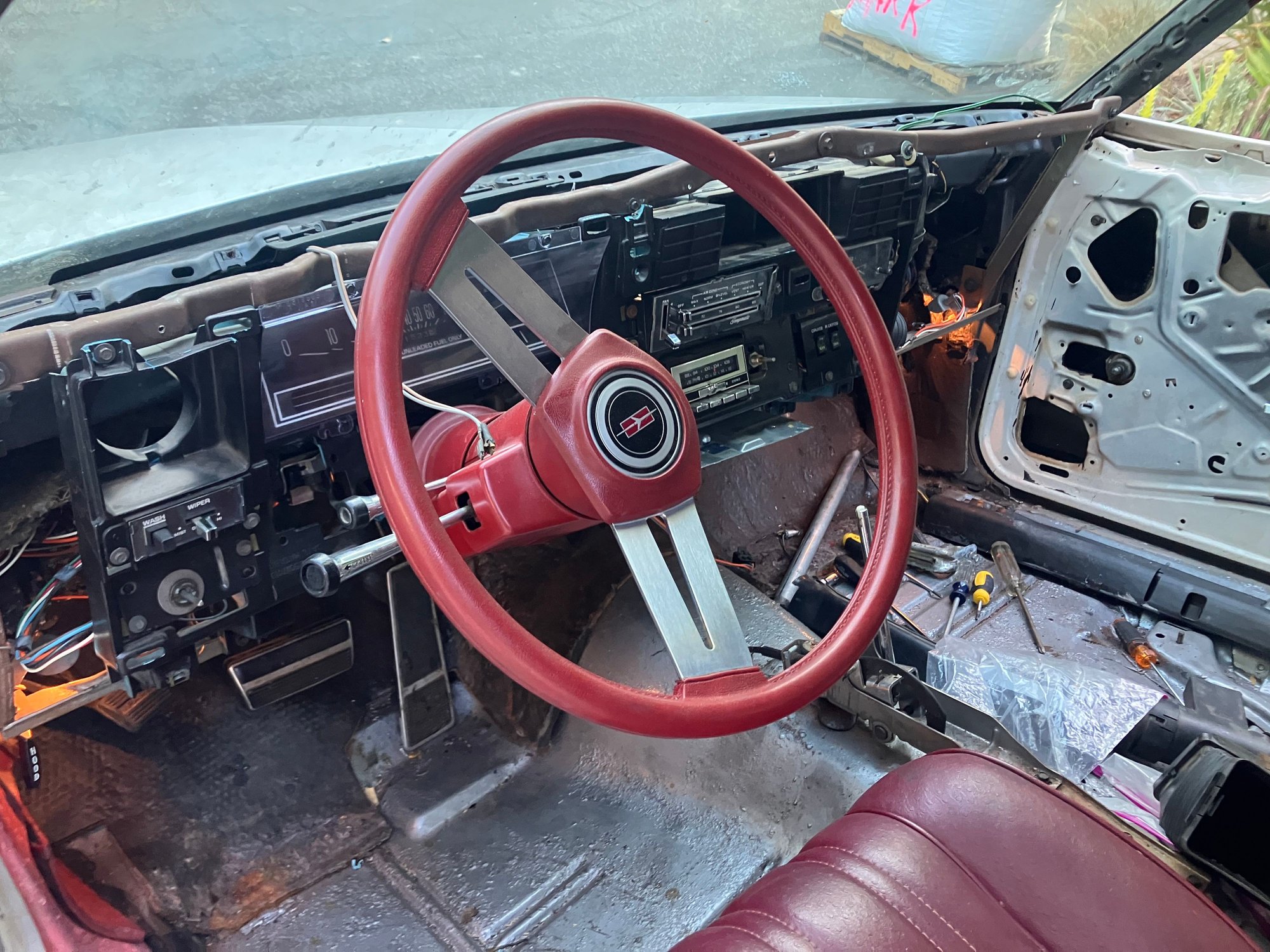

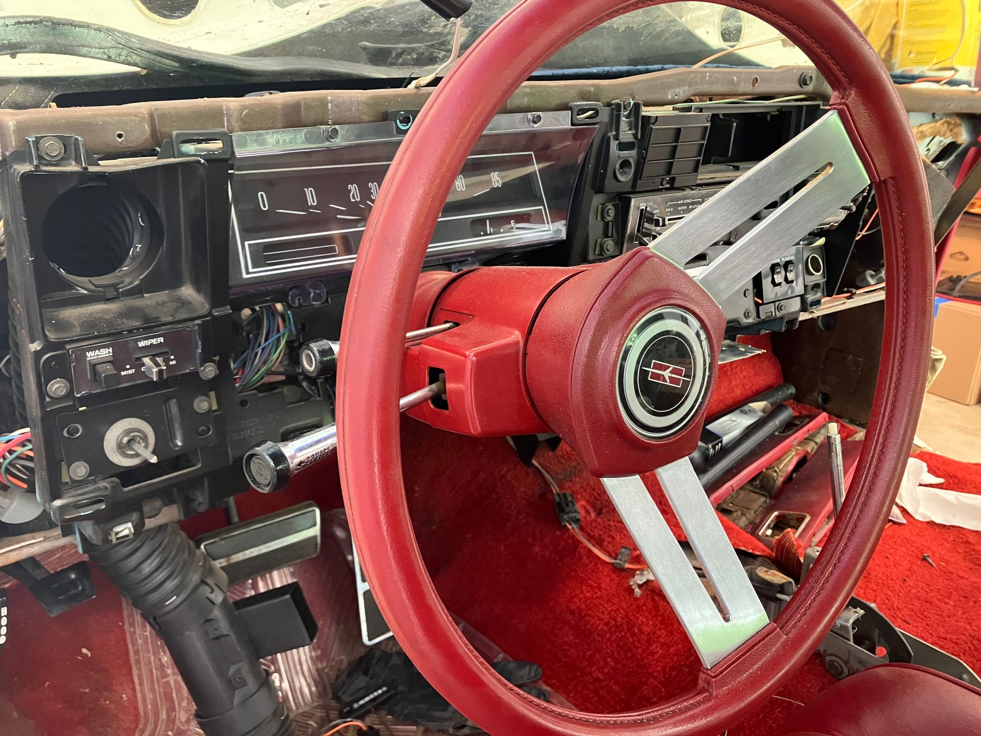

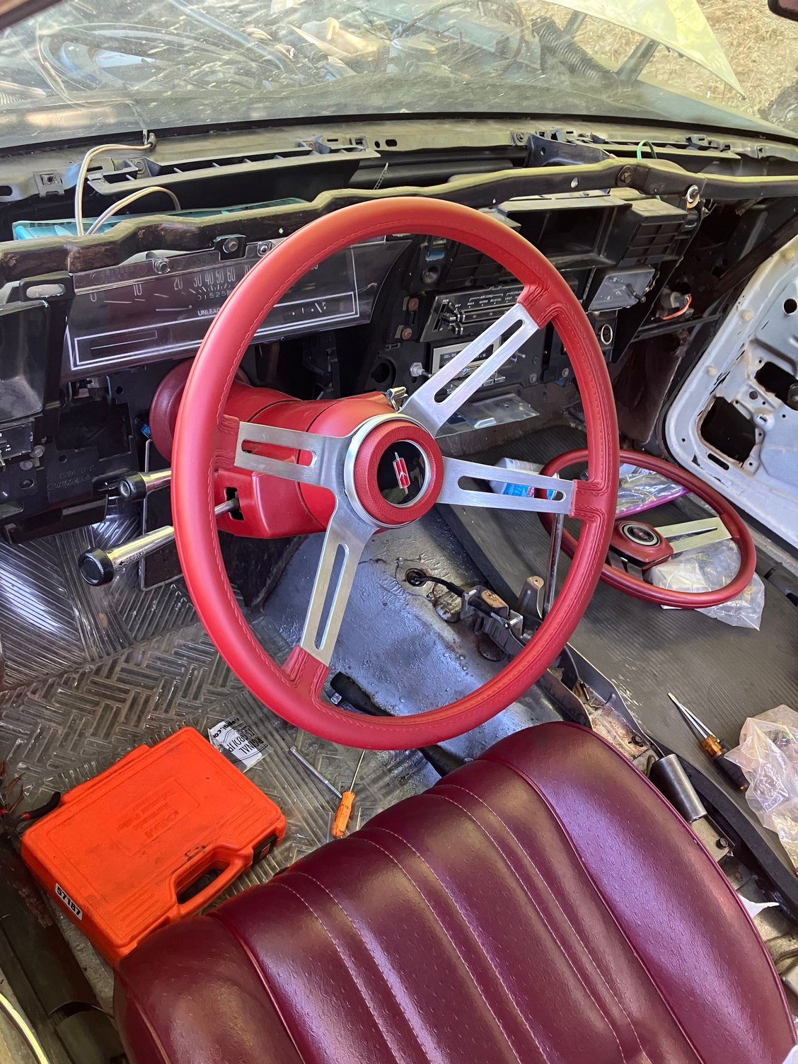

Got the dash and the column out of the donor and swapped into the recipient …Of course the steering wheel is 180 out… not sure why …otherwise everything is working so far… I need to put in a new A/C compressor and convert to R134… more to come
Old Sep 29, 2024 | 08:20 AM
  #57
mapearso's Avatar
Joined: Jun 2006
Posts: 115

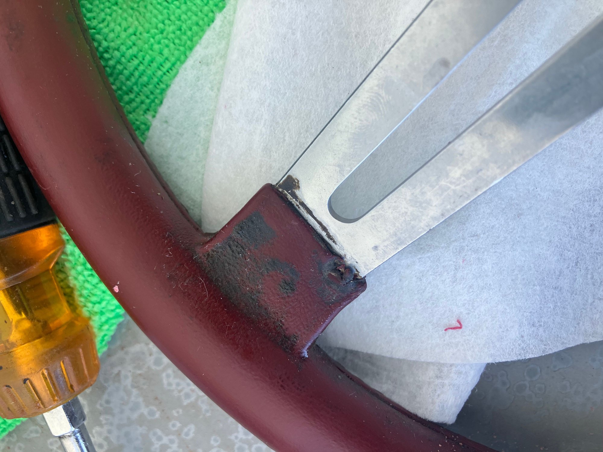

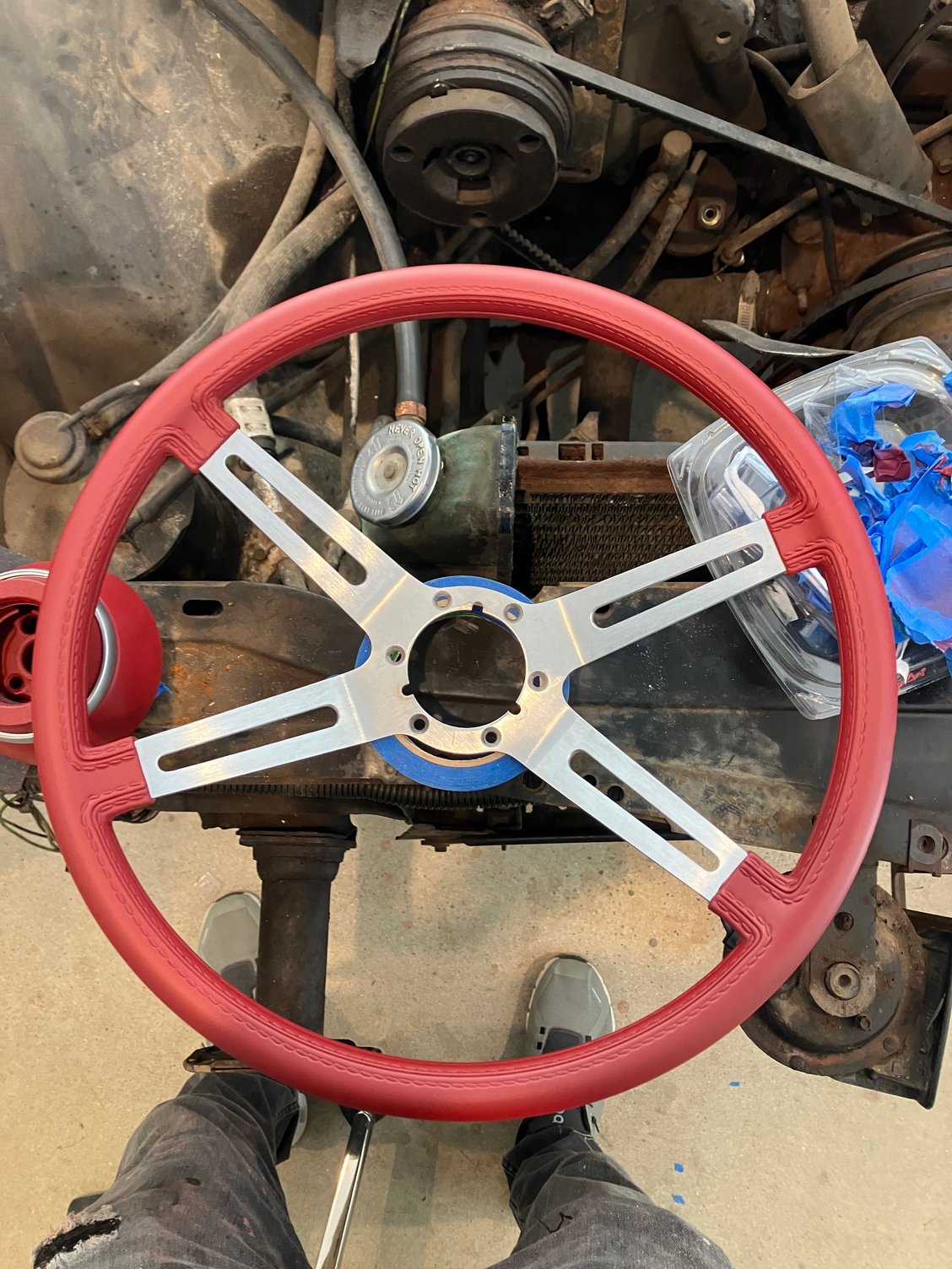

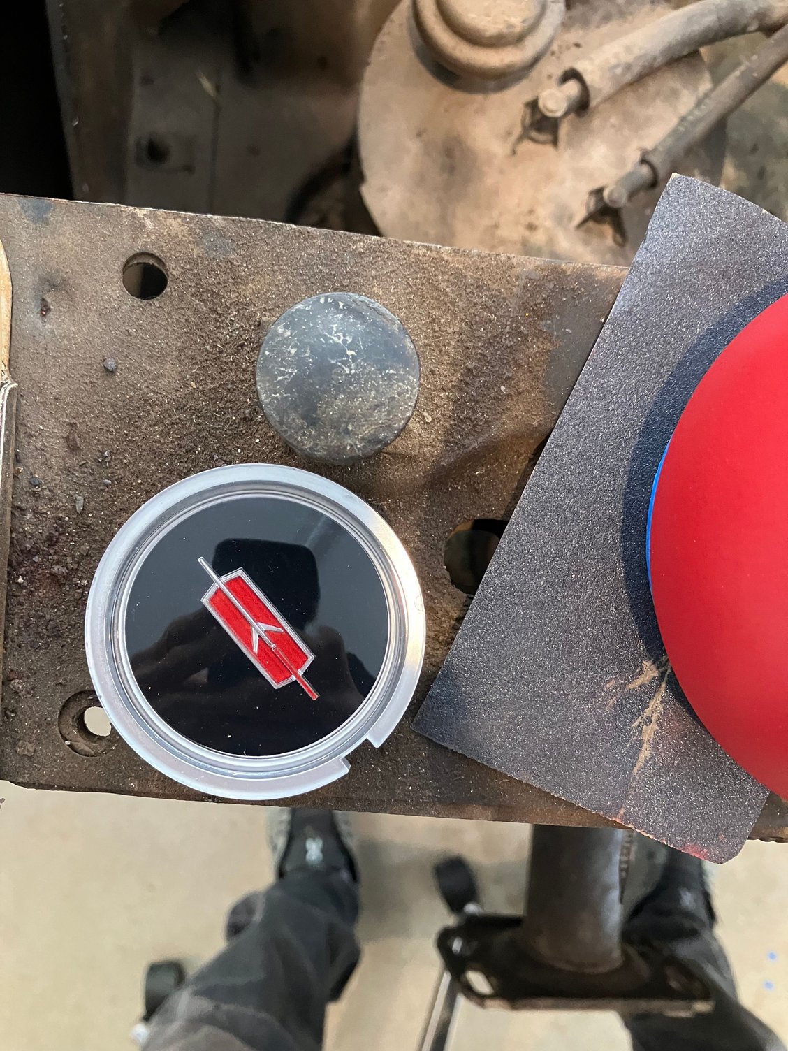

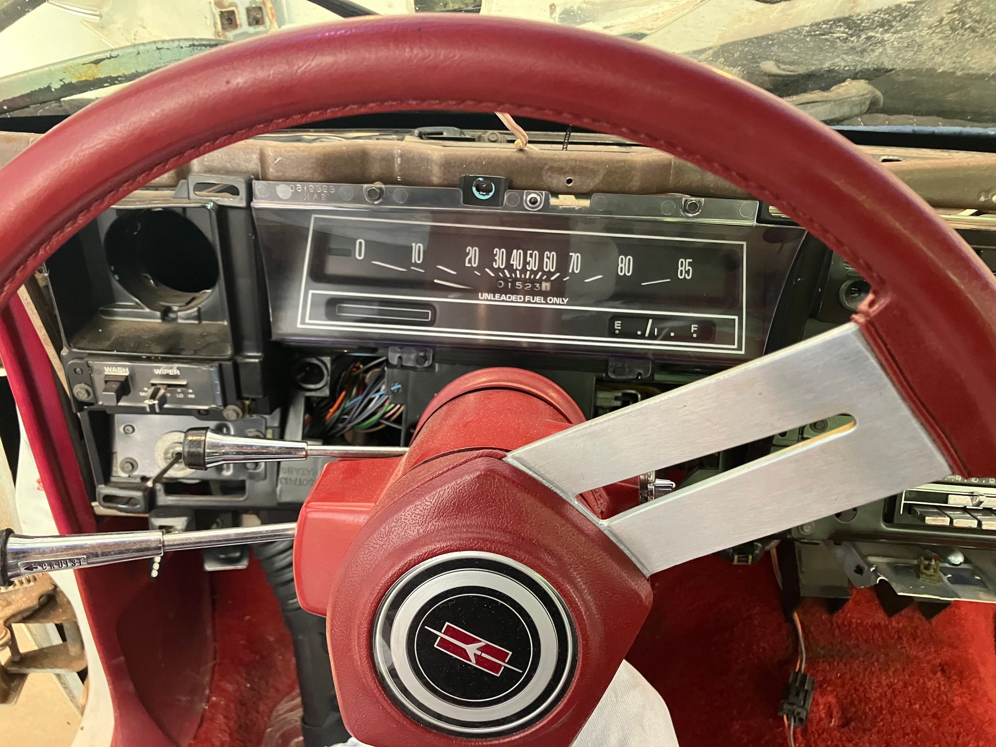

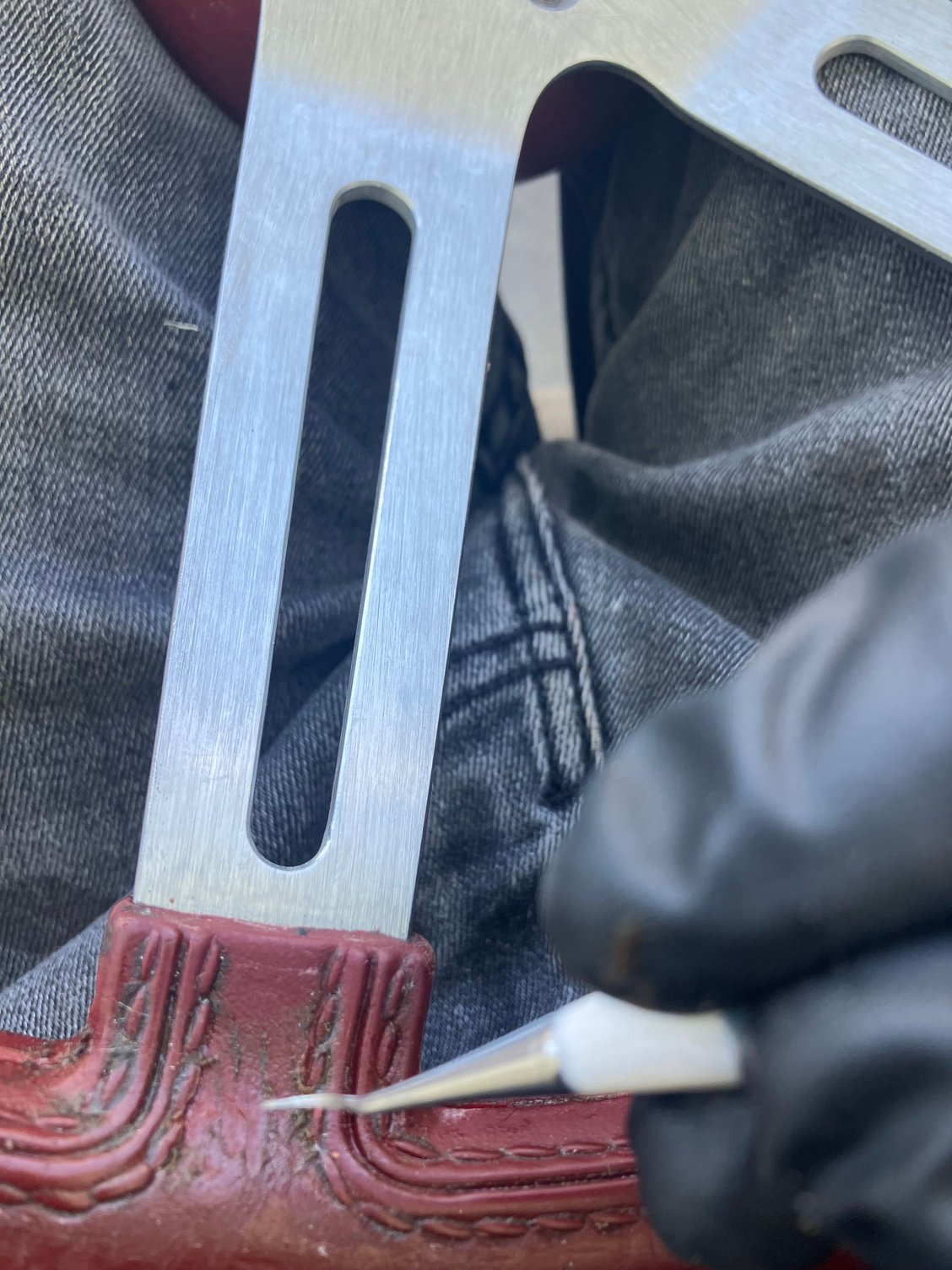

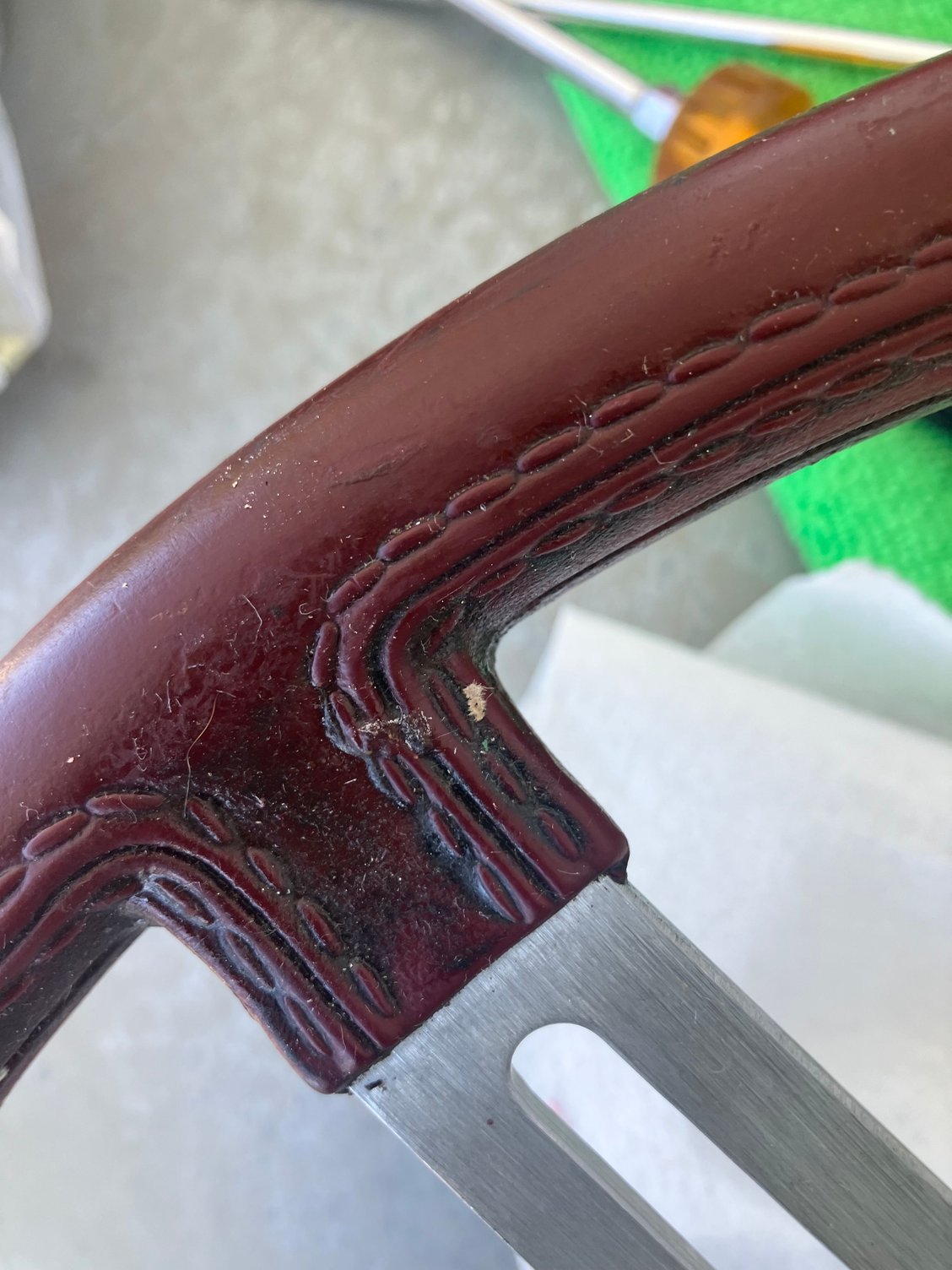

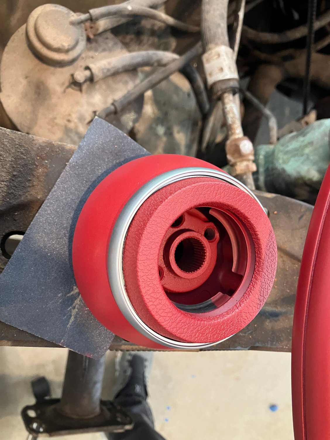

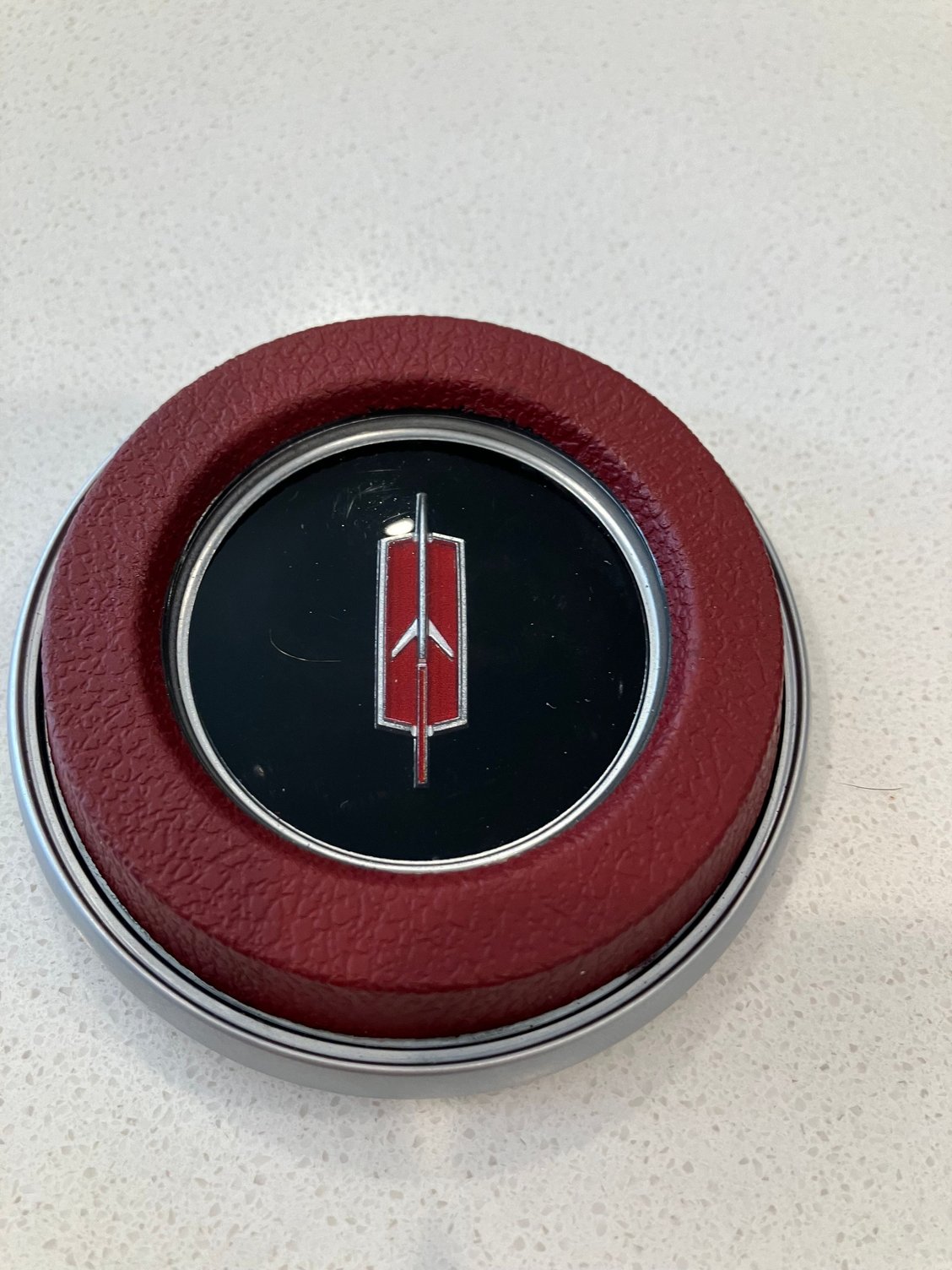

Steering wheel steel an issue. It was 120 out not 180. I think the problem is at the box.
The only solution I could come up with was to take out the correct 78 sport wheel with the wheel fixed in place on the hub and use an Olds 4 spoke wheel which allows for adjustment.

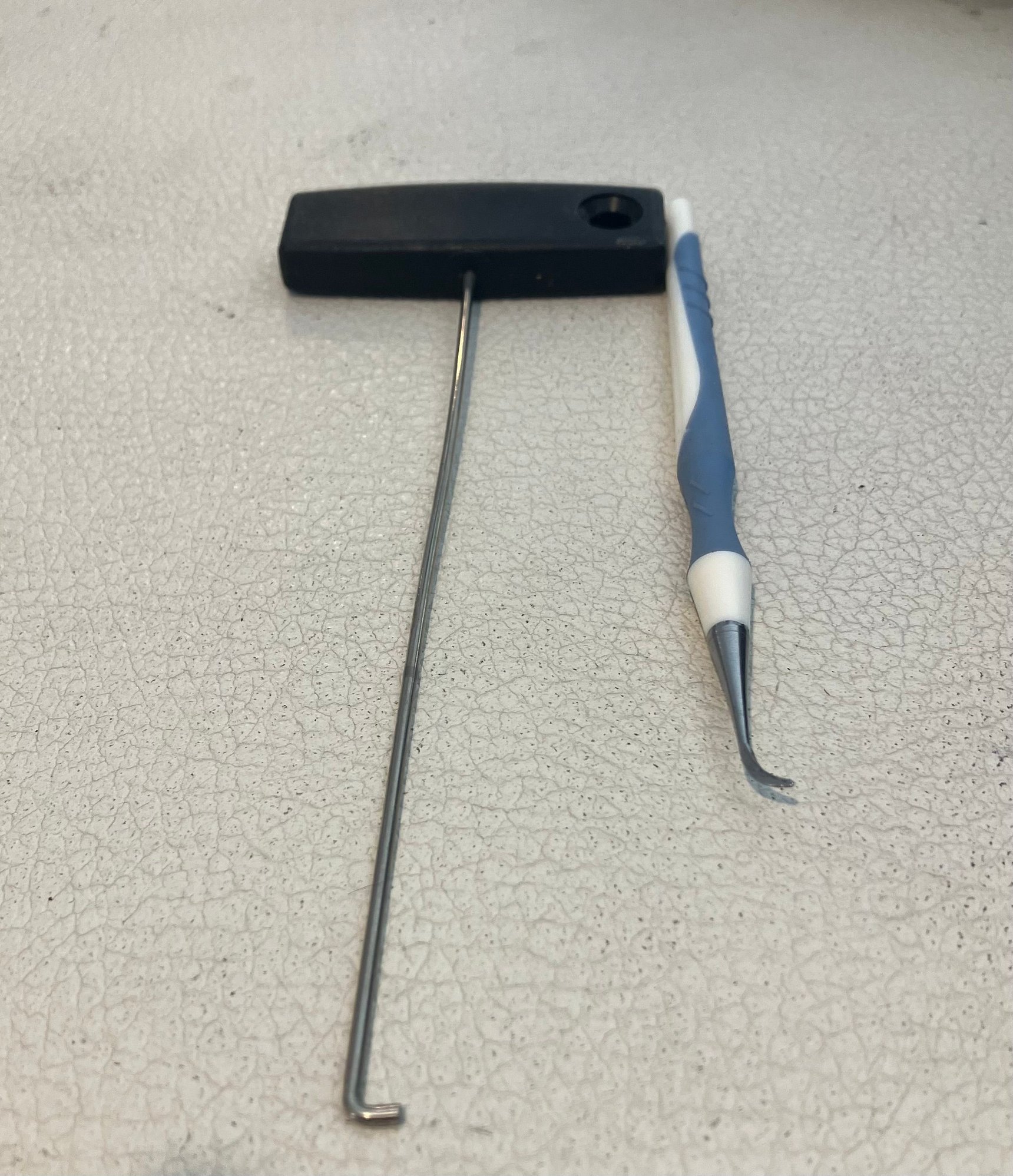

I found a red wheel with a hub for cheap but man was it filthy. Dental tool and some goo gone did the trick. Had to paint a black horn button to match. I think it cleaned up and came together pretty good. I know it’s not correct but it looks the business.
I’m going to have to modify the horn button attachment to get the horn to work.

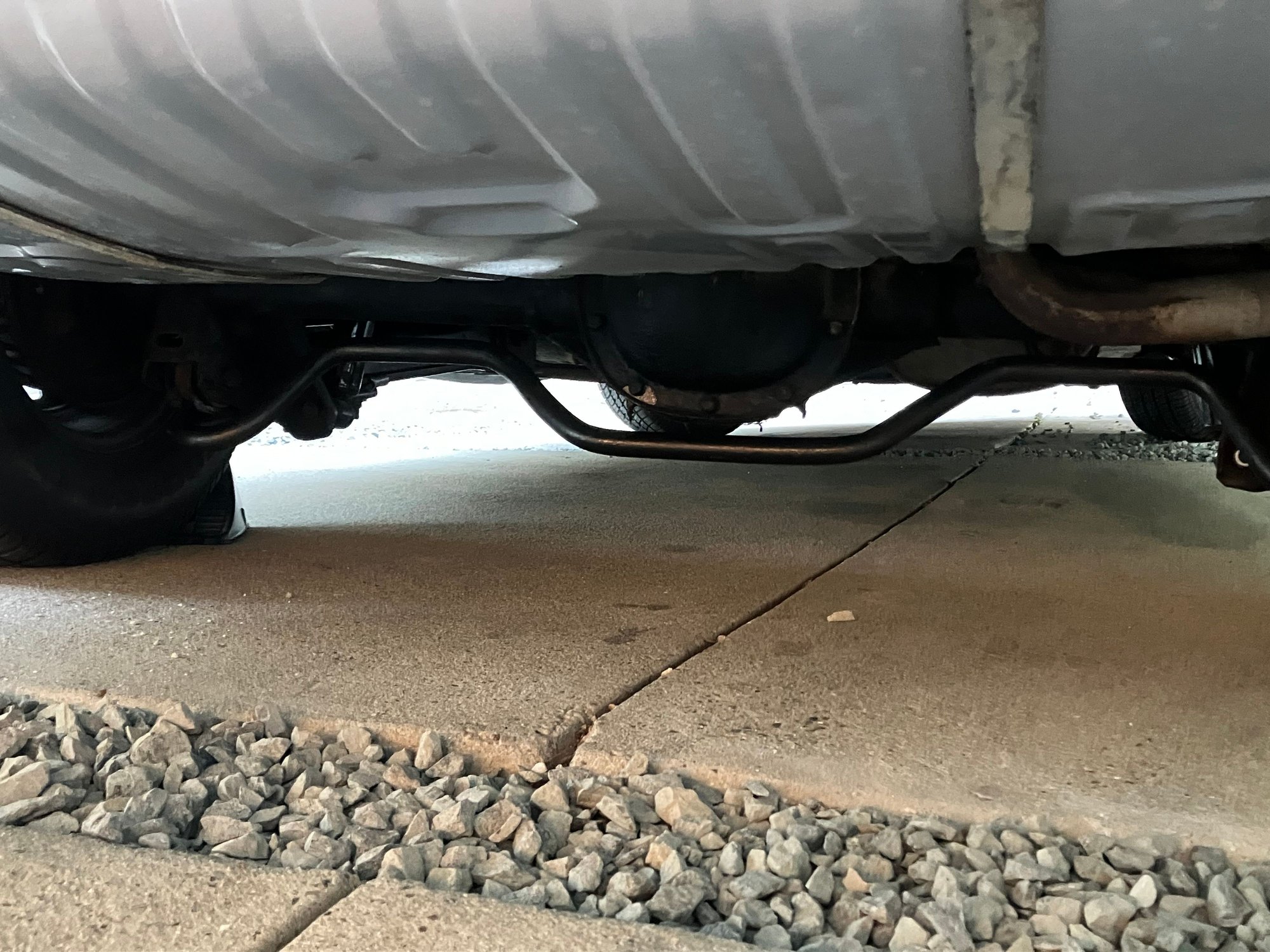

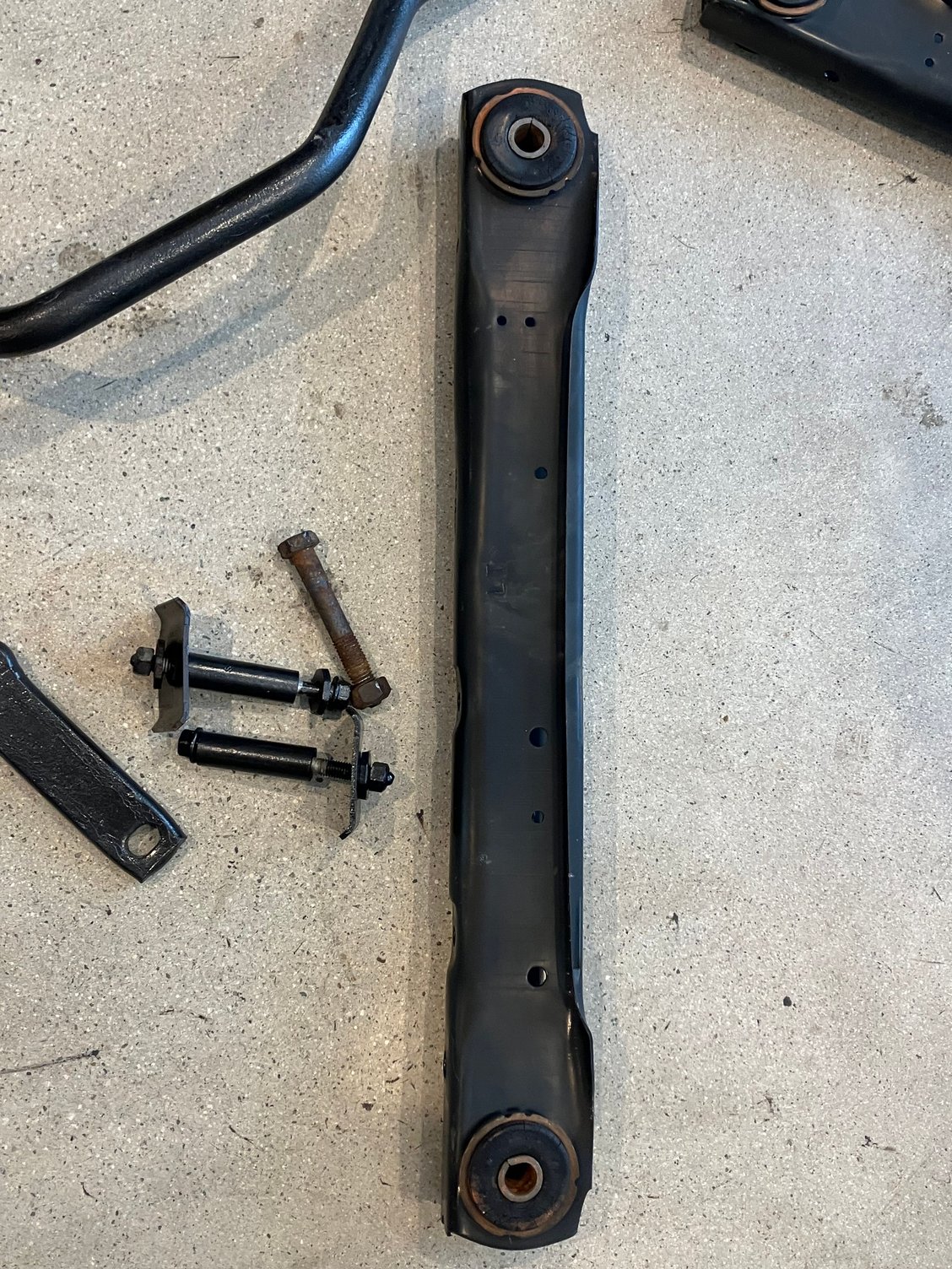

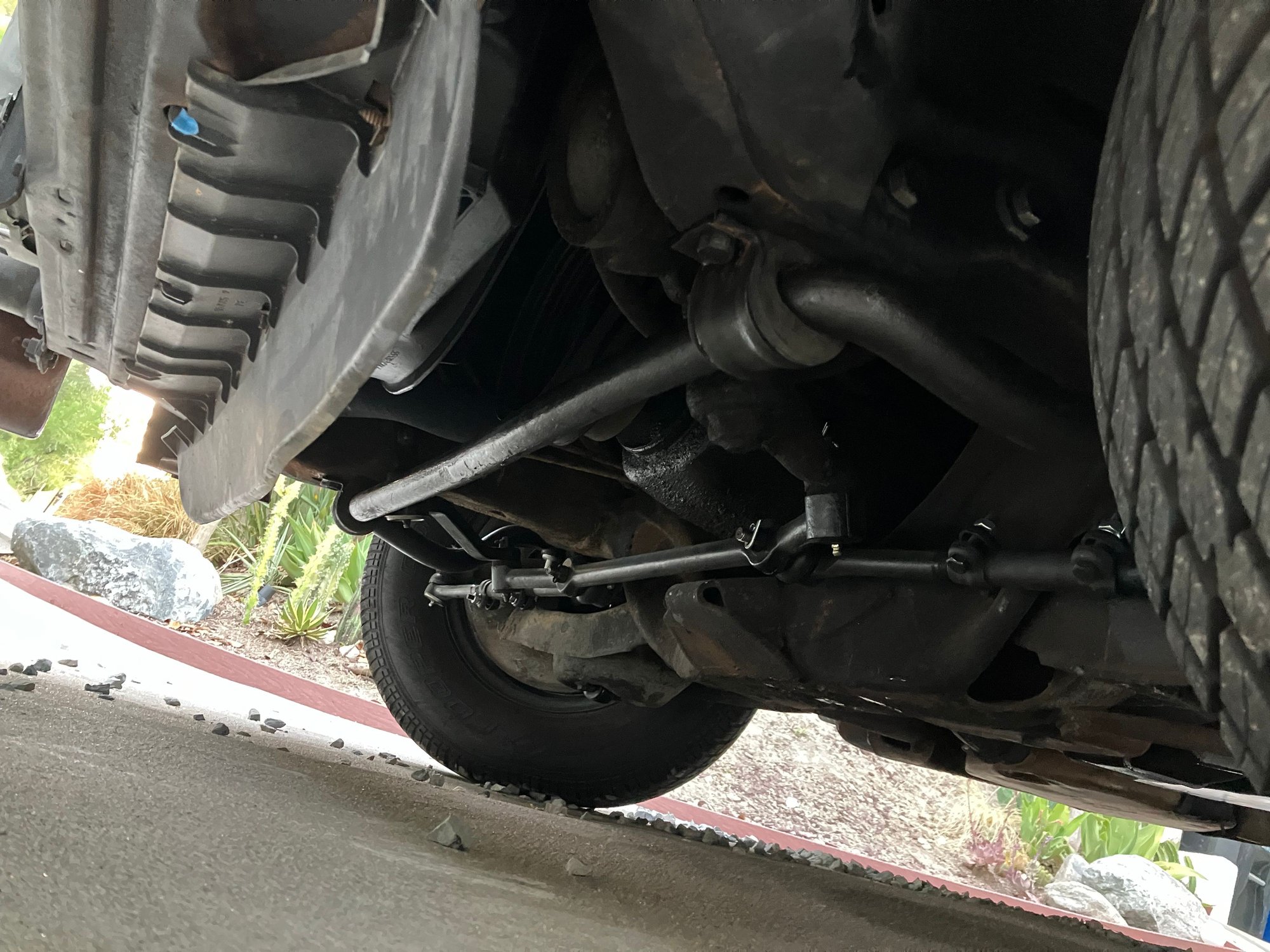

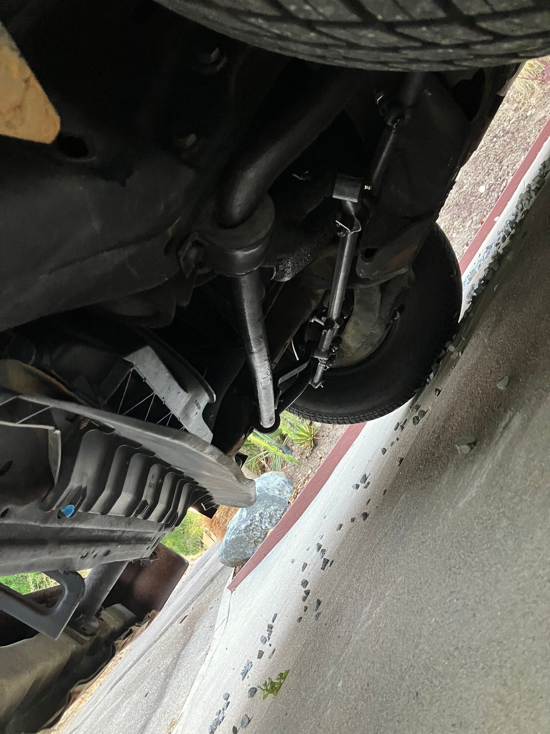

Not gonna be doing any autocross or track days… but I wanted the car to handle a little better.

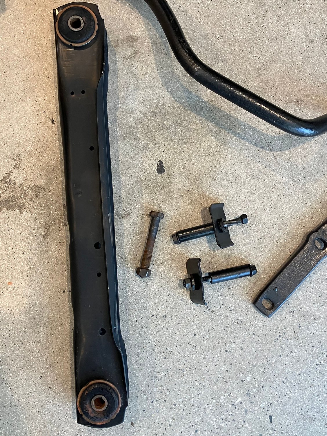

I did the basics (tie rods, center link, ball joints, shocks ) and based on a recommendation from a fellow 78 Delta 88 owner I tracked down the thicker front and rear sway bars and LCAs from a 94 Impala SS.
Only cost a couple hundred bucks and definitely improved the road feel.

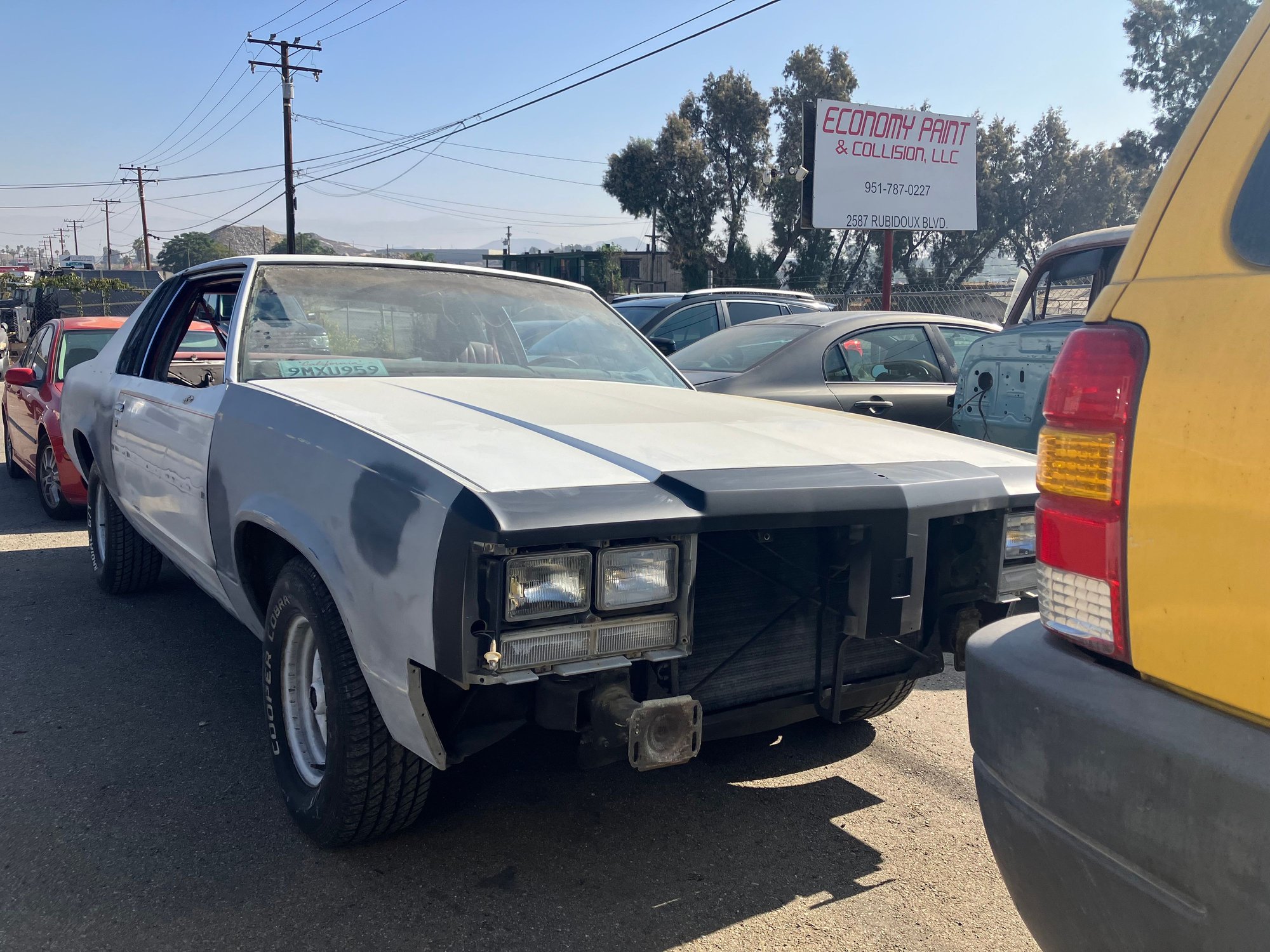

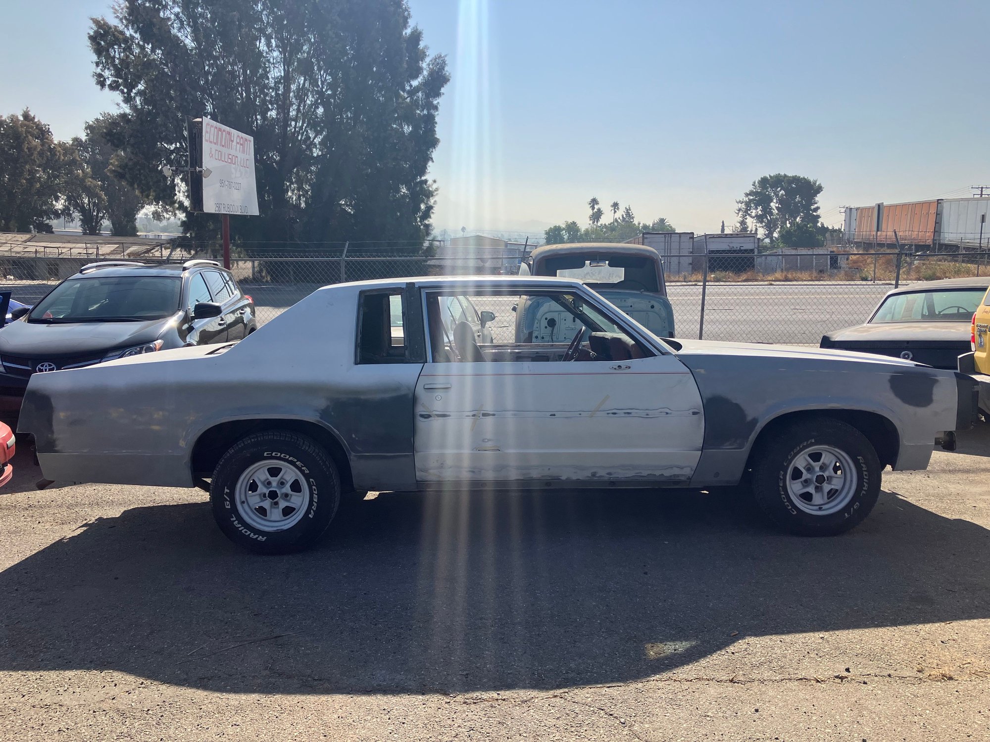

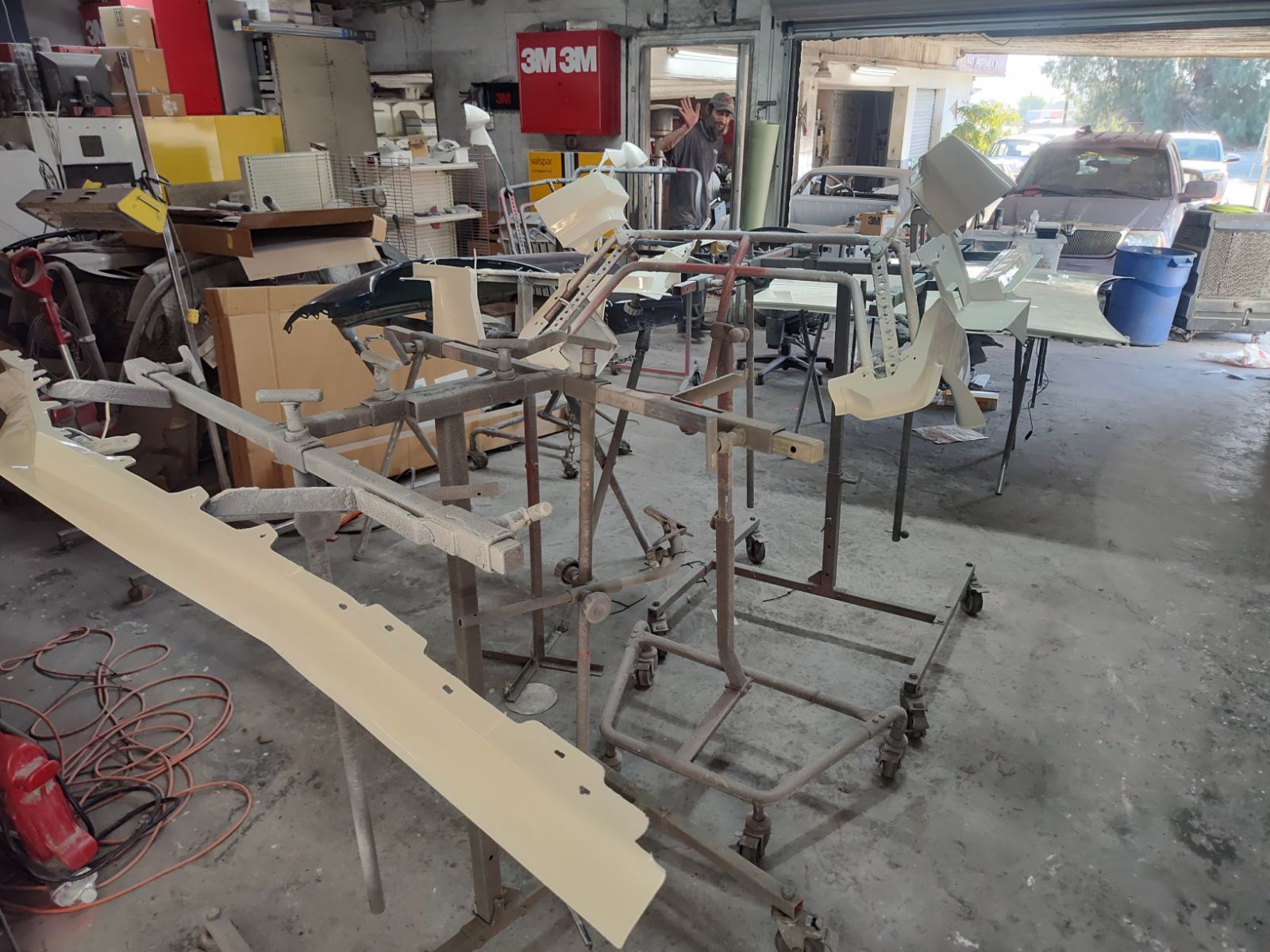

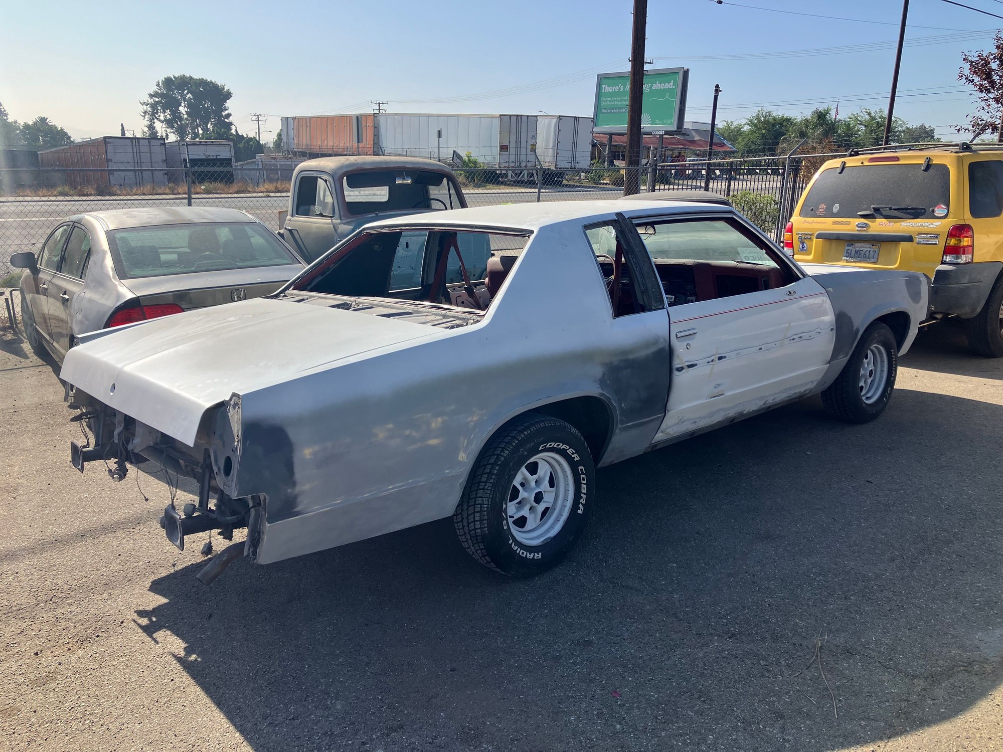

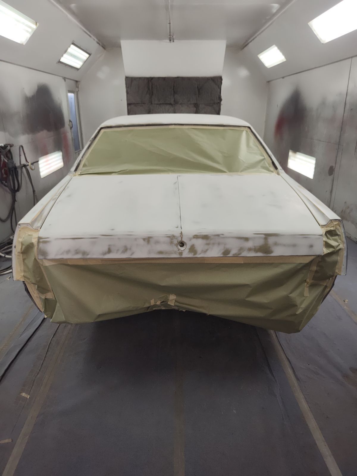

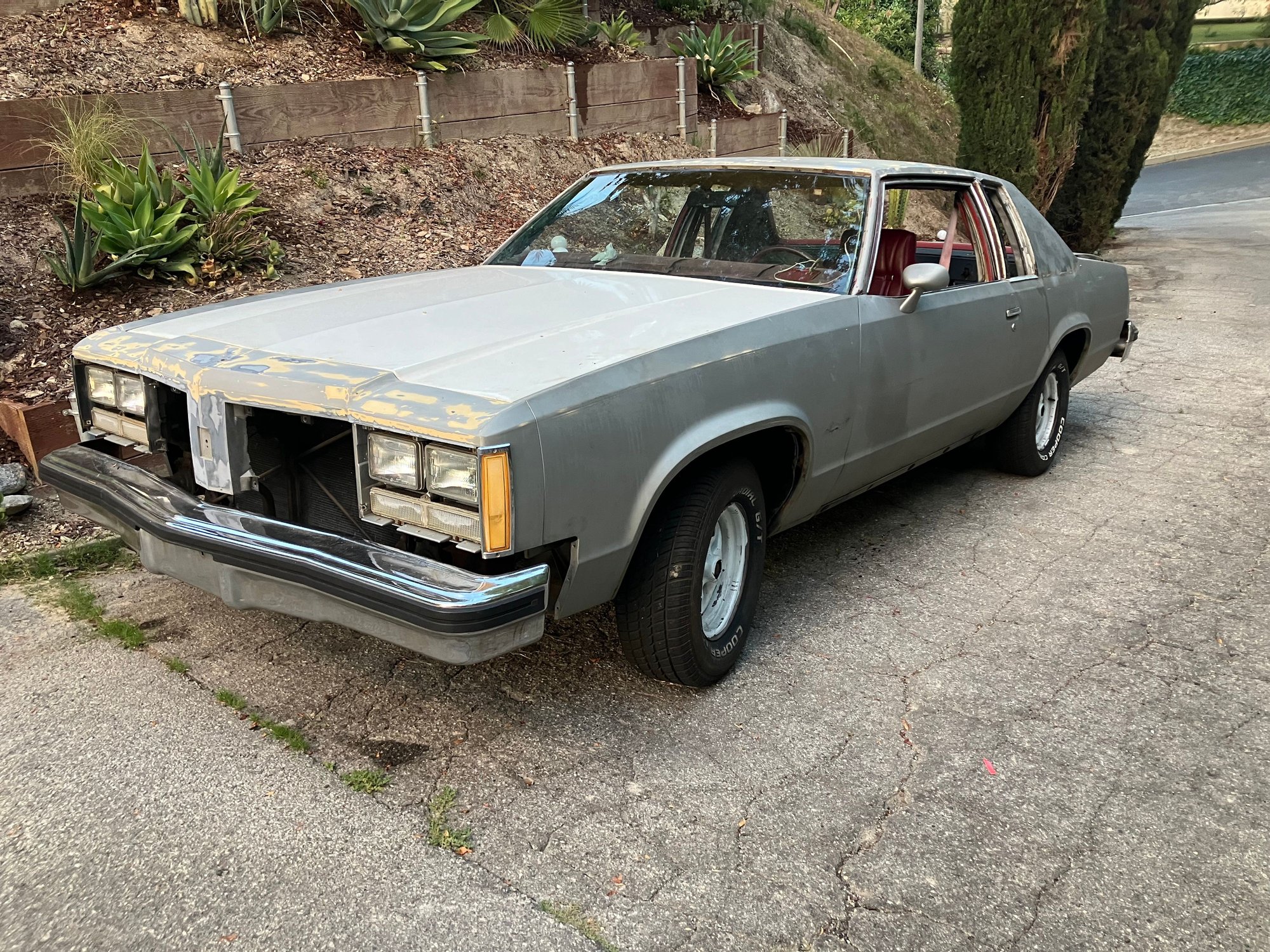

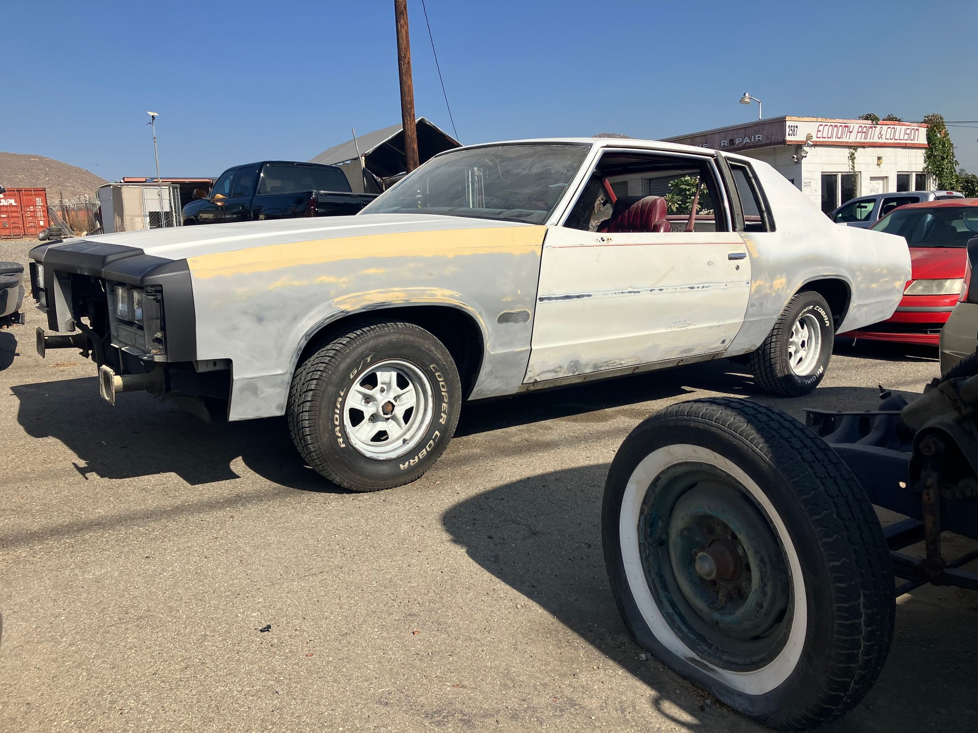

So with most of the mechanicals sorted I got a timely text from my buddy that has a family owned paint and body shop.
He said things were a little slow so I hustled the car and parts out to him last weekend.
It was 80 miles one way and I was a little apprehensive because all I’ve done so far are short trips around town … but the car drove really well…
Thankfully I didn’t get pulled over which I was also worried about since I’m rolling without bumpers, grilles, rear windows, etc etc…
I drove out there yesterday to drop off a spare pair of doors and to my surprise they already got a lot of work done on it….
I’m thinking the doors are probably gonna require the most work. The set on the donor car have excellent glass, channels, trim and inner / outer handles, but have some Bondo and a little rust on the bottoms. I hoped they would work but my gut says no, better to use the rust free doors on the car and swap over the rubber channels, trim and inner / outer handles.
Either way it’s some extra labor. I did manage to track down some really nice NOS door rubber so hopefully that means less fussing to get the doors to shut right and tight.
Keeping my fingers crossed that there’s no ‘surprises’ and no paint jail for this car

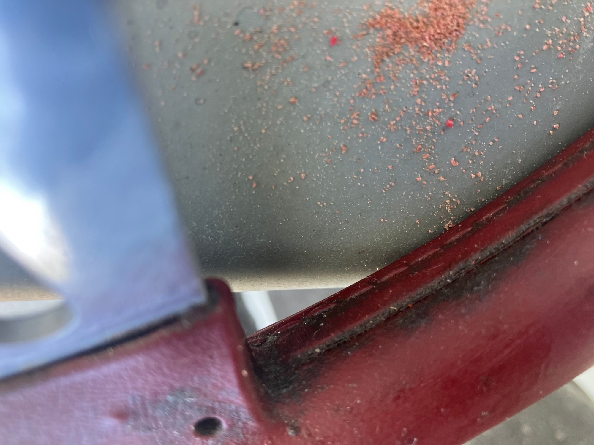

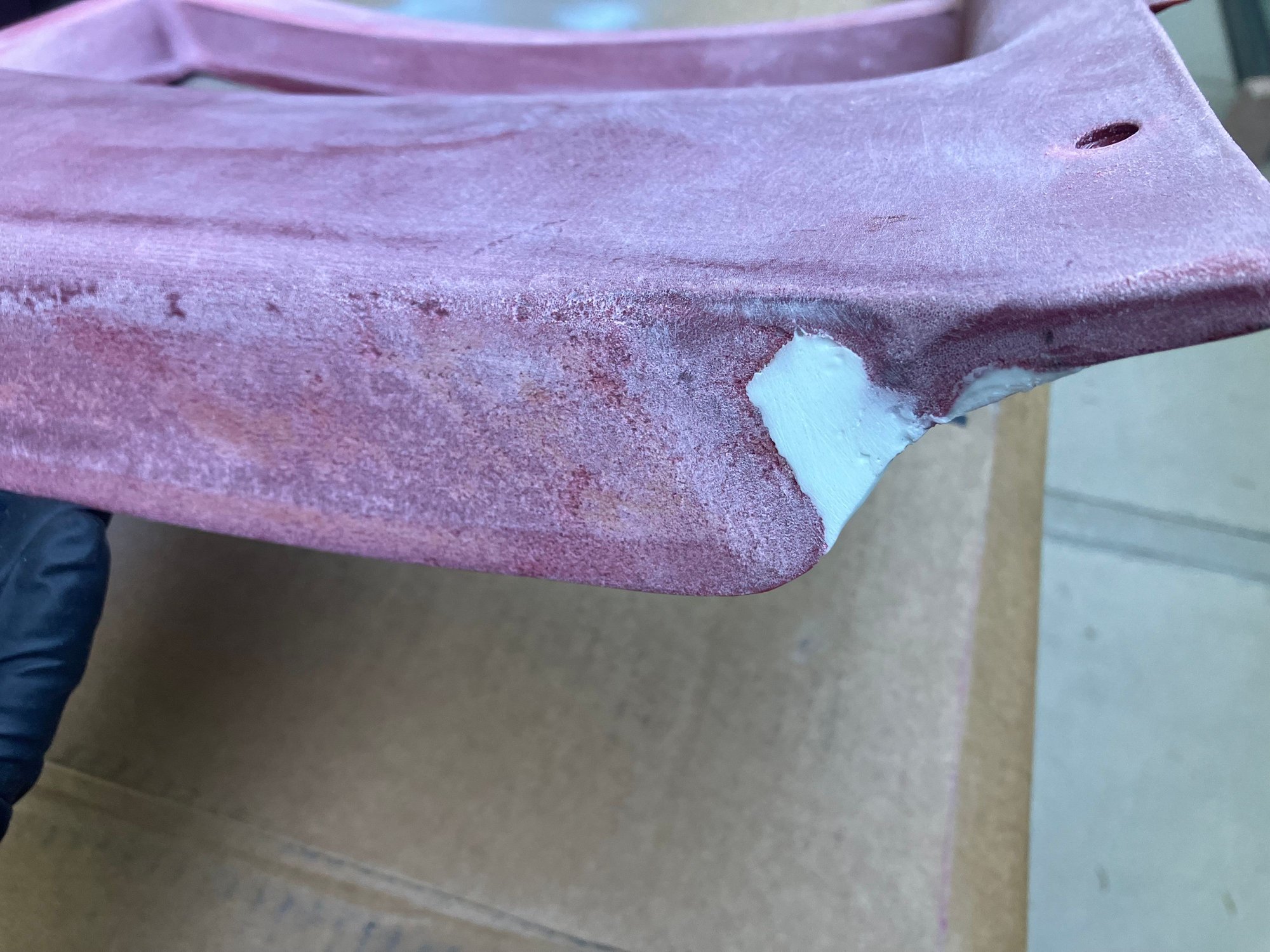

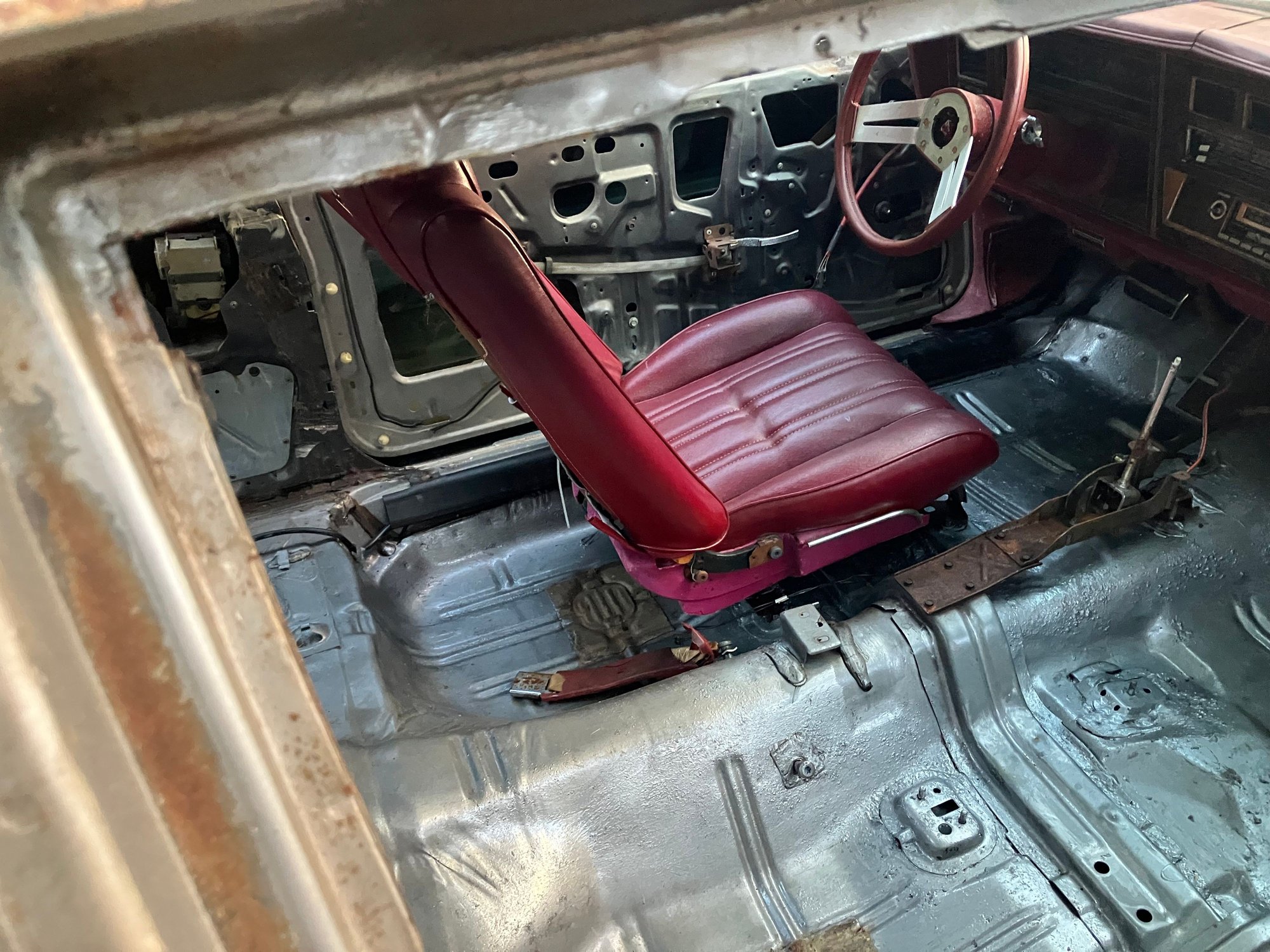

With the car in for paint I’m now working on the interior.

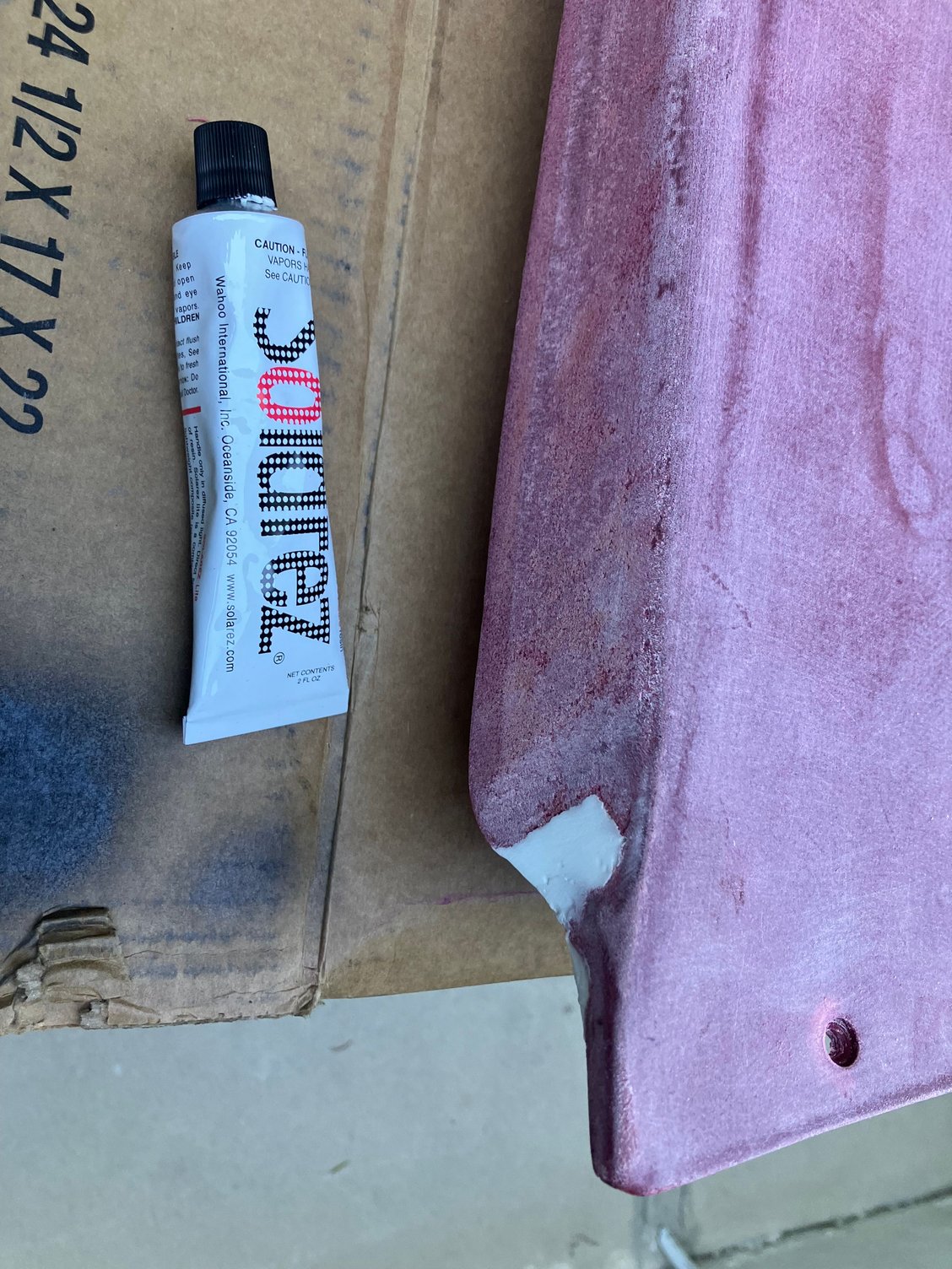

As many of you know, the plastics on these cars will fall apart on you if the car has spent a lot of time in the sun.
Thankfully the interior on my rusty Minnesota donor car did NOT see a lot of sun and is in great shape… but there are some parts that won’t swap over.
For example, the pieces around the opera windows. From what I can surmise, Olds made two different size opera windows on the 78 and 79 Delta 88 coupes… it seems (tho I can’t verify this) that the cars with landau tops got narrower opera windows and the cars with full vinyl or no vinyl top got wider windows.
Whatever the case, my skinny window plastics were shot. So here’s my solution … Solarez. I figure if it works for my surfboard it should work on the trim. We shall see ..

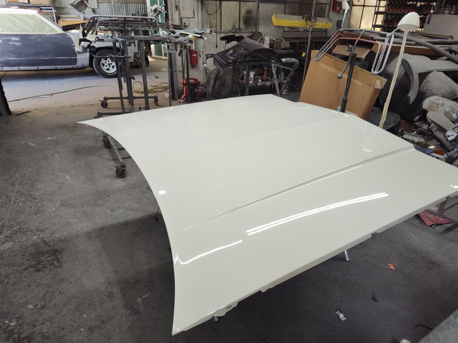

Donor car went bye bye today … offered it up here and on Facebook for free (with a clean title and a good running 350 in it) but there were no takers so I sold it to a scrapper …
Old Oct 12, 2024 | 03:20 PM
  #62
mapearso's Avatar
Joined: Jun 2006
Posts: 115
Paint and body continued …
GM White #40-8554-1. It’s got some beige in it. I HATE bright white that looks cold.
I wanted something white that will cover well because it’s a big slab-sided car.
I also wanted something warm to go with the Carmine Red interior.
Seems to go well with the vinyl top swatch that I have … we shall see …

I didn't see that you got the blower motor working. Since there is power to it the problem can only be the motor (unlikely as it is new) or the ground wire. When you get it back from paint try running a jumper from a good ground such as the engine block directly to the ground tab on the motor, clean the paint away where the tab mounts. If the jumper makes it run but it still won't run when the factory ground wire alone is connected to the tab the problem is at the other end of the ground wire meaning opposite the tab or at the tab connection itself.
