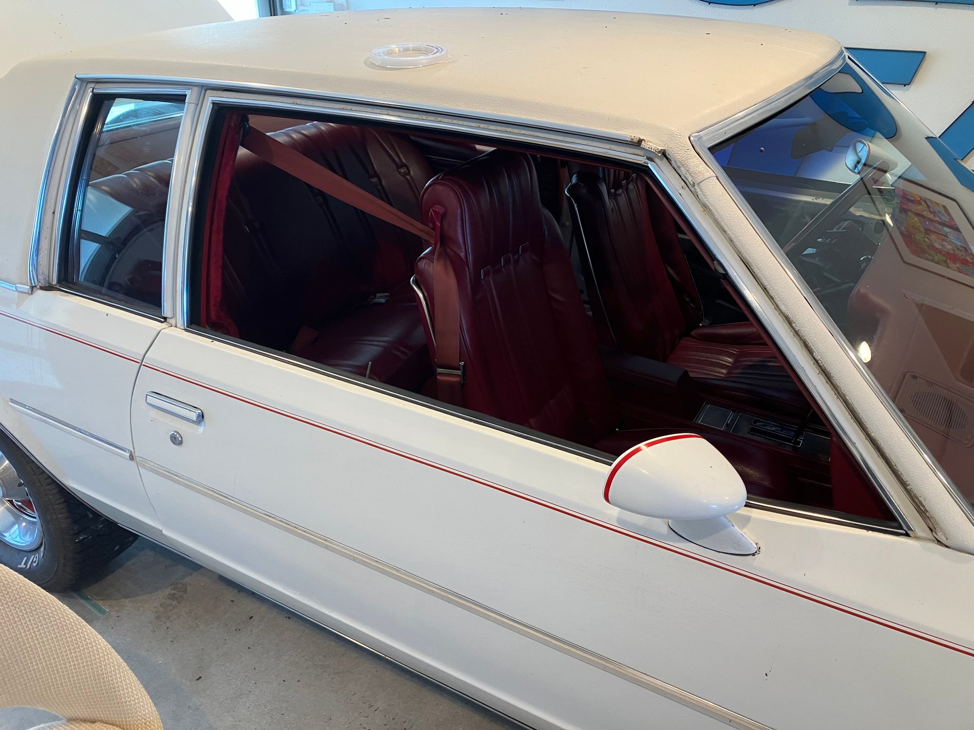

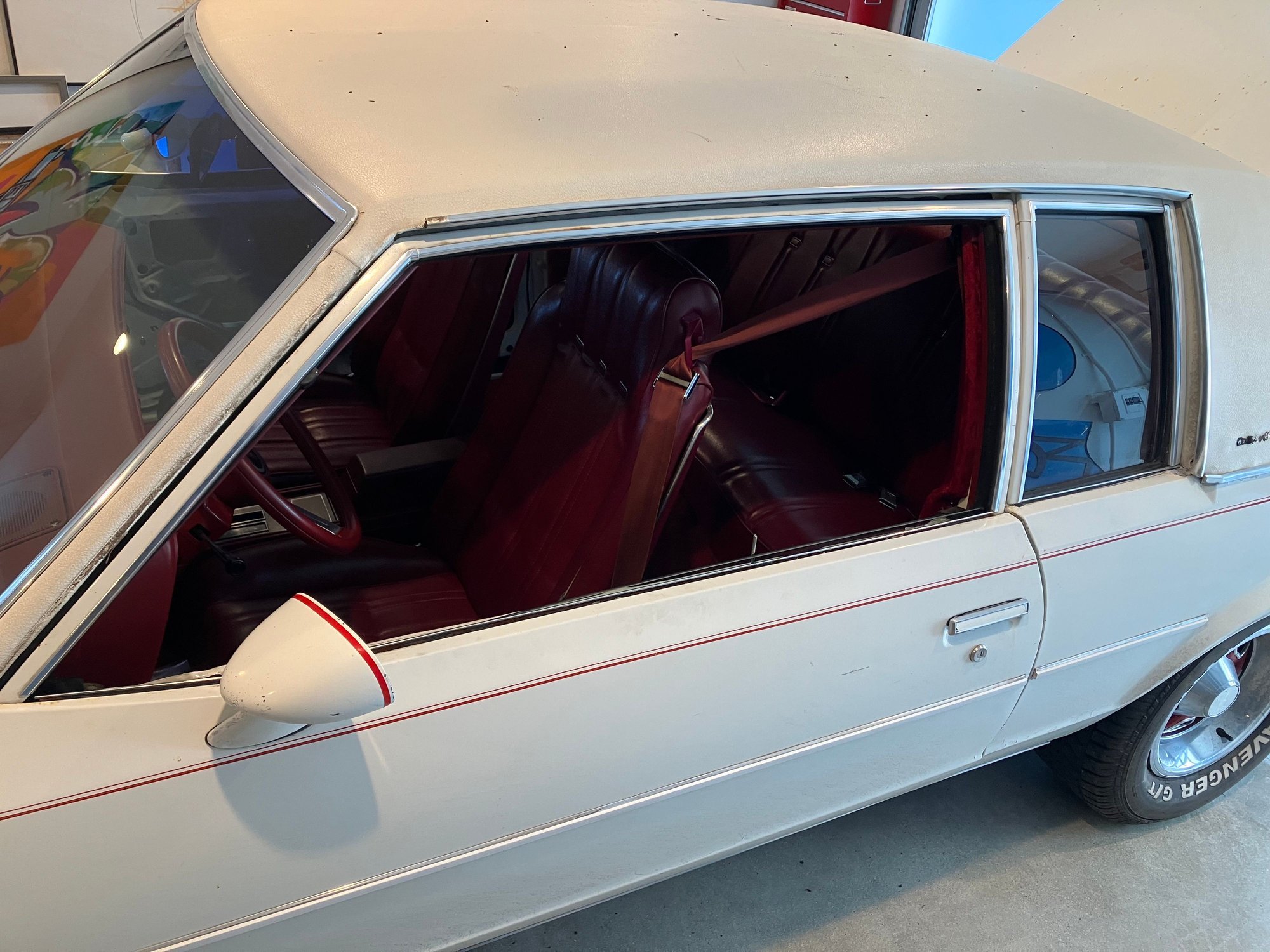

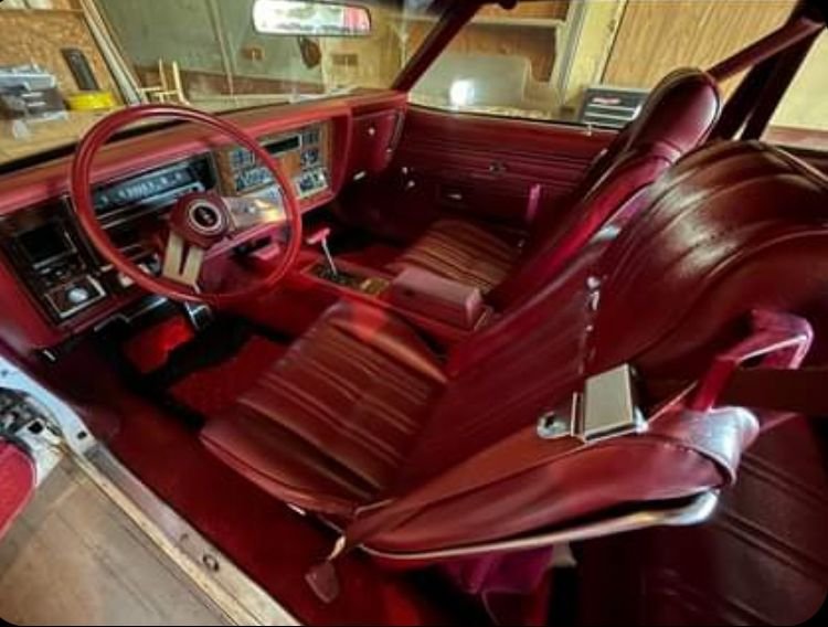

The good…

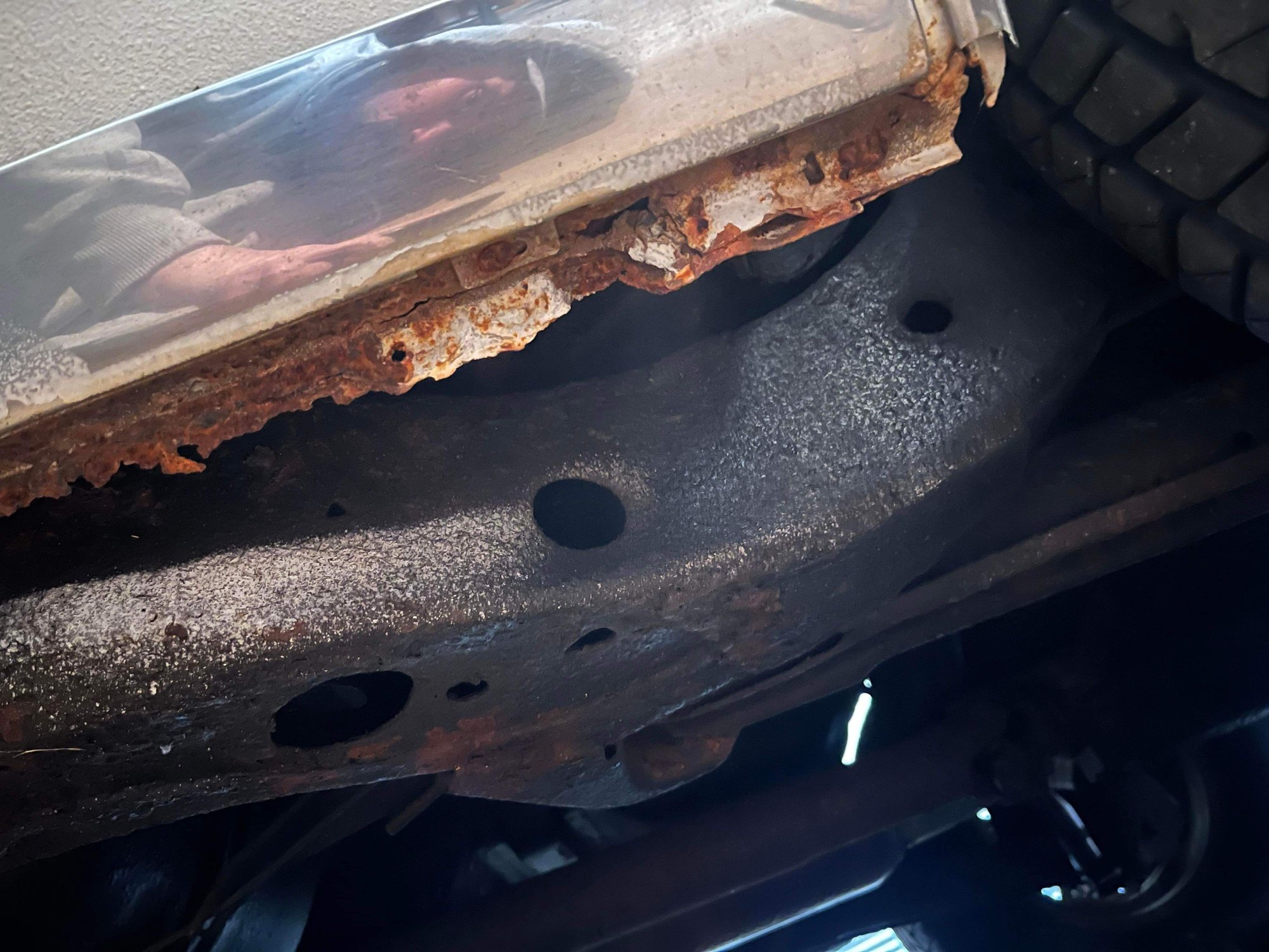

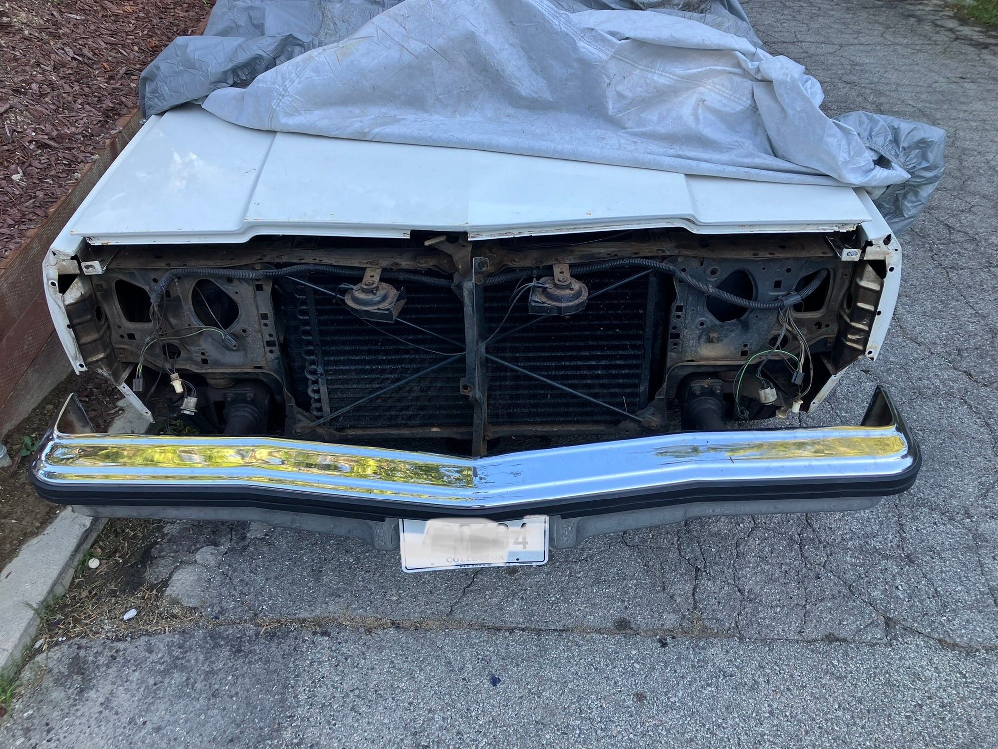

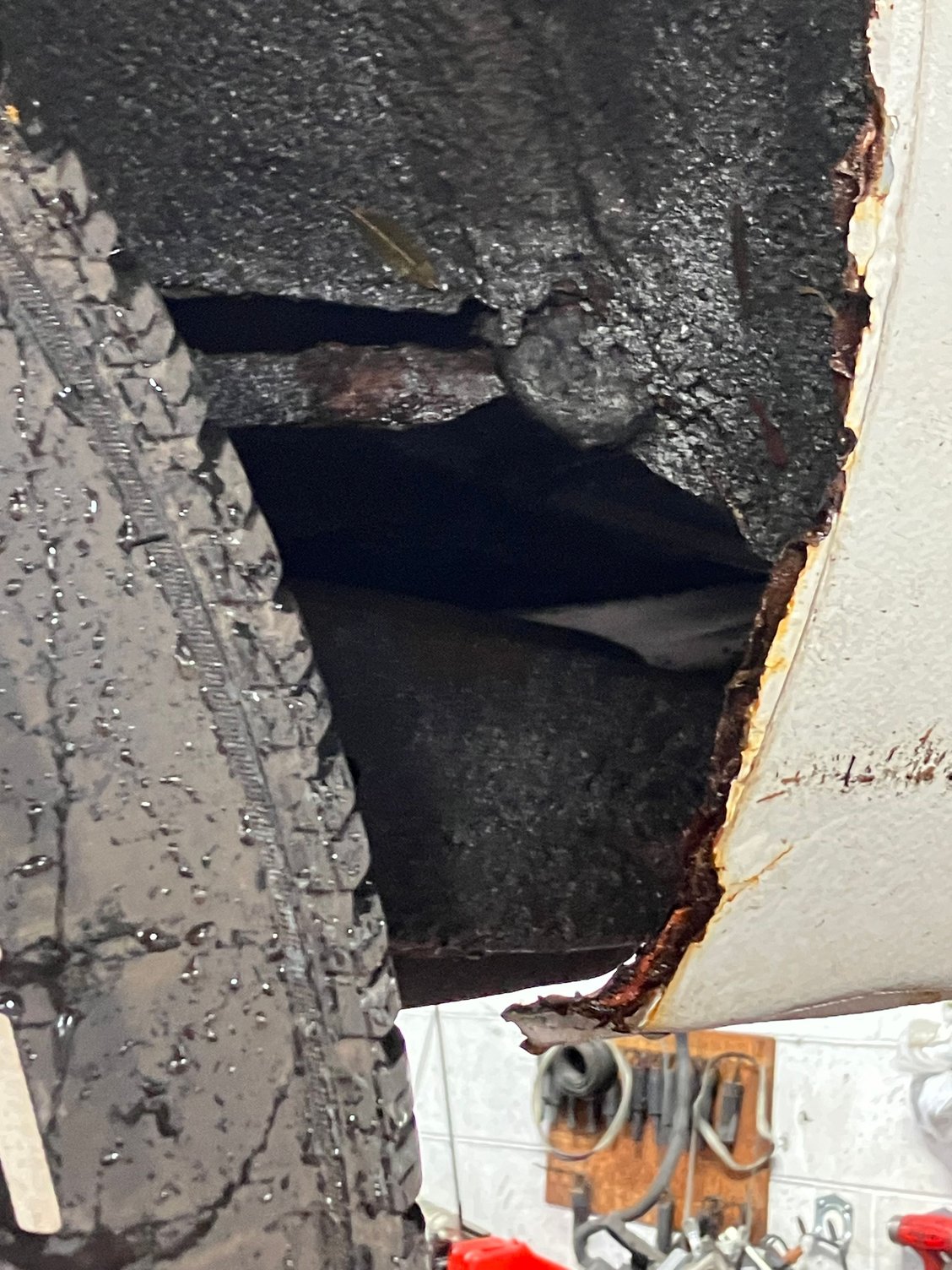

The bad and the ugly …

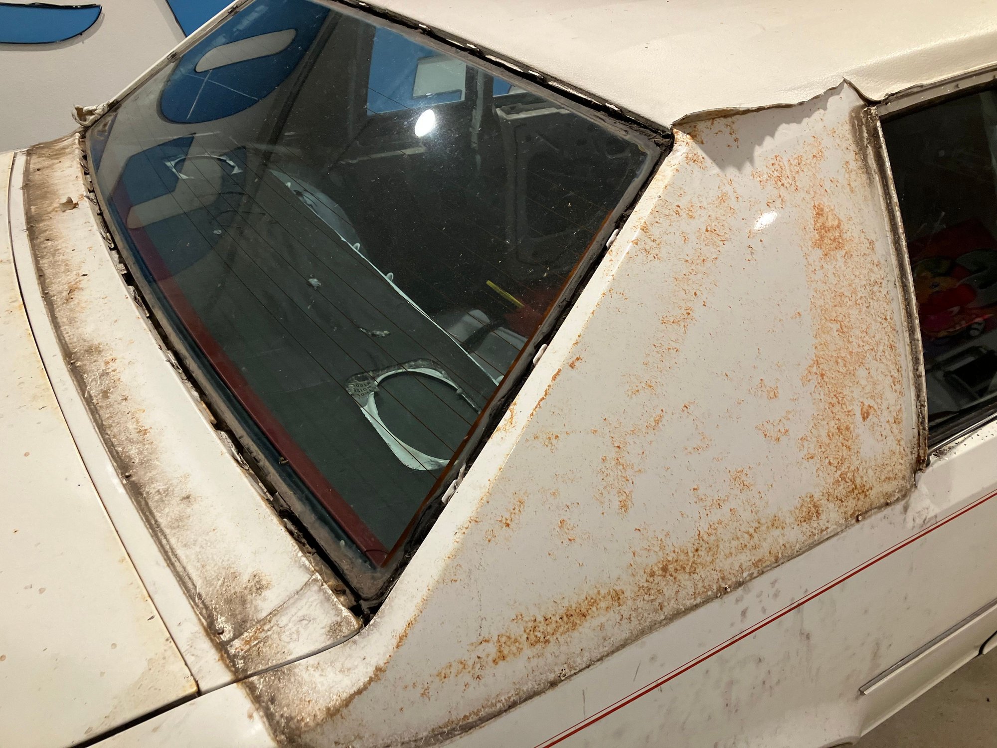

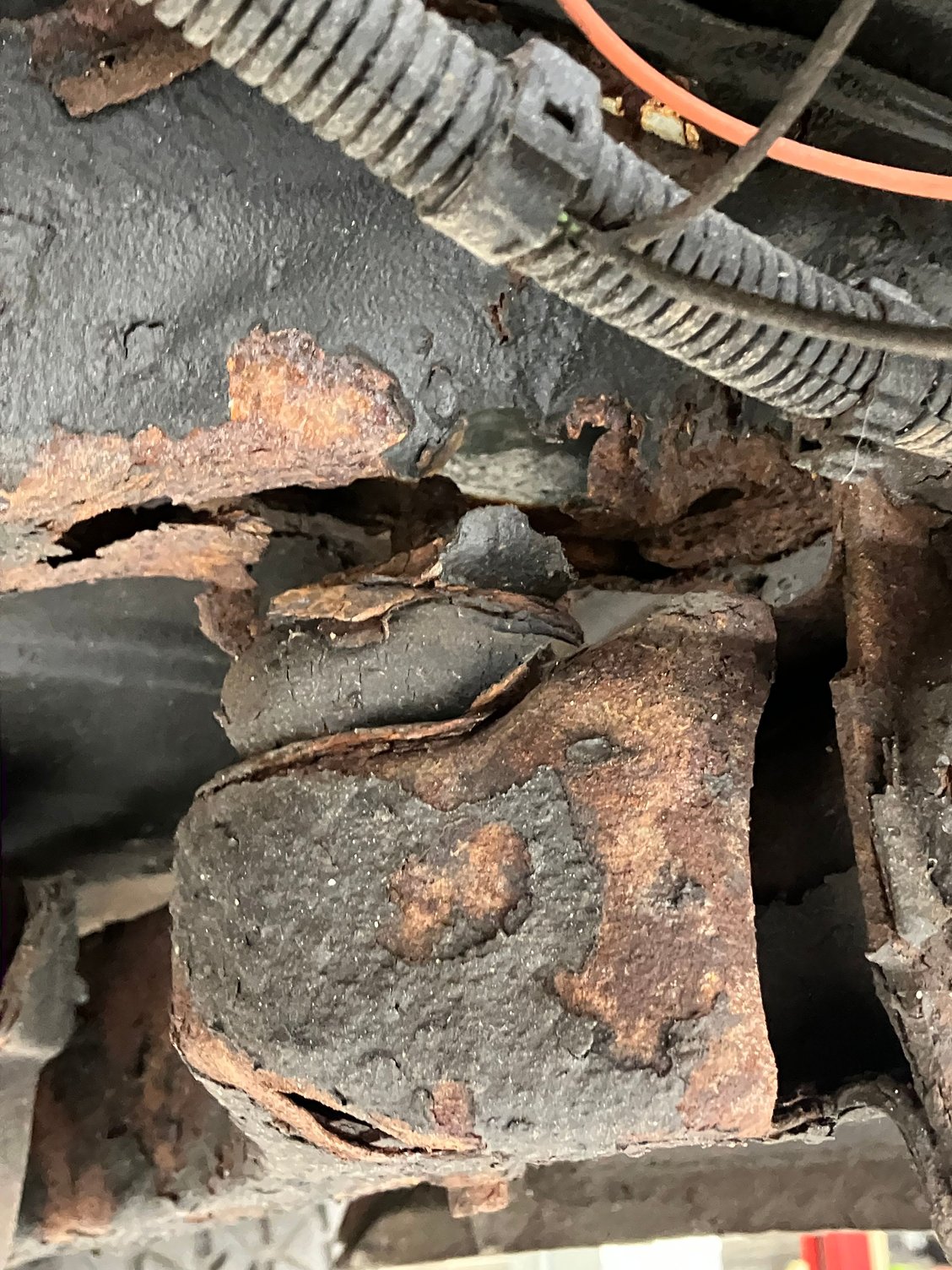

More bad …

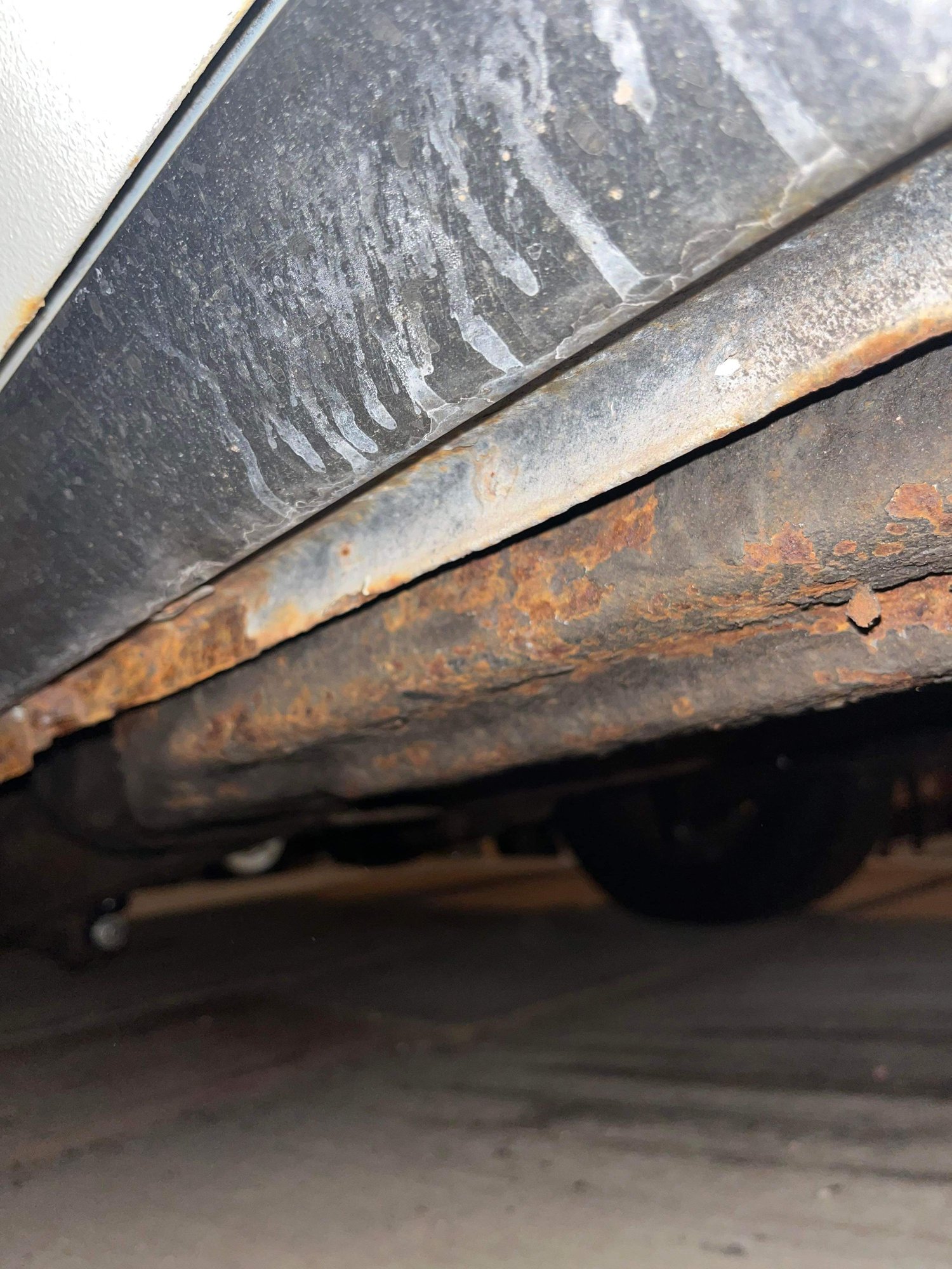

More bad … and not so bad

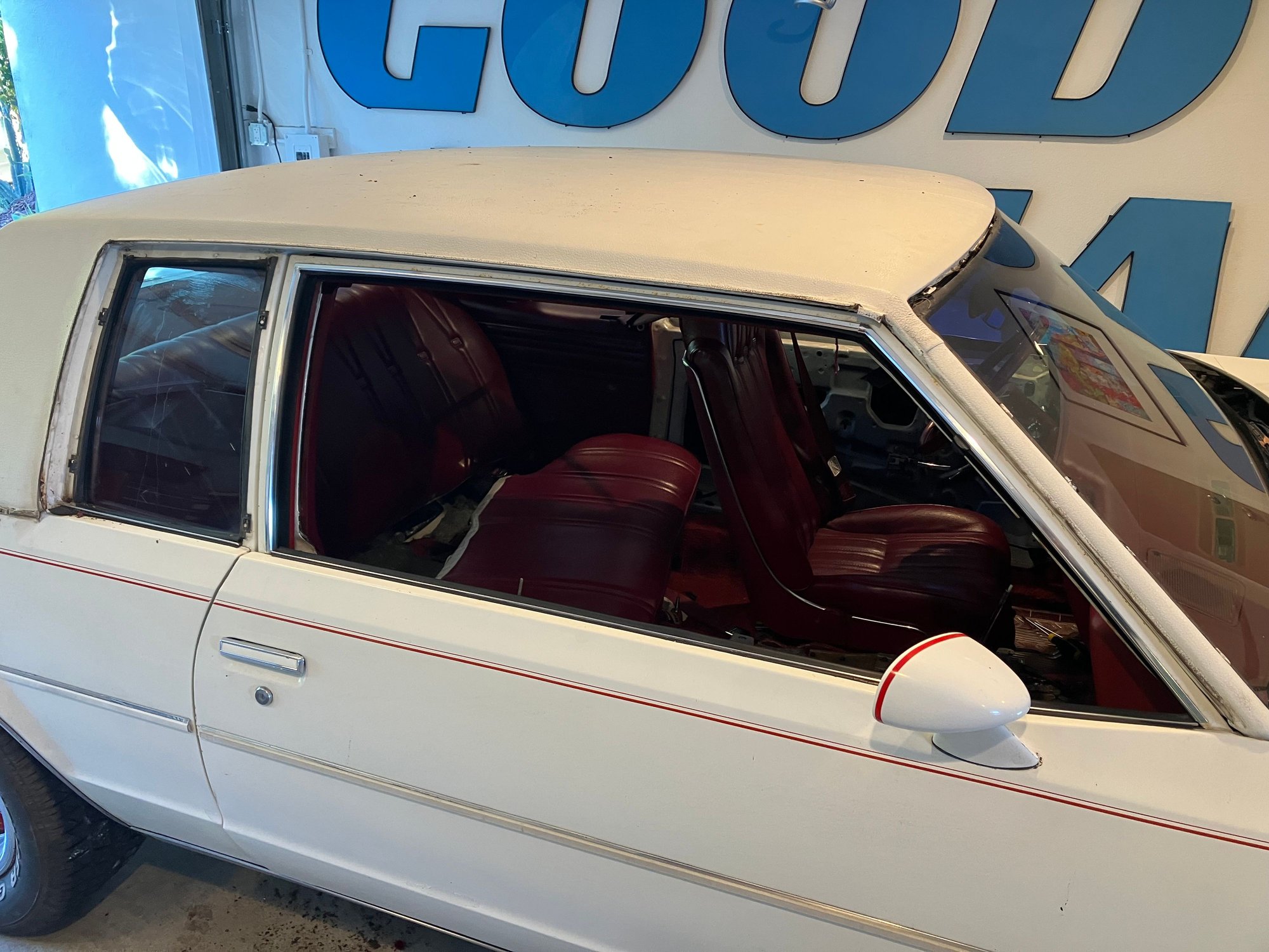

So not sure which car to call the donor car. I mean, they will both be donating to this cause, right?
But I suppose the Midwest car that is currently in my garage is actually the donor car and the southern car on its way to me will be the recipient…
With that said, here’s the Donor car trim … Any bets on what’s I’m gonna find under the vinyl top?

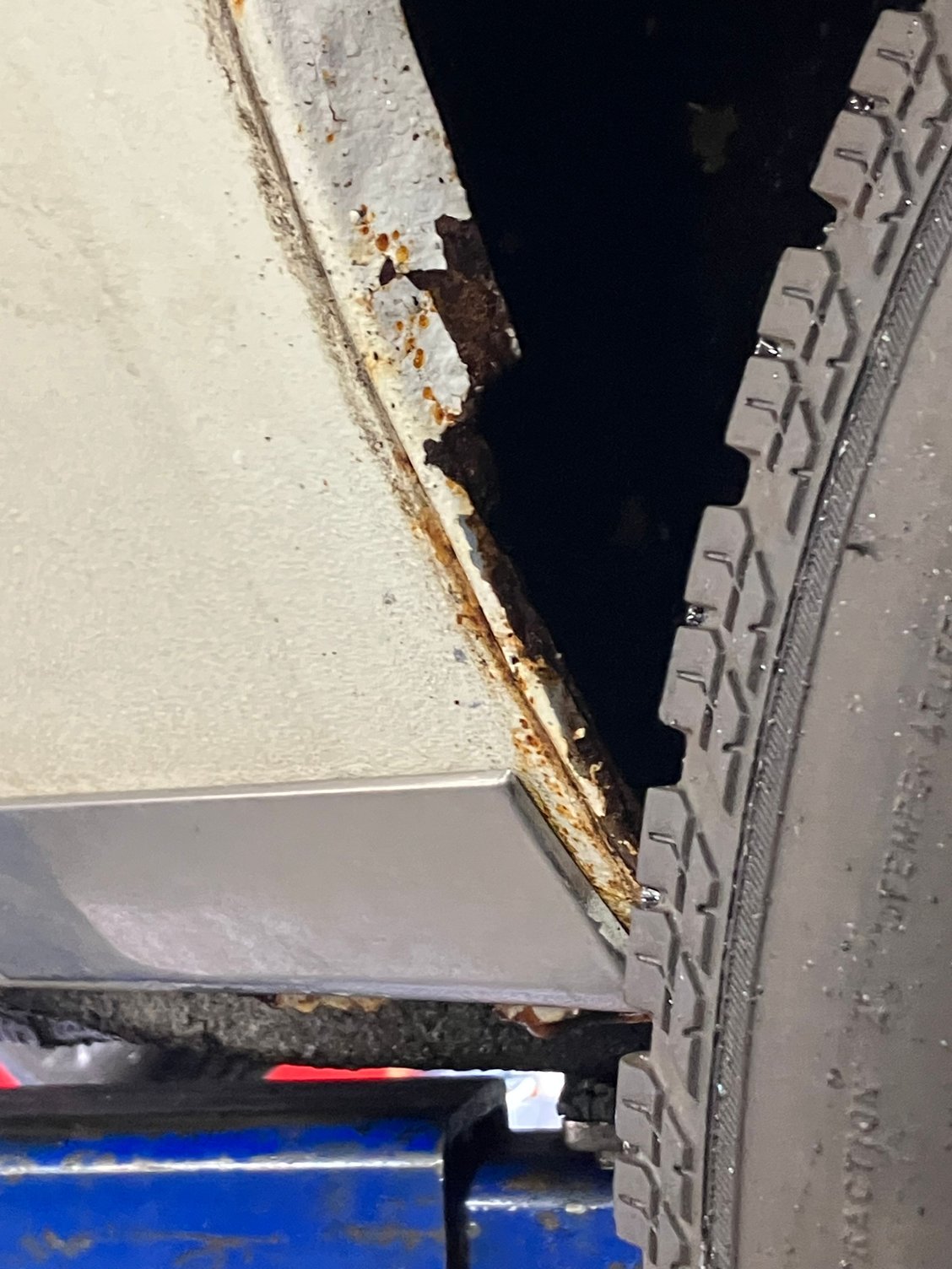

And with all that nice trim off …

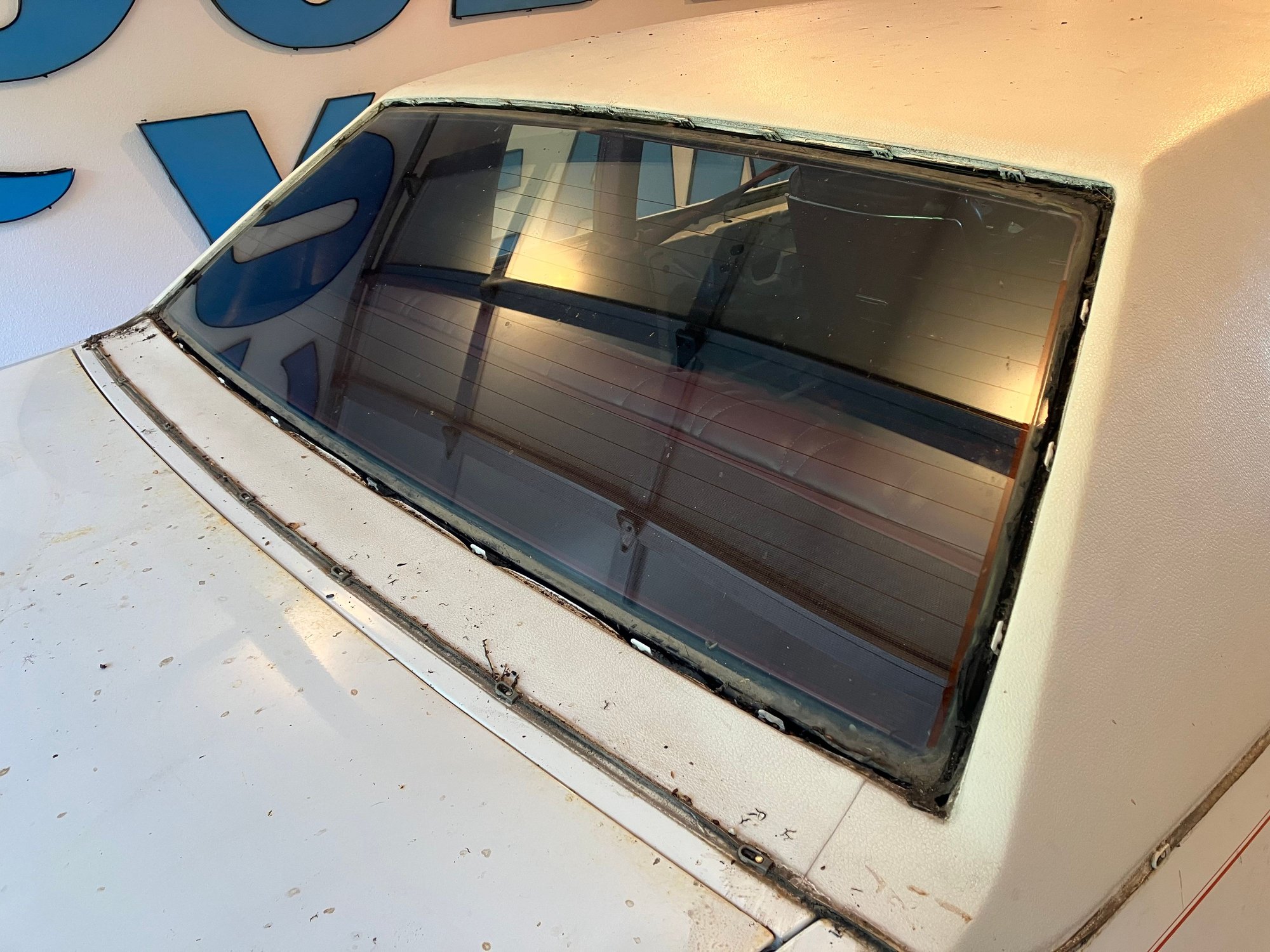

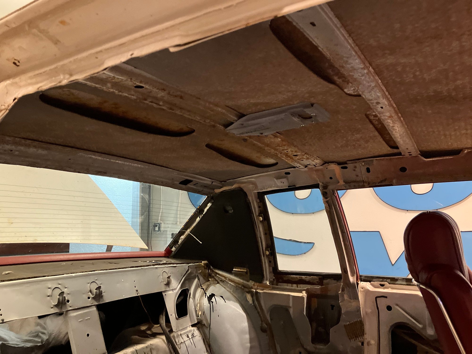

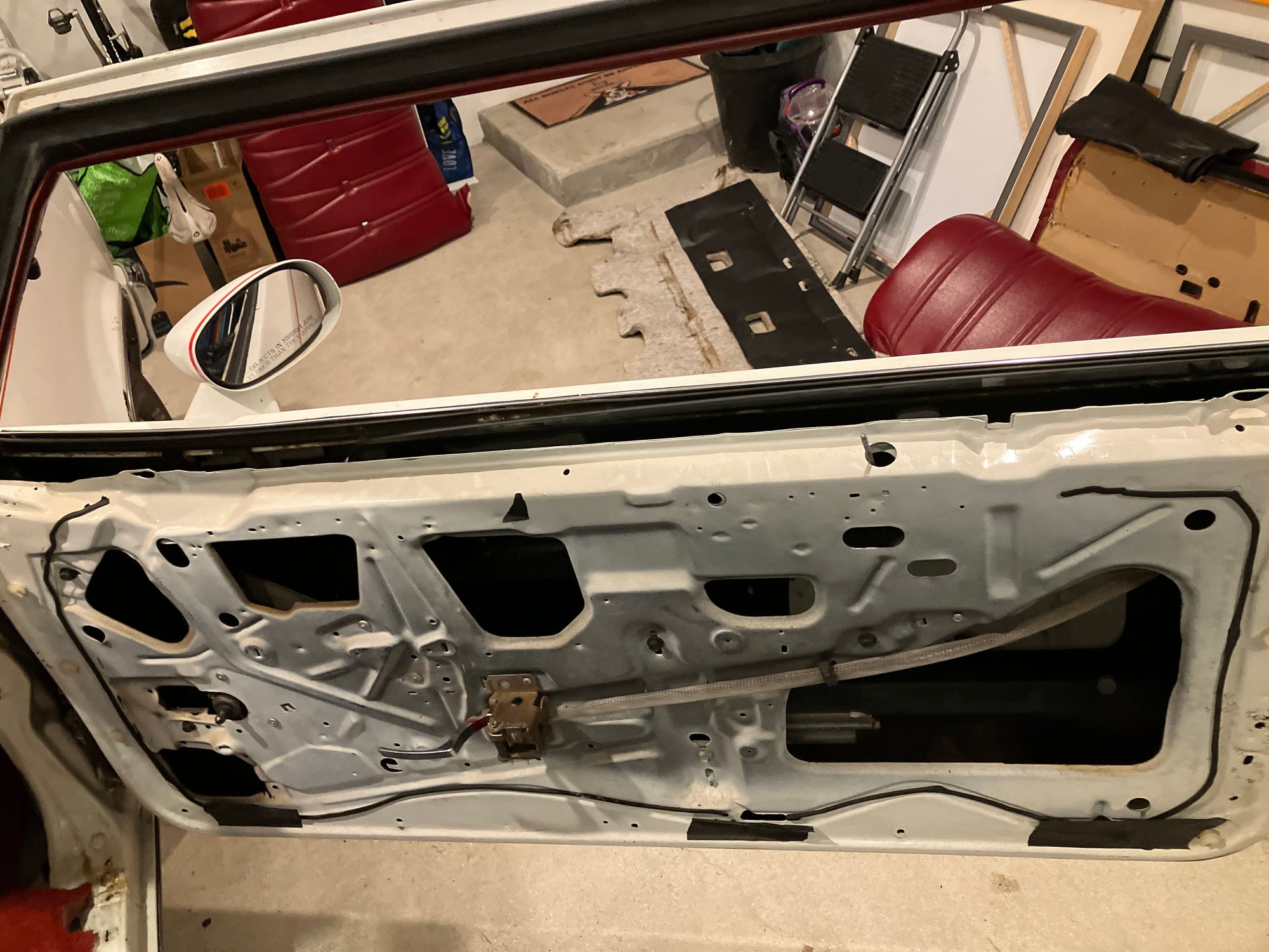

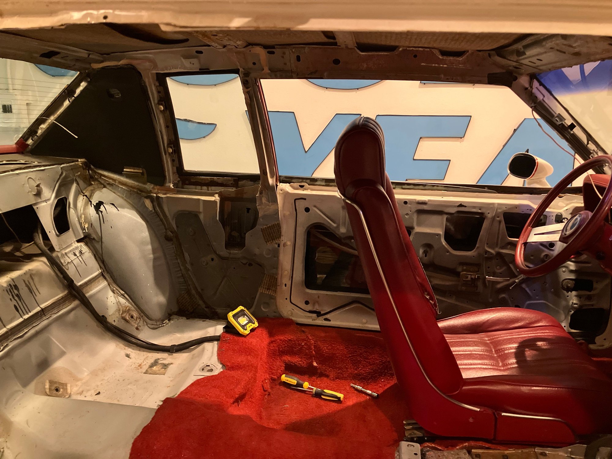

Making some more progress. Got the whole interior out except for the cockpit and the carpet … As always a few pieces that were a giant PITA.
Old Feb 16, 2024 | 07:37 PM
mapearso's Avatar
Joined: Jun 2006
Posts: 115

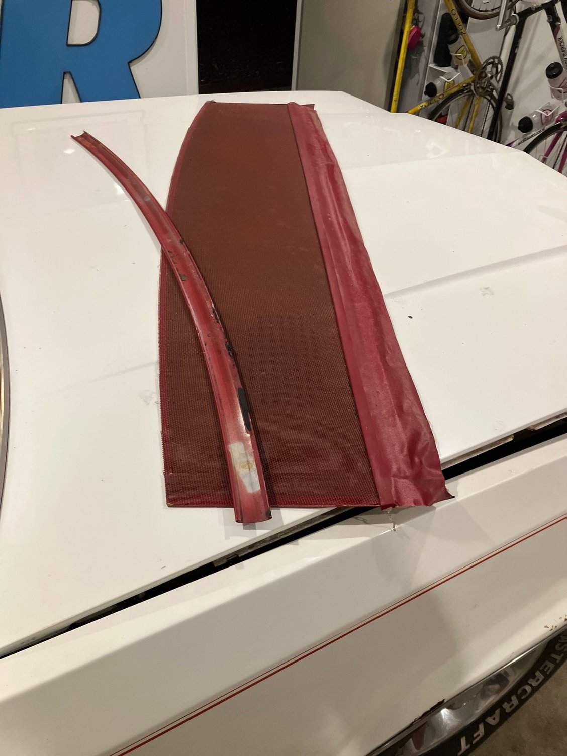

Also started peeling the vinyl top off … surprisingly good so far … except for the opera windows …

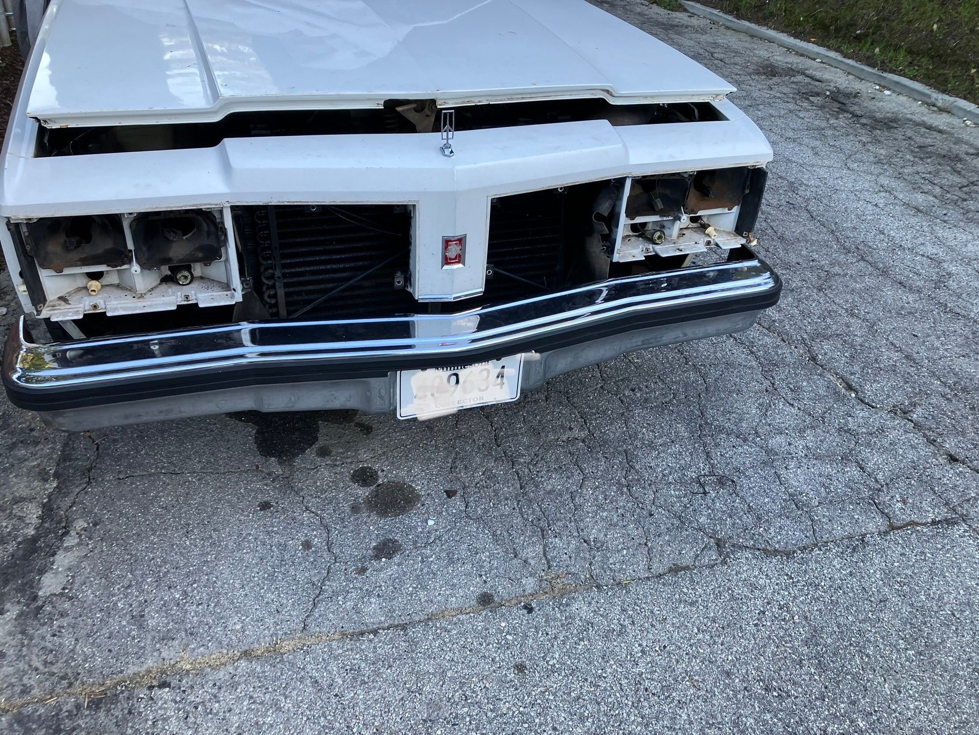

Moving right along - getting close(r). Front bumper is next. All the fillers are out and are in great shape. I’ll probably pull the whole header panel off.

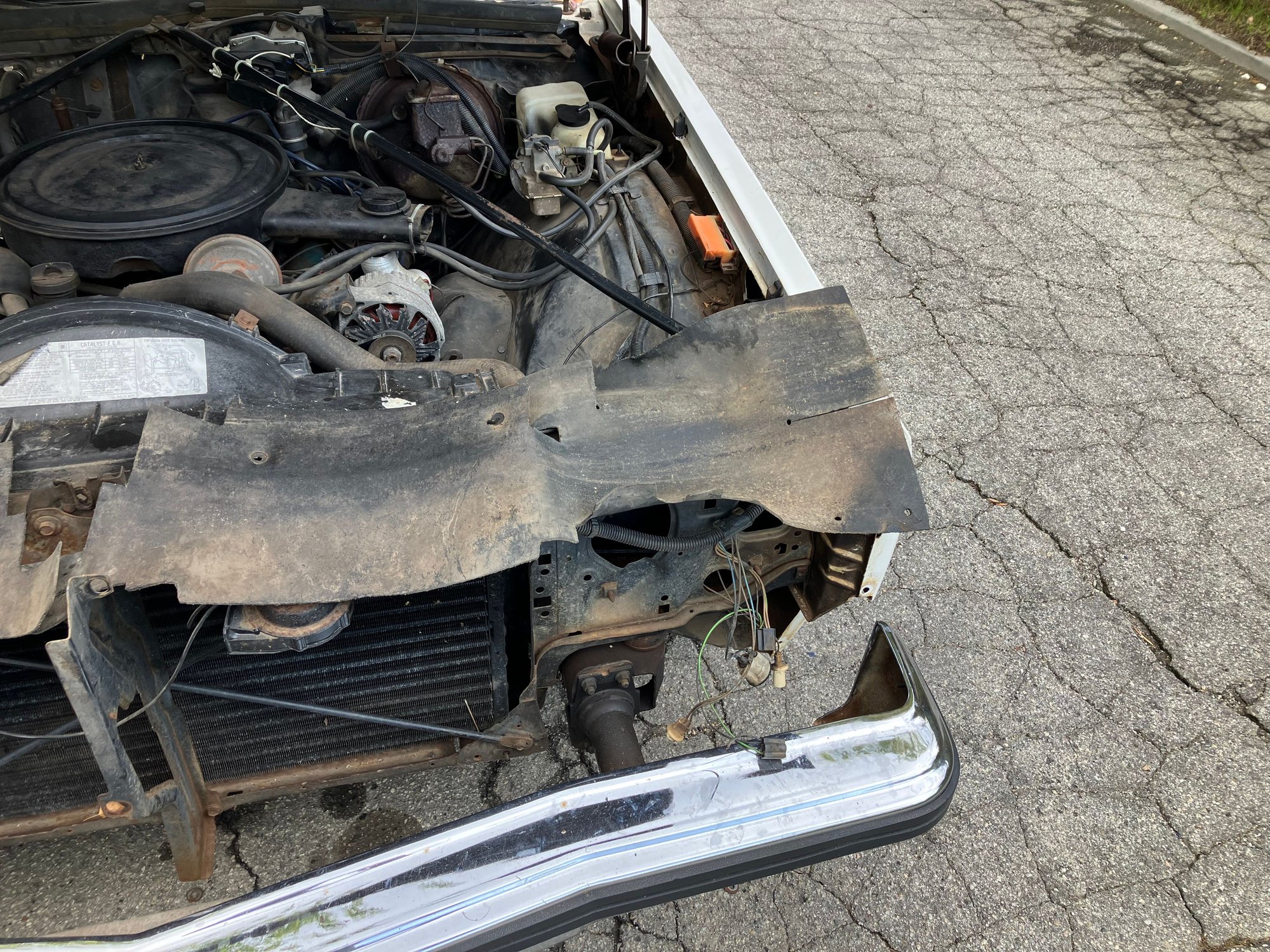

Header panel off. Wow getting to that upper nut above the side markers was not easy …
I’m thinking about cutting the length of the bumper brackets in the front and rear by about 1.5” so they don’t stick out like Jay Leno’s chin…

You could sink the bumper shocks. Drill a small hole in the bottom of the shock to release the pressure, sink them to your desired depth, and add a couple small welds to the tubes. Half-assed? Maybe. It worked well in the old demo derby days.

Showed up yesterday morning — in the pouring rain of course.
I was pleased that it’s as straight in person as it looked in the photos. That doesn’t always happen. (I also like how the soft-Ray glass matches the Impala SS convertible that it showed up with… not mine … I sure hope that guy knows what he bought)
I put some SSIII Rallys on it because as you can see the old tires were toast. Looks better already and of course it moves a helluva lot easier.
I’ll dig into it later today, time and weather permitting. I’m sure RockAuto and Amazon are about to get some of my money …
