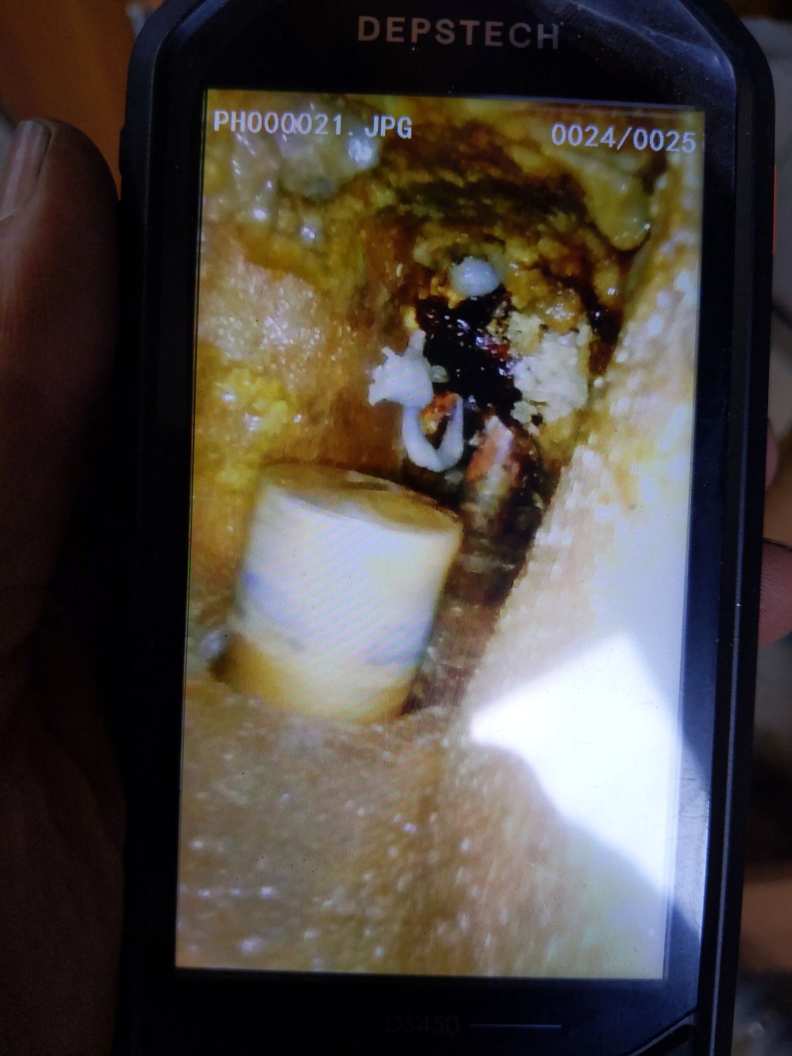

It was having issues staying cool, and it was smoking out my garage pretty good. It seemed like unburnt fuel more than anything else, white smoke that burned the eyes and smelled like fuel.
I started messing with the cooling system a bit, and didn't like what I was finding. I took the radiator cap off hoping it was just air. Every time I would rev it up, then let off, it would puke coolant across the garage.
I did a compression test and a leak down test, and all looked good. So I figured I could just flush the system out.
Here is an image of what the intake manifold looked like (sorry, too lazy to get the actual image off the borescope
Example of the crap that was in my coolant system after letting it sit for 25 years.
). Lesson learned, do NOT let coolant sit for 25 years!!!!!

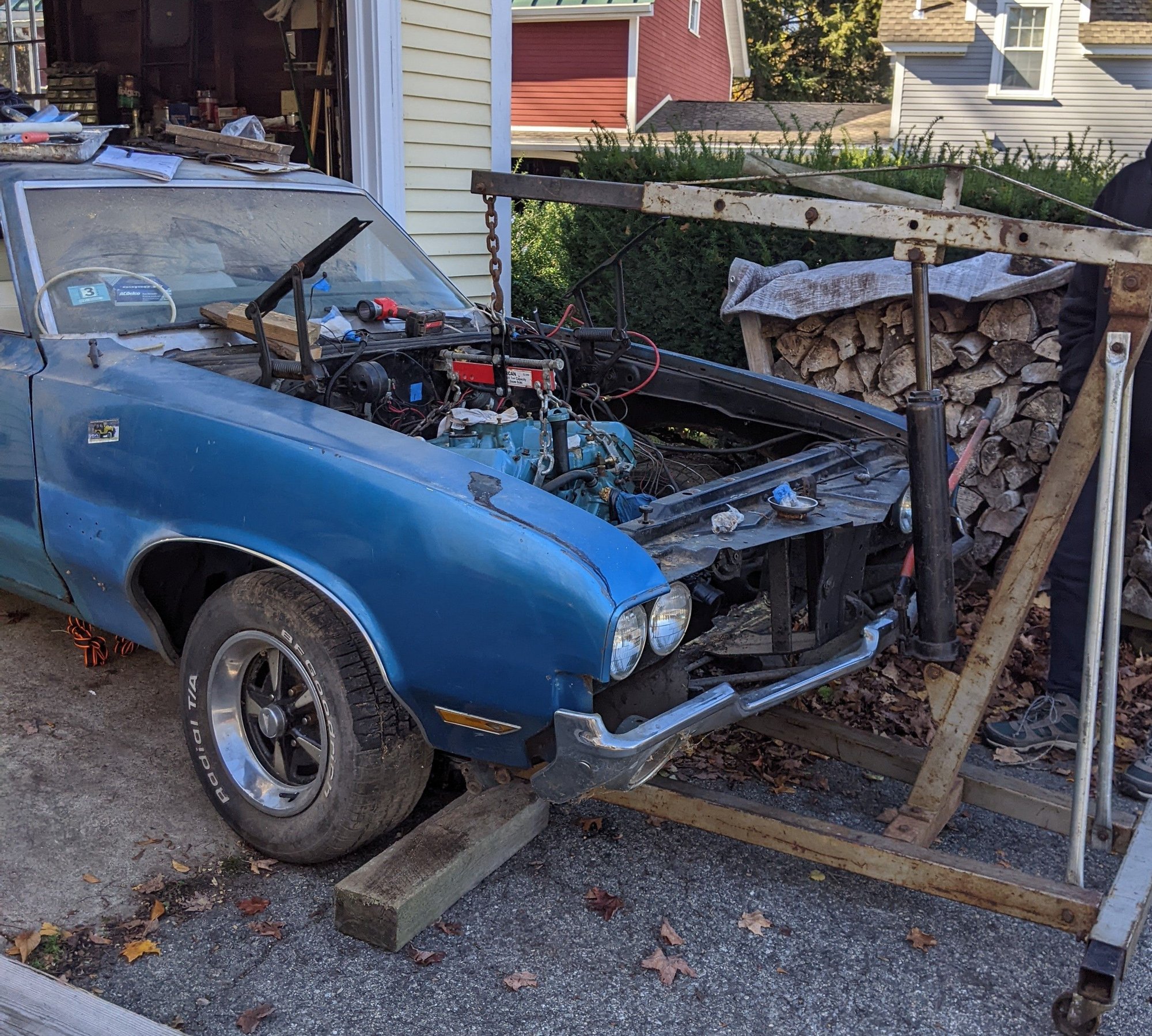

After finally realizing that I can't flush the engine, I decided it was time to pull it. Sadly, it only had about 3-4 hours on the motor. A good portion of that was me trying to flush the coolant system.

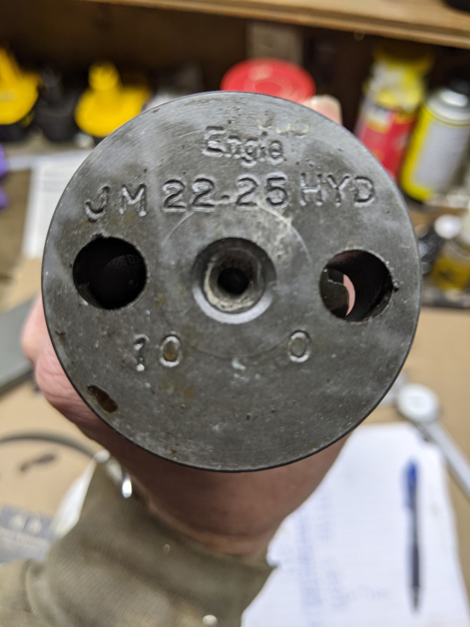

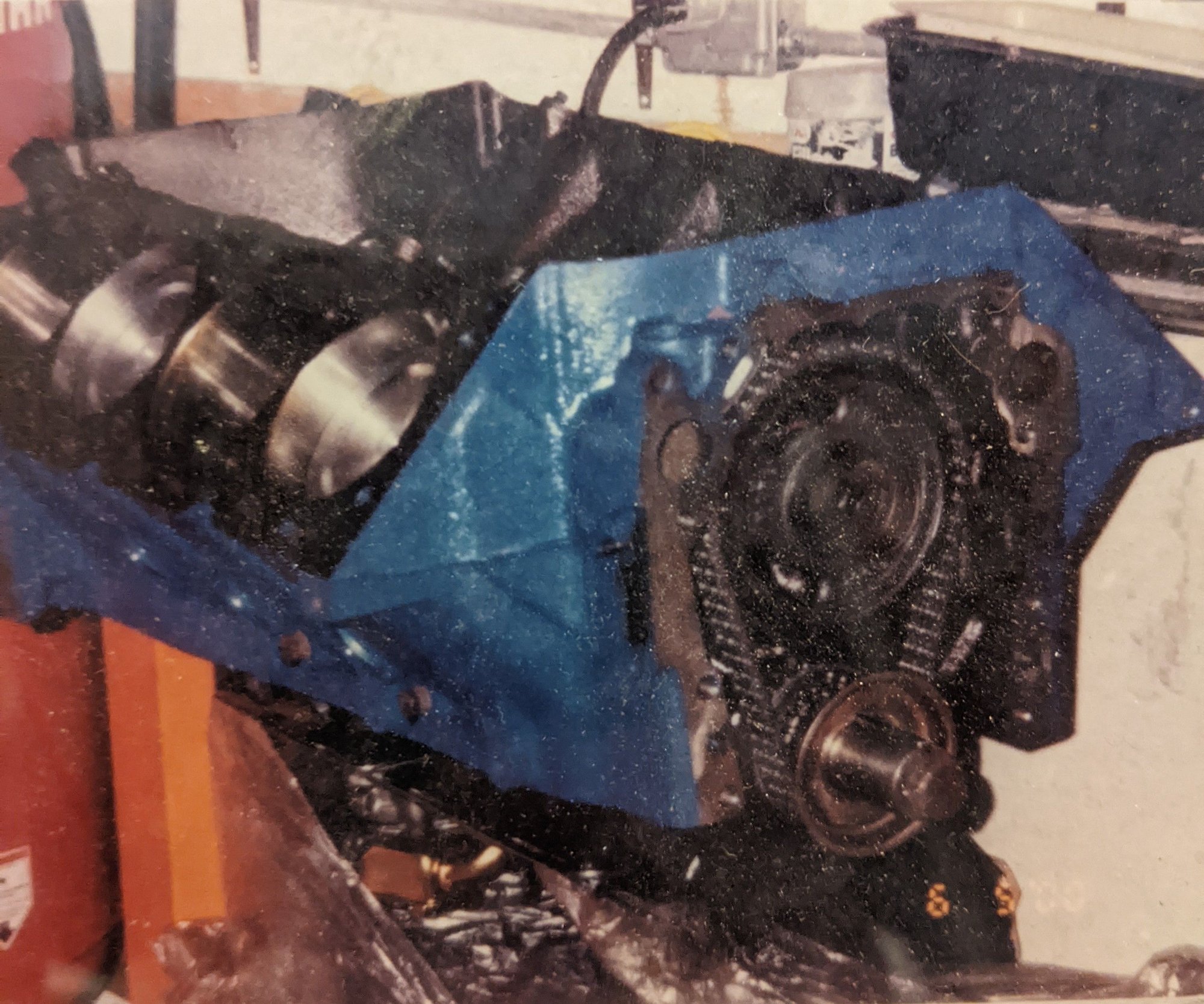

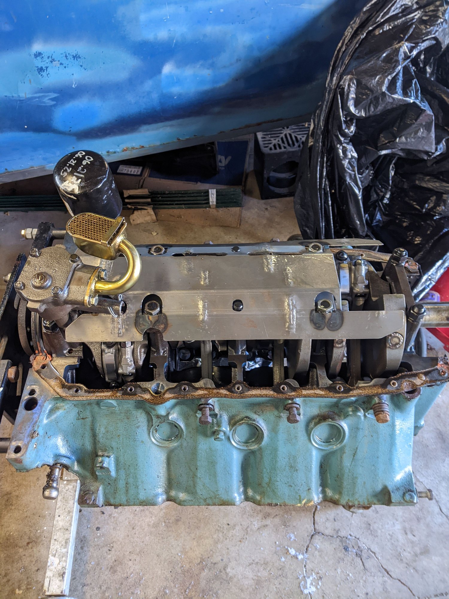

Time to start taking the engine apart! I found some interesting things when taking it apart. The first thing is one lifter had a nasty scar in it. The other thing I noticed was that cylinder #2 rod cap was on backwards!!!! I think that younger me put that together, so no one else to blame but myself.
I also noticed that the rod bearings that I used were not fully grooved. So what did younger me do? I matched up the grooves so that some of the rods had a full groove, and others had none. Geesh.
Crank journals do not look good to me for having so few hours on the motor. So I'm sending it all to the shop to have them investigate and hopefully save what I've got. I already had the shop go thru my heads, because I didn't like how the intake valves looked. Sure enough, they said the valve job on the intake wasn't good and it needed new intake valves (I didn't tell them about that, I just asked them to go thru the heads and look them over).

Cylinder 1/2 journal.  Looks pretty bad to me, especially considering the low miles on the engine.

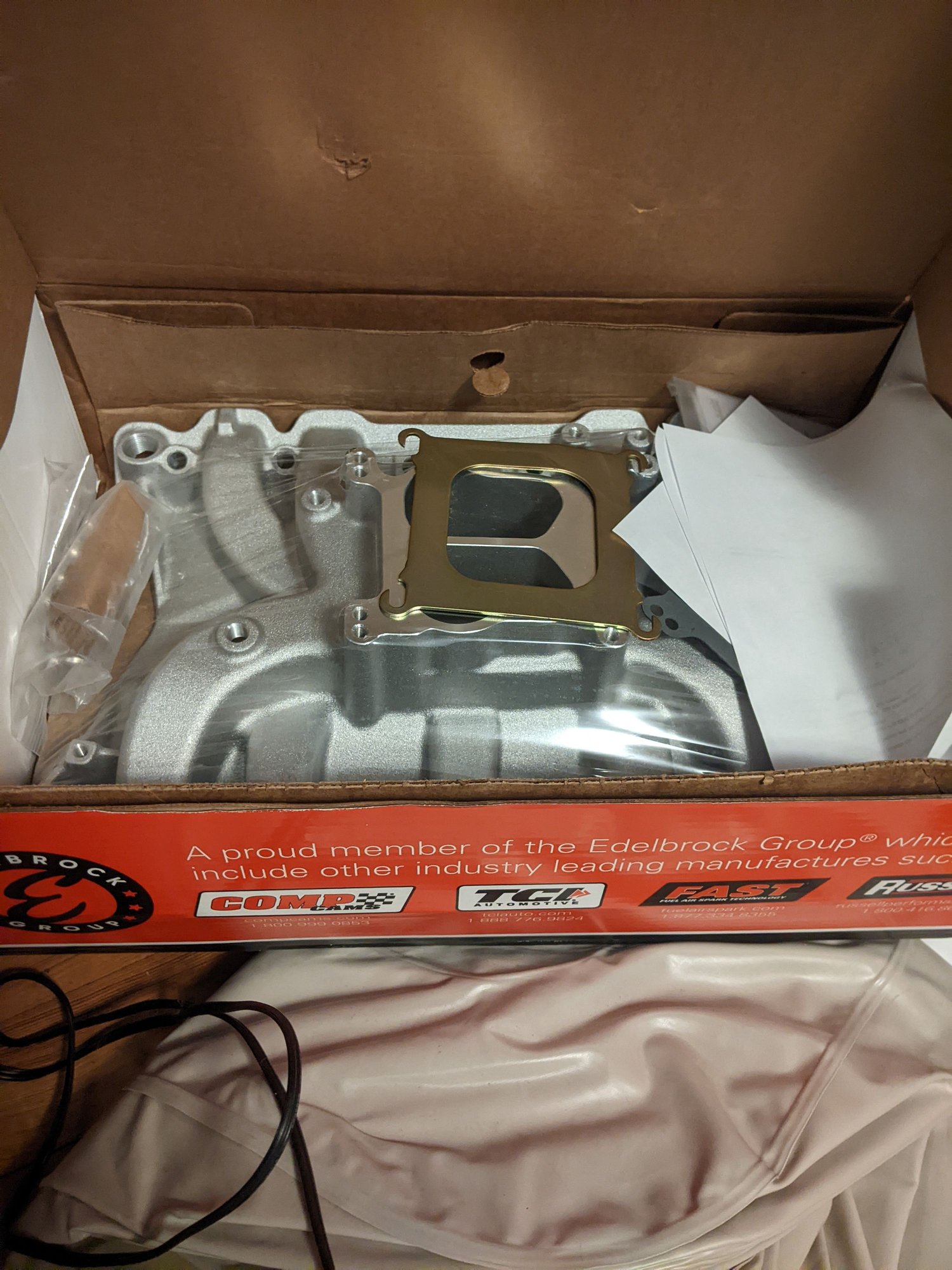

Next steps are to fully strip the block. Clean up all the threads, then ship it off to the machine shop to have them check everything out.
I did buy a performer manifold to replace the torquer, and an AVS2 800 cfm carb to replace the itty bitty carb I had on there.
I will be in the market for a new camshaft, but could probably use some help in that department. So if anyone has a similar build, and intend to use their car on the street with some occasional "spirited" driving, I'd love to hear what you are running.
