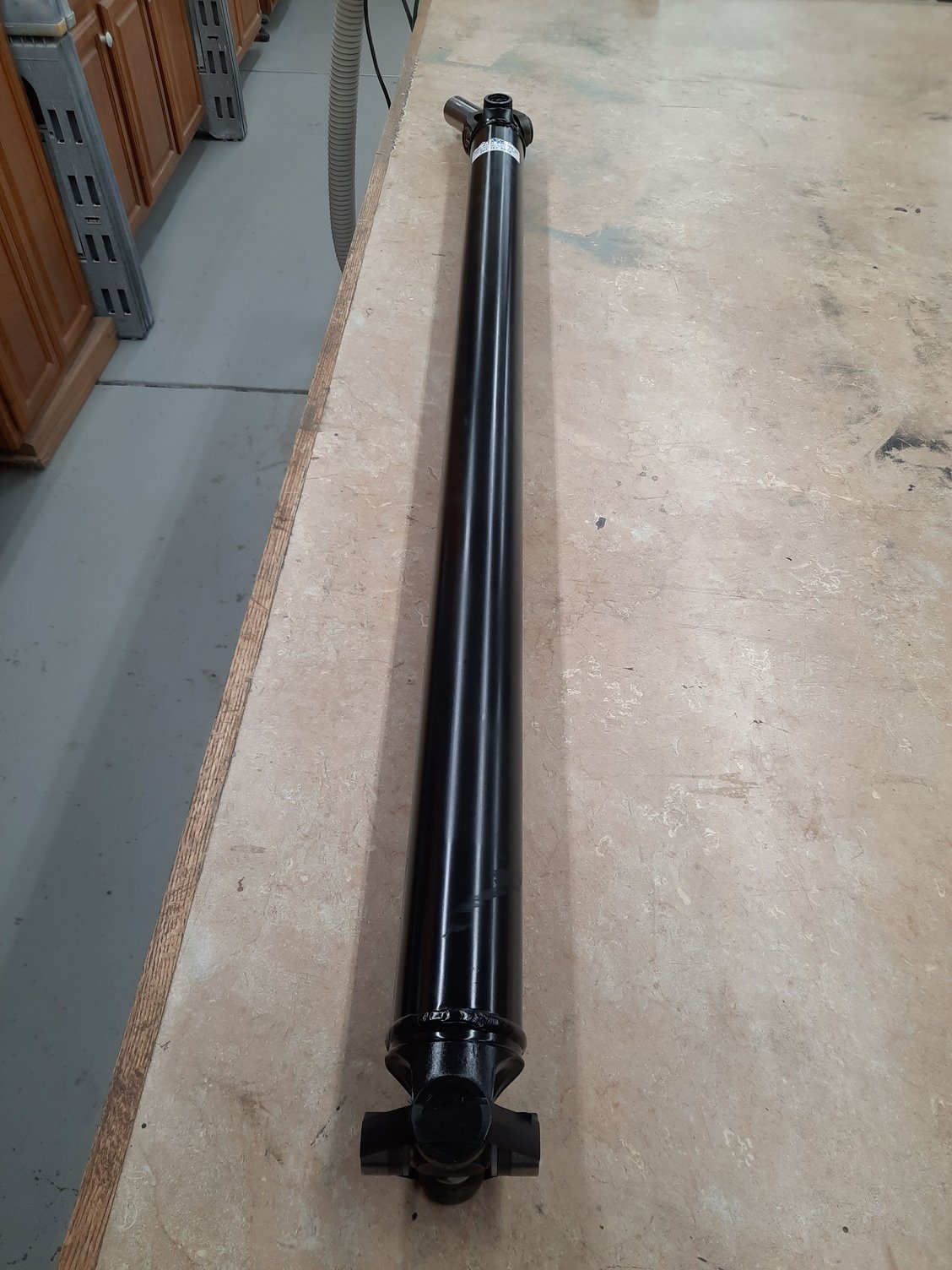

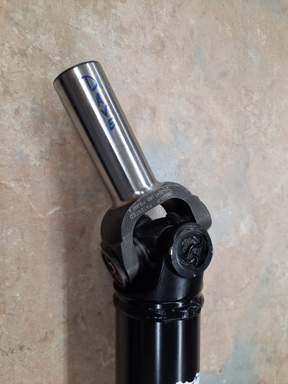

Well great news this week....I finally was able to get a driveshaft locally. It appears there are still limited parts for the 1350 U Joints transmission slip yokes. I had to upgrade to the Mark Williams yoke but glad I did.
Took my first drive after setting all four coilovers, ride height and a quick alignment in the shop. Car ran great and everything performed well. Next off to the exhaust shop although the open header sound is kinda cool.
Mark Williams trans yoke. 1350 U joints.

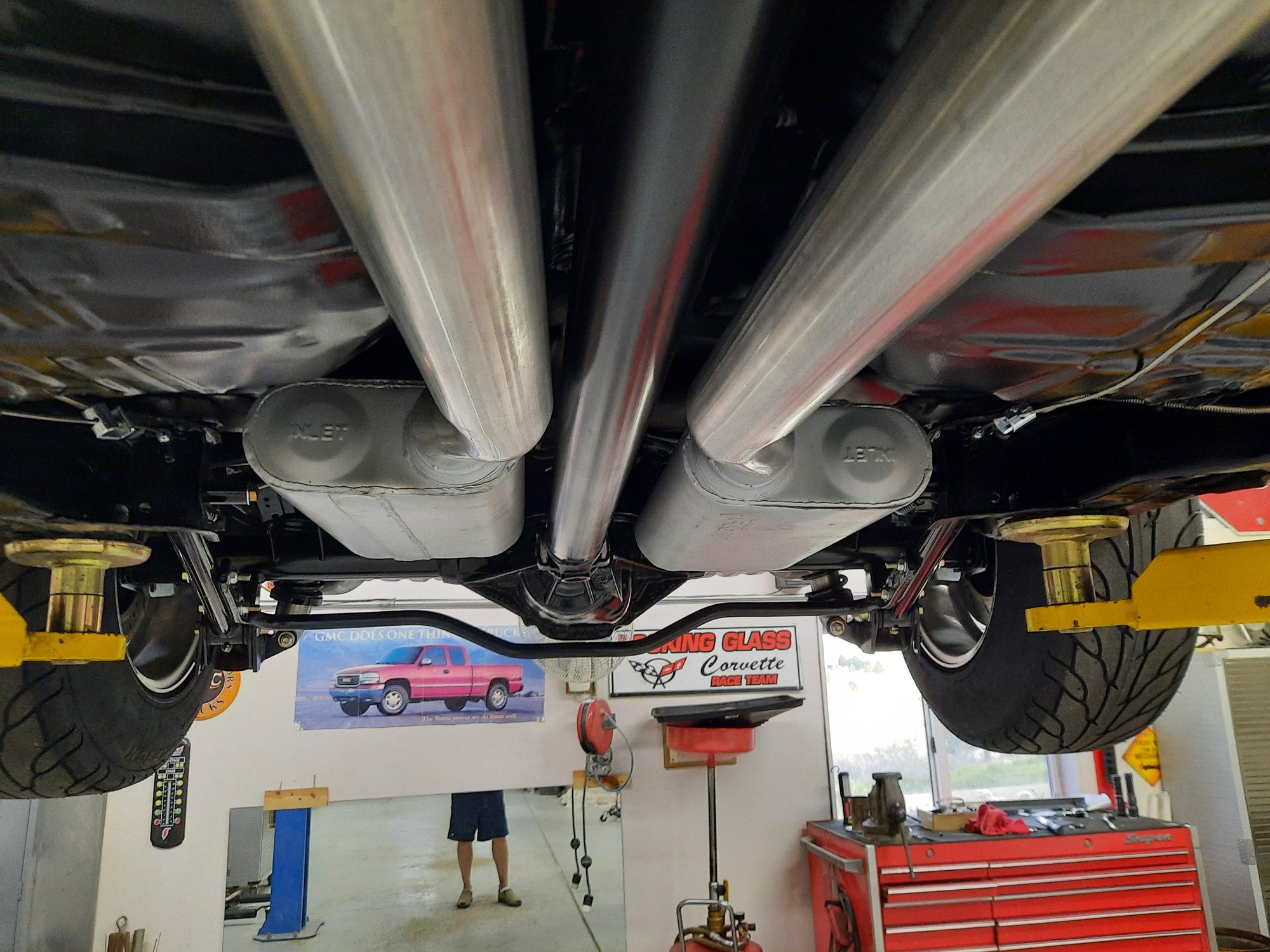

This past Thursday I was able to trailer the car to the exhaust shop 40 mins away and get the exhaust work done. The shop was top notch and did great work. I went with 3" pipes from the 3 1/2" header collector back to Pypes Race Pro mufflers and then 2 1/2" tail pipes back to chrome Pypes trumpet tips. All in all, the system turned out great and seems to perform well. It has quite the bark at idle and then turns heads when you get on it motoring down the road.
I put the hood back on which is nice to see after waiting 2 1/2 years to get to this point and began driving the car more this weekend. I have about 35 miles on it so far and everything is working great. Had to calibrate the Dakota Digital speedometer but that was simple. Now I'm just finishing up a few small items and enjoying the car. I will post another video of the car all put together and running so people can hear the exhaust and engine sounds now.
442 on it's way to the exhaust shop.....
Exhaust complete with Pypes 2 1/2" trumpet exhaust tips....
Exhaust fitment.....
Exhaust fitment.....great welds and bends.....
They did a great job on the welds and even painted everything prior to tucking everything back up into the car.
Exhaust tips fitment is also very straight and level....
The car is finally back together and ready to run.....

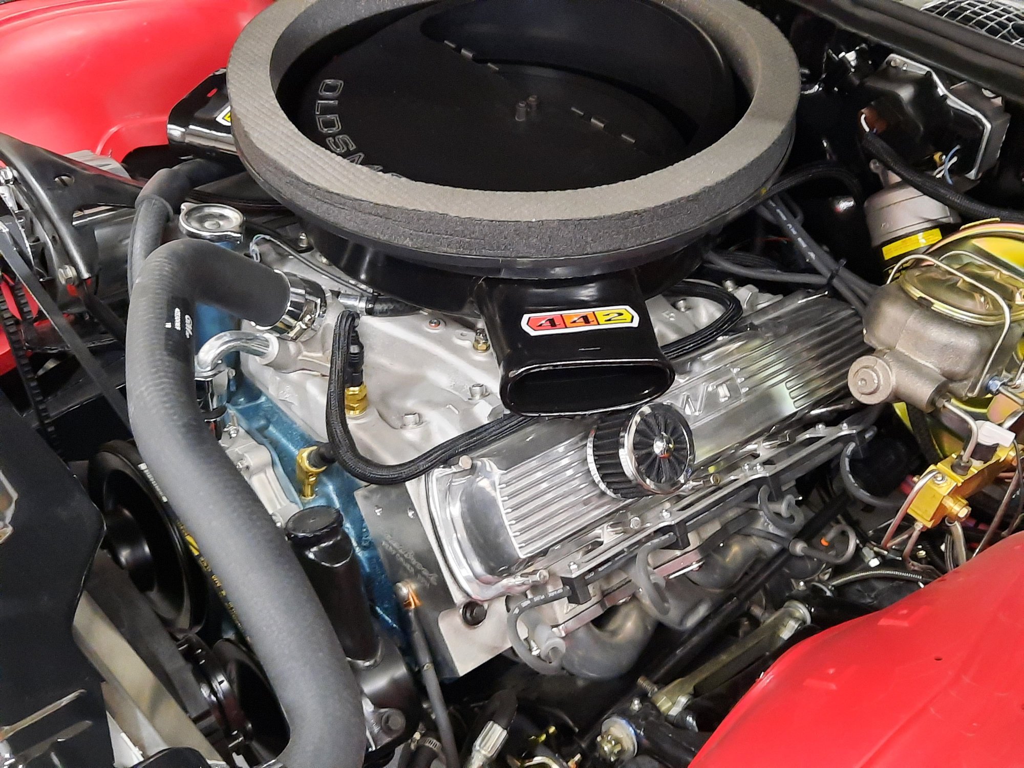

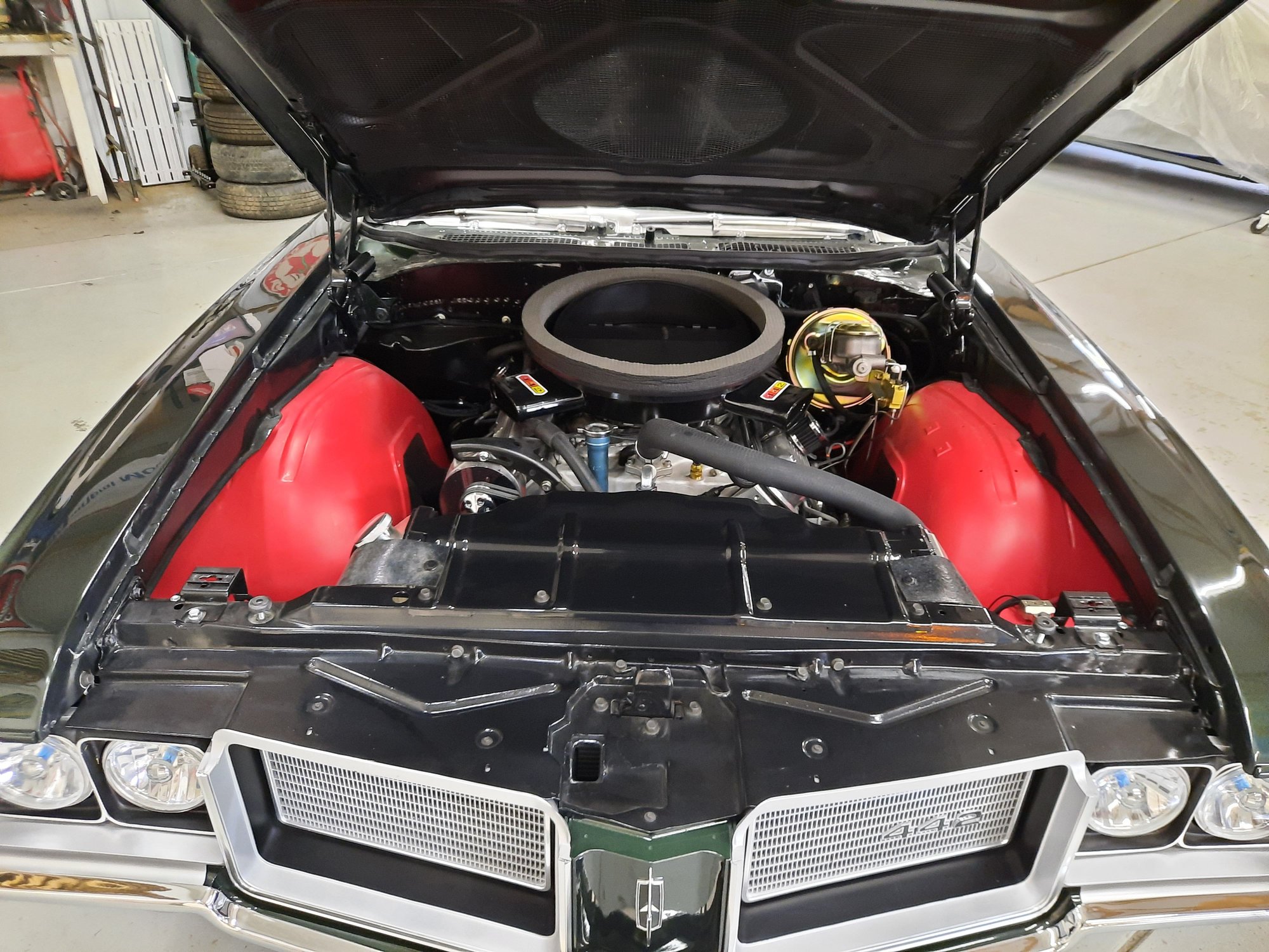

Well the air cleaner assembly was bugging me and I can't leave well-enough alone on anything.....so removed the stock single snorkel and went to a dual. Cut the snorkels down, welded on a nice leading edge, then formed and smoothed it with filler. Much better.....more symmetrical AND more intake air possibilities. Happy Friday.
Dual snorkel setup....
Used a paint pen to highlight the Oldsmobile letters.
I will replace the factory breathers with two silver, high-flow breathers.

Wanted to show a few pics of how I changed up the air filter snorkel and breathers to finish the look I wanted.....
Dual snorkel air cleaner assembly
Hi flow breathers
