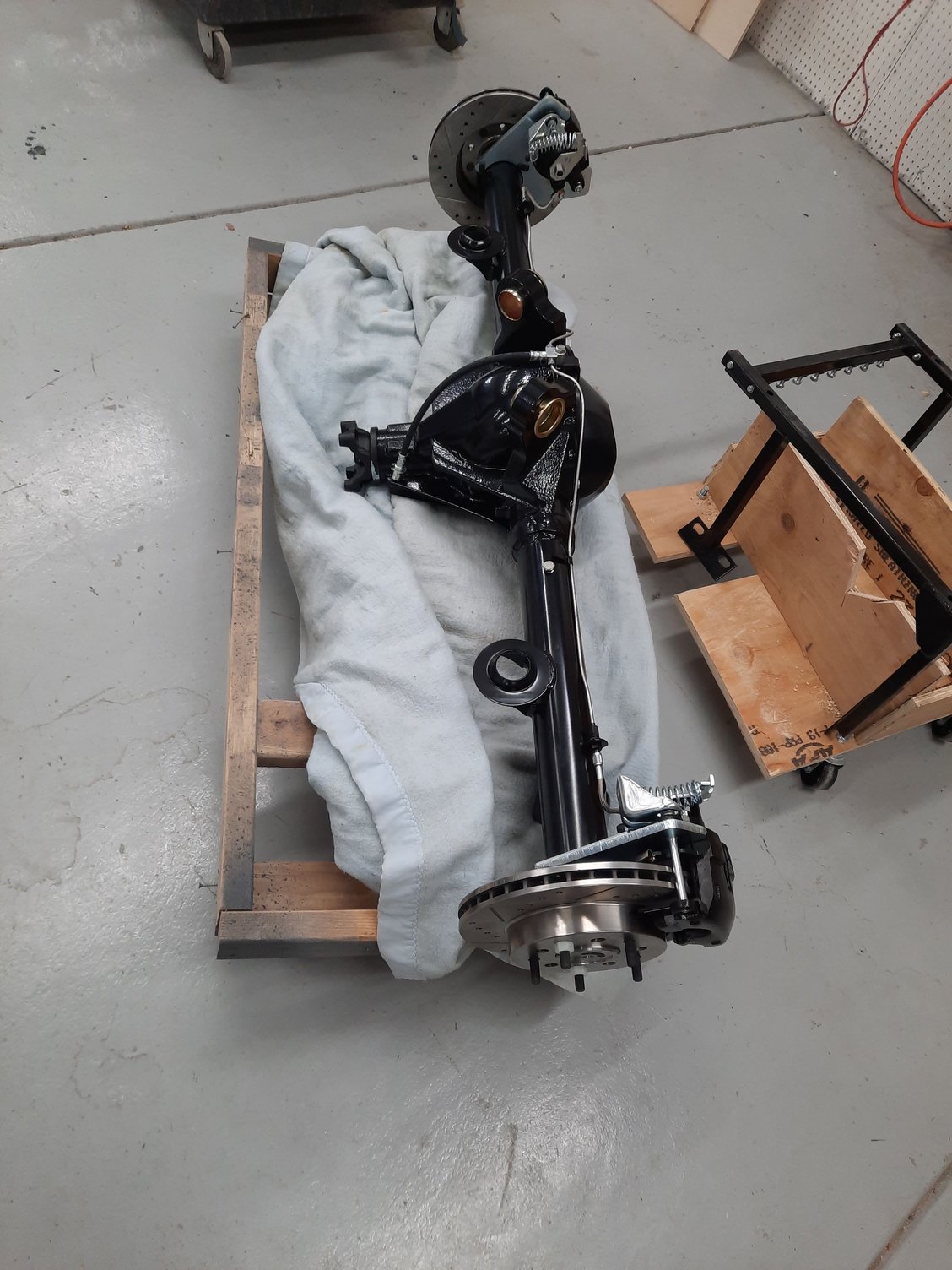

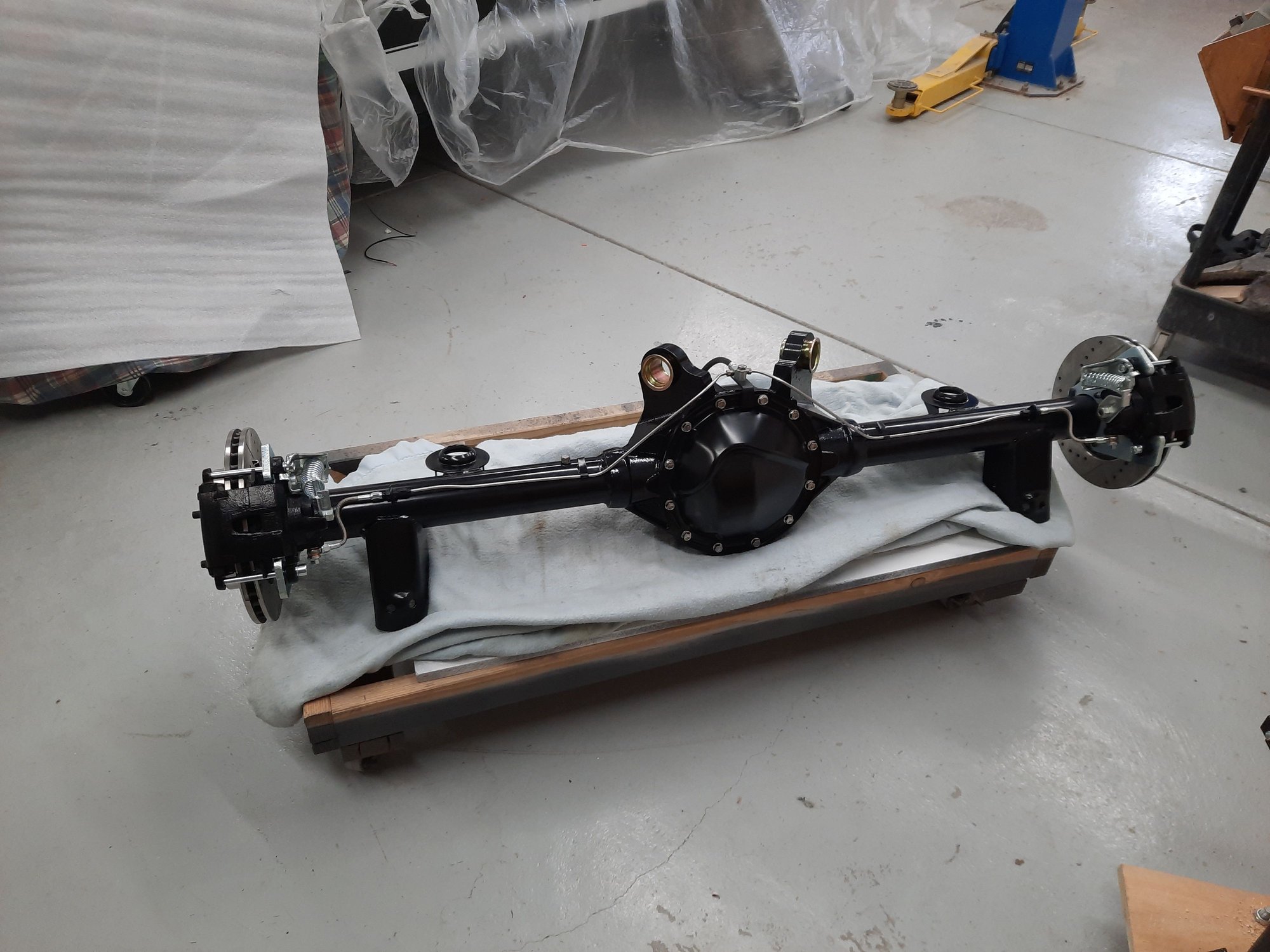

Just picked up my new GM 12 bolt rear end today from Tom Rockwell Racing. This is the second rear end he's built for me and I like his work. This one has 4.10 posi gears which will be fun and still work well with the Tremec TKX 5 speed I hope to purchase soon. My new UMI rear tubular control arms and sway bar arrived but still waiting on the coil-overs from Performance Online. More to come.....
New GM 12 bolt---Right Stuff Rear Disc brakes with drilled and slotted rotors, 4.10 posi gears and 1350 driveshaft yoke.

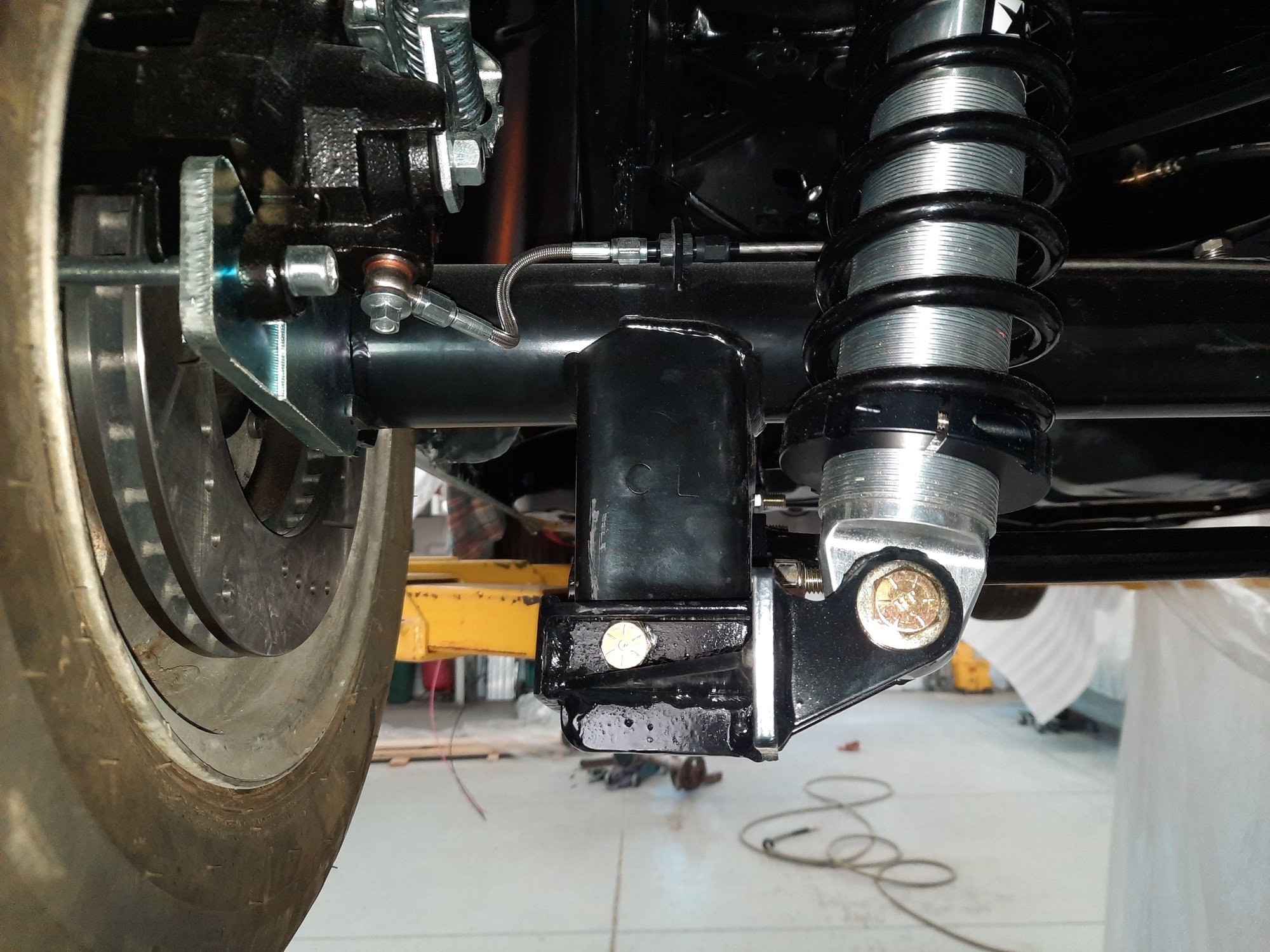

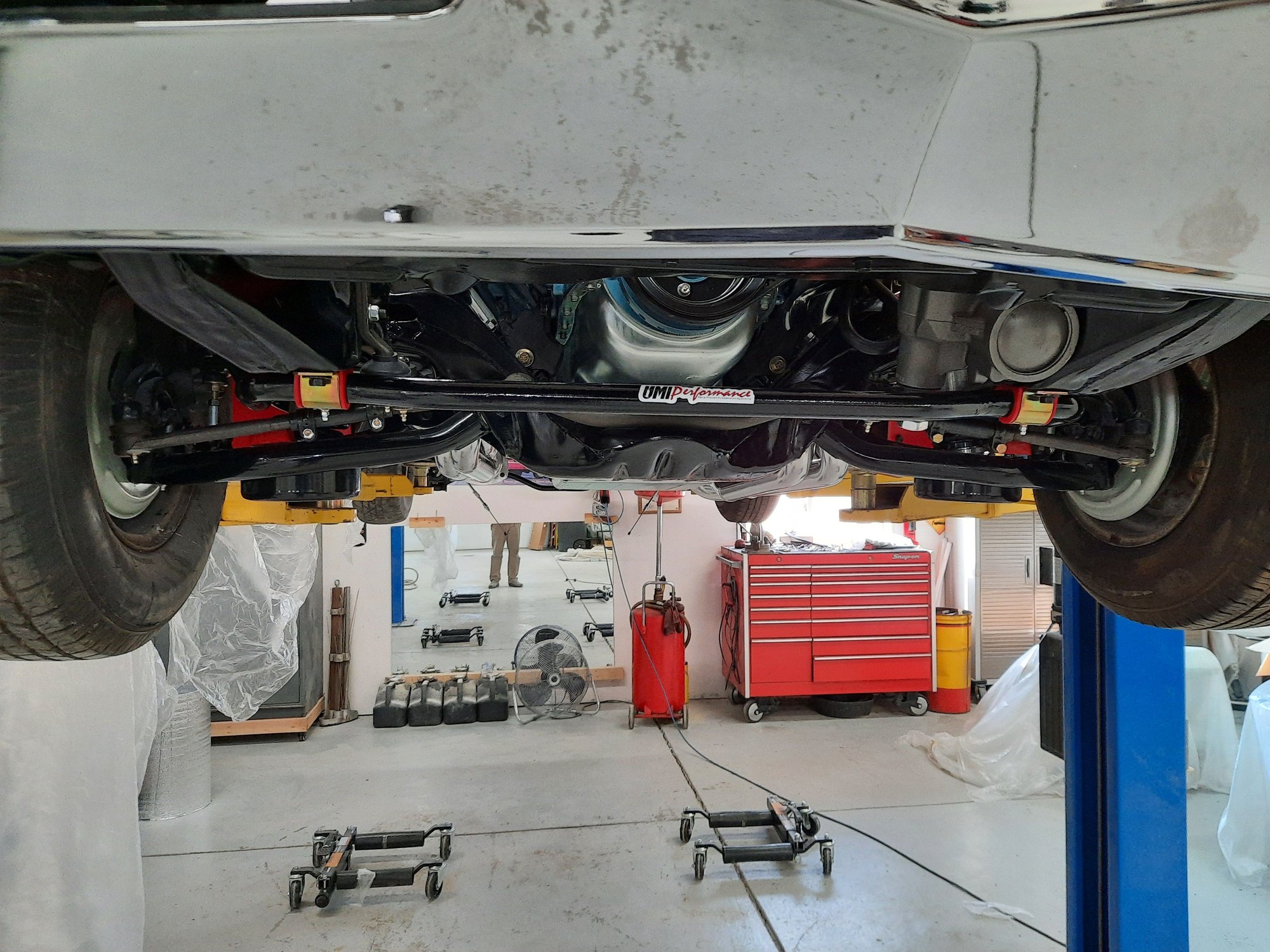

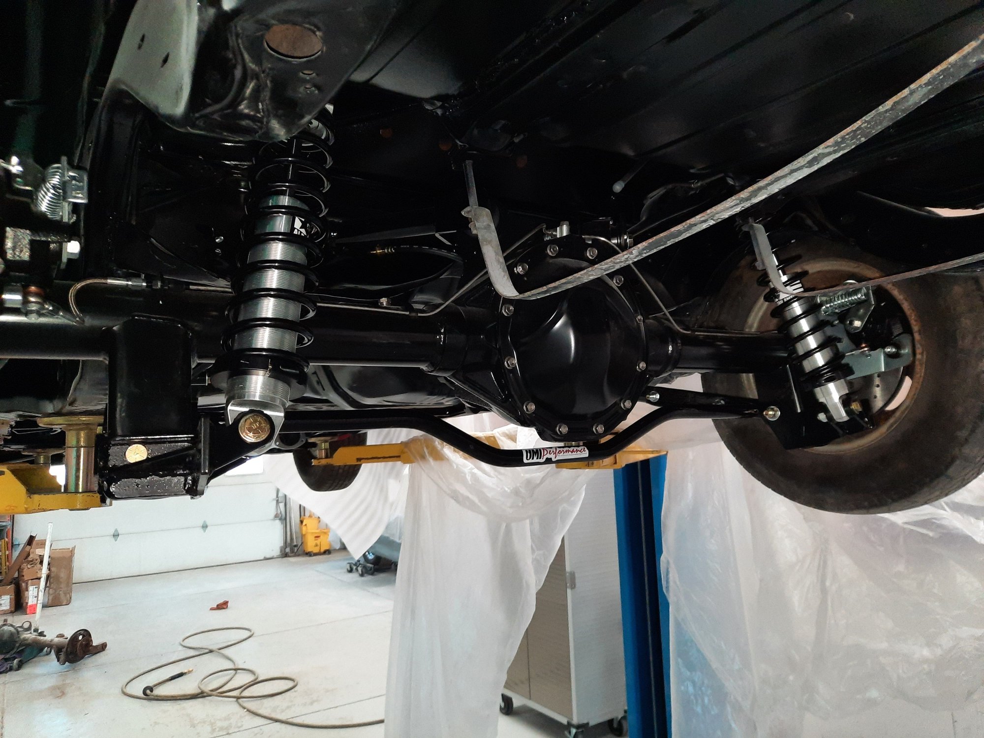

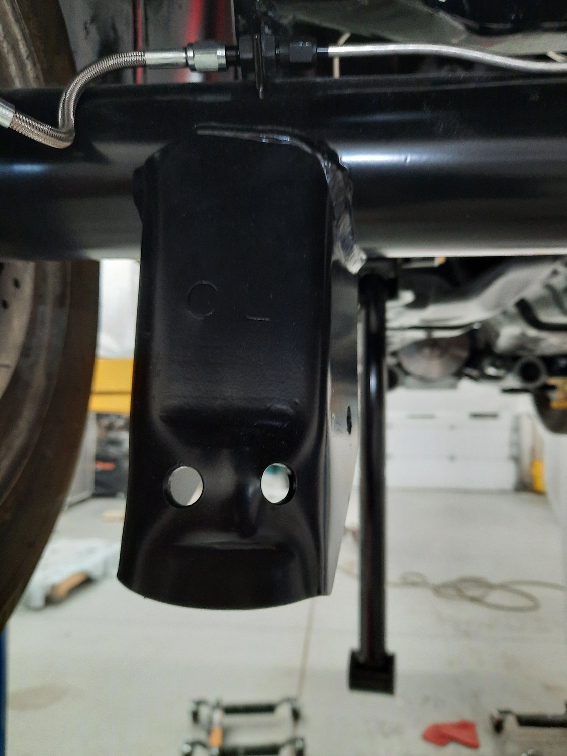

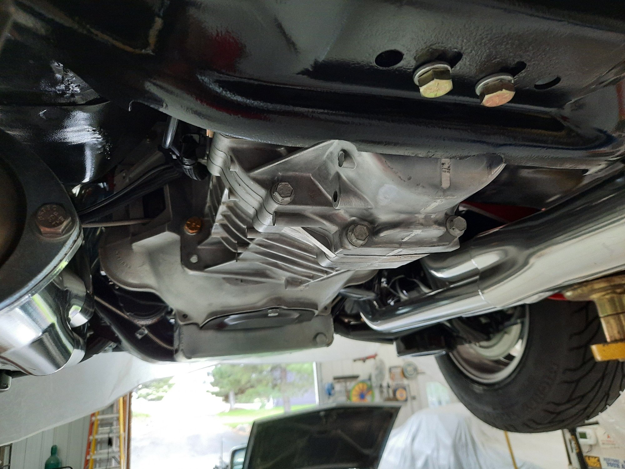

Time to install the rear-end and the rear suspension components. I chose UMI for my rear tubular control arms and sway bar. I went with Aldan American coilovers for the rear purchased from Performance On Line(POL). The install of the new 12-bolt posi was pretty straightforward but not so much on the coilovers. I found out that the Moser shock and lower control arm mounting tangs, that are welded on the housing, are much different than the ones on a GM housing. This caused the coilover brackets to be completely out of alignment. I had to do minor surgery on the brackets with my plasma cutter and then re-weld them with the correct angles and spacing. Here are pics showing the new corrected brackets and the entire setup all complete. All-in-all....it came out nice and I'm happy with it.
Here are the Moser brackets welded to the housing. They're quite different for the shock mount and the lower control arm mounting area.
Left side bracket with alterations....
Right side bracket with alterations....
View from the rear....
View from the front...

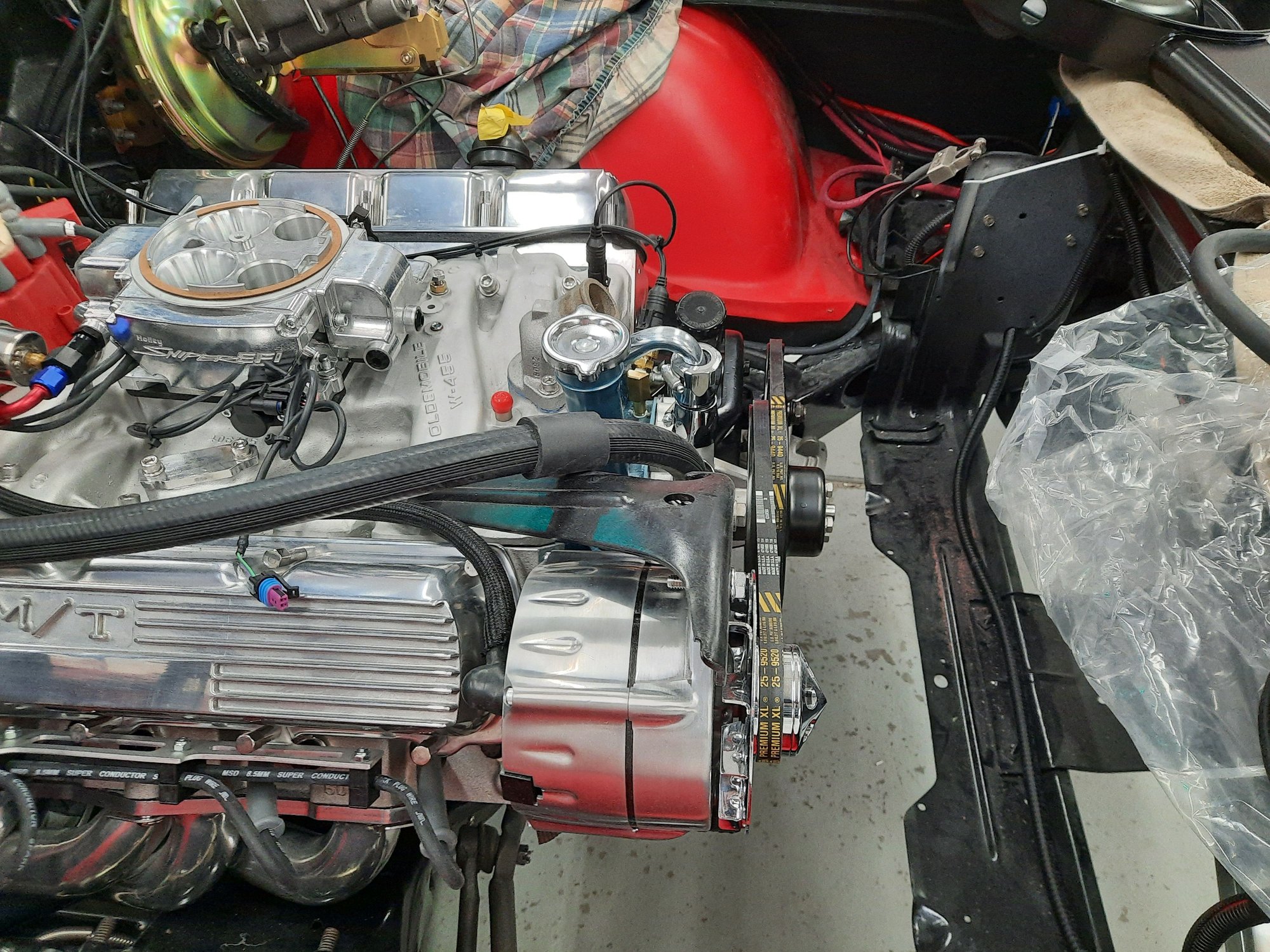

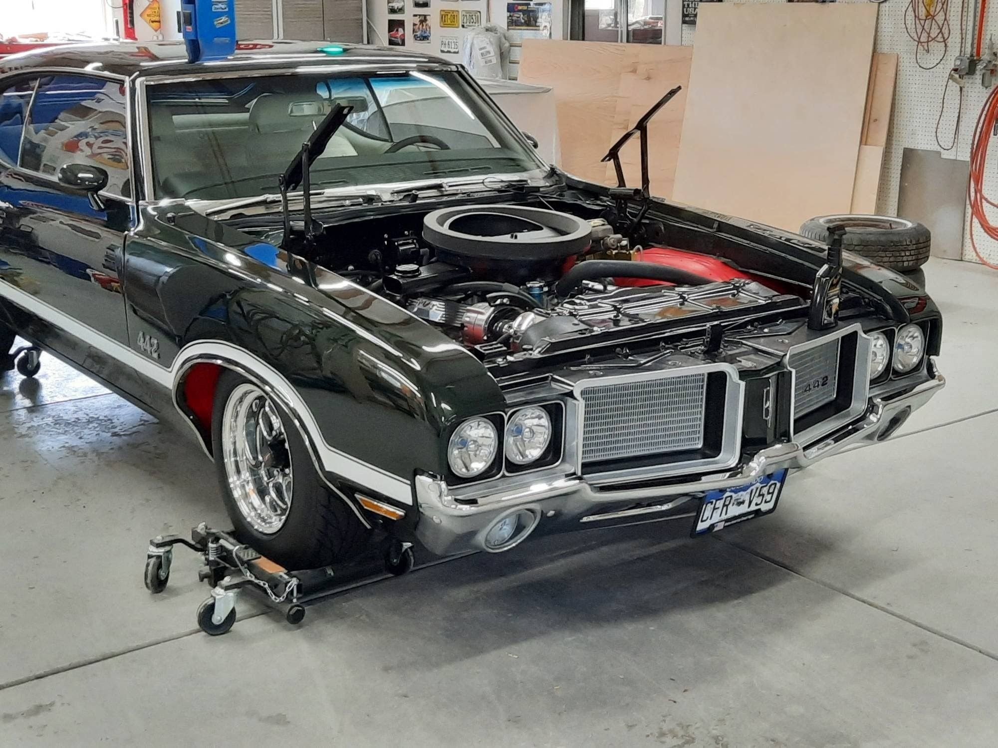

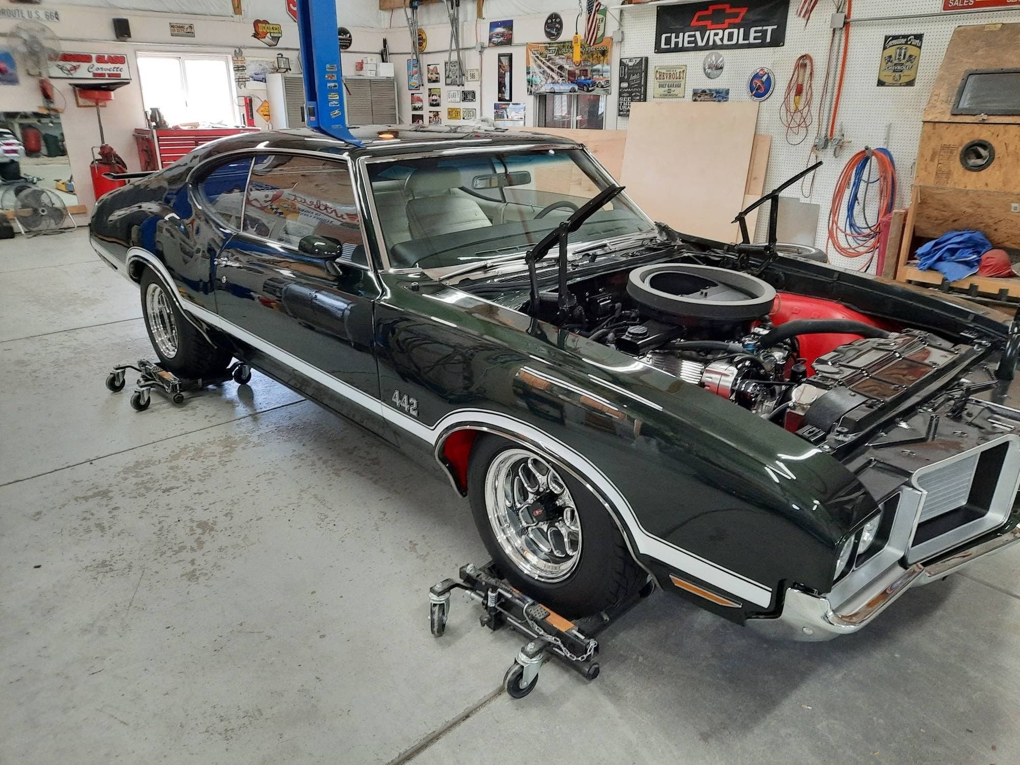

Lots of work done in the last two days.....received the Holley SNIPER Quadra-Jet setup, the fuel tank, and sending unit this week.
Installed the SNIPER and was able to finish near all the wiring for the engine compartment. Installed all the SNIPER feeder circuits, signal circuits and outputs associated with the SNIPER and the Hyper Spark ignition system. I was able to shorten and lengthen the wires as necessary to keep the majority of the wiring hidden and out of site. The coil driver box is placed right behind the right front headlights and then the coil is mounted to the firewall near the distributor. I'll be swapping out the distributor soon as I was waiting to complete a few more things.

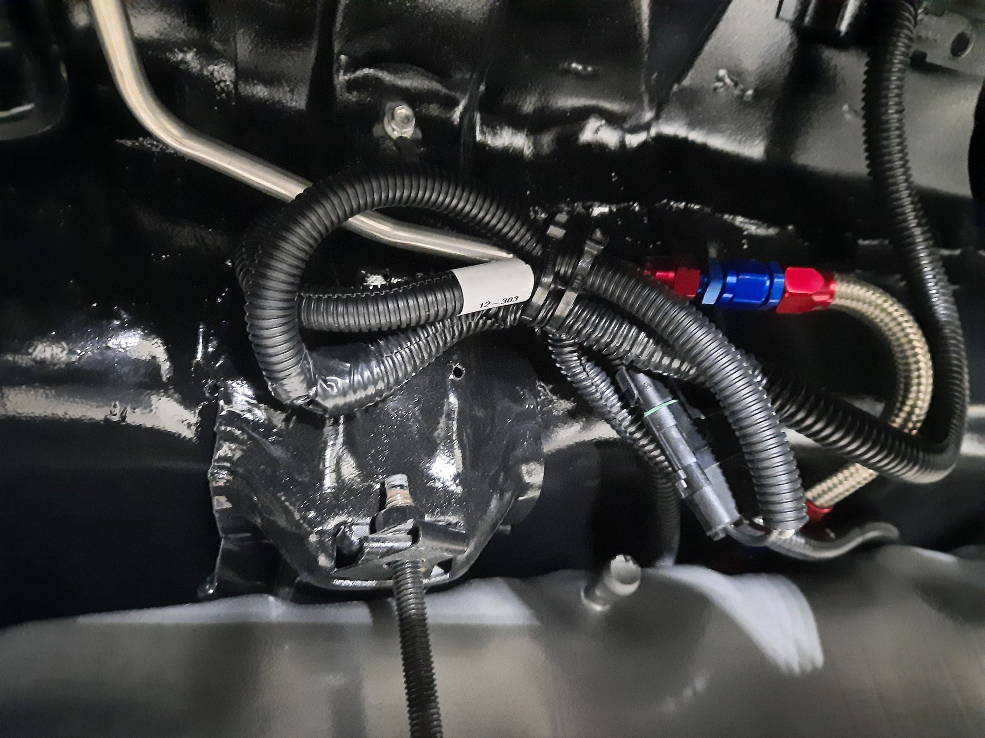

Fuel tank is now installed along with the Holley OEM style pump and sender. I like this model as it recirculates in the tank relieving the need for an external fuel pressure regular. The Quadra-Jet model does not have internal fuel regulation in the throttle body like the 4150 models and requires a bit more thought on how to regulate the fuel pressure.
I have to finalize a few more connections into the Dakota Digital input board for oil pressure and coolant temp. Next will be ordering the radiator and fan setup with internal overflow tank from Wizard Cooling. It's a high capacity aluminum radiator with the overflow tank built in and also includes two high speed SPAL fans integrated into the shroud. I've already added the wiring provisions for the fans and even an external fan bypass. This bypass allows me to enable the fans whenever I desire rather than relying on the SNIPER to trigger them based on the setup parameters entered.
OEM style tank and Holley OEM sending unit and pump..
Fuel tank wiring and fuel line routing....
SNIPER throttle body installed along with fuel line and pressure gage.
More engine compartment pics....
Excited to place the air cleaner on the engine and see how everything fit.....

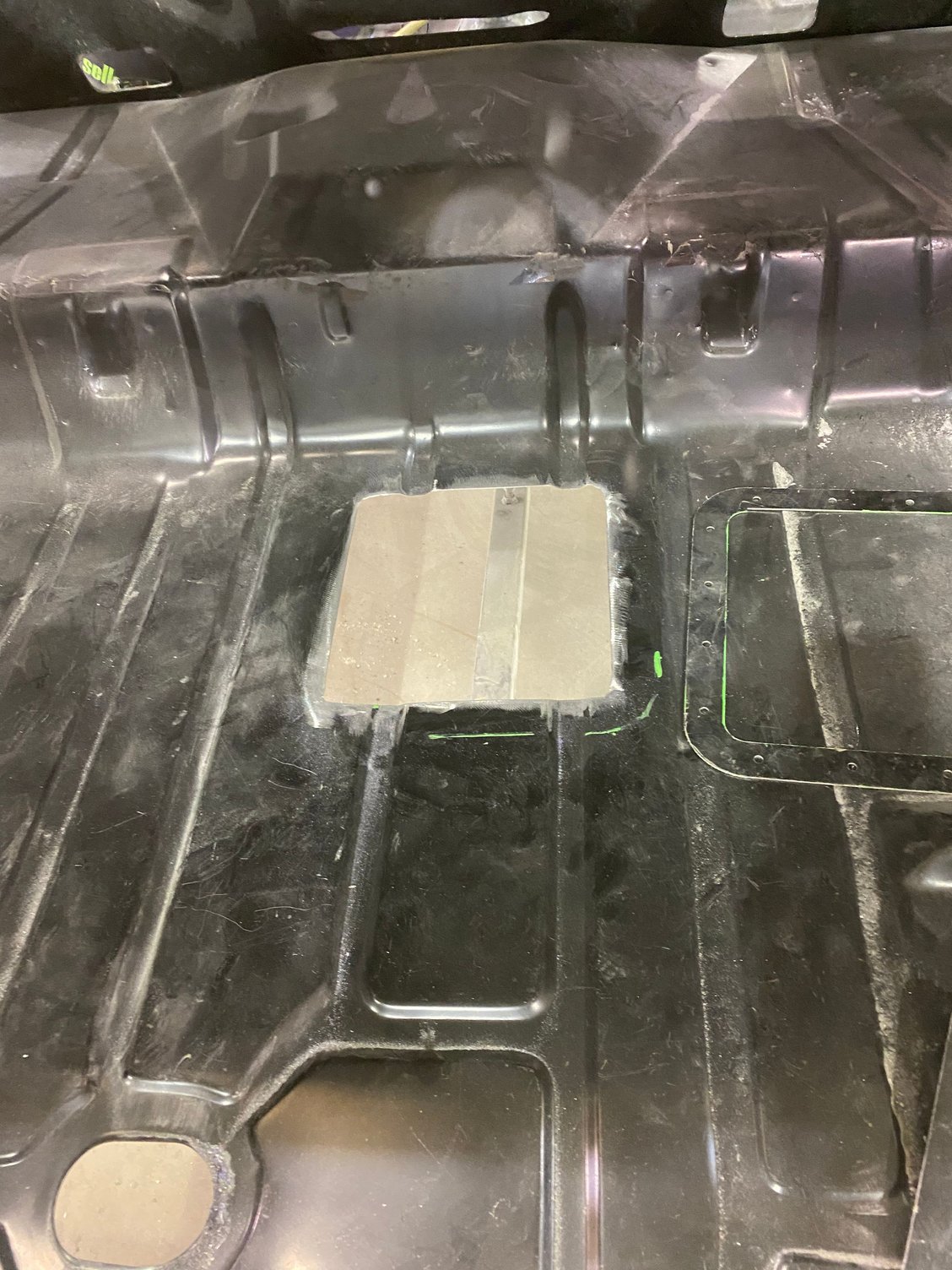

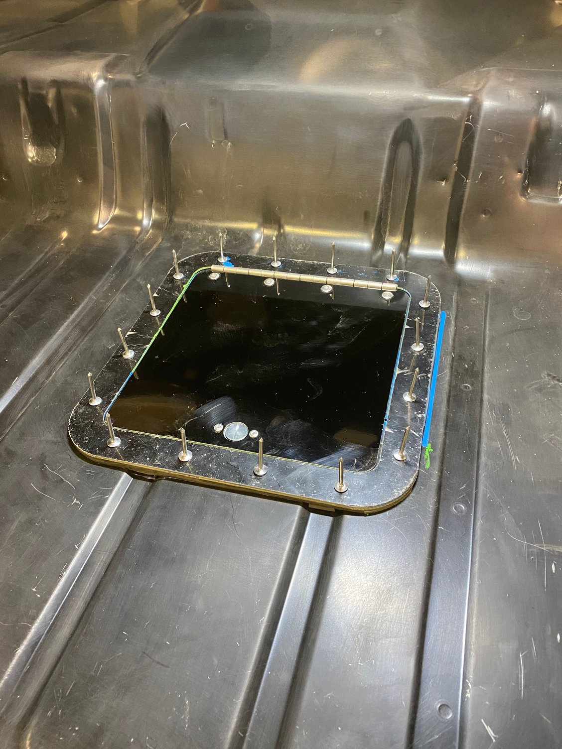

One of the hardest things I had to do was cut a hole in a brand new trunk pan. But I wanted to have access to my intank fuel pump if anything should happen. But it came out ok.

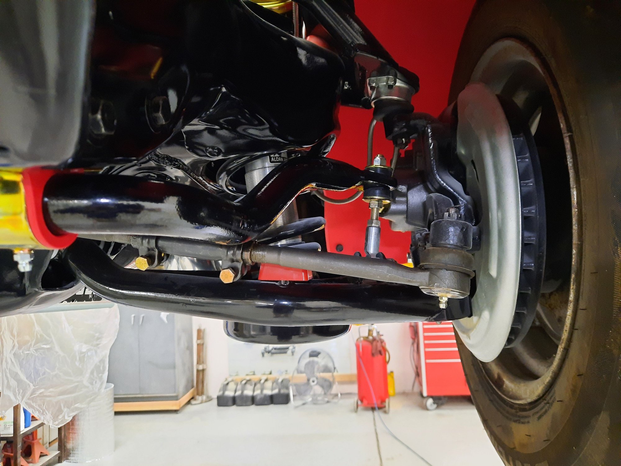

Front sway bar and links installed.

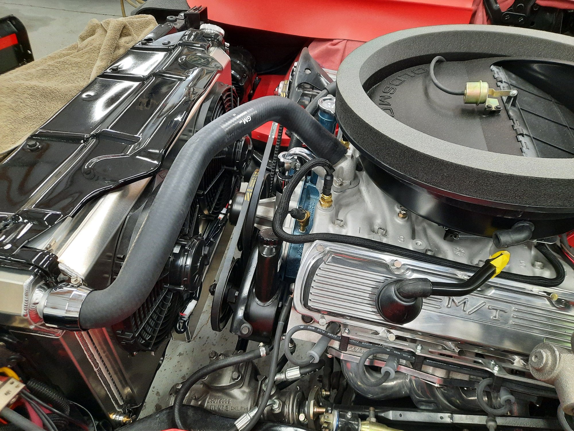

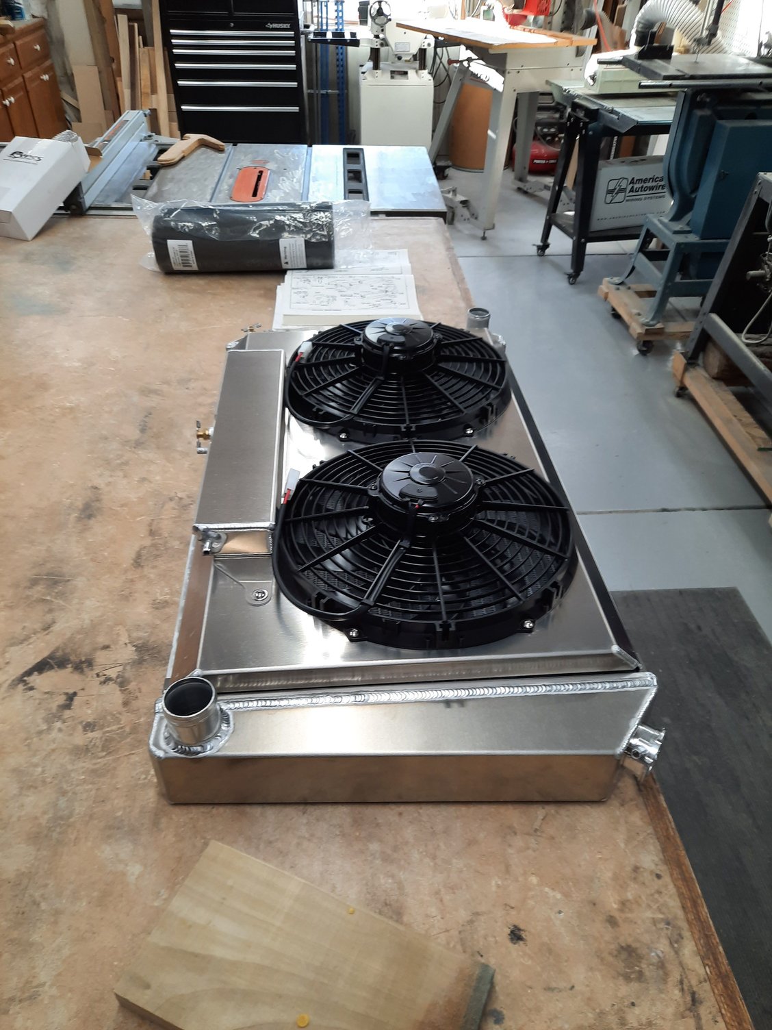

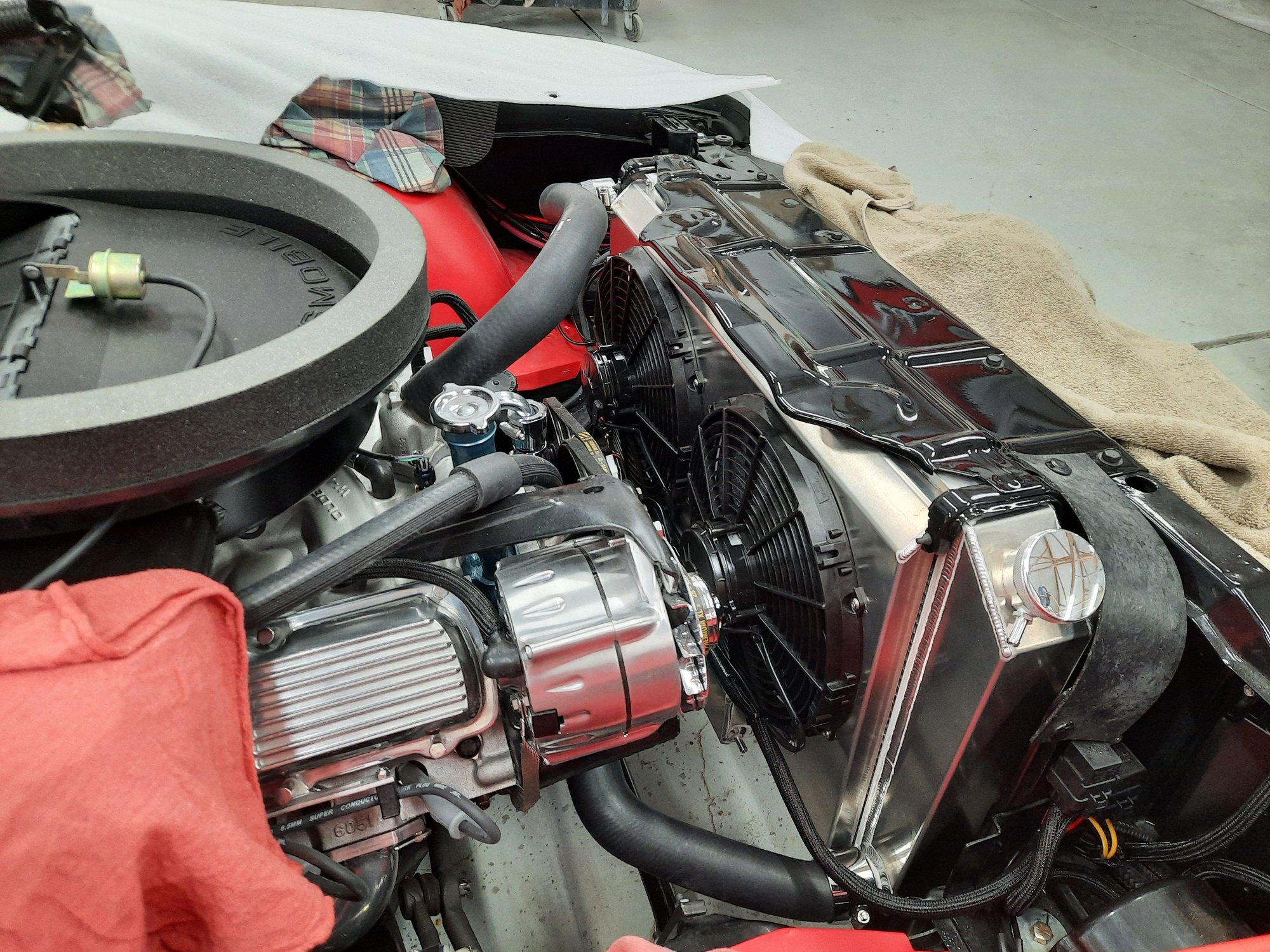

The latest---installed the new Wizard Cooling aluminum radiator with cooling fans over the weekend. I like the look and the fitment. Battery install will be next and then I can fire up the engine while I'm waiting on the trans and other driveline components.
Finally received my rear seat upholstery that's been on order for a year. Cleaned and painted the frames and then added the matting and foam for the seat cushions and seat back. Still waiting on the rear door panels. I have no idea when those will arrive. Also received the front door panels and hope to install those this weekend. More pics to come on that.
New Wizard high performance radiator
Installed...

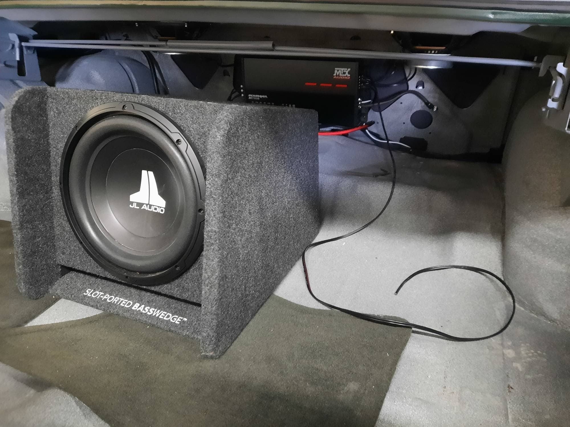

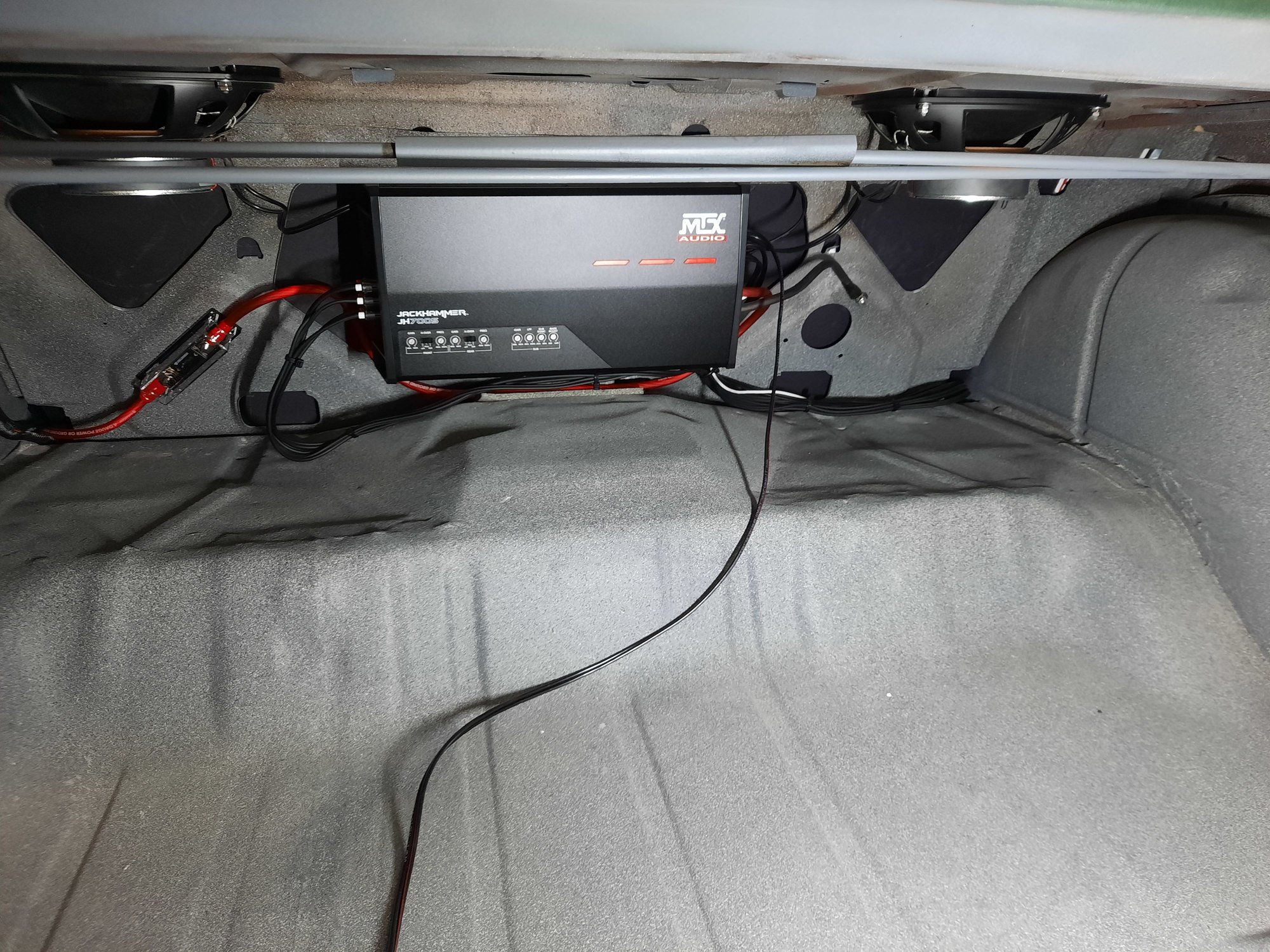

This weekend I finished installing the sound system and am VERY pleased with how that turned out. I went with the Focal speakers recommended from Crutchfield and they sound amazing with the amp that's installed in the trunk. There are 5.5" speakers that I made brackets for and hung under the dash near the kick panels, the Retro Sound speaker in the original dash
​​​​​​​ location, and then (2) 6x9" Focal speakers in the rear deck area. Then add a 12" JL subwoofer with enclosure and it sounds like you are at a concert. The stereo I went with was the Classic Car Stereos model 740. It's got a classic AM radio look but is loaded with all the normal tech features we like.

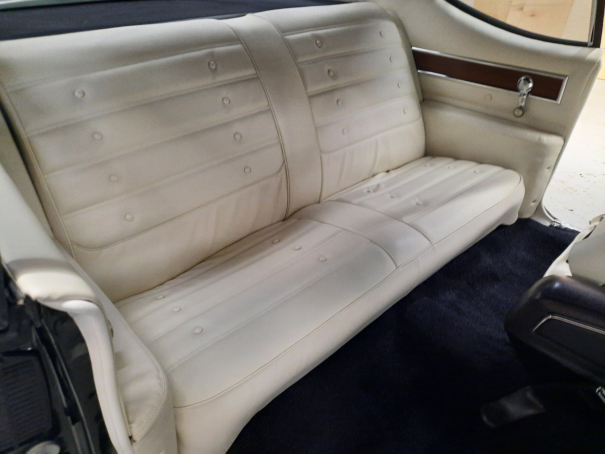

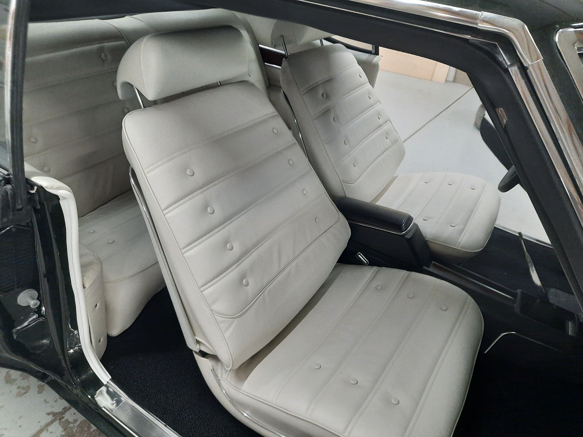

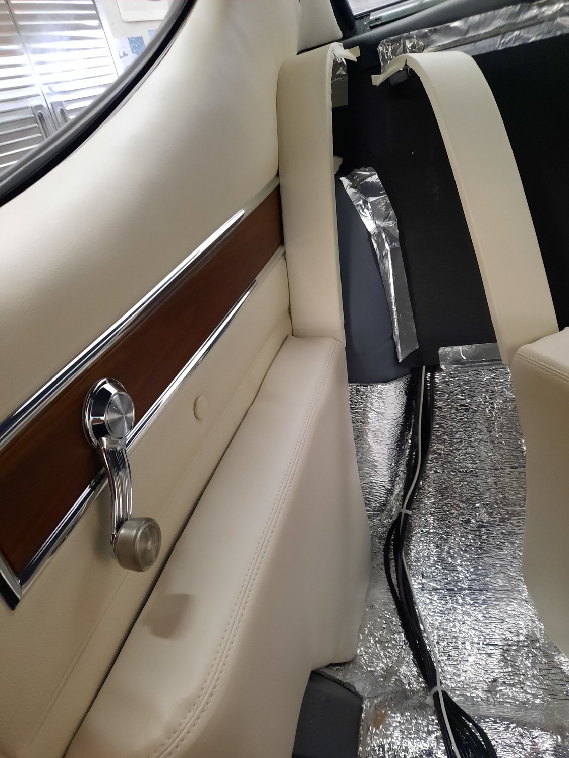

Rear door panels finally arrived yesterday afternoon after a nearly 16 month COVID delay. Installed the rear panels and finished up a giant portion of the interior, seats, carpet, and trim panels last evening. Seatbelts next and then the interior for the most part----should be complete.
Prepping the panel to drill the window crank hole.
Rear door panel half installed.....
Carpet and sill plate completed.
Rear components installed.
The final product........

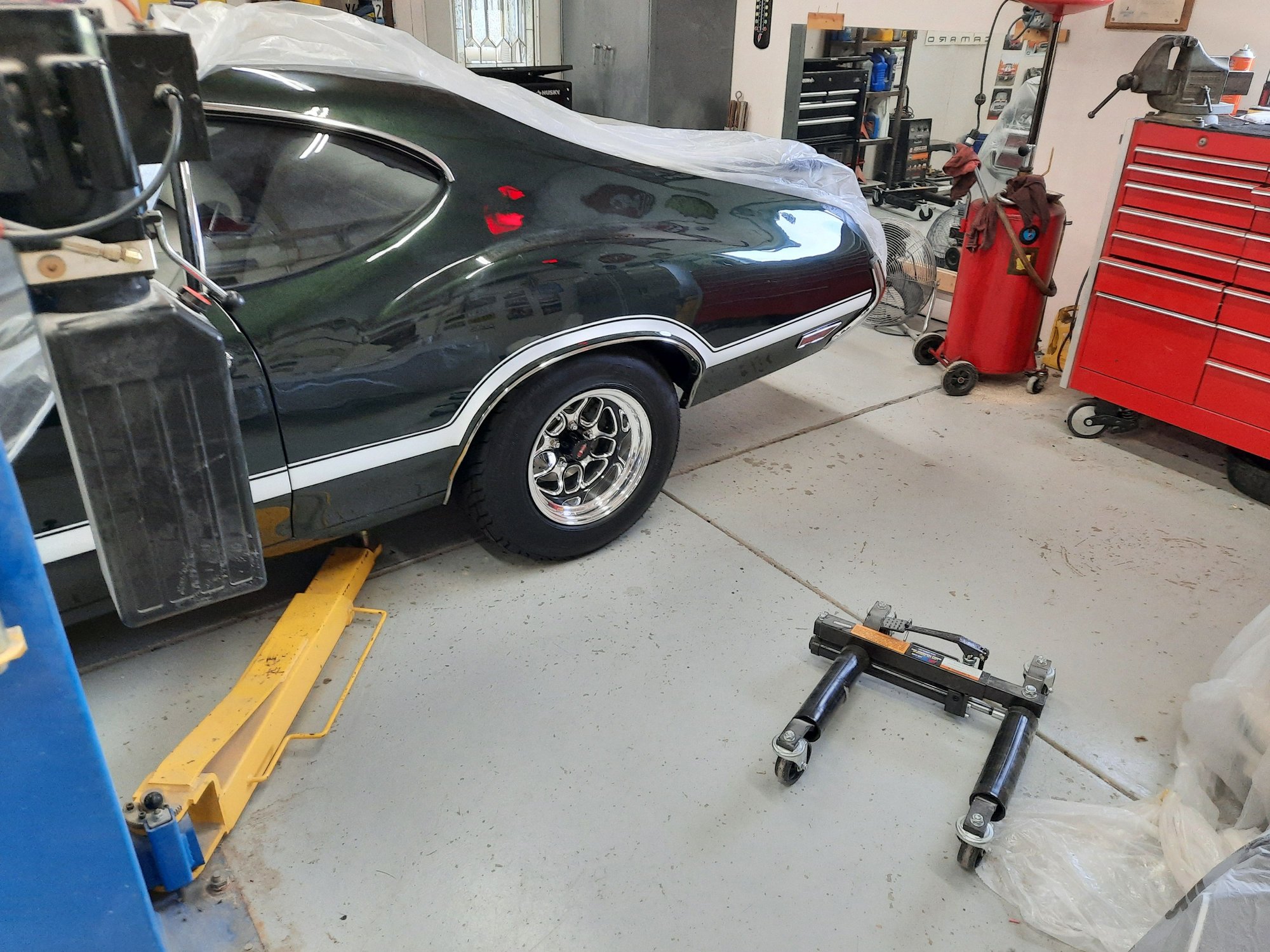

Ready for that first drive once I get the driveshaft......excited!
