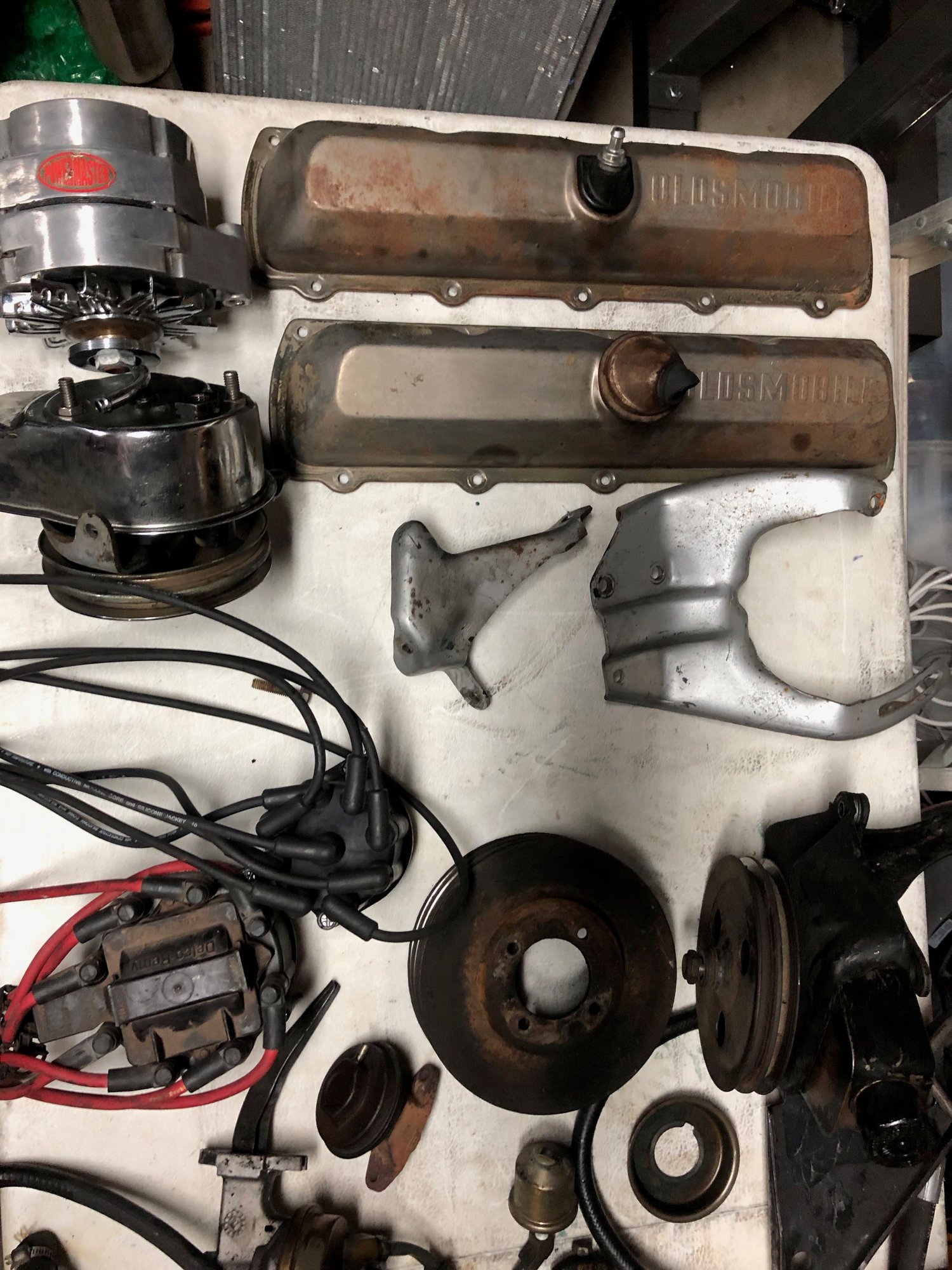

I laid out all of the pulleys and accessories I have at the moment for the car, some of these are from both engines:

I wanted to see if you guys could advise me on what I may be missing in regard of accessories and pulleys to be put on while it still on the engine stand. Here is a couple of things I know I will need:
-AC Compressor
-Electric Fan setup
-Trunk Lid
-Distributor
-Spark Plugs
-Liquids(Oil, Power Steering, Coolant, Brake fluid)

That compression is high for the cam being used, only use premium gas. What was done to the carb? Being a 74 model, if it came off the motor with the Oldsmobile stamped valve covers and being a reman, it was probably way off tune wise. It will probably run lean. I would also upgrade the torque converter to this. It will work much better than stock.
https://www.google.com/url?sa=t&sour...KVBd1QM2yqcPNi
I would go with something like NGK XR5 plugs or maybe even colder. For fans either something like factory caprice fans or good high amp fans like some of the Derale fans. Also is the rad in good shape? You could recurve the HEI distributor or thepoints distributor you have. Even the cheap Chinese HEI's are well made, I just upgraded the module and coil. Also the vacuum advance will need probably adjusted to around 10 degrees advance.

The pulleys depend on the length of water pump used. The both look like A/C 3 groove pulleys. Use the ones that came off the 70 motor since you are going factory A/C.

Rodolfo, you appear to be pretty organized. I would suggest cleaning/washing the engine bay while the engine is out. Perhaps you'll want to repaint some things in the engine bay now. Water pump, pulleys and belt alignment should be all checked installed together. Cut big globs of silicone off before you paint the engine. The points type distributor should be just fine as long as the bushings are worn to a point of sloppy shaft fit. I forgot what carb you were going to use. What carb type fits the intake manifold ? What type cam....flat tappet or roller ? Good luck.

Is there a way to know what the specs of the torque converter are? I have 2: the one with the car attached to the tranny(black in color) and one that came with the other engine (blue in color).
Not sure if you can tell from the photos, the distributor is a bit scuffed on that top exposed part. Makes me thing it's no longer good and will need to be replaced.
I did not see an actual distributor in the photos, just the distributor caps and wires for points and HEI. Do you have the distributors, or just the caps and wires? If you have the distributors, simply replace the scuffed cap with a shiny new one.

Any numbers on the torque converter's? I know 2004R converters have a number and letter stamped all around the outside edge which denotes stall. For $100, if no numbers can be found, upgrade. I would have built a Qjet before an Edelbrock any day but would have went with a later 800 cfm custom tuned, actually I did for my 350. I get you had this one already.
